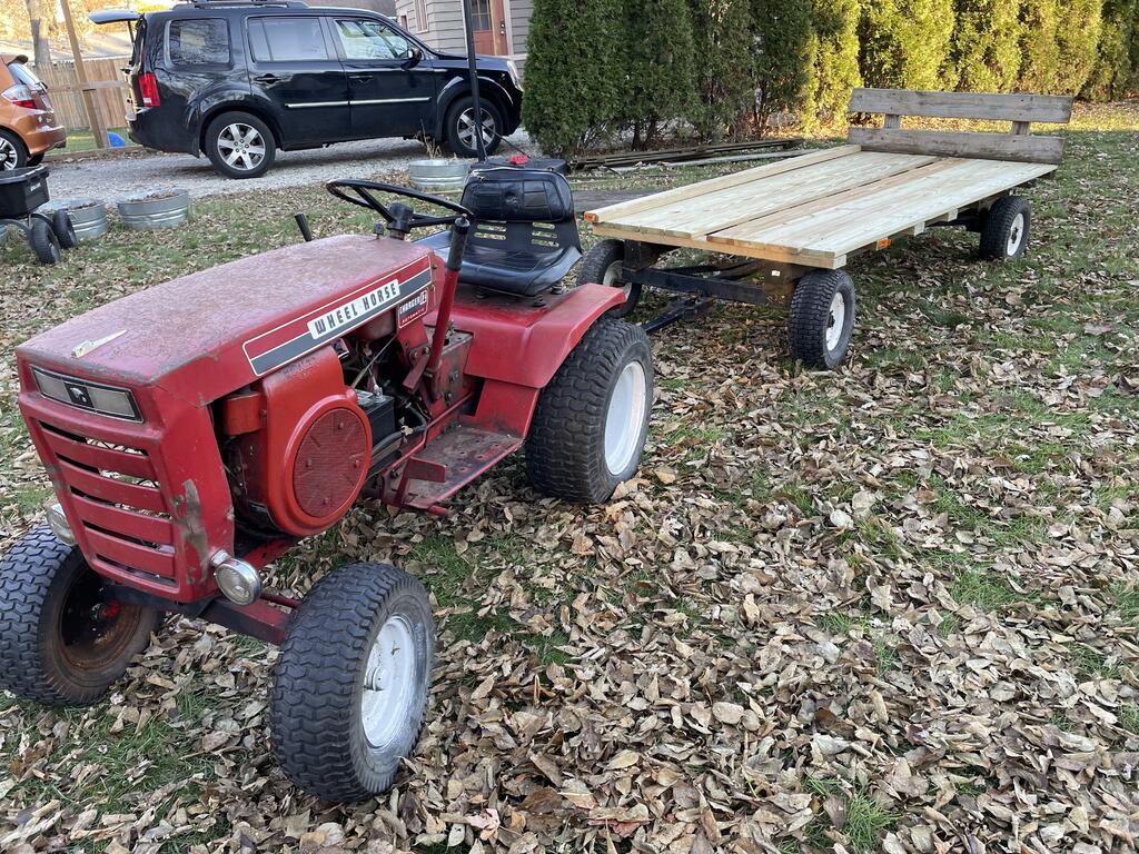

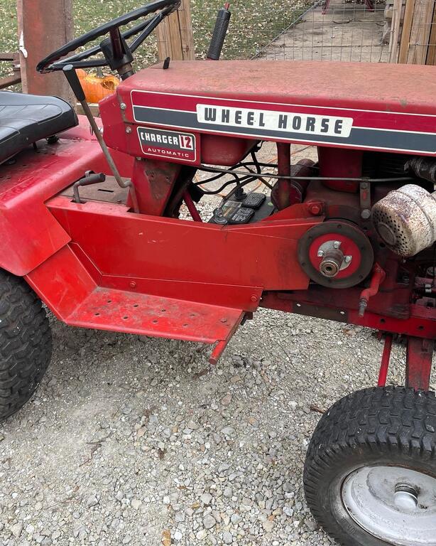

Redav72 231 #1 Posted November 28, 2021 I've been wanting to get a Wheel Horse for years. All I needed was an excuse, so when the guy who does garden tractor hay rides at our church annual event wasn't able to do it this year I went to CL and picked up this 1970 Charger 12 for $200. It runs a little rough and I've already ordered a carb rebuild kit along with a filter for hydrostatic transmission. Philosophy question: Is this a unique enough machine that I should look to keep it as stock as possible or is it common enough that I can give it a little more of a farm spin? Tires are in rough shape and two don't hold air. Should I tube them to keep the original look or put on new AG tires (which I like the look of better)? Where can I get a canister vertical muffler that will reduce noise and give it more of a farm look? 6 6 Share this post Link to post Share on other sites

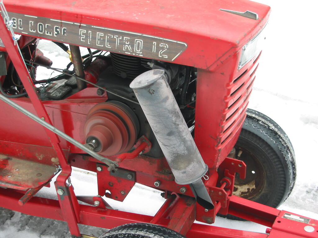

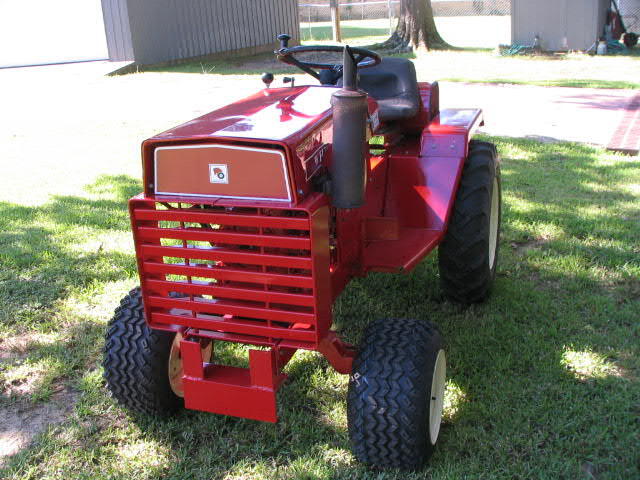

pfrederi 20,868 #6 Posted November 28, 2021 There is a wide variety of ways to get a stack type muffler. As mention Jim Kemp makes nice ones other have modified Farmall Cub Mufflers..Lots of options and widely variable cost. I am not a big stack fan but this would a cheap alternative. This muffler mounted on my Electro 12. You could aim it up. I go down to avoid branches and other issues 3 Share this post Link to post Share on other sites
pacer 3,180 #7 Posted November 28, 2021 You got a steal on that little guy!! I agree with whats already said --- make it YOURS (you can have a lotta fun just doing that!) The muffler @pfrederi shows is a really good option -- reasonable cost, many applications, good sound, etc Here it is in stack mode on my D160 - again shows how versatile they are. 2 Share this post Link to post Share on other sites

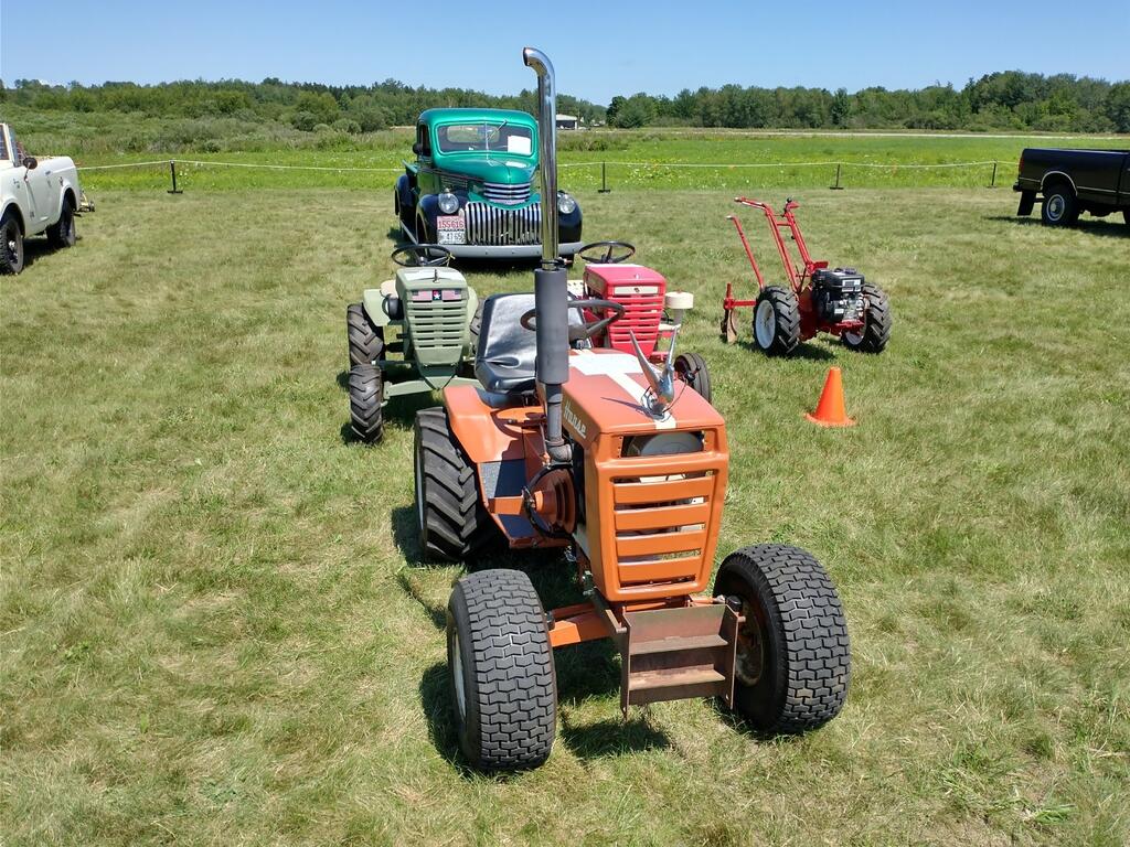

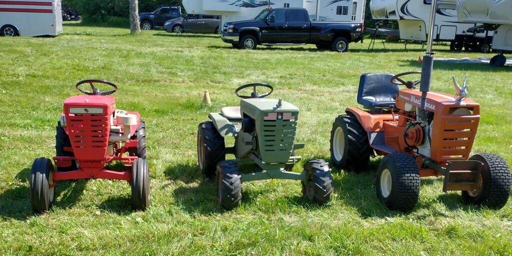

ebinmaine 79,662 #13 Posted November 28, 2021 to Some o these folks know it's only a matter of time before I chime to a "stack" question. Eh @Pullstart?? This here beast is my Cinnamon Horse 1974 C160. I like a stack that's TALL. Can you tell? The top of that one is around 6 ft off the ground. I'll second the above recommendation for a cub muffler, turned to point up. The cub mufflers are fairly quiet which is important to me. If you want to extend it you can use thin wall plumbing pipe as I did or whatever is handy. Here's a pic of 3 from the herd owned by my Honey Trina and I. Her 2 on the left have AGs on the rear. As you can see she runs tri ribs on the front of one and AGs on the other. 2 1 Share this post Link to post Share on other sites

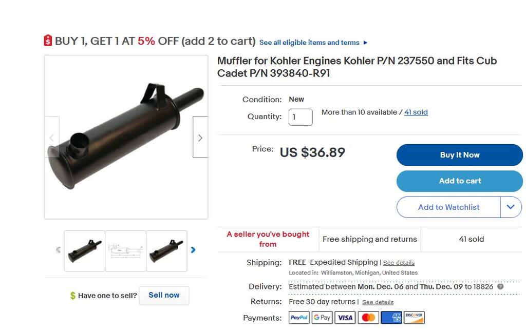

ebinmaine 79,662 #17 Posted November 29, 2021 16 minutes ago, Redav72 said: find the tri-ribs for the front. Here's a copy from the fleabay... TWO (2) 4.00-8 400-8 4.00x8 Tri-Rib 3 Rib 4 ply Rated Tractor Tires Use above to search there and you'll find a pair for $69.88. 2 Share this post Link to post Share on other sites

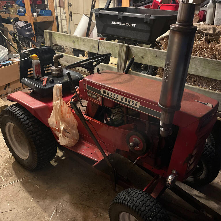

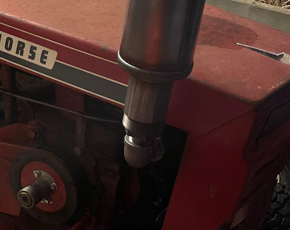

Redav72 231 #24 Posted December 30, 2021 Took the advise of @Snoopy11 and picked up the FlowMonster. Love the look and sound but I'm a little flummoxed as to how I'll permanently install it. I went down the Depot and picked enough black pipe to clear the hood but I'm not quite sure how I'll transition from the 1" out for the block to the 2" of the muffler. I've picked up a 1" to 2" bushing but the 2" is threaded and of course the flow-monster isn't. I'm thinking of grinding the threads off and slipping the muffler over but I didn't know if there were any other more elegant solutions. You can see in the close-up how the new muffler is resting on top of the threads but isn't actually attached. 1 1 Share this post Link to post Share on other sites
sjoemie himself 3,117 #25 Posted December 30, 2021 (edited) That looks awesome. About the mating of the muffler to the pipefitting, looks like a job for a welding machine.. Another option is to cut two opposing slits in the pipe of the muffler and then use a exhaust clamp to clamp the muffler to the pipe fitting. Edited December 30, 2021 by sjoemie himself 1 Share this post Link to post Share on other sites
