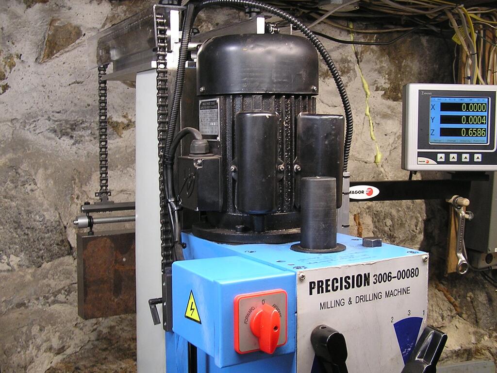

ri702bill 12,475 #2 Posted November 27, 2021 (edited) Hello: I personally have not run chain on my front tires, just AG tires with tubes, filled with winter windsheld washer juice and homemade 25 lb weights - works well and does not mark the driveway - the rears do enough of that. I recently added a counterweight to my milling machine - bought 10 feet of #40 chain, needed 2 42" lengths and used a cutoff wheel to grind the heads on both sides of the pin I wanted to remove. (the chain I bought came with 2 Master links in the box - I used them to attach the chain to the head) Lay it on a block of wood and used a 1/8" straight punch and 2 lb hammer. Connector links come in many varieties - "Master Links" can have either a hairpin clip or the pin could be drilled for small (tiny) cotter pins. Roller chain uses alternating inner and outer links - the master link is a connection that replaces the outer to join 2 inners. Offset is a mutant - it joins an inner to an outer. @ebinmaine has done what you are trying to do, I believe. The key is to deflate the tire to find your true circumference and then decide how to cut the chain and which style link you really need. Install the chain and reinflate the tire to seat the chain. Edited November 27, 2021 by ri702bill 1 Share this post Link to post Share on other sites
