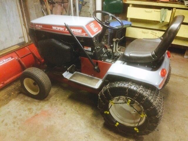

Horse Newbie 7,405 #11 Posted November 27, 2021 Do you all think I could add a “Dial-a-Height” to a 1984 Work Horse GT-1600 ? Share this post Link to post Share on other sites

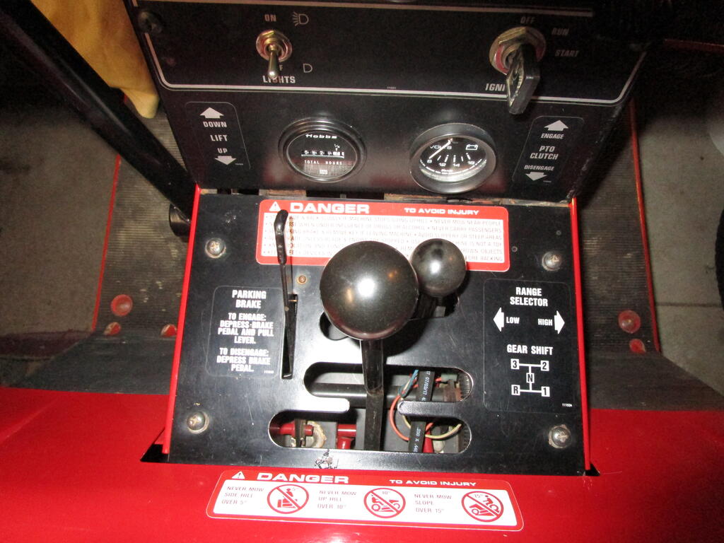

kpinnc 18,744 #12 Posted November 27, 2021 15 minutes ago, Horse Newbie said: Do you all think I could add a “Dial-a-Height” to a 1984 Work Horse GT-1600 ? If your dash tower has the hole in it on the left side. Then yes you can. See the zoomed pic below. 1 Share this post Link to post Share on other sites
Horse Newbie 7,405 #13 Posted November 27, 2021 Thanks @kpinnc… I’ll check ! Share this post Link to post Share on other sites
