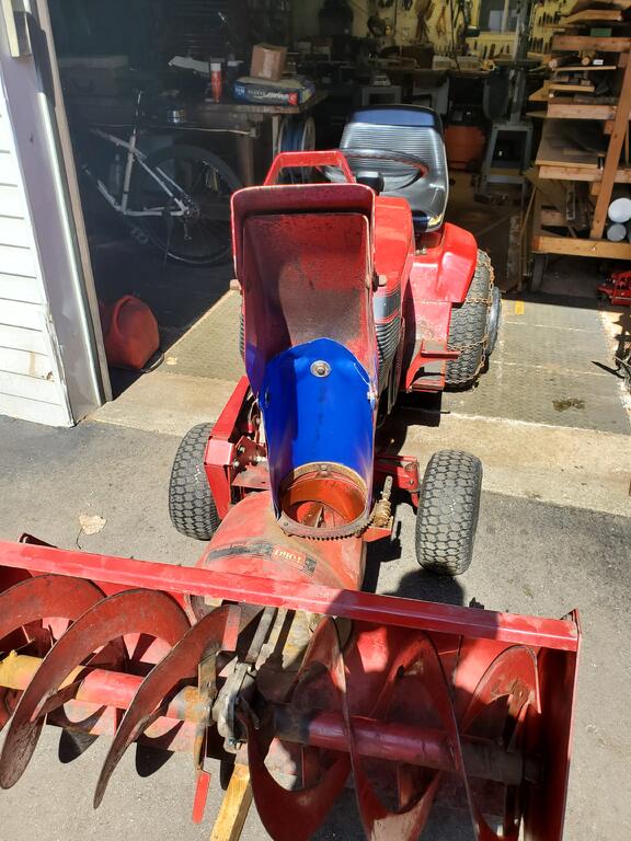

R Scheer 525 #13 Posted November 24, 2021 You mean something like this? I put it in temporarily just to see if the concept worked, it's not the neatest install. Results the heavy wet snow left by the city snow plow can still plug the chute, but it doesn't freeze to the chute. If you can go through some not so wet snow afterwards it will push the plug out. On ordinary wet snow it seems to blow without getting clogged at all. I do spray some Rust check behind the former super slider just to help prevent any rusting issues. The upper portion of the chute I just spray with a dry wax. Overall I'm happy with it, but will probably redo the install and clean it up a bit next spring. 1 Share this post Link to post Share on other sites
wallfish 20,667 #14 Posted November 24, 2021 1 hour ago, R Scheer said: You mean something like this? Yup! That's it Share this post Link to post Share on other sites
