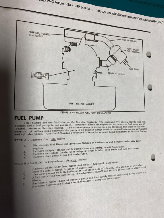

Handy Don 16,751 #4 Posted November 17, 2021 Sounds like classic vapor lock to me, but I've no direct experience for how to solve it on that sort of engine. Vapor lock comes from fuel vaporizing in places where the carb needs liquid to operate properly. I would start by making sure that it has adequate cooling airflow (pull the tins). Maybe also put a heat shield where the exhaust routes near the carb. BTW, I've never seen before a pulse fuel pump that taps into a spacer between the block and the carb. 2 Share this post Link to post Share on other sites

formariz 12,359 #6 Posted November 17, 2021 (edited) 25 minutes ago, Handy Don said: Sounds like classic vapor lock to me, but I've no direct experience for how to solve it on that sort of engine. Vapor lock comes from fuel vaporizing in places where the carb needs liquid to operate properly. I would start by making sure that it has adequate cooling airflow (pull the tins). Maybe also put a heat shield where the exhaust routes near the carb. BTW, I've never seen before a pulse fuel pump that taps into a spacer between the block and the carb. Didn’t think about vapor lock . Pulled spark plug and it’s soaked. I am thinking something going on with carb also. 3 minutes ago, John2189 said: Could be the intake valve is tight And needs adjustment. Stretches when hot. Shrinks when cooled off. That was also my initial thought Edited November 17, 2021 by formariz Share this post Link to post Share on other sites

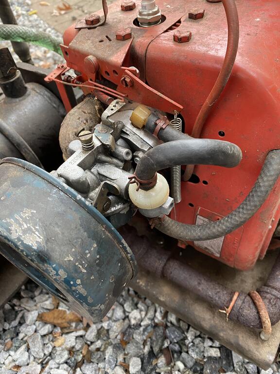

formariz 12,359 #20 Posted November 18, 2021 We will see tomorrow after I redo carburetor if that fixes problem. Interesting thing about this backfire which ordinarily one does not see. If you notice on photo the fitting from the line on pulse pump that goes into adapter flange at engine is a light color plastic. During the backfires it actually lights up. I guess if air filter wasn’t on one would see it out of there. Share this post Link to post Share on other sites
