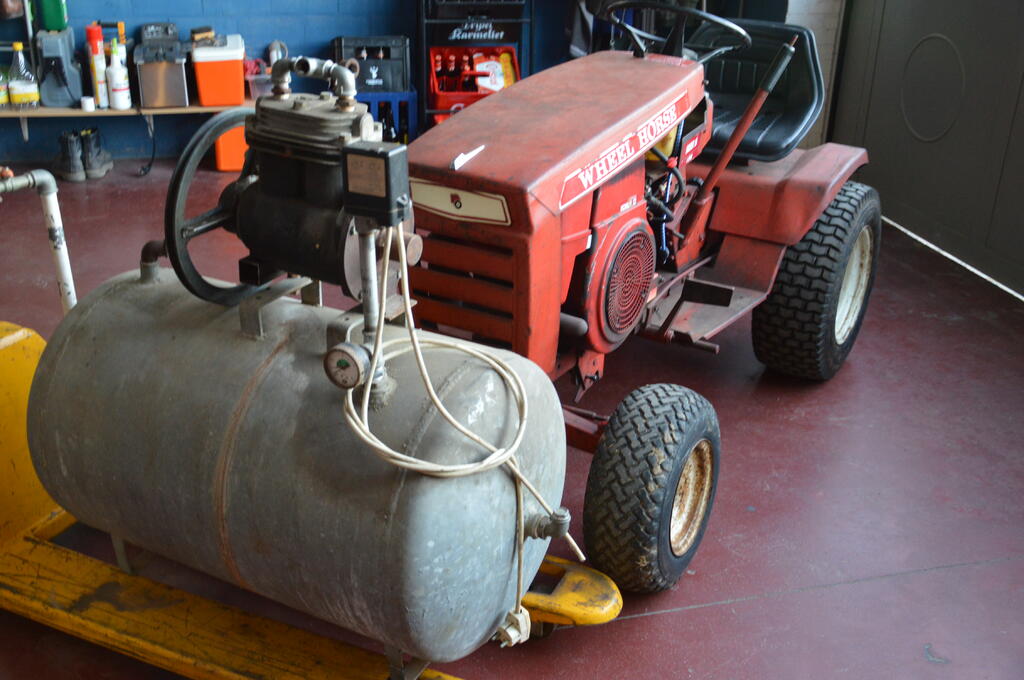

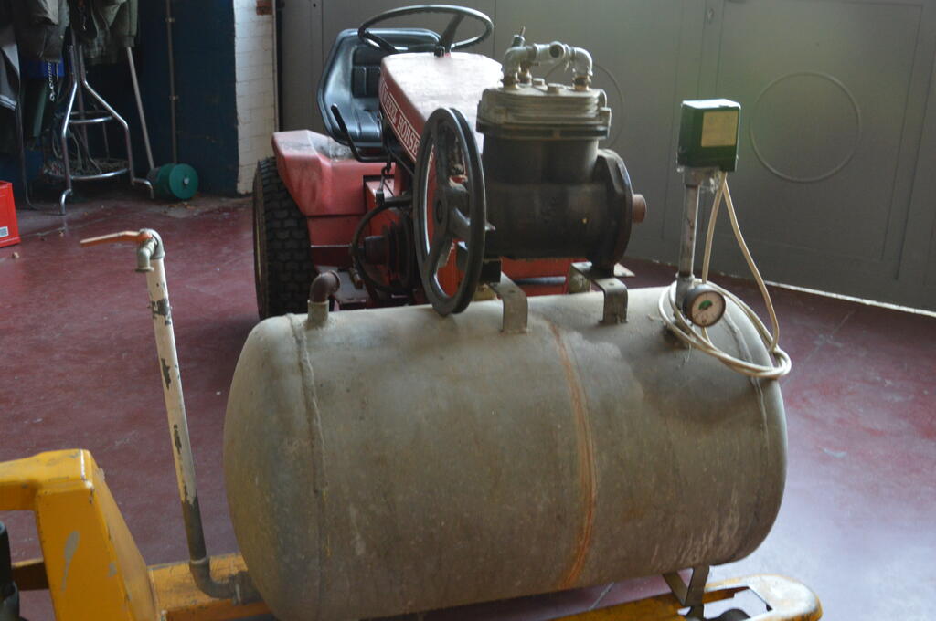

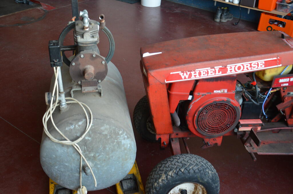

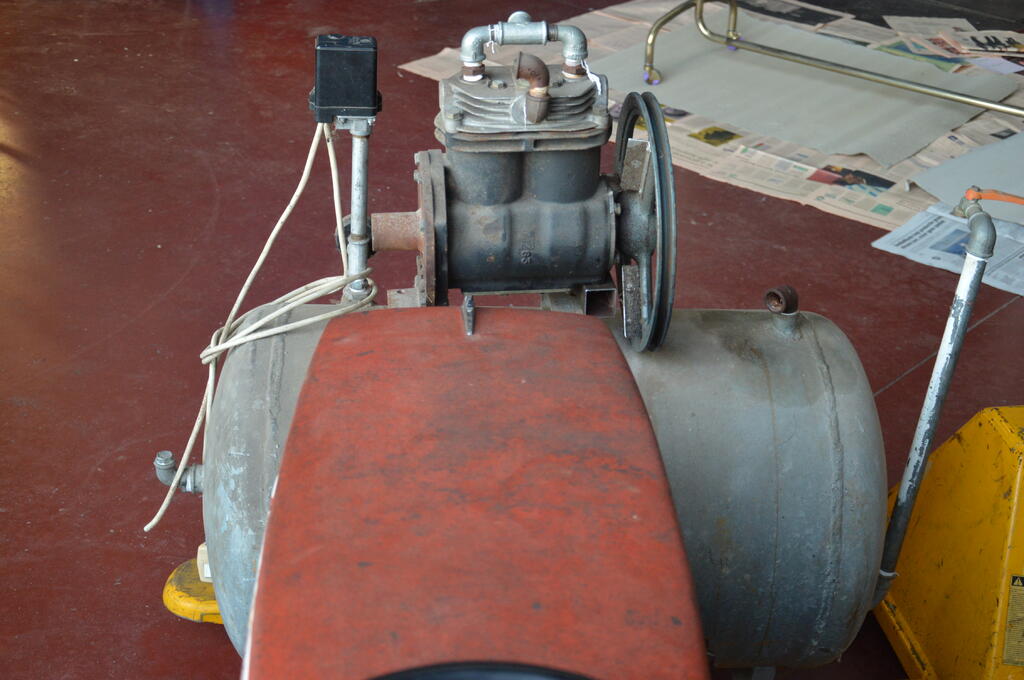

Maxwell-8 4,371 #57 Posted November 22, 2021 I got me a tank. 52 gallons extra sturdy. A bit to big for the task, No? @ 110 pounds for the tank and 55 pounds for the compressor I am starting to worry about weight on that front-end. 3 Share this post Link to post Share on other sites

ebinmaine 80,933 #61 Posted November 22, 2021 3 hours ago, Maxwell-8 said: Haha, I only weigh 140lbs @ 6 foot I'm only 6'-1"+ at 262 lbs. Headed downward... 4 hours ago, Maxwell-8 said: @ 110 pounds for the tank and 55 pounds for the compressor I am starting to worry about weight on that front-end At 165 lbs you're right in the range of what my Mackissic chipper is. I'm not sure what a 2 stage snowblower weighs in at. IMHO, you're just fine. 1 1 1 Share this post Link to post Share on other sites

Handy Don 17,562 #63 Posted November 23, 2021 (edited) On 11/22/2021 at 2:07 PM, Maxwell-8 said: @ 110 pounds for the tank and 55 pounds for the compressor I am starting to worry about weight on that front-end. You might consider a caster mount, similar to the front mount for a mowing deck. Edited November 23, 2021 by Handy Don 3 1 Share this post Link to post Share on other sites
ebinmaine 80,933 #64 Posted November 23, 2021 1 minute ago, Handy Don said: You might consider a caster mount, similar to the front mount for a mowing deck. That's not a bad idea for those that live on flat ground. 1 Share this post Link to post Share on other sites
Maxwell-8 4,371 #65 Posted November 23, 2021 (edited) 22 minutes ago, Handy Don said: You might consider a caster mount, similar to the front mount for a mowing deck. I have been considering that. I have some casters laying around. But I may be looking for a smaller tank. 52 gallons is way more then I will need. But we will see. Edited November 23, 2021 by Maxwell-8 1 Share this post Link to post Share on other sites
Bill D 3,168 #66 Posted November 26, 2021 Mount the pump on the front. Run a high temp hose from the pump to the back of the tractor. Make a trailer for the tank and tow the tank. Use a quick disconnect to connect two. Option two, buy a very small tank and mount it to the back of the tractor. I have seen people make air tanks out of old propane tanks. However, that could be dangerous. It would be safer to buy a proper air tank. 3 1 Share this post Link to post Share on other sites
Maxwell-8 4,371 #67 Posted January 5, 2022 (edited) On 11/26/2021 at 6:47 AM, Bill D said: Mount the pump on the front. Run a high temp hose from the pump to the back of the tractor. Make a trailer for the tank and tow the tank. Use a quick disconnect to connect two. Option two, buy a very small tank and mount it to the back of the tractor. I have seen people make air tanks out of old propane tanks. However, that could be dangerous. It would be safer to buy a proper air tank. Thanks for the tips! Maybe a small update, I got a smaller and lighter tank, which I will most likely will install in the front. I have had little time lately. Will get back in this project in the start of February. Edited January 5, 2022 by Maxwell-8 1 3 Share this post Link to post Share on other sites
