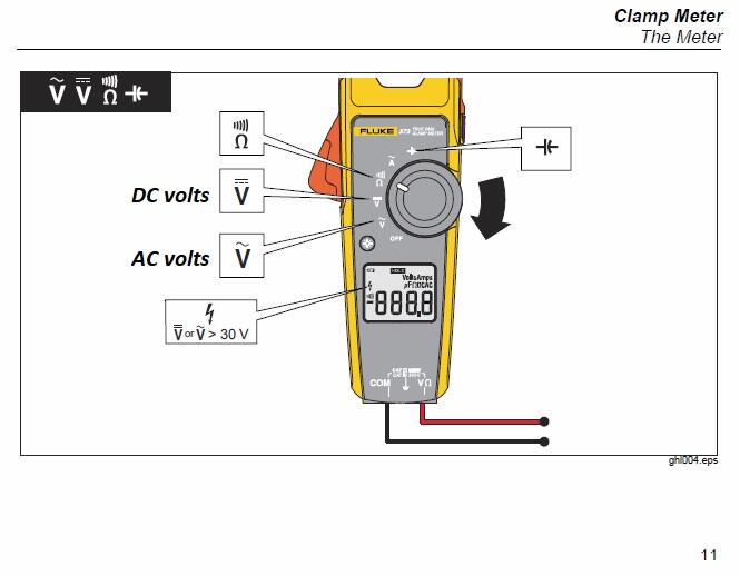

squonk 46,559 #88 Posted November 15, 2021 I can't think of any meter made by Fluke that isn't a DVOM outside of a continuity tester. 1 Share this post Link to post Share on other sites
Crmaverick 91 #89 Posted November 15, 2021 1 hour ago, gwest_ca said: Any model number on your meter? Maybe we can look to see what you are working with. This is the meter I’m working with. Fluke 373 link is below https://www.fluke-direct.com/product/fluke-373-trms-ac-clamp-meter# Share this post Link to post Share on other sites
squonk 46,559 #90 Posted November 15, 2021 That's a DVOM. You said you didn't have one? Share this post Link to post Share on other sites
Crmaverick 91 #91 Posted November 15, 2021 8 hours ago, squonk said: That's a DVOM. You said you didn't have one? It only allows me to do continuity tests I’m not sure where on it I can get resistance readings Share this post Link to post Share on other sites
squonk 46,559 #92 Posted November 15, 2021 The horseshoe setting is resistance. That's the symbol for ohms. The setting just below it is DC volts Share this post Link to post Share on other sites
Handy Don 16,597 #93 Posted November 16, 2021 28 minutes ago, squonk said: The horseshoe setting is resistance. That's the symbol for ohms. The setting just below it is DC volts Just read your manual and you are correct, it is not able to display a reading for ohms (for ohms alone the symbol looks like this: Ω) It tests for, and beeps, for continuity (defined as ≤ 30 ohms) at the Ω with the "sound" symbol above it. Not precise enough for tractor electrical component work. BTW, this is not a cheapie meter. It just has limited functions. Consider a basic VOM from Harbor Freight or the jungle site. Less than $20. Share this post Link to post Share on other sites
gwest_ca-(File Mod) 12,233 #94 Posted November 16, 2021 There is an easy way to determine if the points are working and your meter will do it. Set it on DC volts. Remove the spark plug to eliminate the compression so you can turn the engine over by turning the crankshaft by hand. Put the wire back on the plug and ground the plug so the coil is not overloaded and you can see a spark if it happens. Connect the tester to the battery posts to determine battery voltage. Turn the ignition key to RUN and connect the red test lead to the coil (+) . Should have battery voltage whatever that is. Connect the red test lead to the coil (-). Now turn the crankshaft in the normal direction of travel. When the points are open you should have battery voltage at the coil (-). When the points are closed you should have 0 volts at the coil (-) terminal. This cycle should repeat once for every two turns of the crankshaft. If you have constant battery voltage on the (-) terminal the points are not making electrical contact when they are closed or the wire between the coil and the points is bad. If you have constant 0 volts the points or the wire to the points is shorted to ground. The condenser should be connected to the coil (-) or the points. Try these tests with the condenser wire disconnected. It is the on-off-on-off cycle that forces the coil to fire the plug. 2 Share this post Link to post Share on other sites
