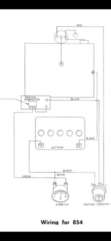

Handy Don 17,193 #13 Posted November 12, 2021 4 minutes ago, Crmaverick said: I realized that someone had the coil wired backwards, ... Once I saw this, I would instantly distrust ALL the wiring on the tractor and stop trying to look for a simple solution. Do you have the OM and wiring diagram? If not, get it from the manual section (search on "tractor 1963 753" for example). Once you have that, confirm that you understand the from and to of every single wire, test and secure each connection (dielectric grease is a good idea), and as you go confirm that you have power where the diagram indicates there should be power and ground where there should be ground. At some point you'll be heard saying "Eureka" or "Aha" or something more colorful when you hit the first spot with a problem. Don't stop. Keep going until you've checked it all. Good luck 2 Share this post Link to post Share on other sites
Crmaverick 91 #14 Posted November 12, 2021 27 minutes ago, Handy Don said: Once I saw this, I would instantly distrust ALL the wiring on the tractor and stop trying to look for a simple solution. Do you have the OM and wiring diagram? If not, get it from the manual section (search on "tractor 1963 753" for example). Once you have that, confirm that you understand the from and to of every single wire, test and secure each connection (dielectric grease is a good idea), and as you go confirm that you have power where the diagram indicates there should be power and ground where there should be ground. At some point you'll be heard saying "Eureka" or "Aha" or something more colorful when you hit the first spot with a problem. Don't stop. Keep going until you've checked it all. Good luck I do have a 854 wiring diagram. I have it all wired up as shown here. Cleaned all connections and added dielectric grease. I am using a jumper cable for my negative battery terminal to ground since I don’t have the wire yet, not sure if that may be an issue. Share this post Link to post Share on other sites

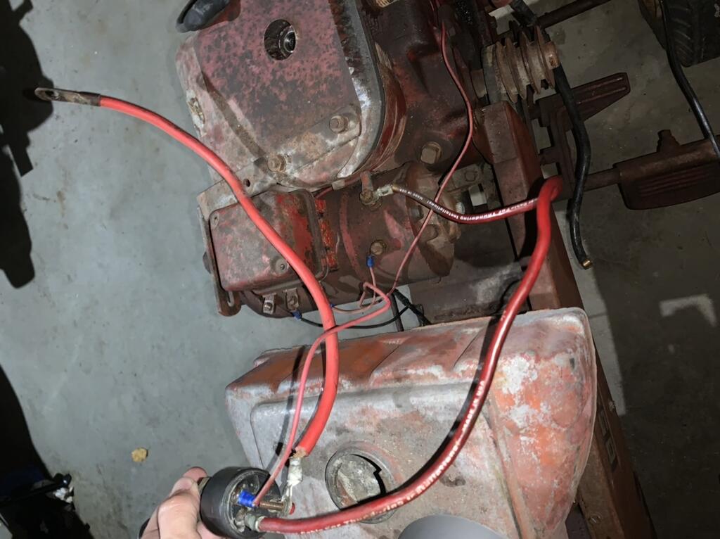

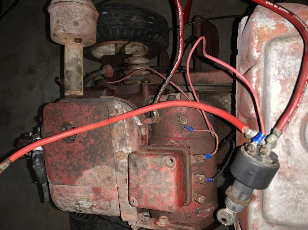

Crmaverick 91 #15 Posted November 12, 2021 (edited) Picture of wiring. It’s following the correct terminals off the ignition switch. I - Goes to + on coil S - Top terminal on Gen B - Hooks to + on battery voltage regulator has whip to bottom terminal. Amp meter is disconnected. Points and condenser to negative on coil. Edited November 12, 2021 by Crmaverick Share this post Link to post Share on other sites
Handy Don 17,193 #16 Posted November 12, 2021 (edited) Are you sure the S/G housing is well grounded to the engine? Looks to me like switch S is going to the bottom terminal on the S/G? What is the extra wire from the S/G going to the regulator? It isn't on the diagram and yet it seems to belong! I'm not familiar with S/G and electromagnetic regulators' wiring though, so hope someone who is can confirm more closely. Edited November 12, 2021 by Handy Don Share this post Link to post Share on other sites
Crmaverick 91 #17 Posted November 12, 2021 30 minutes ago, Handy Don said: Are you sure the S/G housing is well grounded to the engine? Looks to me like switch S is going to the bottom terminal on the S/G? What is the extra wire from the S/G going to the regulator? It isn't on the diagram and yet it seems to belong! I'm not familiar with S/G and electromagnetic regulators' wiring though, so hope someone who is can confirm more closely. The S terminal is the thicker red wire coming off the switch onto the top of the Gen. the way I’m looking at the diagram the other small wire off the voltage regulator is on the diagram on the bottom terminal of the S/G Share this post Link to post Share on other sites

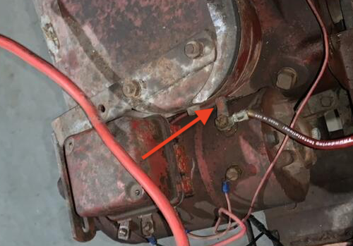

Handy Don 17,193 #18 Posted November 12, 2021 9 minutes ago, Crmaverick said: The S terminal is the thicker red wire coming off the switch onto the top of the Gen. the way I’m looking at the diagram the other small wire off the voltage regulator is on the diagram on the bottom terminal of the S/G Not sure which terminal is which on the S/G. Sorry. This wire (red arrow) is making me curious. Share this post Link to post Share on other sites
Crmaverick 91 #19 Posted November 12, 2021 50 minutes ago, Handy Don said: Not sure which terminal is which on the S/G. Sorry. This wire (red arrow) is making me curious. That’s some factory wire it’s not on the diagram Share this post Link to post Share on other sites
ebinmaine 80,084 #20 Posted November 12, 2021 2 hours ago, Crmaverick said: Amp meter is disconnected How's this done? Is there a jumper or are the 2 wires to the meter connected? What are you using for a negative battery cable? Share this post Link to post Share on other sites
Crmaverick 91 #21 Posted November 12, 2021 22 minutes ago, ebinmaine said: How's this done? Is there a jumper or are the 2 wires to the meter connected? What are you using for a negative battery cable? The amp meter on the dash board of the tractor is disconnected, does that need to be hooked up? im using a battery jumper cable as the negative from battery negative to block Share this post Link to post Share on other sites
ebinmaine 80,084 #22 Posted November 12, 2021 Ammeter itself doesn't need to be in there. The wire going through it however, certainly does. You can bypass the ammeter by connecting both of the terminals to the same stud on the meter. Share this post Link to post Share on other sites
ebinmaine 80,084 #23 Posted November 12, 2021 8 hours ago, Handy Don said: Not sure which terminal is which on the S/G. Sorry. This wire (red arrow) is making me curious. Most S/G terminals are actually labeled right on the connection tab or near it. 7 hours ago, Crmaverick said: That’s some factory wire it’s not on the diagram Where exactly does that go?? The ONLY wire I've noted not being on the factory schematic is the one that goes from VR to under itself on the S/G. The negative cable should be fine as a battery jumper as long as the squeeze clamps are well "chewed in" to what they're on. Likely you're ok there given that the engine will turn over. Share this post Link to post Share on other sites
ebinmaine 80,084 #24 Posted November 12, 2021 8 hours ago, Handy Don said: Not sure which terminal is which on the S/G. Sorry. This wire (red arrow) is making me curious. Don you've got 3 terminals left to right in this pic. (The right one is behind the battery cable). Left. Lights/accessories. Middle. Feeds back to battery positive through ammeter. Right. To S/G for powering ((fields??)). @Crmaverick that extra wire isn't factory. That's a PO add-on from the past. Share this post Link to post Share on other sites
ebinmaine 80,084 #25 Posted November 12, 2021 10 hours ago, Crmaverick said: Also on the lead that goes to + on coil I have 12 volts at the key ignition but somehow at the coil nothing on the + terminal. 2 things to do here. Remove, clean and reinstall both ends of that wire. Using the Continuity setting on your DVOM check that wire on and off the tractor. While it's off the tractor and in your hands connected to the DVOM shake/twist/move it around to check for inconsistency or breaks in the continuity. Share this post Link to post Share on other sites
