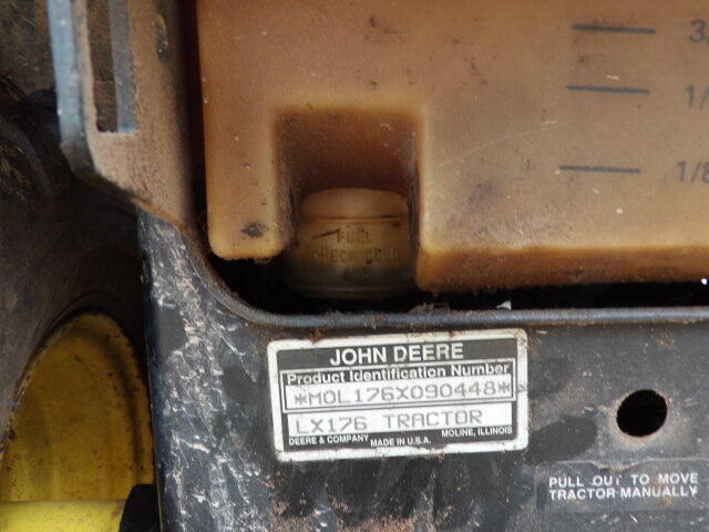

Snoopy11 5,731 #52 Posted November 12, 2021 So... I was looking at a diagram of my transaxle... and I noticed... my transaxle does not have a reservoir... like it is supposed to... the reservoir is missing... it just has a tube coming up and it is capped off... So... I had to order one... My tires are supposed to come tomorrow... I can only hope... Don Share this post Link to post Share on other sites
Handy Don 17,393 #53 Posted November 12, 2021 44 minutes ago, Snoopy11 said: So... I was looking at a diagram of my transaxle... and I noticed... my transaxle does not have a reservoir... like it is supposed to... the reservoir is missing... it just has a tube coming up and it is capped off... So... I had to order one... My tires are supposed to come tomorrow... I can only hope... Don Same idea as the Eaton 700 -- gotta have somewhere for fluid to go when it heats up and expands! Share this post Link to post Share on other sites
Snoopy11 5,731 #54 Posted November 12, 2021 13 hours ago, Handy Don said: Same idea as the Eaton 700 -- gotta have somewhere for fluid to go when it heats up and expands! Yes, I think for right now, I am just going to keep in in the shop... even after I get my tires on, until I get the bottle. I might pull it out of the shop to let it air out... but I won't be driving it around quite yet.... Don Share this post Link to post Share on other sites

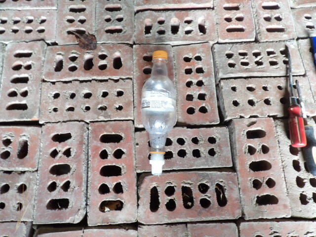

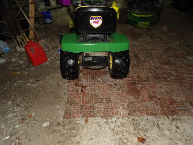

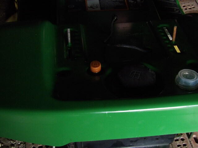

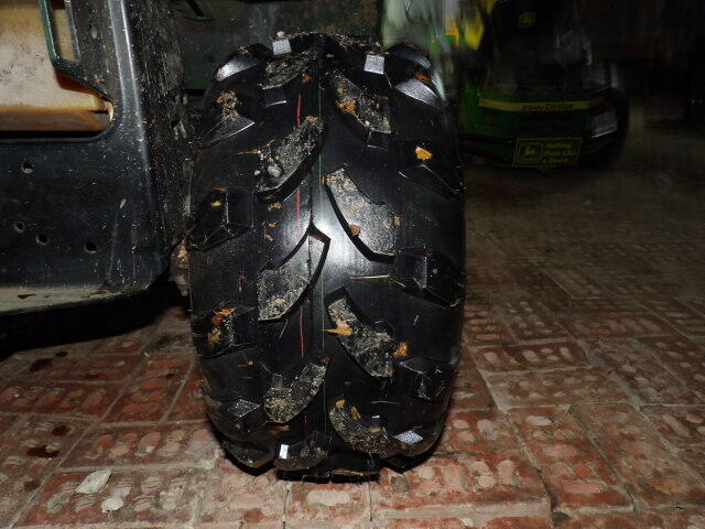

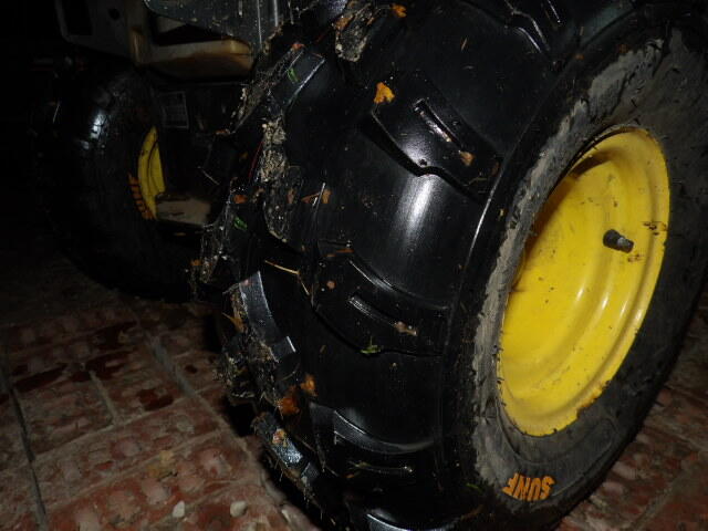

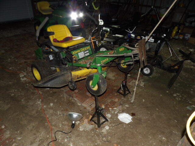

Snoopy11 5,731 #55 Posted November 13, 2021 (edited) What a day... So, I wanted to mulch up some leaves before the rain today. I hit a stump with the zero turn... broke the deck. Knowing that I am going to have to weld, cut, and do a lot of modifications to the deck now to get the zero turn back in commission... I figured... well... might as well give the '95 LX176 a shot. My tires came today, so I put them on... and took it out for a run. It is awesome. It does not bog down, even in the thickest of leaves... it is pretty darn fast... faster than the zero turn believe it or not... I made the following for the transaxle reservoir until the one I ordered comes... pretty primitive, but it worked like a charm! Go ahead and laugh... I know you want to. AND YES, I stood there and drunk 2 rootbeers to make that...! You can see the bottle coming through in this picture... where I can fill the 'reservoir' LOL TIRES... pain in the )( to put on... And yes, guys, even though I said I wasn't going to... I did paint it green for resale value purposes... (a buddy convinced me of this...)... altough, after using this sweet old girl, I am really leaning towards not selling it! zero turn out of commission... 'till tomorrow... In the middle of mowing with the LX176... the deck belt broke (it has a right to... after all it is probably 20 years old itself...)... so believe it or not, the belt that I use for HellHorse actually fits the deck on the John Deere... so since I had a couple of extra belts laying around for HellHorse... I did not have to run to a tractor store... ! I got my lights put on... I think that covers everything. What a day. Don Edited November 13, 2021 by Snoopy11 1 1 Share this post Link to post Share on other sites

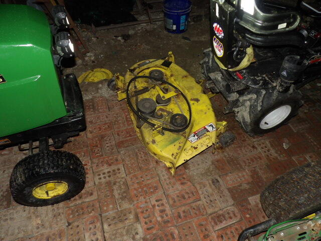

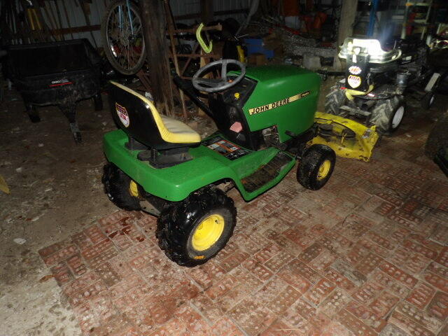

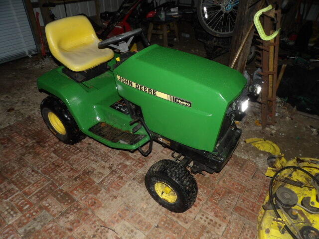

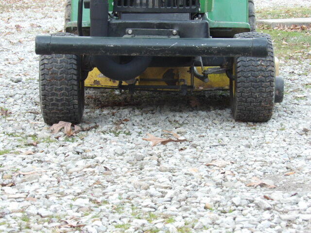

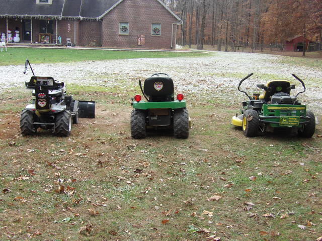

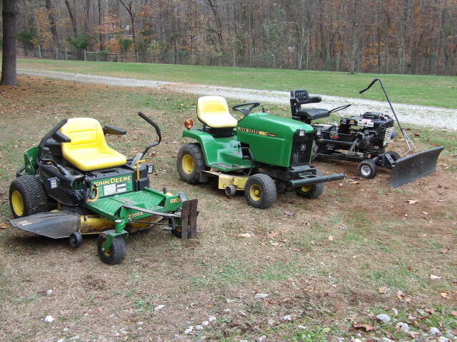

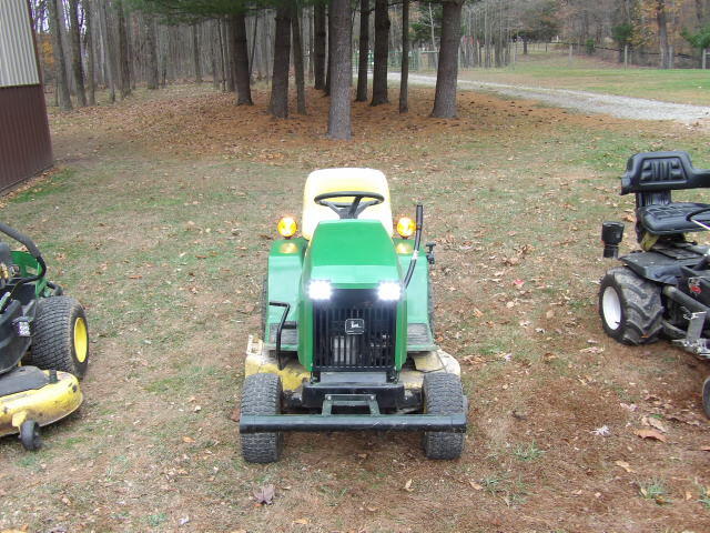

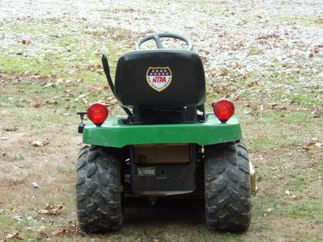

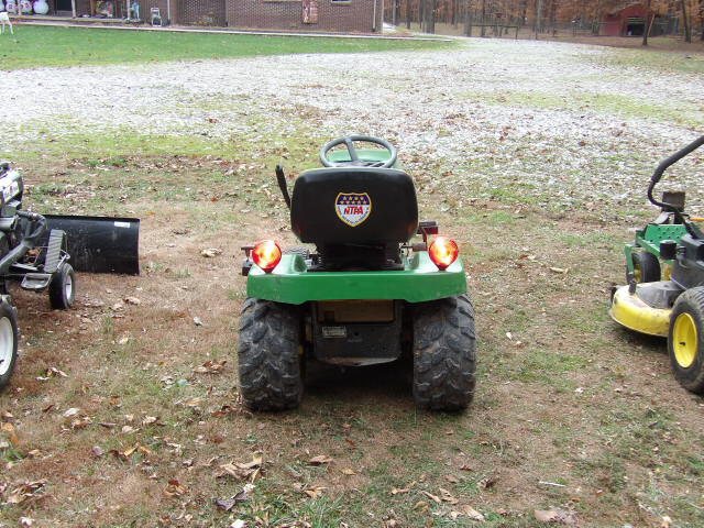

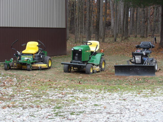

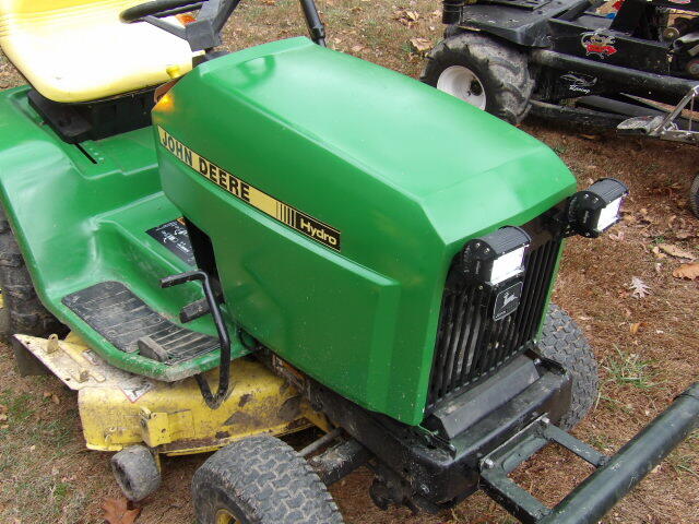

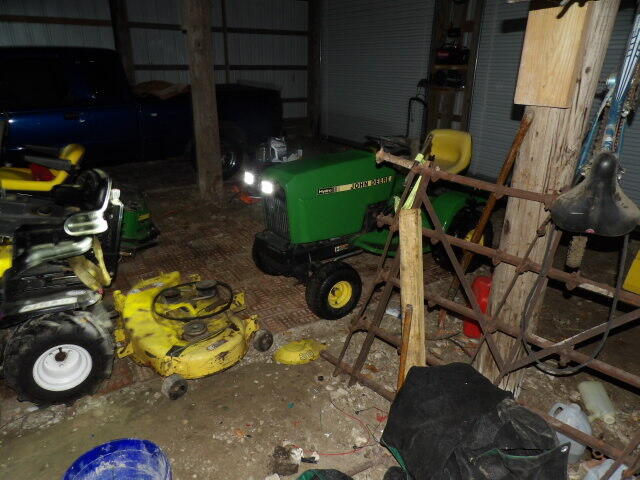

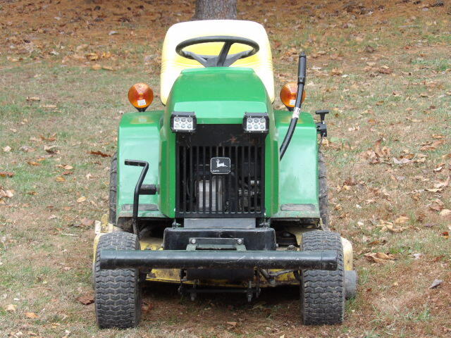

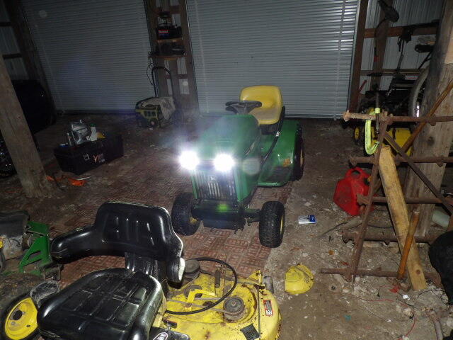

Snoopy11 5,731 #65 Posted November 20, 2021 UPDATES! I had a clogged main jet, so had to re-clean the carb... (not sure where the gunk came from... as I cleaned the entire fuel sytem and put a new filter on... but... )... Got some additional lighting put on. Used the bumper that I made for HellHorse, and bolted it onto the front of the '95 deere... (the bumper will interchange with Hellhorse and the deere, at my discretion... ) Put a nice clear coat on it... All new tires... And, when taking this photography, I just had to include the Wheel Horse, of course... ...(the zero turn showed up there somehow... ) Got my new reservoir put in... Don 2 Share this post Link to post Share on other sites
Snoopy11 5,731 #66 Posted November 20, 2021 You know, I was thinking... what is interesting about taking pictures of all my equipment together is... HellHorse has more horsepower than both of the Deere's combined... Don 1 Share this post Link to post Share on other sites

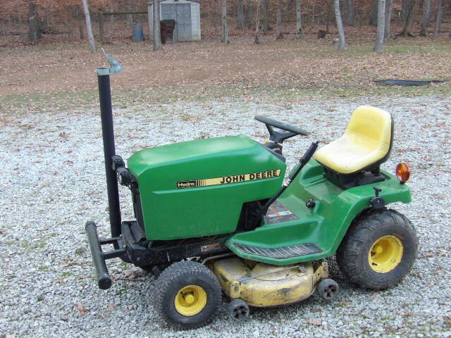

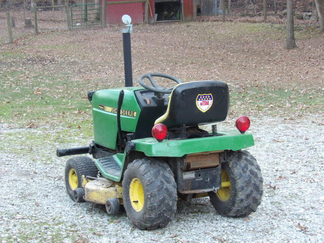

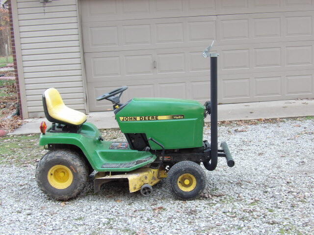

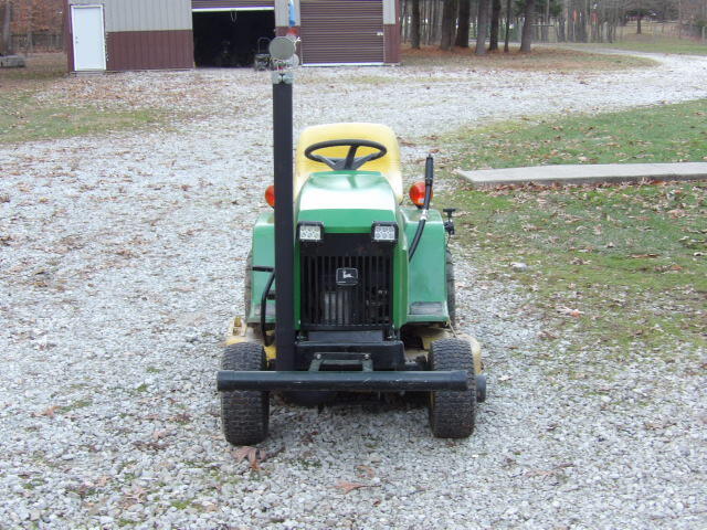

Snoopy11 5,731 #71 Posted November 29, 2021 You will probably like this @ebinmaine... I HAVE MADE, ZEE STACK!!! Don Share this post Link to post Share on other sites
ebinmaine 80,485 #72 Posted November 29, 2021 MOOHOOHOOHAAHAAHAAHAA!!!!! 1 Share this post Link to post Share on other sites
Snoopy11 5,731 #73 Posted November 29, 2021 19 minutes ago, ebinmaine said: MOOHOOHOOHAAHAAHAAHAA!!!!! I figured that you would like it. I had to move it more forward than I would have liked... because of the really tight steering... the wheels come VERY close to the frame... so I had to move the stack more towards the front of the tractor... Still looks pretty though... Don 1 Share this post Link to post Share on other sites
Snoopy11 5,731 #74 Posted November 29, 2021 VIDEO... Tractor was VERY cold, but... this is pretty much the way it sounds... much more like a tractor... than a lawnmower... Don 1 Share this post Link to post Share on other sites
ebinmaine 80,485 #75 Posted November 29, 2021 Not bad at all for such a small engine. Has a neat little echo in there... 1 Share this post Link to post Share on other sites
