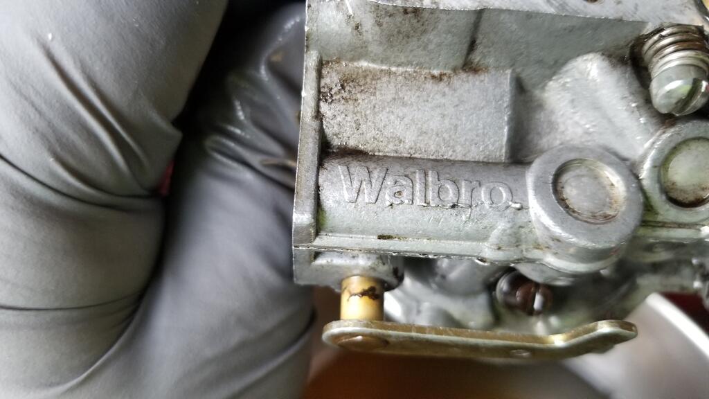

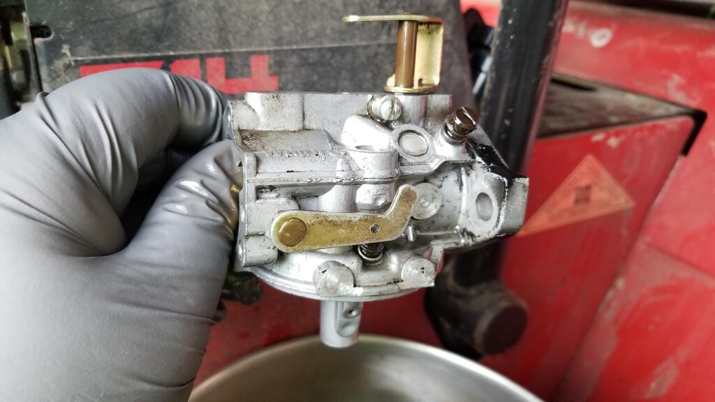

oldlineman 1,809 #9 Posted November 2, 2021 Please don't use starting fluid in a gas engine, better using carb cleaner for this test. You need to do a good rebuild and cleaning of this carb., probably has dried corn alcohol in some internal passages. Bob 2 Share this post Link to post Share on other sites

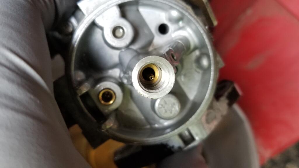

oliver2-44 11,741 #10 Posted November 2, 2021 4 hours ago, JDEVO said: On the Walbro carburators that I have cleaned the jet was always to the side like that. leave it there, don't try to remove it. i would get a carb kit and carefully clean all the small passages. The Walbro carb kit will contain some small welch plugs (metal disc) Remove the ones on the carb and carefully clean those passages, then install the new welch plugs. Share this post Link to post Share on other sites

oliver2-44 11,741 #18 Posted November 3, 2021 Back to getting your horse running. As part of inspecting you carburetor check if the throttle shaft has a lot of side to side wear that would let air leak my the carb. 1 Share this post Link to post Share on other sites

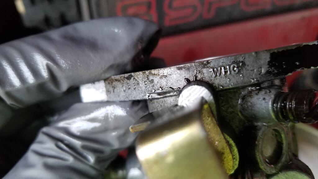

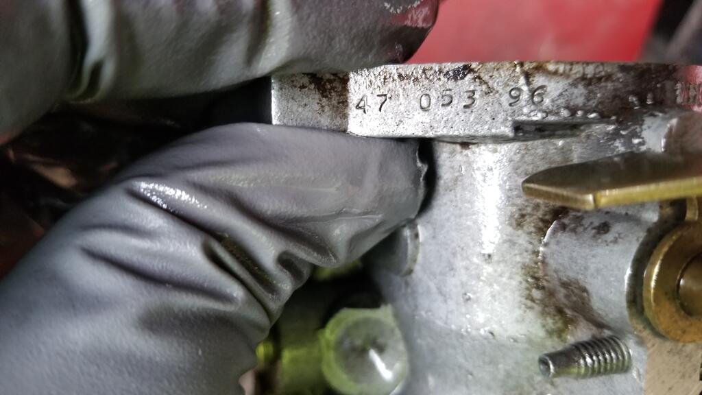

JDEVO 9 #19 Posted November 3, 2021 (edited) I have new gaskets and air filter. The gaskets I have are for the carb attachment at the head to carb and air filter assembly to carb. I do not have a carb rebuild kit. When I was searching for this carburetor, I never ran across a rebuild kit. Concerns me if I will find one. Do you (Jim, my name is John) know a good place to look for these type of kits? I was keeping my eye out last time for a carburetor kit because I was scared, I would ruin the gas bowel gasket by removing it. It didnt break it but after not being in the carb for 2 days it looks a bit wonkie. I dont have a lot of confidence it will seal back up. I have worked on cars and trucks all my life but I have never rebuilt a carburetor. I guess my luck has run out. Honestly, just glancing at the carburetor I am not sure what I could take off next to get into the inner workings of this thing. lol ....I will look for YouTube videos. In the fifth picture I posted. Are those part numbers? 47 053 96 All you guys rock, I really appreciate the help and I look forward meeting and riding my 314 in a parade with you all. I will keep the pictures coming. I FOUND REPAIR KIT,,,,THANKS GUYS Edited November 3, 2021 by JDEVO 3 Share this post Link to post Share on other sites
tunahead72 2,662 #20 Posted November 3, 2021 5 hours ago, JDEVO said: ... In the fifth picture I posted. Are those part numbers? 47 053 96 ... I FOUND REPAIR KIT,,,,THANKS GUYS Yes, that's your carb number. Have you seen the Kohler carb reference manual posted here under Manuals? It's really useful, and will give you Kohler numbers for the kit and a lot of the individual parts as well. You can also find a Walbro kit for it. I don't have the part numbers you might need, but they're readily available. The WHG on your carb is the Walbro series name. There's also a how-to on this site that's really helpful if you've never done one of these small engine carbs. It's not hard, I refer to it every time I clean and rebuild one of mine. I'll see if I can find direct links for these two documents. By the way, what kit did you end up getting? 1 Share this post Link to post Share on other sites
tunahead72 2,662 #21 Posted November 3, 2021 Here's the carb reference manual: Engine Kohler Carburetor reference #TP-2377-E.pdf - Kohler - RedSquare Wheel Horse Forum 1 Share this post Link to post Share on other sites
tunahead72 2,662 #22 Posted November 3, 2021 And here's the rebuild instructions I use (I thought it was on our site here, but it's not). I just noticed the web site there is not secure, so if you're at all nervous about that, let me know and I'll send you a PM with it attached. Microsoft Word - carb rebuild (mgonitzke.net) Your carb will look a little different than the one he's working on, but the basic procedure is the same. I've only done one Walbro carb like yours, and don't remember the details right now, but I do have some notes somewhere. And as @oliver2-44 mentioned, check the throttle shaft, it will make a difference if it's loose, and it's easily repaired. 1 Share this post Link to post Share on other sites
