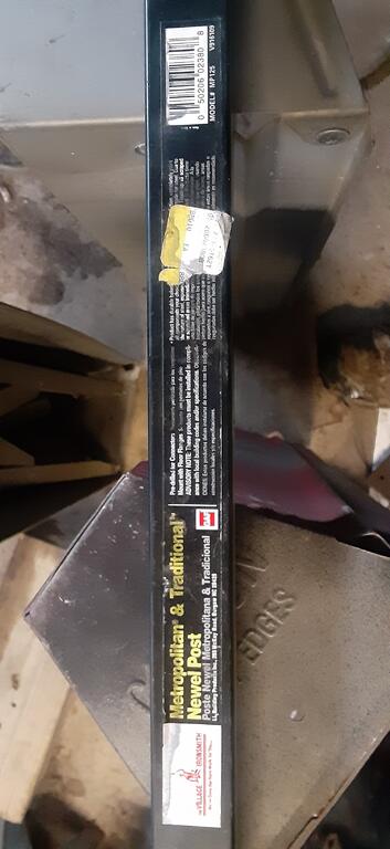

As luck would have it I was just gifted 18 metal newel posts. Approx 1-1/4 square by 30+ish inches long approx 16-14ga. material.
 I think those will come in quite handy.

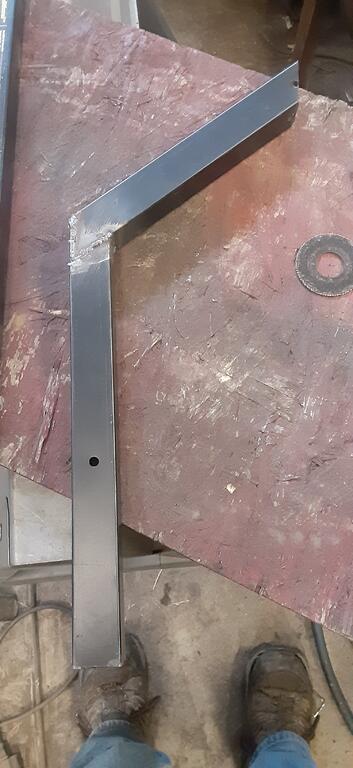

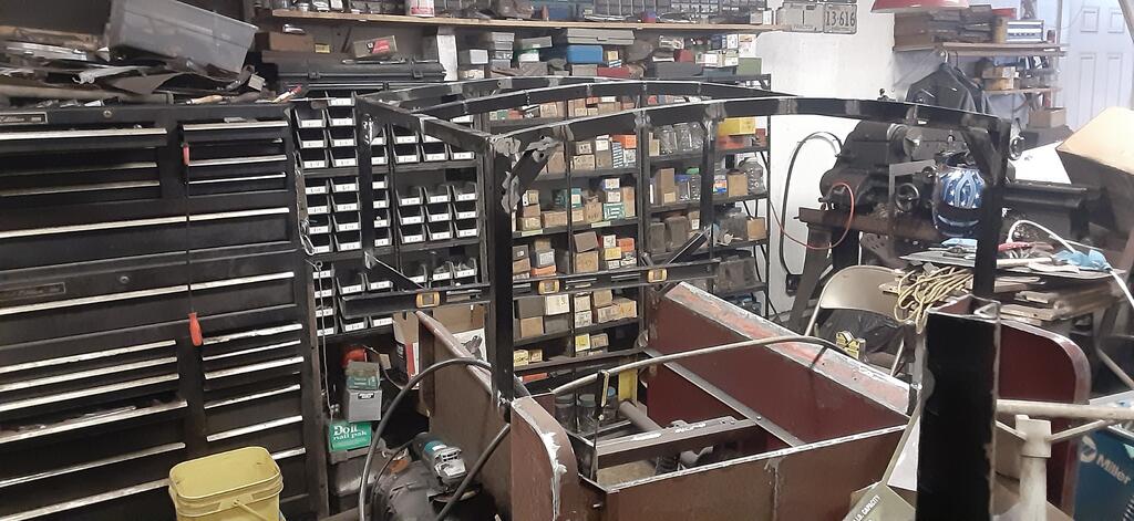

I have finally managed to get some shop time in.
Chopping and welding some of those newel posts together. Maybe I'll have a semi finished product later this afternoon.

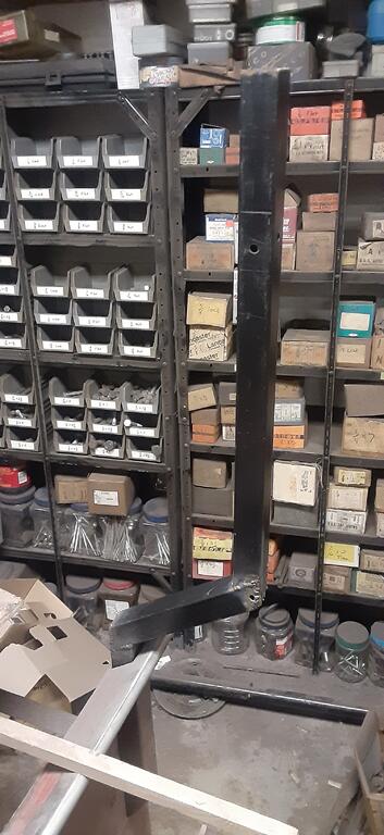

Oldskool
Not as far as I was hoping for today.
One step closer

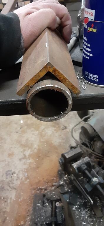

So I had a chance to walk around this project a couple times today after work while getting and putting away the snowblower.
I'm thinking of stiffening up the pipe frame a bit.
My dilemma is.... would welding 2in x 1/4"angle iron on the top of the the pipe like a cap give me enough strength?
Or would I be better off trusting it with 1"x1" 1/8" tubing turned 45degree from the pipe with sections of flat stock welding inbetween periodically?
OR some other method?
If the tubes you built are 2" square I kinda like the option A.
Aesthetically it would be consistent and 1/4 is pretty rugged angle iron.
Oldskool
The frame is 2in ID pipe approx. 3/16 wall
TractorEd
I agree with eb.  But if it were me, I’d take a few more walks around and glances at it before thinking on it a bit.
Handy Don
I’d like to hear @Pullstart chime in on this with his experience on larger vehicles.
That pipe is pretty sturdy but it may need some stiffening to limit flex and possibly twisting. Hard to say at a distance.

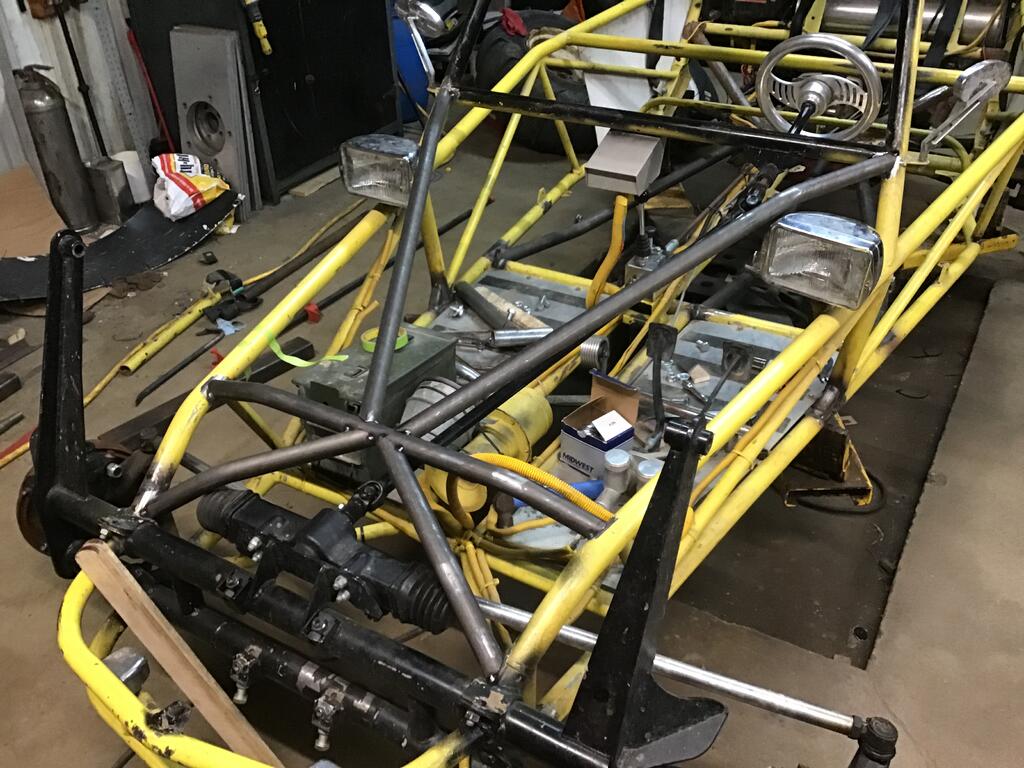

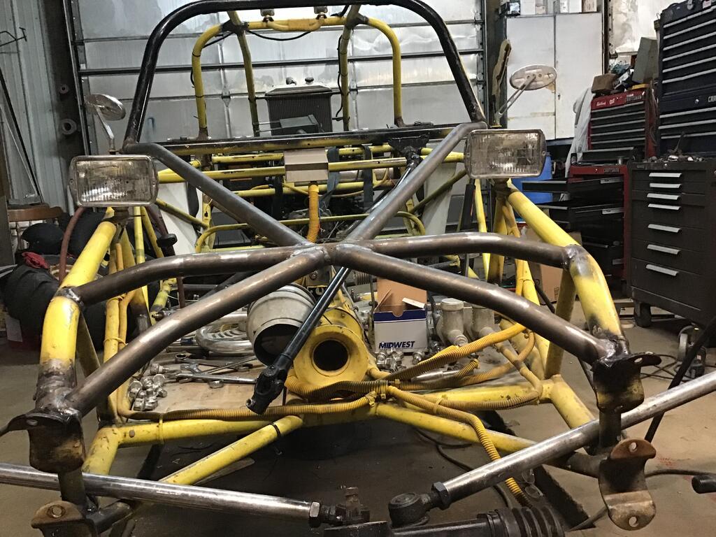

I’d like to see some pictures of the ideas… hold a piece up and snap a pic for us to chew on maybe?  I do know one thing.  Triangulation trumps thickness whenever possible.  I’ve gotten some massive strength in my buggy front end (I’ve been getting the buggy itch lately) by adding this all diameter and thinner wall tubing, but with structurally sound design.
wallfish
:text-yeahthat:
"Beefing it up" with triangles gives support in all directions. Like Kevin's buggy is. Even the original frame is triangles everywhere

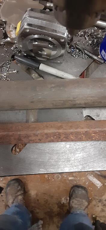

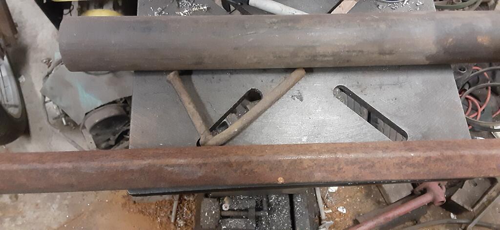

Oldskool
Here are some ideas from scrap laying around. I will buy new when a design is settled on.
My trouble spot is the 5ft straight run of frame.
This rig won't be used for extreme off road. Mostly to carry the wife's and my butts to camp along with some coolers and such.
The biggest issue is the massive amount of potholes and ruts along the way.

Well, that’s triangulation to a point… it would prevent twisting for sure.

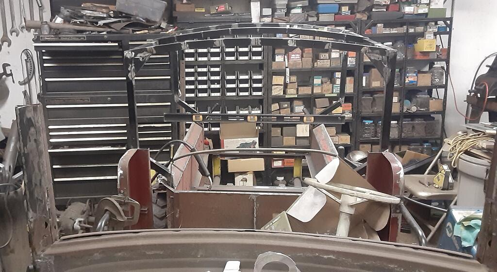

Did get to do some welding today.
I'm thinking this part will be hardtop.
From there to the windshield post will probably be much like a canvas type Jeep bikini top.

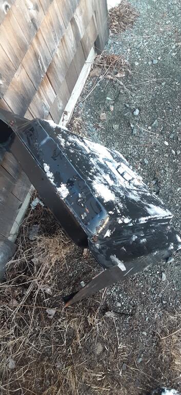

I think this maybe the gas tank I'll use.
It's a generator tank. Possibly 2 -2.5 gallons. It will probably be mounted under the bed floor at the rear with access thru a hatch cover of sorts.
Handy Don
You might be surprised. My “square pancake” fuel tank on a 9hp generator holds 6+ gallons. That one doesn’t look much different. Post the dimensions and I’ll do the math!
Oldskool
I think it's about 18"x22"x4"
Handy Don
If it had squared corners, it’d be about 6.8 gallons. Since it’s a bit beveled on the sides, figure 6.5.
Nice!
