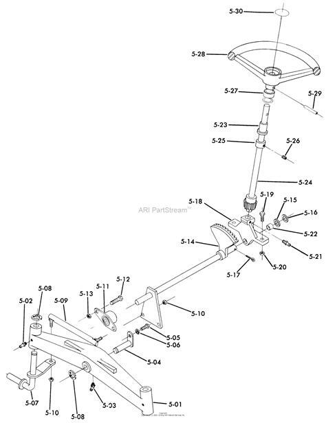

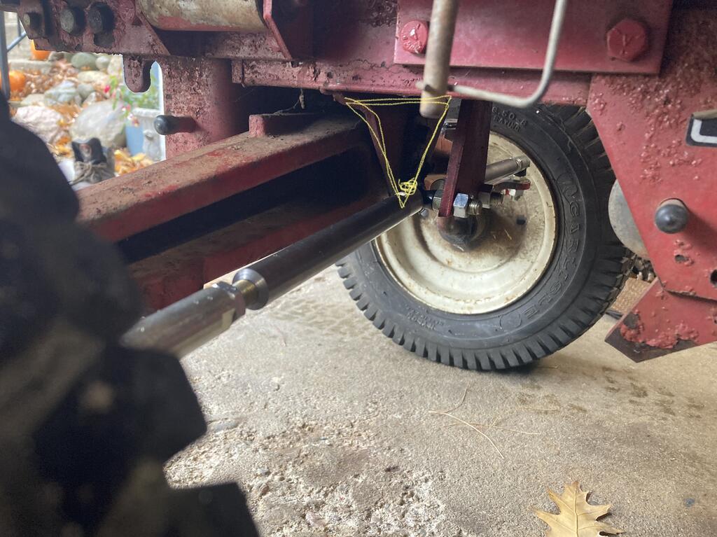

Lee1977 7,805 #51 Posted November 16, 2021 On 11/13/2021 at 12:47 PM, SylvanLakeWH said: Tie rods installed… No more wandering front end…! Did you check to axle pivot tab as they are usually broken. 2 Share this post Link to post Share on other sites
SylvanLakeWH 32,722 #52 Posted November 16, 2021 (edited) 1 hour ago, Lee1977 said: Did you check to axle pivot tab as they are usually broken. I did not. Is that the L shaped bracket in front of where the tie rods connect to the steering shaft in the picture? Highlight yellow… Which part are you referring to? Edited November 16, 2021 by SylvanLakeWH Added parts diagram… Share this post Link to post Share on other sites
WHX?? 58,308 #53 Posted November 16, 2021 On 11/13/2021 at 11:47 AM, SylvanLakeWH said: Tie rods installed… No more wandering front end…! Do we not have a rattle of regal red here Silvia!?!? Lowell leaves them plain in case a guy wants to go green or yellow.... 2 Share this post Link to post Share on other sites
SylvanLakeWH 32,722 #54 Posted November 16, 2021 7 minutes ago, WHX?? said: Do we not have a rattle of regal red here Silvia!?!? Lowell leaves them plain in case a guy wants to go green or yellow.... Now don’t you worry yourself there… I took the @peter lena approach for now and lathered them with copious amounts of grease… whilst you are gathering your curds for a long winter nap, it’s cold round my parts and I’ll wait and do em proper in the Spring. Some of us don’t have heated play rooms with padded walls for shops… Yes, they’ll be Regal Red… or maybe not… may just go “awe naturale” in keeping with the whole electric, save the planet, battery powered thing… them rattle cans gonna melt the North Pole ya know… Stay tuned… 1 1 5 Share this post Link to post Share on other sites
WHX?? 58,308 #55 Posted November 16, 2021 17 minutes ago, SylvanLakeWH said: copious amounts of grease Oh yeah... two guys you don't want to p off ... the pope & lube police! 1 3 Share this post Link to post Share on other sites
Lee1977 7,805 #56 Posted November 16, 2021 4 hours ago, SylvanLakeWH said: I did not. Is that the L shaped bracket in front of where the tie rods connect to the steering shaft in the picture? Highlight yellow… Which part are you referring to? 5-04 axle pivot the tab where it is bolted to the axle. 1 1 Share this post Link to post Share on other sites
lynnmor 9,051 #57 Posted November 16, 2021 6 minutes ago, Lee1977 said: 5-04 axle pivot the tab where it is bolted to the axle. When the bore for that 5-04 gets worn, the 5-05 bolt gets worked loose and can fall out. If the 5-04 is a sloppy fit it should be repaired. To prevent wear in the future, jack up the tractor by the frame so that the axle hangs free, and then pump grease in till it comes out clean. 1 1 Share this post Link to post Share on other sites

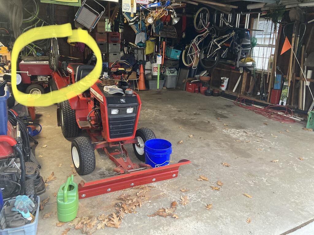

SylvanLakeWH 32,722 #58 Posted November 21, 2021 (edited) Put her to bed for the winter… space constraints lead to necessary decisions… Mrs. Sylvan’s car goes in the garage for the winter, and with two plow workers ready to go for winter duty, the choice was made for me… will be learning the dc world over the winter and will be ready to go in the spring… Edited November 21, 2021 by SylvanLakeWH 3 Share this post Link to post Share on other sites
Pullstart 71,413 #59 Posted November 21, 2021 I’ve noticed you have no stacks. This should have an @ebinmaine clip-on just to get people wonderin’! 3 Share this post Link to post Share on other sites
ebinmaine 80,999 #60 Posted November 21, 2021 12 minutes ago, Pullstart said: stacks 2 Share this post Link to post Share on other sites
SylvanLakeWH 32,722 #61 Posted November 21, 2021 8 hours ago, Pullstart said: I’ve noticed you have no stacks. This should have an @ebinmaine clip-on just to get people wonderin’! Hhmmm… maybe I should - you know, being “green” powered and all, it does emit Unicorns and rainbows instead of Greenhouse gases… 🦄 🌈 2 Share this post Link to post Share on other sites
Pullstart 71,413 #62 Posted November 21, 2021 1 hour ago, SylvanLakeWH said: it does emit Unicorns and rainbows instead of Greenhouse gases… 🦄 🌈 on a good day, so do I….so do I. 2 2 Share this post Link to post Share on other sites

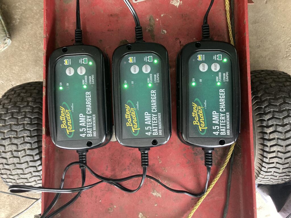

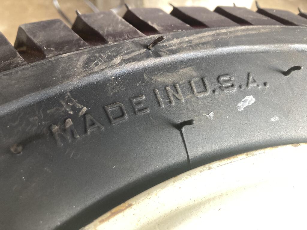

SylvanLakeWH 32,722 #69 Posted March 15, 2022 (edited) Started fixin up the E 141 with a bit of warm weather. Ordered new shoes - Carlisle Turfsavers all around… Existing are holding air but pretty severe cracking… Don’t need a high speed blow out pulling the train…! Installed the battery chargers / floaters… Went with three separate 12 volt chargers for two reasons. 1) Existing batteries are all different. Individual chargers insure good charge for each. 2) Cost. They are working well. I may not need to flip for batteries this year. We’ll see… Edited March 17, 2022 by SylvanLakeWH 3 1 Share this post Link to post Share on other sites

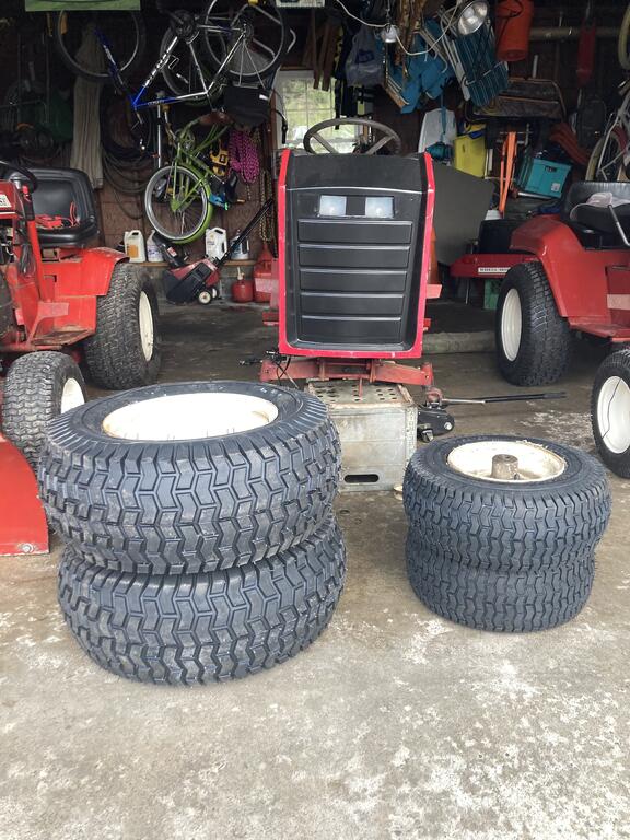

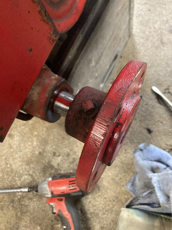

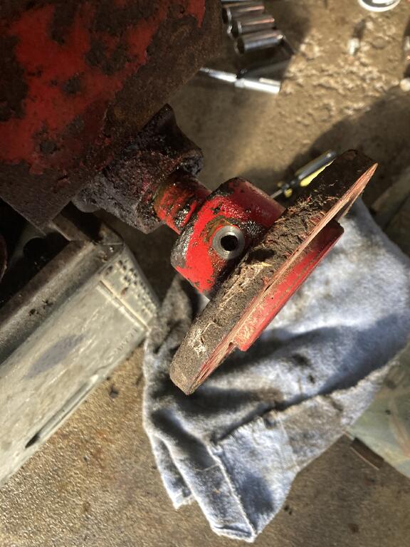

SylvanLakeWH 32,722 #70 Posted March 17, 2022 New shoes today… Carlisle Turf Savers - Made in USA…! Then noticed right rear hub was in about 1”… hhhmmm. Loose set screw. Hub came off by hand!!! Now I know why I don’t use lift assistance for my plow blade… After a winter of plowing with a manual lift I can take hubs off by hand!!! Fixed and torqued… Oh… the other one is soaking… 5 3 Share this post Link to post Share on other sites
ebinmaine 80,999 #71 Posted March 17, 2022 Are the tires still being made in the USA or are those old stock? Did you replace the set screw(s)? 1 Share this post Link to post Share on other sites
SylvanLakeWH 32,722 #72 Posted March 17, 2022 Don’t know if NOS… they seem very “fresh” but I don’t know. I do know Carlisle makes Tires in China, as I did a thread on the size difference between USA (bigger) and Chinese… I did not replace set screw. I cleaned it up and torqued it back in place… 2 Share this post Link to post Share on other sites
ebinmaine 80,999 #73 Posted March 17, 2022 If that set screw has only been tightened up once or twice in the past and not overdone, you should be fine. Might want to make a note somewhere to re-torque it after 30 or 60 minutes of use. 2 1 Share this post Link to post Share on other sites

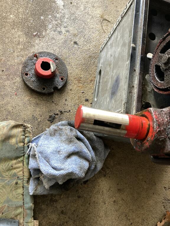

SylvanLakeWH 32,722 #74 Posted March 17, 2022 Irish eyes were smiling on me today… the second hub slid right off by hand with one night of PB soaking… May be a new name in my future… The Hub Whisperer… Never replaced an axle seal or brake shaft on a WH… done a few on motorcycles… tricks on removal and replacement? 3 Share this post Link to post Share on other sites
ebinmaine 80,999 #75 Posted March 17, 2022 3 minutes ago, SylvanLakeWH said: axle seal or brake shaft on a WH… done a few on motorcycles… tricks on removal and replacement? Get you some crokus cloth and clean that shaft up real well. De-burr the keyway groove. I use a small sharp flat screwdriver to drive the seal around the shaft a bit then it just keeps circling and comes out. Some find it easier to use a screw (into the metal of the seal) and pliers to pull the old seal. I've done both. Clean the seat where the seal rests. Likely all gunky. Now's the time to take a good look at the bearing. To reinstall lotsa folks recommend taping the keyway groove to protect the seal from the sharp edges. I don't. That's the reason I smooth it out with sand paper. Oil the seal. Carefully slide it into place. It'll likely be a little tough to start on. I usually use the hub as the driver for the seal. Sets them right in nice and flush and straight. 1 2 Share this post Link to post Share on other sites
