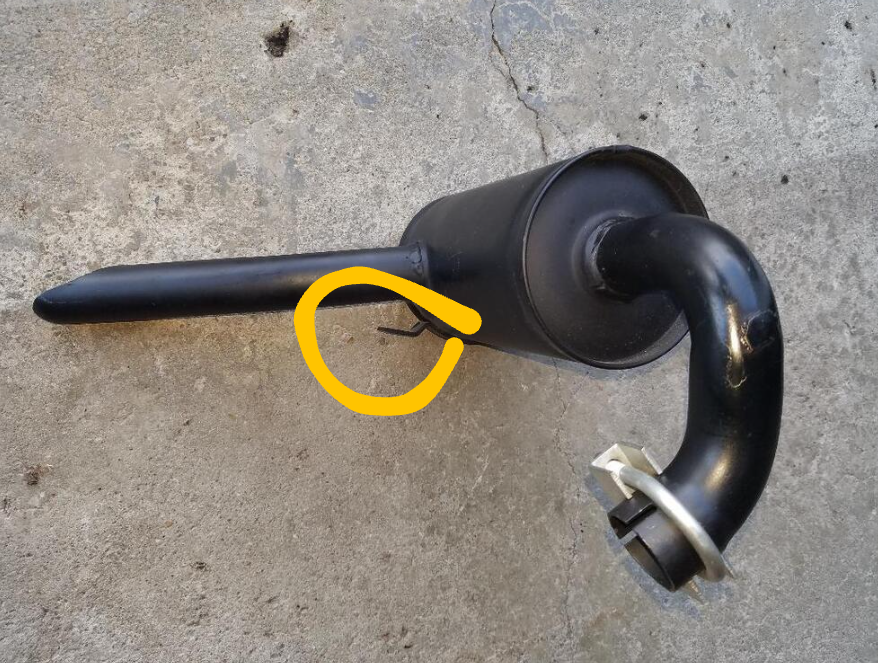

Brockport Bill 2,478 #1 Posted October 31, 2021 Can anyone identify what model WH tractors this exhaust muffler would go onto? It is close to what would be on C175 but top neck has a curve..... the C175 Kohler 17 twin is straight at the top connection? Any help ? thanks Share this post Link to post Share on other sites
roadapples 6,987 #2 Posted October 31, 2021 Looks to big in diameter for anything but a black hood... 1 Share this post Link to post Share on other sites
Bill D 3,158 #3 Posted October 31, 2021 K series exhaust. 3 Share this post Link to post Share on other sites

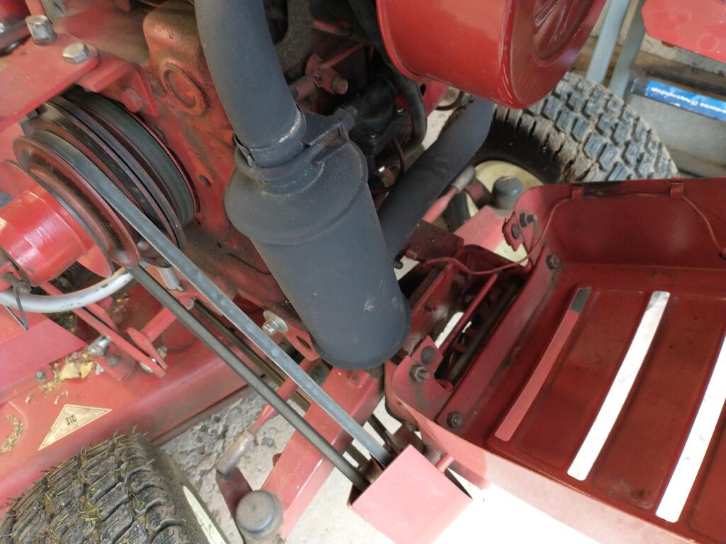

Maxwell-8 4,371 #4 Posted October 31, 2021 (edited) My raider as one similair on the M12. Don't know if a M16 has a bigger exhaust but looks in size to be like an M16 exaust M16 2pics of my raider, sorry I don't have a better pic of the exaust Edited October 31, 2021 by Maxwell-8 2 Share this post Link to post Share on other sites

pfrederi 21,183 #11 Posted October 31, 2021 31 minutes ago, clueless said: Big block K- series. Bent to fit the angled exhaust port on big blocks...K181 needs more bends at eh top as exhaust port is at right angle to the engine. 2 Share this post Link to post Share on other sites

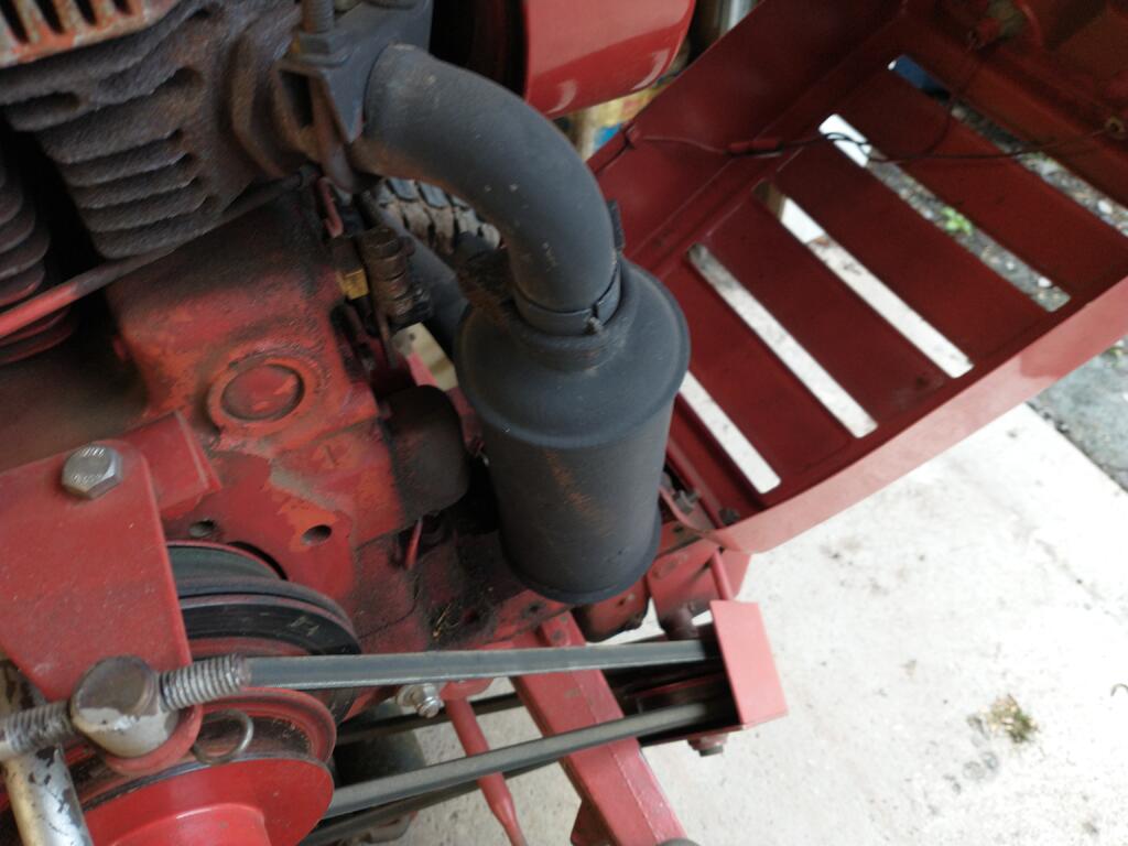

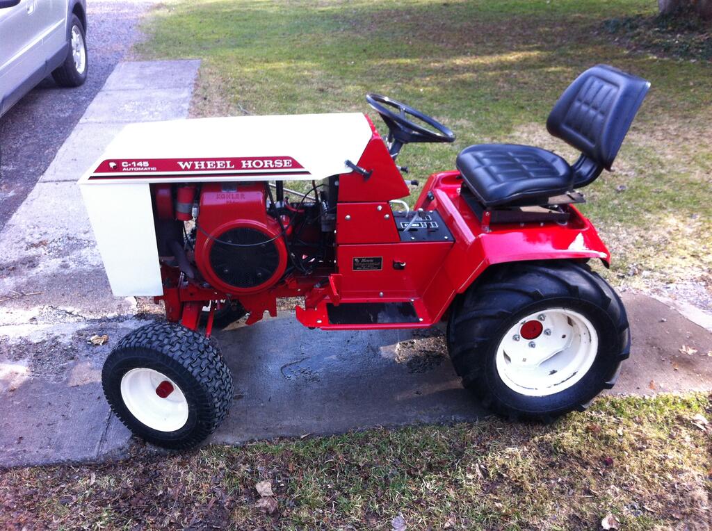

squonk 48,157 #12 Posted October 31, 2021 (edited) With that extra bend and larger can, I think it's a C-125,145 muffler. C160 Muffler looks like this: Look at this pic of the C-145 I had. You can see how "forward " the muffler is and can see the bigger can. Edited October 31, 2021 by squonk 4 Share this post Link to post Share on other sites
rmaynard 17,589 #13 Posted October 31, 2021 Notice the little mounting tab at the bottom. That is for attaching the bottom to the shaker cradle of a 1978 and later C-series so the muffler wouldn't shake loose. All replacement mufflers made after 1978 had the tab, even for the non-shaker models. 5 1 Share this post Link to post Share on other sites

clueless 3,439 #15 Posted October 31, 2021 Yes it is for a big block K with the shaker cradle thus the bolt tab, but it will work with the earlier BB K's with a little tweaking Share this post Link to post Share on other sites
