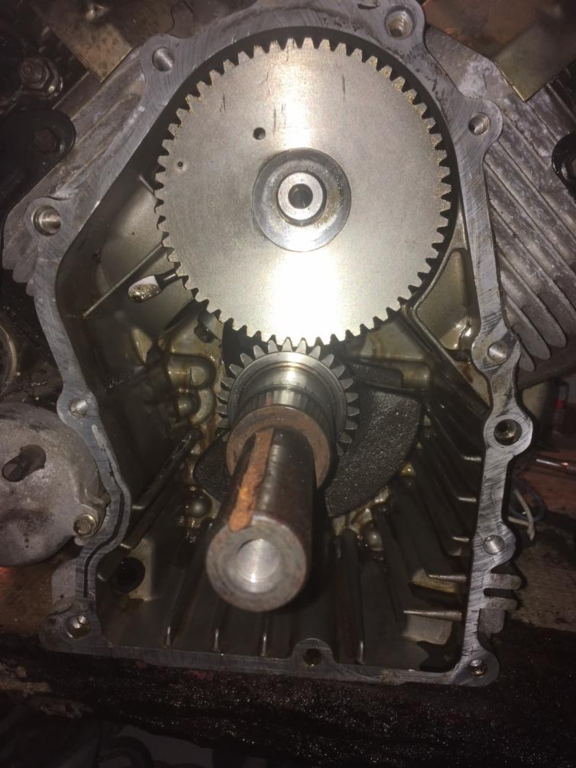

Snoopy11 5,718 #4 Posted October 23, 2021 In my experience... flipping this engine on its side would orient the cam above the crankshaft. I know that @kpinnc is one guy who did this... possibly successfully? However, the cam will not get lubricated properly. As far as I know... the Kohler 16 is pressure lubricated... so no issues on the crankshaft journal / rod. However, it is paramount that the cam and followers get lubricated properly... If you did this, your engine would look something like this (note the cam above the crank): I'm not saying that this wouldn't run... because it would. But, for how long? If you decided to do this, I would use some oil with VERY high ZDDP content. This is the only hope for the cam lobes and cam followers. Some guys I know did this, but they used a scavenging pump to get oil from the "oil pan," tap a hole in the block, and shoot it across the cam lobes. Might be something for you to consider. Other points of consideration... cam end lubrication. Neither ends of the cam, either flywheel side, or cover side are going to get enough oil. The crankshaft bearings should get enough oil... but no guarantee. You cam ends are very high in the engine... if tilted horizontally... Again, anything can be done... but how long it lasts... no one can tell you. Don 1 Share this post Link to post Share on other sites

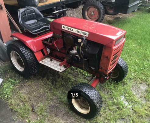

Maxwell-8 4,367 #10 Posted October 24, 2021 @520hC-120PLus a Kohler command would be hard to fit: do it being OHV I bought this horse, dude had to elevate the hood and put it longitudinal 1 Share this post Link to post Share on other sites
