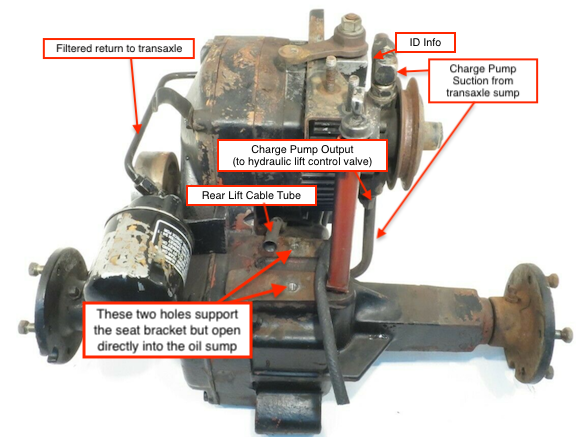

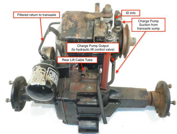

davem1111 2,274 #5 Posted October 19, 2021 13 hours ago, Handy Don said: Hmmm. Experts? For the most part we are just folks with experience that we're willing to share. Well, to me, that's what an expert is. 13 hours ago, Handy Don said: The usage you describe is well within the normal capabilities of the Eaton 700. You must find the source of the leak to have full information for making a decision to save this pump/motor. Now that I've taken the wheel off and cleared a lot of greasy crud, I can see that the plastic reverse-threaded plug on the bottom of the pump was leaking. I tightened it gently and it may have stopped, will check again later. Might not matter now if the pump is shot though. 13 hours ago, Handy Don said: I don't understand " I have temporarily repurposed the oil reservoir as a "mini gas tank" so I can run the tractor if I want to try anything". This component MUST be left attached to the transmission pump/motor assembly. It is an expansion tank that holds the oil that expands out of the pump/motor when it gets hot. If it was not properly connected before, that could be the source of the leakage and it may have allowed contaminants into the pump/motor (contaminants are a serious problem). When the transmission is cold, the reservoir should show about ⅓ full. If you filled it at that point, then when the oil heated up it simply overflowed the reservoir and that could also be your "leak". So, I had removed the fender & gas tank, and the oil reservoir. Then I thought, what if I want to run the engine a bit at some point to see what happens? No gas tank.... hmmm... oil reservoir has the same size tube fitting... I may have wrongly assumed that not having the reservoir on there for a minute or two (because I was using it as a temporary gas tank ) would be okay. If I put the reservoir back on and the pump is no longer leaking from the bottom, and the reservoir stays full, is it safe to assume that the pump has the proper amount of oil in it? Should I completely drain and refill it to be sure? 13 hours ago, Handy Don said: The transmission's ill behavior is a bad sign--likely causes are low or contaminated oil that permitted excess wear of pump/motor components. These operate at extremely close tolerances. After dealing with the pump oil and reservoir as mentioned above, if it is still slipping, then I probably need to replace the pump, right? 13 hours ago, Handy Don said: Now, on to your options: - A used 700 pump motor. The 700 remains practical for your level of usage (unless the blade work requires a lot of power). It is a pretty straightforward swap if you have decent tools and some mechanical proficiency once you remove the fuel tank and seat supports. The 30-day return does require removing it again and a second shipping cost, so its not free. Frankly, $250 seems very high for just a 700 pump/motor, though. I thought the 700 was "enough" but maybe not. I'm liking your next suggestion: 13 hours ago, Handy Don said: - A used 1100 transaxle. Firstly, the 1100 is a much stronger transmission used with engines up to 20hp. It is more than adequate for your described usage. It is, however, a more involved and complicated swap since it affects the drive belt, brakes, wheels, and hydraulic plumbing plus its connection to the motion control is different. You'd be taking essentially all of the rear end of the tractor apart and then reassembling it. And an 1100/transaxle is heavy--well over 100 lbs. Also, the value of the unit on offer depends a great deal on how it's been treated and how complete it is because there are parts used by an 1100 that aren't on 700 so you won't have them from your tractor if they are missing. These are primarily an oil filter, its mount and plumbing, and the plumbing for a hydraulic lift. If it comes with the filter holder already mounted, and all the plumbing but you are not going to use the hydraulic lift capability, then you will also need to acquire and install a non-standard piece of hydraulic hose or tubing to connect the charge pump output to the filter inlet. Is this one I'm looking at an 1100? It has an oil filter. Again, this is what the seller is calling it: "OEM Toro COMPLETE HYDRO TRANSMISSION 108368 108369 fit Work Horse D1-184801 1848" If this will fit my tractor and is an upgrade (assuming it is in good working condition), then I'm leaning toward getting this (and repainting it in red, of course ). Should I ask the seller for the numbers off the pump itself? I am assuming that the part just inside the pulley is for external hydraulics - do you know if that is a problem if *not* hooked to something? Can I retrofit my 312-A with a hydraulic lift? BTW, I've been looking at this forum for a while, since I got the tractor and started having repair/maintenance questions. Thank you for all the useful info. Hoping I can return the favor somehow. I actually have more experience working on bigger tractors, like Ford 8n/9n/Jubilee, 6000 diesel or John Deere 1070 diesel. And a lot of motorcycles, cars & trucks. Share this post Link to post Share on other sites
Handy Don 16,286 #6 Posted October 19, 2021 (edited) Lots of questions here! On the current 700: - I can't tell from a distance so it's on you to decide: Did that loose connection or when you had the reservoir off let the 700 run without enough oil due to leakage for a long time or did it permit contaminants to enter? There is no practical way to change the oil in a 700 except by removing it from the tractor--it was intended as a lifetime closed system. - One potential diagnostic: If the system is back together enough, fill the 700 via the reservoir up to having the oil just come into the bottom of the reservoir (you may have to do this a second time after running the pump/motor briefly to be sure any trapped air in there has a chance to come out). Run the tractor enough to get the pump/motor really warm (idling will not do it, it has to have a load). The oil should rise in the reservoir due to expansion up to maybe ½ or ⅔ of the tank. First, observe its performance. Second, immediately swab out a sample of the oil from the reservoir and spread it on a clean piece of white paper. You are looking for metal particles or other debris which indicates excess internal wear. If performance is now OK and no particles or debris in the oil, no need to go further, keep the 700. On the 1100: - Yes, that is an 1100. It is black because it was in a Wheel Horse "economy line" Work Horse (I'm not at all familiar with those tractors, but other members are). From what I recall, the transaxles and pump/motor were the same across both lines--I don't know if Work Horses used hydraulic lifts but I would assume yes given that they had the 1100. - I'd want the info on the pump's ID plate (1100's had a number of models over the years with some nice improvements). The oil filter and mount are there as is at least some of the critical plumbing (not sure about that piece of fuel line next to the bottom of the dipstick tube ). Also, at least from here it seems like the axle oil seals are not leaking. The tube for the rear lift cable is there but without its clamp. - What you cannot see, and is to me important, is the condition of the oil. In an 1100, the oil does three things: it bathes the transaxle gears and differential, it flows through the motion pump/motor, and it circulates out to the hydraulic lift cylinder. The transaxle can stand some abuse, but the hydro pump/motor is sensitive to rust or other contamination. It becomes a question of provenance of the unit and trust in the seller--especially if you cannot examine it first hand. Some questions I'd ask: How many hours on this unit? How was it used and stored while part of the tractor? How long has this unit had its filter input line disconnected? When the charge pump output plugged? How was it stored since being removed (has moisture had a chance to enter? - Yes, the section just inside the drive pulley is the charge pump (up to 700psi at 1.3 gpm, requires external pressure relief--WH control valves used with this pump had built in pressure relief). - Yes, an 1100 can work with or without an external hydraulic lift with the right plumbing connections. - Yes, you could retrofit your tractor with a hydraulic lift, but it is not a trivial exercise--it goes to the very center of a 300-series tractor's assembly (I posted some of the issues in a different context in this thread). Edited October 19, 2021 by Handy Don 1 Share this post Link to post Share on other sites

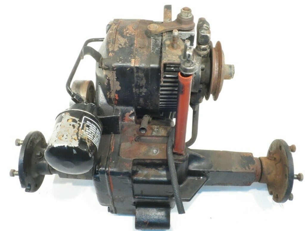

kpinnc 17,931 #12 Posted October 20, 2021 (edited) Just my opinion... Anytime you buy a used hydro, it's a game of chance. Even a test drive requires 30 mins to allow the fluid to warm up. And if you have to open a pump (transmission), one grain of dirt can quickly destroy it. So- the 700 is easiest and safest IF it is in good shape. BTW, they cost about $800-1200 new back when they were produced. $250 is alot, but the warranty is definitely something to consider. Since it has an enclosed system that can't be contaminated by the trans oil, it is a safer option to swap out. That being said, the 1100 Eaton is hands down a far better system. The fact that the one in the pic is missing the bolts on top is a concern, because it shares the oil from the gearbox, and is likely now contaminated. It might be great for several hours of operation, or may be good for years. Again, it's a gamble. Also, the leak on the bottom of the tranny is likely a weeping axle seal. Edited October 20, 2021 by kpinnc Share this post Link to post Share on other sites
Handy Don 16,286 #13 Posted October 20, 2021 11 hours ago, kpinnc said: the one in the pic is missing the bolts on top is a concern Nice catch, @kpinnc. I didn't notice those. I was focussed on seeing if the hoses were intact. I should also add, that $250 might buy a parts tractor where the engine or other parts are missing/damaged but the Eaton 1100 is "unopened". That's how I got mine--a PO took the engine to replace one blown in a puller tractor, sold off some of the other parts and I bought the rest as a "roller". Knowing the hours, usage, and maintenance history plus having the complete hydro system still sealed made it less risk for me as a purchaser. 1 Share this post Link to post Share on other sites

Handy Don 16,286 #16 Posted October 21, 2021 6 minutes ago, davem1111 said: I've been scraping and brushing crud and dirt all over that. Are the casings for the hydraulic pump and the axle completely isolated from each other? How does one know if the hydraulic pump has the proper amount of oil in it - is it assumed that if there is any oil in the reservoir, that the pump is full? Someone mentioned it possibly having air in it. I'm thinking I'll just need to put it back together and run it around to see what happens. But in the meantime I'm probably buying the 1100 tranny, and also looking at a 416-8 that I might be able to pick up for around $300. Oh, and I realized recently that I was finding pieces of my PTO clutch plate on the ground in the yard. Guess I need to replace that too. Thanks for all the help! Will post follow-up and maybe some pics. Ok, on the subjects of oil and casings.... On the the 700 pump/motor and the transaxle do not share oil. 700 is self-contained with Reservoir as the access/level-if you cannot see oil in the reservoir, the level is too low and there might be air in the pump. A few minutes running when there is oil in the reservoir will permit air to escape. Dipstick is for the transaxle only. (1100 shares oil, as noted earlier.) On crud scraping... Could be worse, since you've likely introduced crap into ONLY your transaxle by leaving those holes open (though I still worry about when you had the reservoir off the 700). A transaxle teardown probably isn't necessary, but do plan on changing that oil soon following the instructions in the owner manual. Ideally, you'd give it a flush with a quart or two of diesel before filling with new oil. There are several entertaining threads discussing how to fill the transaxle through that narrow dipstick tube -- you can search and read! On testing... Jacking the rear to test the hydro is ideal for "is it alive" testing and for adjusting the motion control so that neutral on the lever is neutral on the hydro. It is NOT adequate for putting enough load on the hydro to really warm it up or to see if its speed and power are correct. Driving around for several minutes (seat time!) will warm it up and let you check for speed in both directions. As for power, WH suggests putting the front wheels against an immovable object and then gently putting motion control into forward--one or both wheels should spin even on a dry surface. FWIW, to me an 1100 into the 312 makes sense for motion if the 700 is really dead, the tractor is otherwise in great shape, and the cost of the new transaxle is comfortable ($250 being out of my comfort range). The 416-8 is a nice machine. Understand that some years had a one-cylinder Kohler and others had a two-cylinder Onan -- look closely if this matters to you. Onan vs. Kohler is a busy topic on the forum ! 1 Share this post Link to post Share on other sites
