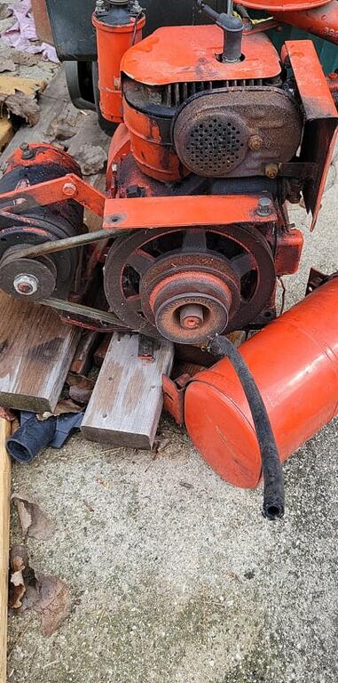

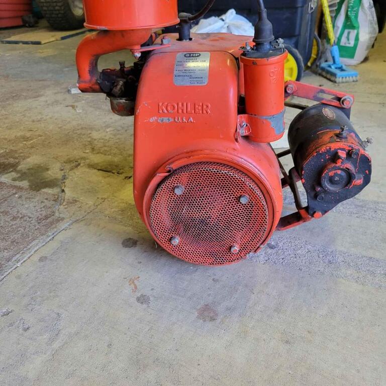

Gregor 4,848 #1 Posted October 8, 2021 I have a chance to buy this K181, spec # 30109. Was the S/G added at a later date, on the PTO side? If I could find the parts for the flywheel, could I turn it around to the flywheel side? Share this post Link to post Share on other sites
Mike'sHorseBarn 3,605 #2 Posted October 8, 2021 You would need a different starter generator because if you turn it around it would be spinning the wrong way. 1 1 Share this post Link to post Share on other sites
pfrederi 20,885 #3 Posted October 8, 2021 Cubs and others ran the S/G off the pto side. That would be counterclockwise rotation I am not sure how you would have to modify the Genny to get it to go clockwise 1 Share this post Link to post Share on other sites
Handy Don 16,963 #4 Posted October 8, 2021 21 minutes ago, Gregor said: If I could find the parts for the flywheel, could I turn it around to the flywheel side? I think I recall @squonk mentioned that some can be rewired to work in the other direction without much difficulty. Probably depends on the model of S/G. Share this post Link to post Share on other sites
Gregor 4,848 #5 Posted October 8, 2021 I'll just hook it up backwards. 1 Share this post Link to post Share on other sites
Handy Don 16,963 #6 Posted October 8, 2021 Just now, Gregor said: I'll just hook it up backwards. Or twist the belt into a figure eight? Share this post Link to post Share on other sites
Gregor 4,848 #7 Posted October 8, 2021 1 minute ago, Handy Don said: Or twist the belt into a figure eight? Or use gears Share this post Link to post Share on other sites
stevasaurus 23,746 #8 Posted October 8, 2021 You have to change the field coils inside to change the clock wise direction to C-CW. It's all about the field coils. The guys are right, that is probably for a Cub Cadet. There should be a CW or a C-CW stamped on the bottom plate. That should have a CW. Nothing wrong with the engine...they turn the same way whether they are Cub or WH. 2 Share this post Link to post Share on other sites
Gregor 4,848 #9 Posted October 8, 2021 If I do end up with the motor, hopefully between @lincoln, @richmondred01, @76c12091520h, and possibly some others, I can find the parts to make it right. Even if I don't, it's OK, I really don't have a use for it right now, but it's hard to pass up for $25. Share this post Link to post Share on other sites
Snoopy11 5,731 #10 Posted October 8, 2021 (edited) That starts me thinking... along the lines of what @Gregor said here... about gears. If you could afford them... But... I am more like this guy: 1 hour ago, Handy Don said: Or twist the belt into a figure eight? You realize that there is actually a website that literally talks about that... Here is the website: https://technologystudent.com/gears1/pulley5.htm#:~:text=Sometimes it is necessary to,shown in the diagram above. Don Edited October 8, 2021 by Snoopy11 1 1 Share this post Link to post Share on other sites
squonk 47,421 #11 Posted October 8, 2021 The gen is a DC motor. Polarity needs to be reversed (I. E. different coils) Also the brushes and holders are designed for a certain rotation. You would probably need different holders and flip the brushes. Share this post Link to post Share on other sites
Gregor 4,848 #12 Posted October 8, 2021 1 hour ago, squonk said: The gen is a DC motor. Polarity needs to be reversed (I. E. different coils) Also the brushes and holders are designed for a certain rotation. You would probably need different holders and flip the brushes. Probably easier to get another S/G 1 Share this post Link to post Share on other sites
stevasaurus 23,746 #13 Posted October 9, 2021 Or, go to a show and buy one from a vender that is correct and sell the $25 one to a cub guy. Share this post Link to post Share on other sites
