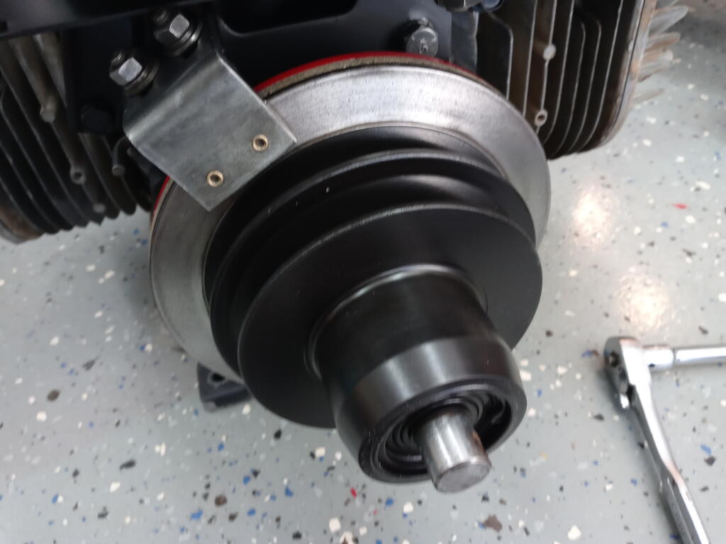

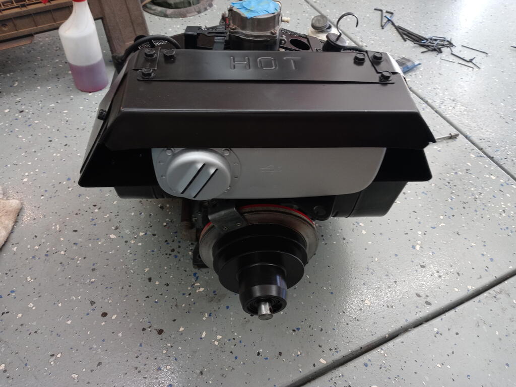

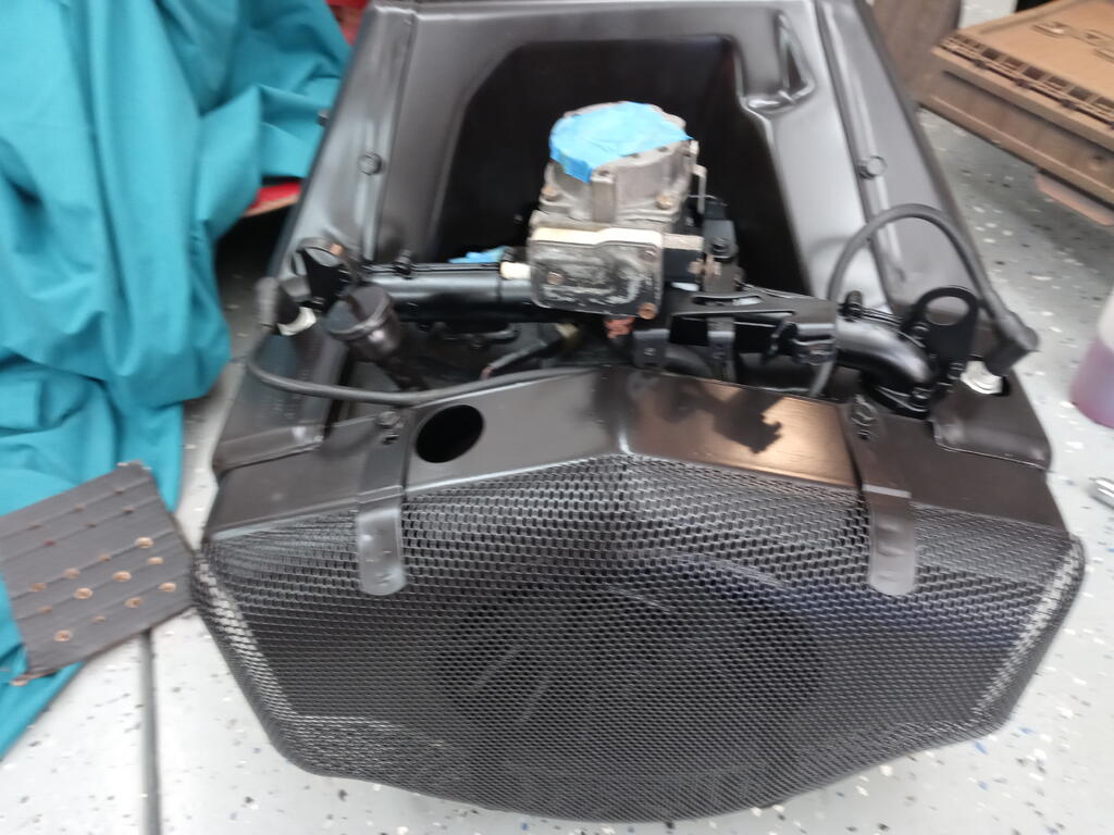

Horse Newbie 7,404 #203 Posted October 31, 2021 Got the engine tins and PTO back on the Briggs. 4 Share this post Link to post Share on other sites

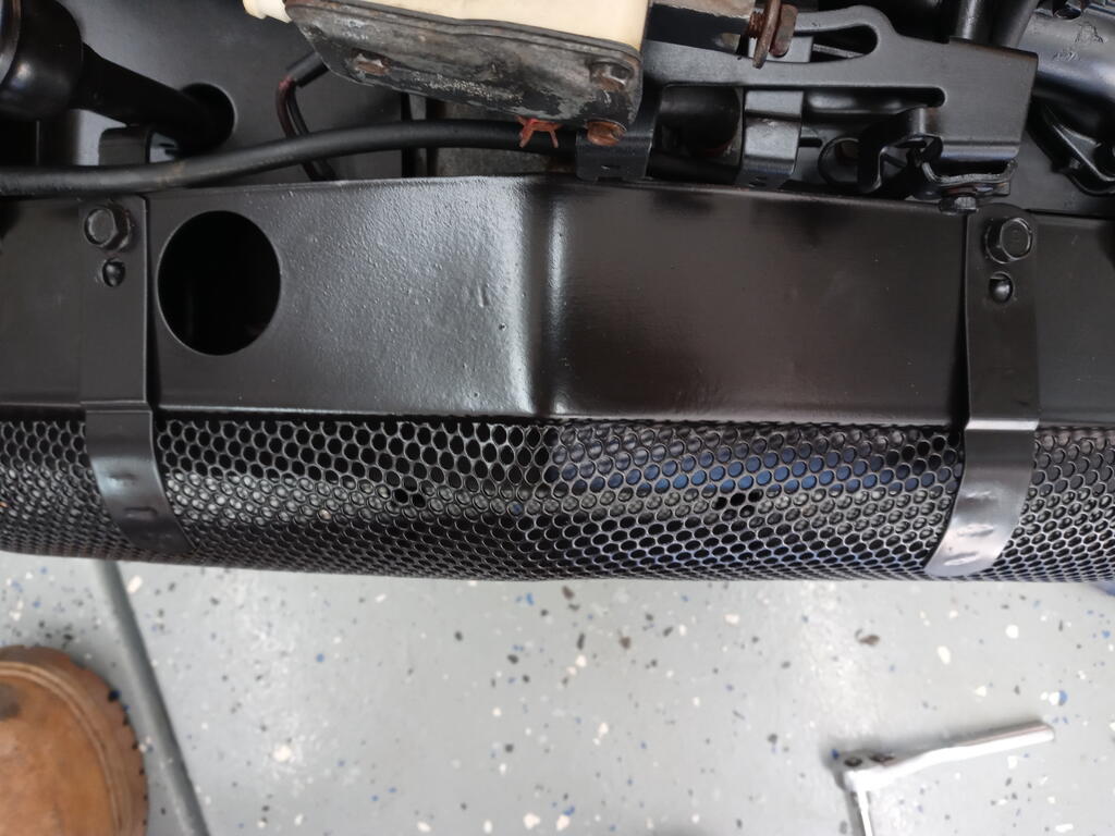

Horse Newbie 7,404 #204 Posted October 31, 2021 The chaff screen was on farther than I put it back...it has 2 sets of holes...in the farthest in position it was scratching the tins... 1 Share this post Link to post Share on other sites

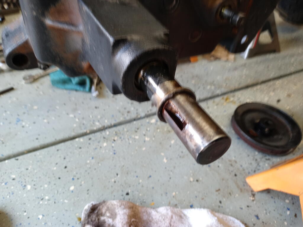

Horse Newbie 7,404 #205 Posted October 31, 2021 Got the input shaft seal and the right axle seal fished out... Share this post Link to post Share on other sites

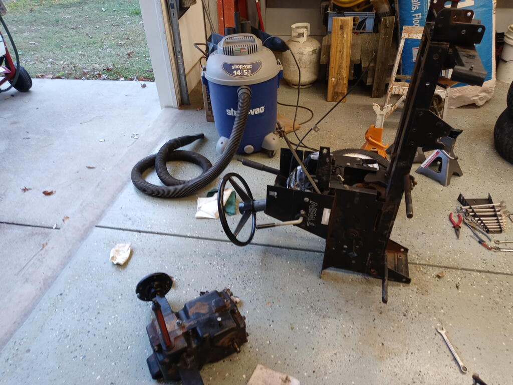

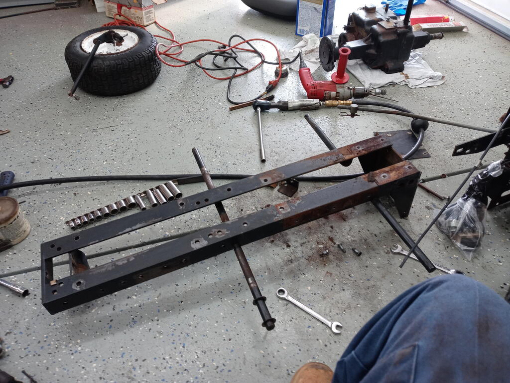

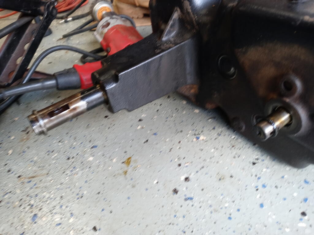

Horse Newbie 7,404 #207 Posted October 31, 2021 Wire brushing the frame under neath and where the transmission bolts to the frame. I WAS NOT planning on all this... Check out this steering linkage repair... 1 Share this post Link to post Share on other sites

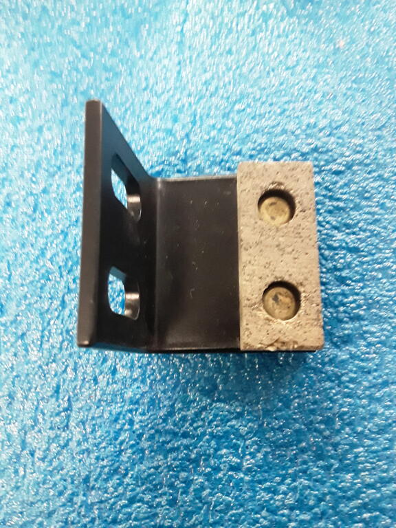

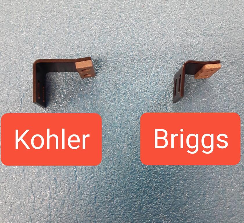

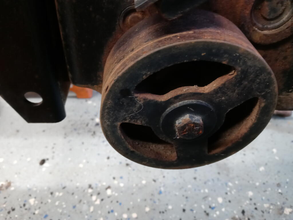

Horse Newbie 7,404 #208 Posted October 31, 2021 Do any of you know if anybody on Red Square sells the PTO brake pad bracket ? I replaced my clutch disc because it was almost worn to the rivet heads and the PTO brake pad is almost to the rivets as well. Share this post Link to post Share on other sites
76c12091520h 4,148 #209 Posted November 1, 2021 30 minutes ago, Horse Newbie said: Do any of you know if anybody on Red Square sells the PTO brake pad bracket ? I replaced my clutch disc because it was almost worn to the rivet heads and the PTO brake pad is almost to the rivets as well. Should've got one with the PTO disc and got our discounted price (see the listing on my vendor page for more info ) Share this post Link to post Share on other sites
Horse Newbie 7,404 #210 Posted November 1, 2021 (edited) @76c12091520h I see you have them for Kohler and Onans... I need one for a Briggs twin... Would one of the Kohler or Onans be the same as Briggs ? I checked your vendor ad...only mentioned Kohler and Onans... Edited November 1, 2021 by Horse Newbie Share this post Link to post Share on other sites
76c12091520h 4,148 #211 Posted November 1, 2021 29 minutes ago, Horse Newbie said: @76c12091520h I see you have them for Kohler and Onans... I need one for a Briggs twin... Would one of the Kohler or Onans be the same as Briggs ? I checked your vendor ad...only mentioned Kohler and Onans... My bad, forgot what we were working on . But yes we have them too discontinued by Toro, they are also listed on our vendor page. Sorry for the mix-up. Share this post Link to post Share on other sites
Horse Newbie 7,404 #212 Posted November 1, 2021 (edited) @76c12091520h...I couldn't see them on you vendor site ...must be tripping...send a link/ invoice to me PM, or email and I will pay it. Thanks! Edited November 1, 2021 by Horse Newbie Share this post Link to post Share on other sites

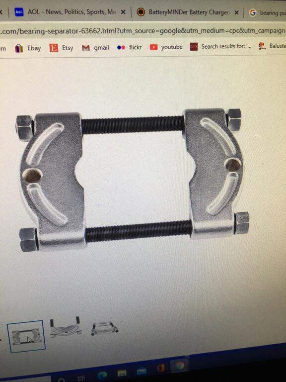

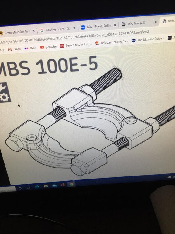

Horse Newbie 7,404 #213 Posted November 1, 2021 Still have one hub, and the brake drum to pull...my welder friend has on of these, and he said that should do it... 2 Share this post Link to post Share on other sites

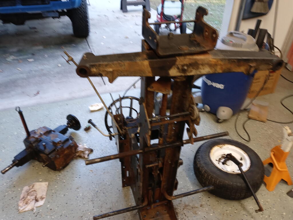

Horse Newbie 7,404 #214 Posted November 1, 2021 @ebinmaine... Right after my first post on this topic you were asking how far I was going to disassemble...well I was not gonna do this... I got carried away ! 3 Share this post Link to post Share on other sites
ebinmaine 78,632 #215 Posted November 1, 2021 11 minutes ago, Horse Newbie said: @ebinmaine... Right after my first post on this topic you were asking how far I was going to disassemble...well I was not gonna do this... I got carried away ! Hahahahaha. Excellent. There's certainly something to be said about a good full frame off every single nut and bolt restoration!!! 1 Share this post Link to post Share on other sites

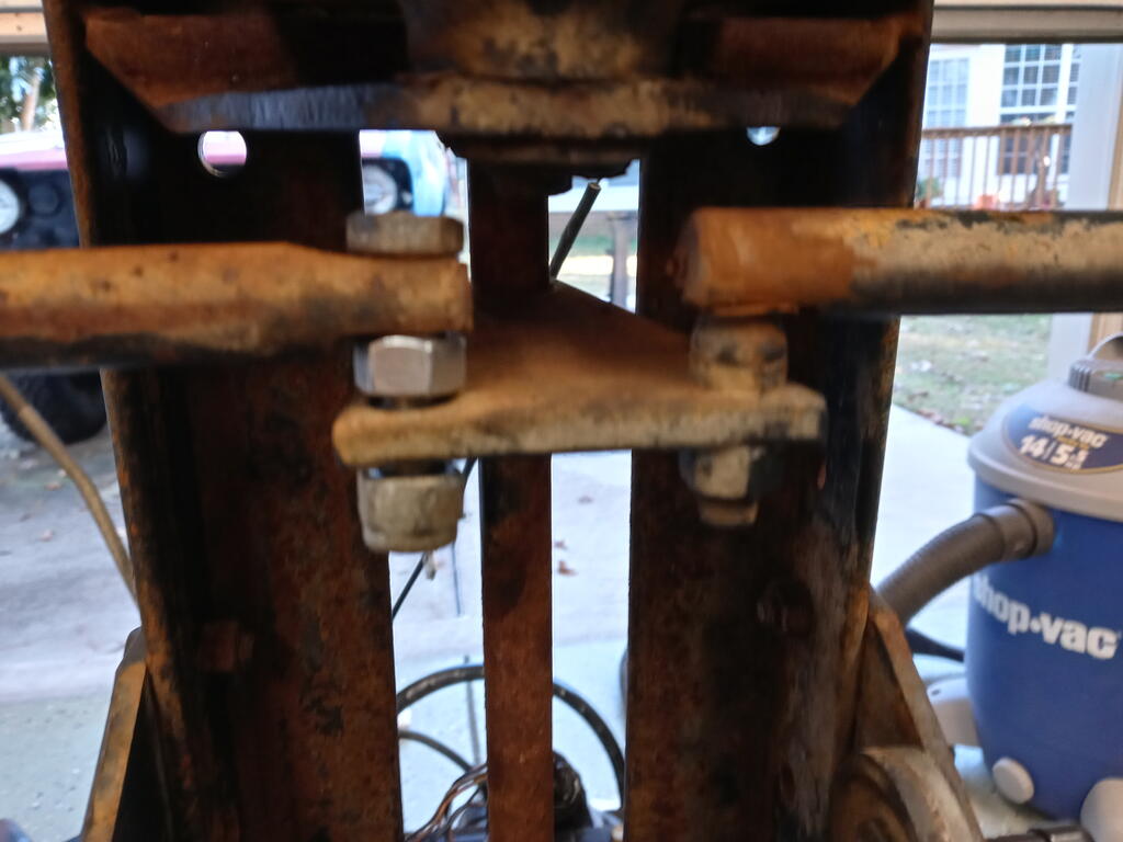

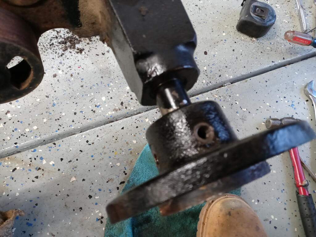

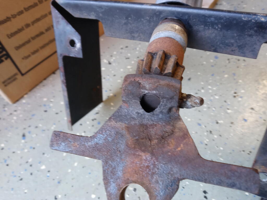

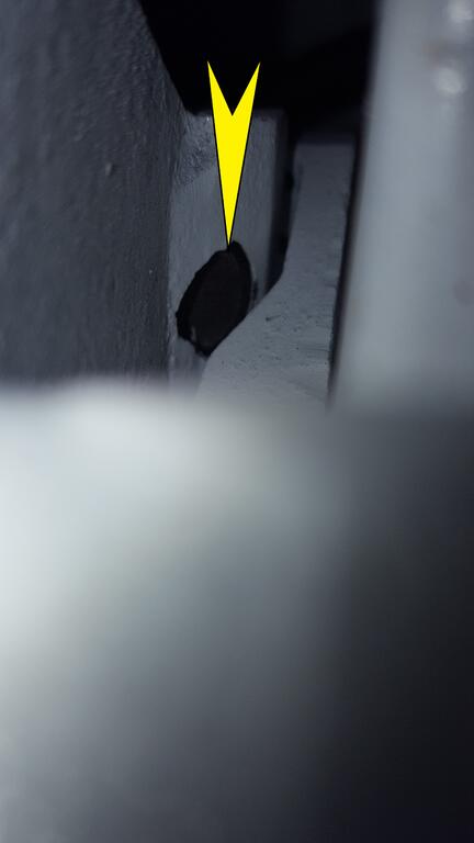

Horse Newbie 7,404 #217 Posted November 1, 2021 Is this supposed to have a hole in the bottom ? Share this post Link to post Share on other sites
Moparfanforever 930 #218 Posted November 1, 2021 5 hours ago, Horse Newbie said: @ebinmaine... Right after my first post on this topic you were asking how far I was going to disassemble...well I was not gonna do this... I got carried away ! Don't feel bad , a lot of us have said and done the same thing !! 3 2 Share this post Link to post Share on other sites
Handy Don 16,475 #219 Posted November 2, 2021 (edited) 3 hours ago, Horse Newbie said: Is this supposed to have a hole in the bottom ? I'm thinking maybe yes, but I've never disassembled the steering block to remove a fan gear. It'd serve to lube the fan pivot and lower face below the gear teeth, as well as the steering shaft pivot, right? Edited November 2, 2021 by Handy Don 1 Share this post Link to post Share on other sites
Horse Newbie 7,404 #220 Posted November 2, 2021 Thanks @Handy Don...I need to investigate it further. Share this post Link to post Share on other sites

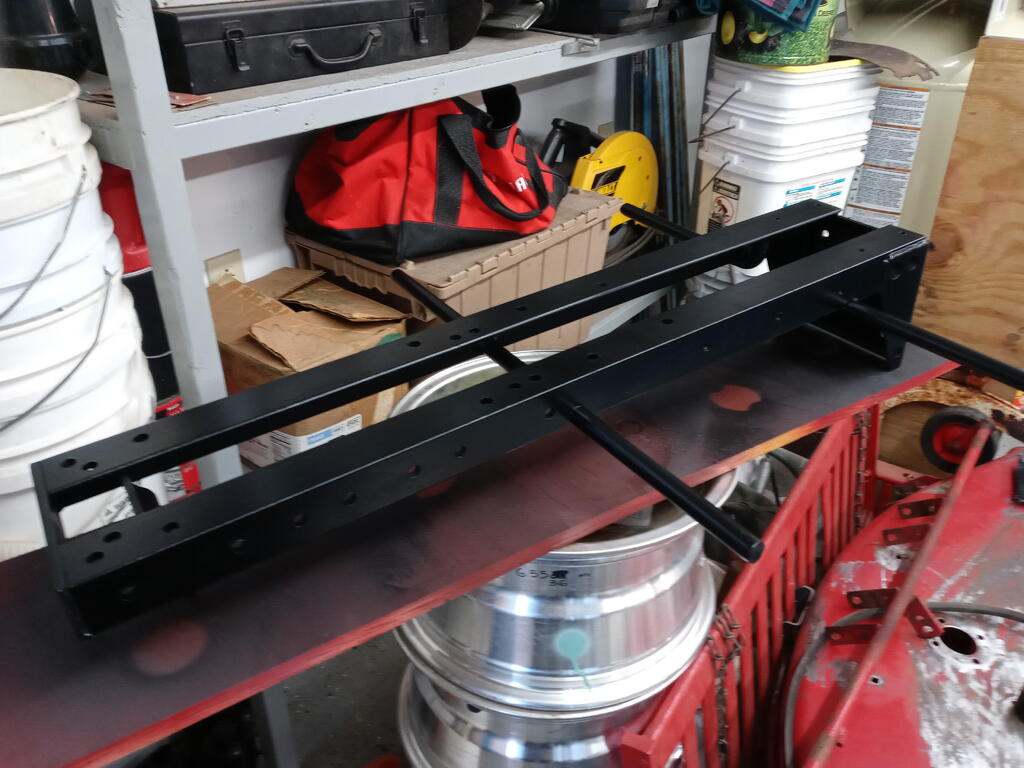

Horse Newbie 7,404 #221 Posted November 2, 2021 I got the frame painted Rustoleum Satin Black... Share this post Link to post Share on other sites

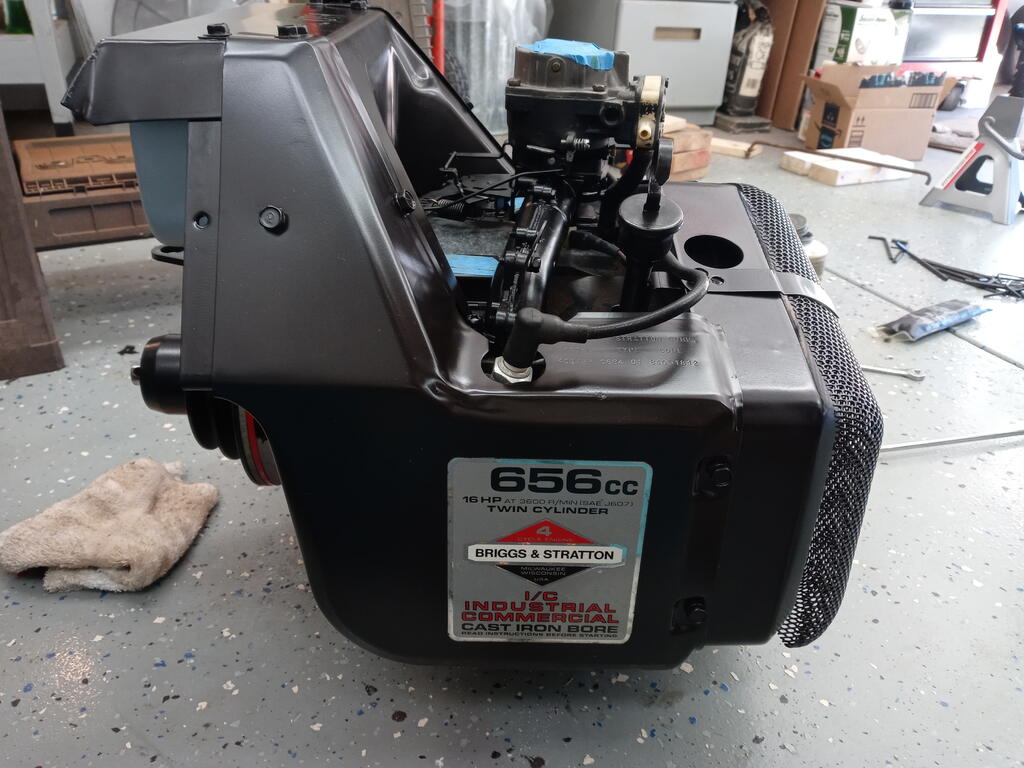

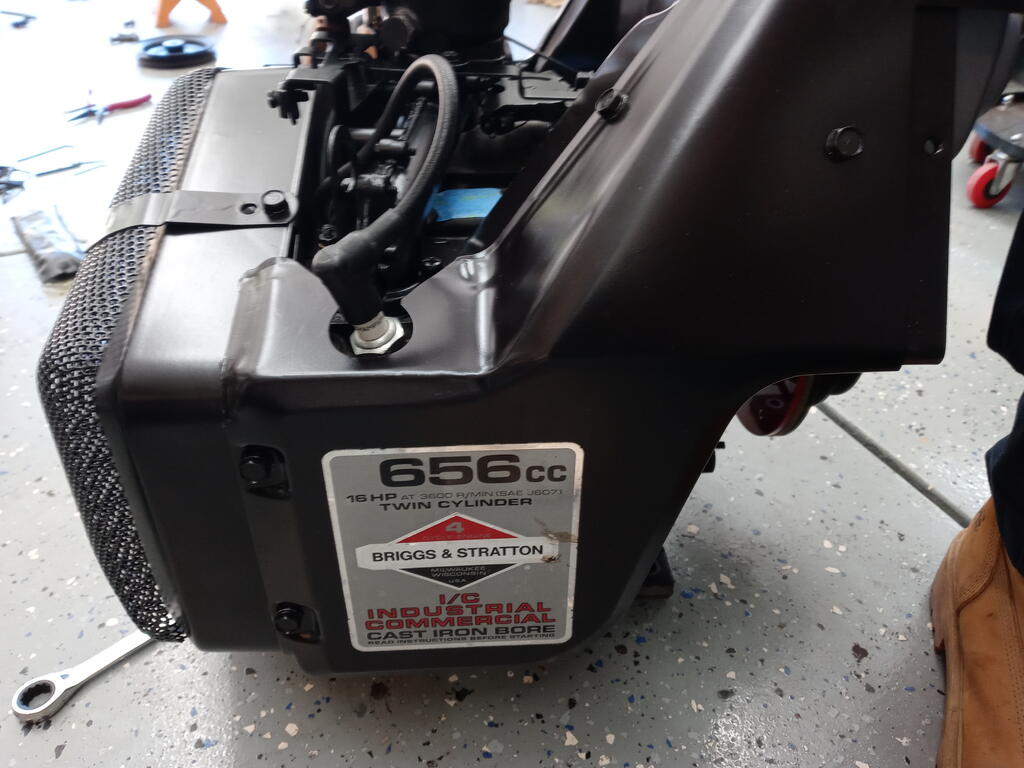

Gregor 4,848 #222 Posted November 2, 2021 (edited) 5 hours ago, Horse Newbie said: Is this supposed to have a hole in the bottom ? Mine does. Underneath my 656 Edited November 2, 2021 by Gregor 1 Share this post Link to post Share on other sites
Horse Newbie 7,404 #223 Posted November 2, 2021 3 minutes ago, Gregor said: Mine does. Thanks @Gregor...it's got a grease zert that goes to the area that has the hole in the bottom. I thought for a second that the steering column shaft had worn through... It was dry, but did not have a lot of wear... I'm moving forward with it ! Share this post Link to post Share on other sites
Horse Newbie 7,404 #224 Posted November 2, 2021 10 minutes ago, Gregor said: Mine does. Underneath my 656 @Gregor...man you are awesome with your help ! When I first responded to "Mine does", the pic had not loaded ( my phones about shot )... When I seen the pic I said " This guy doesn't play around" Now that's what I call a good answer ! Share this post Link to post Share on other sites
