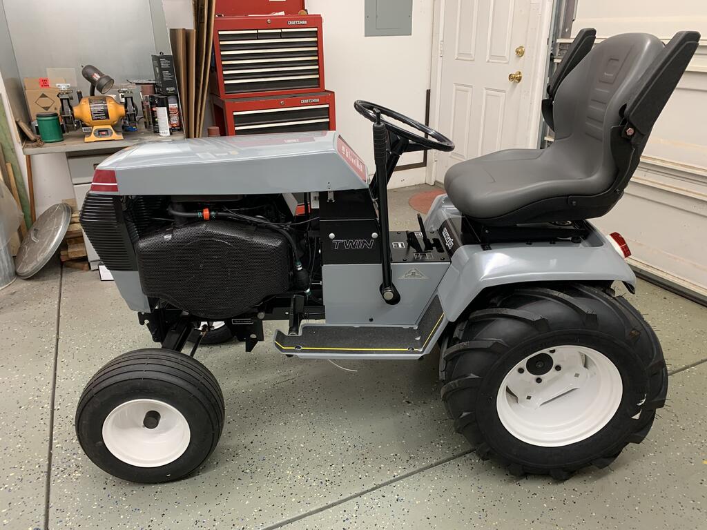

ebinmaine 80,755 #1126 Posted April 8, 2022 Hard to tell. Mebbe others can offer info here... Perhaps a heat gun would help ease the removal enough to keep the paint whole? @953 nut @Achto @WHX?? 1 Share this post Link to post Share on other sites
SylvanLakeWH 32,571 #1127 Posted April 8, 2022 Your call. But I’d be inclined to leave it if it were mine. Interestingly, the bottom of the sticker looks straight…? Is the hood tweaked? Maybe optical illusion. Perhaps @Vinylguy can comment on the paint damage potential and best way to do it if you decide. I’ve only removed them off stuff I was going to paint so didn’t care if paint damaged. Used blow dryer to soften decals… 3 Share this post Link to post Share on other sites
Achto 32,772 #1128 Posted April 8, 2022 A hair dryer will help remove the decal if you wish. It should take the decal about 48hrs to really set up. Or a day in the sunlight. The sooner you make your decision the less likely to do paint damage. if your paint was well cured before the decal went on (2 to 3 weeks old) the likely hood of paint damage decreases as well. Like @SylvanLakeWH said, it looks strait on the bottom, maybe just a hair off on top. Your call. BTW, this tractor is looking awesome. 2 1 Share this post Link to post Share on other sites
Horse Newbie 7,405 #1129 Posted April 8, 2022 (edited) 1 hour ago, SylvanLakeWH said: Your call. But I’d be inclined to leave it if it were mine That’s the way I’m leaning… ”There once was a crooked man, who”… Edited April 8, 2022 by Horse Newbie 4 Share this post Link to post Share on other sites
Horse Newbie 7,405 #1130 Posted April 8, 2022 10 hours ago, Handy Don said: You sure can be proud of your work on that there "hoss". I am proud of it, but not “prideful “, if that makes sense… 1 Share this post Link to post Share on other sites
Horse Newbie 7,405 #1131 Posted April 8, 2022 (edited) 13 hours ago, Handy Don said: You sure can be proud of your work on that there "hoss". I am proud of it, but not “prideful “, if that makes sense… I have done things in the past… looked at it with criticism, tried to make it better, and end up making a mess out of it… Should have left well enough alone… Edited April 8, 2022 by Horse Newbie 1 Share this post Link to post Share on other sites
rjg854 13,371 #1132 Posted April 8, 2022 Maybe the case this time, too. Looks very nice the way it is. Most likely noticeable to you, more than any one else. As long as your happy with it is all that matters. 4 Share this post Link to post Share on other sites

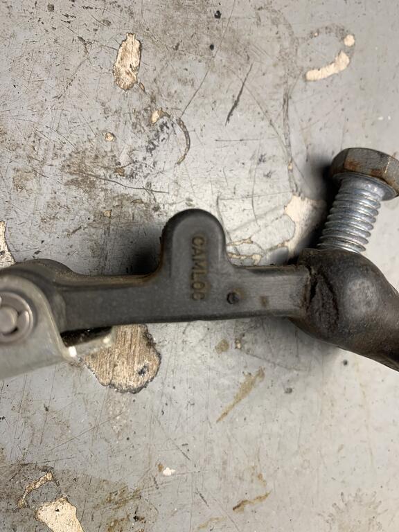

Lee1977 7,782 #1133 Posted April 8, 2022 9 hours ago, Horse Newbie said: I need 2 rubber hood latches… part # 106825. Doesn’t have to be new… just in good condition. I placed an ad in the classifieds under ”Wanted”… There are new ones for sale I don't remember where. I have seen some one post them the place had three different lengths. 1 Share this post Link to post Share on other sites
WHX?? 58,174 #1134 Posted April 8, 2022 Fleabay on those latches Newbie....... search on "rubber latch" 1 Share this post Link to post Share on other sites
Handy Don 17,484 #1135 Posted April 8, 2022 I think of "proud of it" as being work I'm happy to have my name on--that I gave it good effort and attention and didn't withhold anything important (not that it always turns out well!) 2 1 Share this post Link to post Share on other sites
Bill D 3,156 #1136 Posted April 8, 2022 16 hours ago, Horse Newbie said: I need 2 rubber hood latches… part # 106825. Doesn’t have to be new… just in good condition. I placed an ad in the classifieds under ”Wanted”… There was a thread on here about those. They are available new. I forget who made them for wheel horse. 1 Share this post Link to post Share on other sites

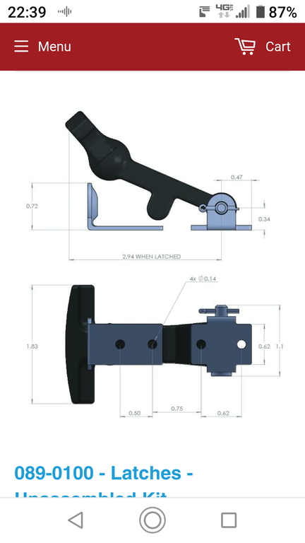

Bill D 3,156 #1137 Posted April 8, 2022 Found the latches. Contact ACTUS MFG. They have them on their website. A 3" latch is $6.31. 1 Share this post Link to post Share on other sites
kpinnc 18,970 #1138 Posted April 8, 2022 17 hours ago, Horse Newbie said: I hate the decal on the front of the hood is a little crooked… guess it could be worse. I do appreciate the kind words though… If it is crooked- I can't see it. ...and it's prolly straighter than they came from the factory. 2 Share this post Link to post Share on other sites
sjoemie himself 3,226 #1139 Posted April 8, 2022 20 hours ago, Horse Newbie said: Man that colorscheme looks good! Awesome work 1 1 Share this post Link to post Share on other sites
Jeff-C175 7,211 #1140 Posted April 8, 2022 52 minutes ago, kpinnc said: If it is crooked- I can't see it. Yer just bein' nice... and that's OK !!!! 1 Share this post Link to post Share on other sites
kpinnc 18,970 #1141 Posted April 8, 2022 1 hour ago, Jeff-C175 said: Yer just bein' nice... and that's OK !!!! No, I think it looks good. There are some serious faults on my tractors. They still look good to me. 2 Share this post Link to post Share on other sites
Horse Newbie 7,405 #1142 Posted April 8, 2022 2 hours ago, sjoemie himself said: Man that colorscheme looks good! Awesome work That was an accident… I went to buy a seat for my 1994 520H, and when I got there it turned out to be grey… I bought it anyway since I had driven an hour to buy one. A few months later a friend gave me the 1984 Work Horse GT-1600… since the Work Horse was grey, I figured it would work on it… got lucky ! 2 Share this post Link to post Share on other sites
Horse Newbie 7,405 #1143 Posted April 8, 2022 (edited) 4 hours ago, Bill D said: Found the latches. Contact ACTUS MFG. They have them on their website. A 3" latch is $6.31. Is a 3” latch what it takes ? I will definitely take some measurements and check that vendor to see how what they have compares to the length of mine. I have been trying to make sure I get the right length. Some people measure from the pivot point to the center of the ball, and others may be using the full length of the rubber as a guide. That price is good… most I have seen online is at least $20 or more a piece. Edited April 8, 2022 by Horse Newbie Share this post Link to post Share on other sites

Bill D 3,156 #1146 Posted April 9, 2022 Here is the image from the ACTUS website. It should have all the measurements you need. You can buy just the rubber strap for $3.43. 1 1 Share this post Link to post Share on other sites
