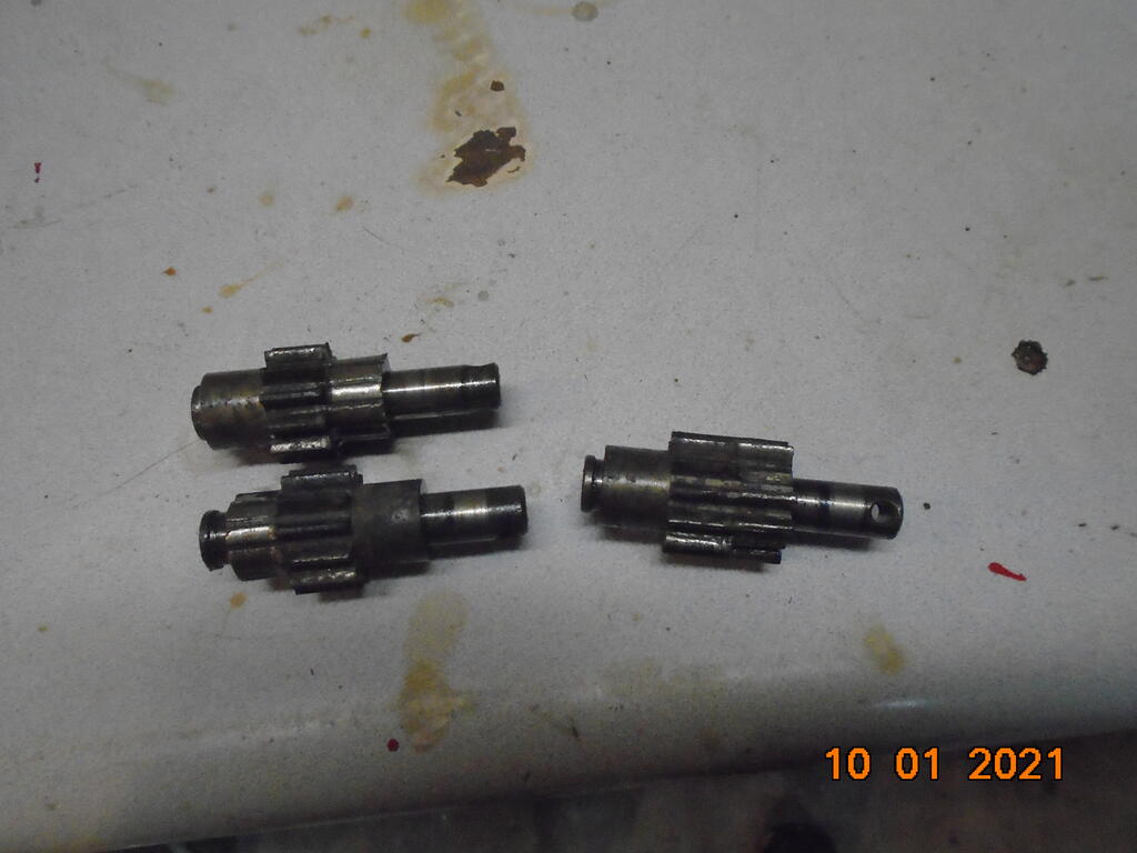

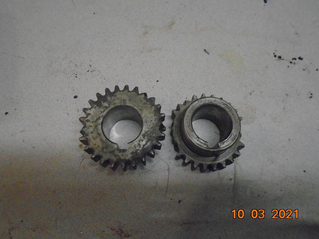

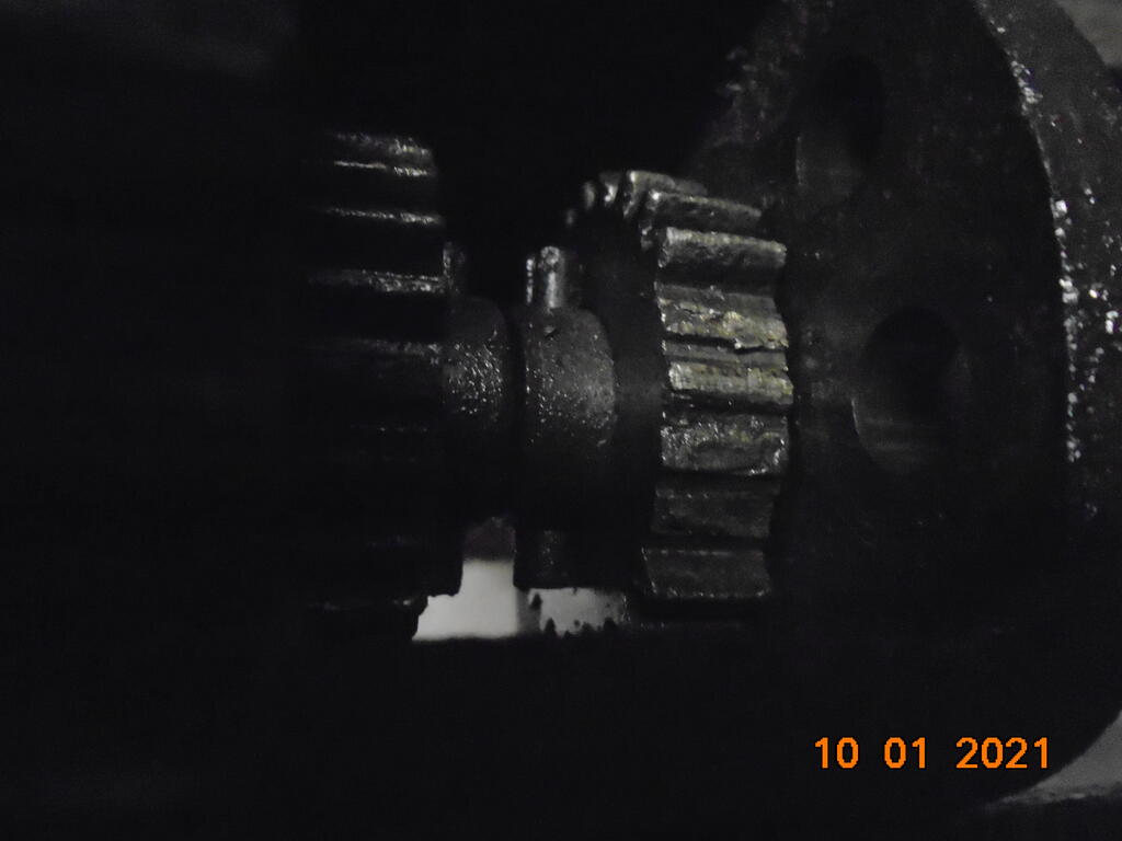

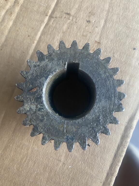

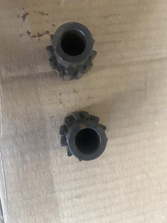

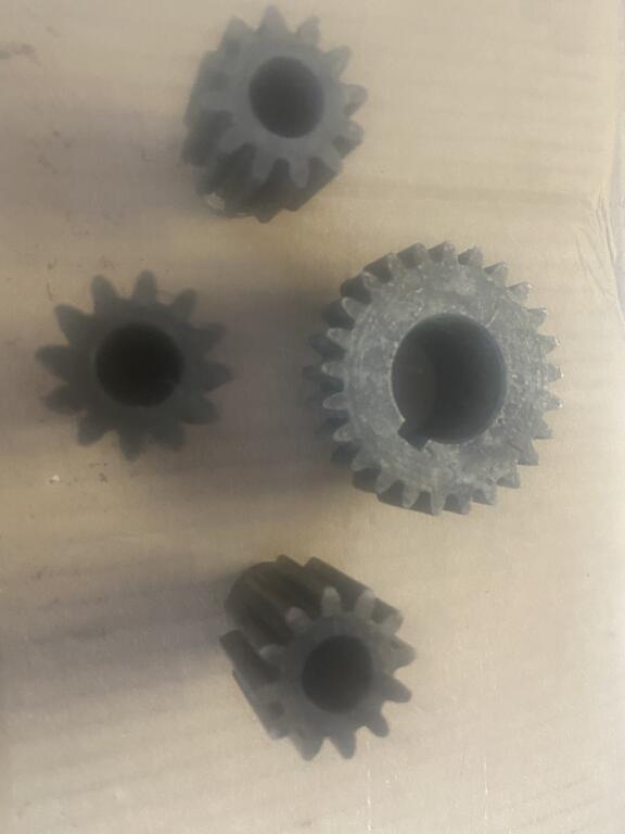

flatlndr 17 #16 Posted October 2, 2021 Hope the pics come through ok. Two of the spider gears are completely shredded. One has teeth chewed up and should probably be replaced. The axel gear has two teeth sections completely missing. The other axel gear is salvageable. Laneranger, I tried to message you but couldn't get pics inserted. Thanks for any help. Tom B 1 Share this post Link to post Share on other sites
Lane Ranger 12,131 #17 Posted October 2, 2021 (edited) 5 hours ago, flatlndr said: Hope the pics come through ok. Two of the spider gears are completely shredded. One has teeth chewed up and should probably be replaced. The axel gear has two teeth sections completely missing. The other axel gear is salvageable. Laneranger, I tried to message you but couldn't get pics inserted. Thanks for any help. Tom B post pics of the gears with the gear teeth face up! I need the number of teeth?? You have to knock out the roll pins to get the axle gear and Woodruff key off the axle to get it out of the differential. The gear needs to be face down and photographed. Edited October 2, 2021 by Lane Ranger Share this post Link to post Share on other sites

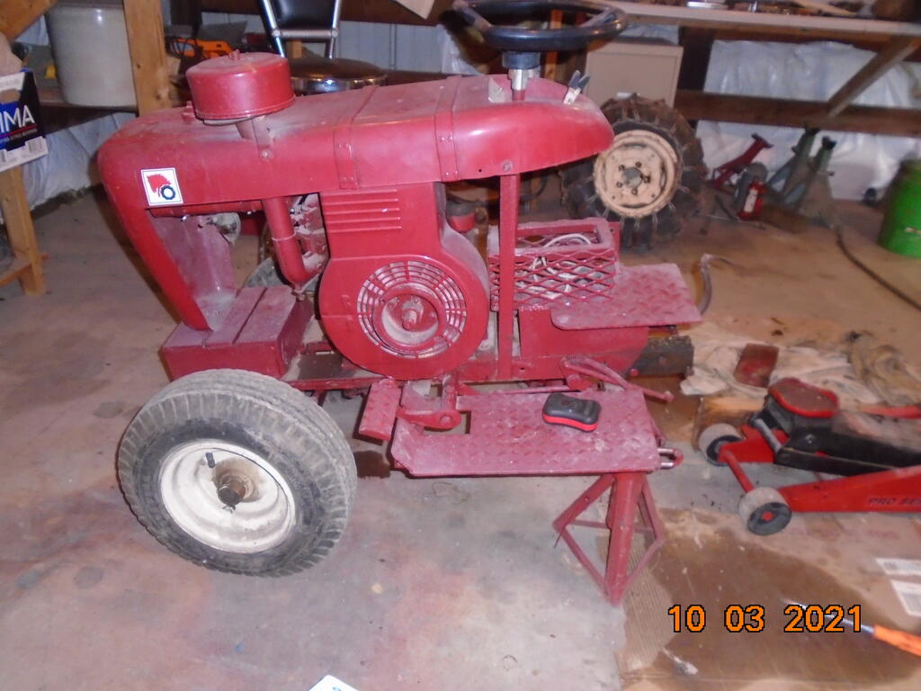

flatlndr 17 #18 Posted October 3, 2021 Sorry about that. The axle gears have 25 teeth and the spider/pinion gears have 12 teeth. Pic of axle gears and the old rig I'm trying to resurrect. Thanks for checking Tom B Share this post Link to post Share on other sites

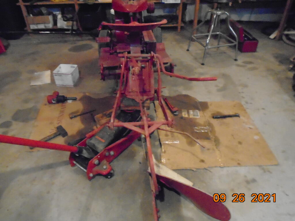

flatlndr 17 #19 Posted October 3, 2021 Don't chastise me too bad, a Sears 3 point plow mounted on the back of it. The guy that built it did a pretty nice job of putting it together. Share this post Link to post Share on other sites

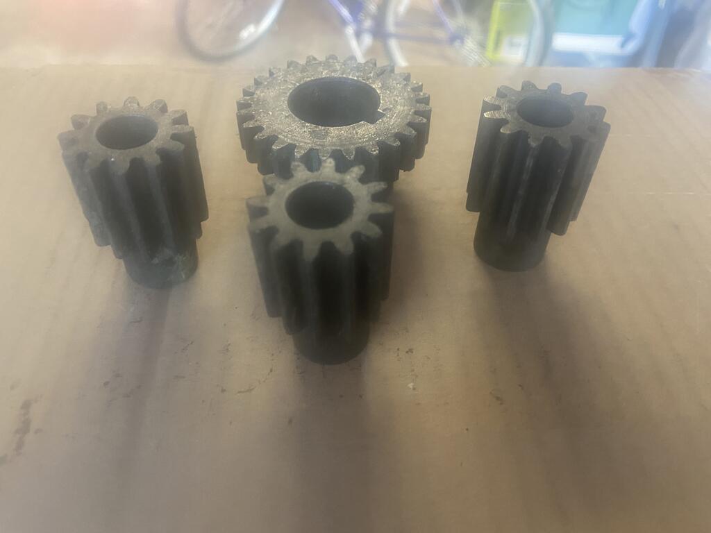

Lane Ranger 12,131 #20 Posted October 3, 2021 (edited) Tom looks like you have a real cobbled together Wheel Horse someone made work for them. I have sent you a pm. I have four good gears that will work for you. Three 12 tooth spiders and a 25 tooth axle gear. You might consider putting the stronger two piece/3 speed transmission in your tractor if you are going to use to plow. The three piece transmission will work for you but plowing does put a lot of stress on the tractor! Edited October 4, 2021 by Lane Ranger Share this post Link to post Share on other sites
flatlndr 17 #21 Posted October 4, 2021 Cobbled is a kind description. Yeah, a 2 piece tranny would be a better option. My welding/fabricating skills are non-existent mounting it up. I'll be kind to the old rig. Thanks again for all your help. Tom B Share this post Link to post Share on other sites
