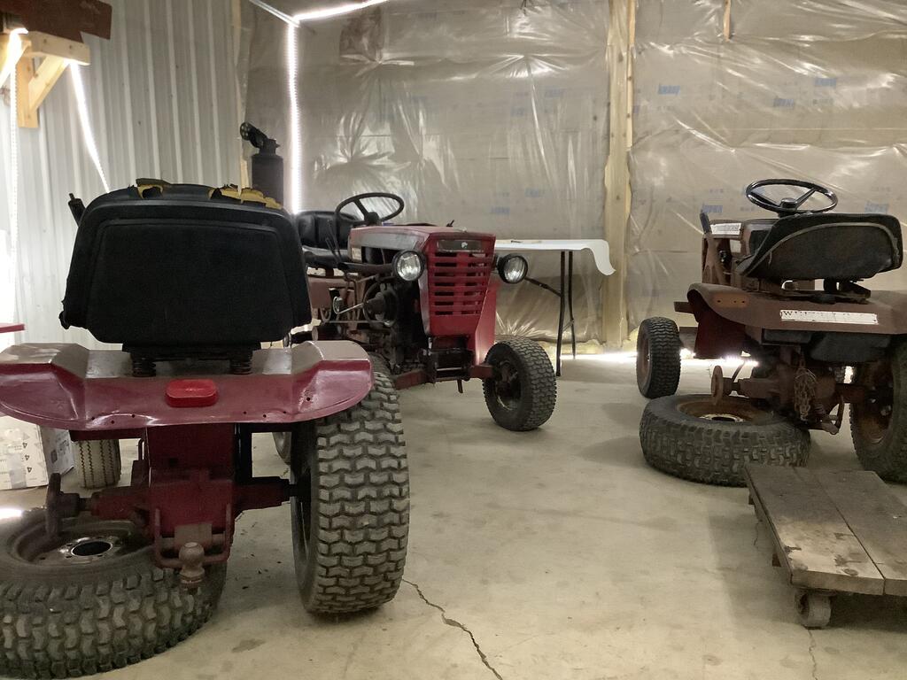

Pullstart 71,213 #1 Posted September 23, 2021 I’ve been kind of busy building a little insulated work shop for winter tinkering. I should be able to heat this little insulated lean-to room with a small electric heater unit fairly easy. It’s R19 insulated, has some plastic as a vapor barrier and enough lighting to see what I’m doing. Unfortunately, my 36” door I installed isn’t quite wide enough for rear ends to get through! For now, I need to pop a few machines apart that are unused or have been set aside for parts. In here now are Chief, Leroy and A C-101 from a local member. I was doubted by Mrs. P when I showed her today that I’m going to pop a few apart. I’m promptly here to get to work! I even have a mini fridge in here! 7 7 1 Share this post Link to post Share on other sites

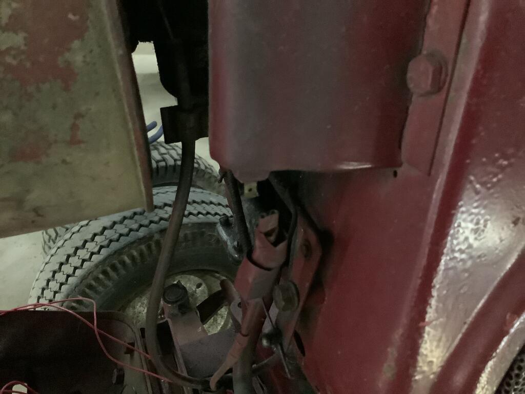

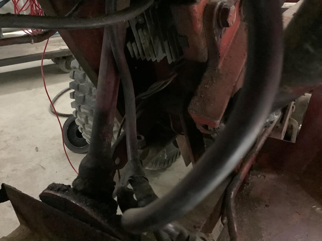

Pullstart 71,213 #5 Posted September 23, 2021 It’s funny what you find when a machine is written off. Here I thought maybe a flywheel key way sheared. Running loud and clear, then some crazy intermittent running, then big backfires (stack full of raw fuel) then no fire or backfire. The ignition coil kill wire was barely touching, but wrapped tight around the implement lift lever. My guess is it was off and on grounding out while I was mowing 24+” high field grass… I’ll likely still check the flywheel key way but I’m thinking funky wiring. 4 Share this post Link to post Share on other sites

squonk 48,072 #8 Posted September 23, 2021 (edited) 10 hours ago, pullstart said: Unfortunately, my 36” door I installed isn’t quite wide enough for rear ends to get through! Sounds like some folks need a diet! I have the same issue with a 33" door. Pop a couple of 6-12 wheels tires on the backs with a couple of lugs and roll them through. Edited September 23, 2021 by squonk 2 1 3 Share this post Link to post Share on other sites
Pullstart 71,213 #9 Posted September 23, 2021 2 minutes ago, squonk said: Sounds like some folks need a diet! I have the same issue with a 33" door. Pop a couple of 6-12 wheels tires on the backs with a couple of lugs and roll them through. Thought about grabbing some 6-12’s, but knew they had only 12-14’ to roll to their demise. They can do that on 3 wheels 1 Share this post Link to post Share on other sites
