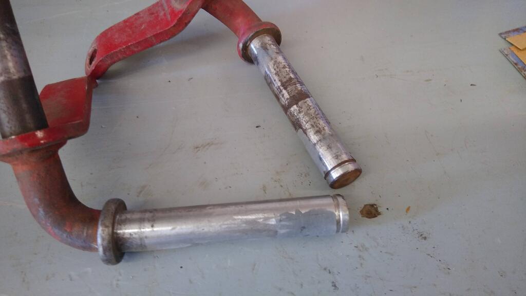

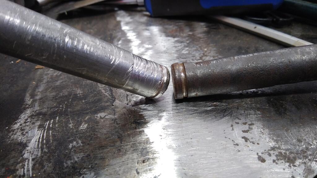

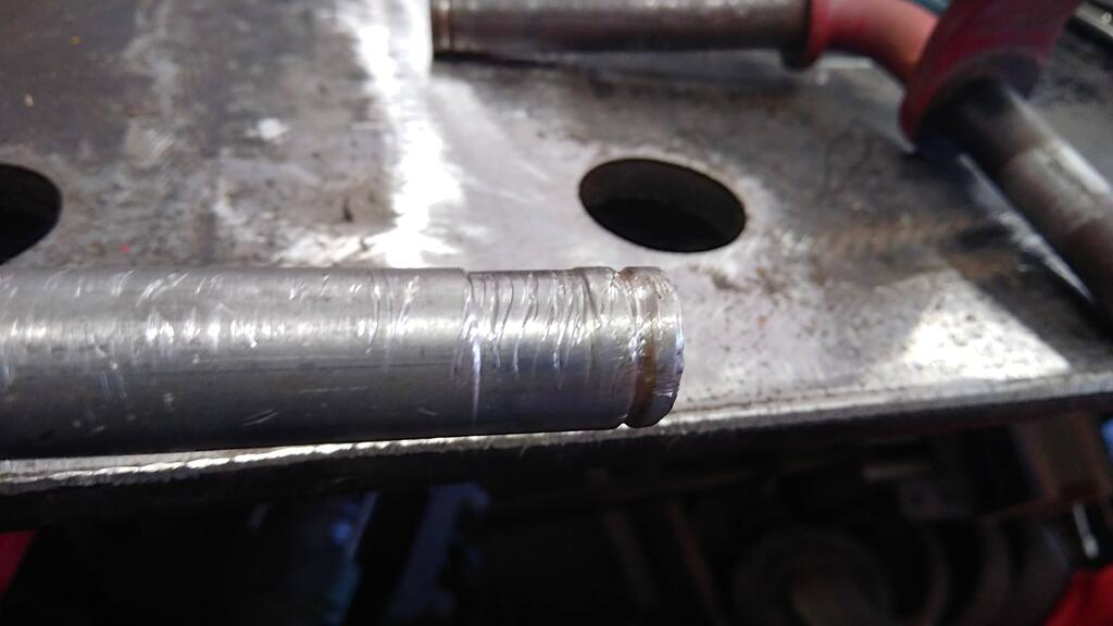

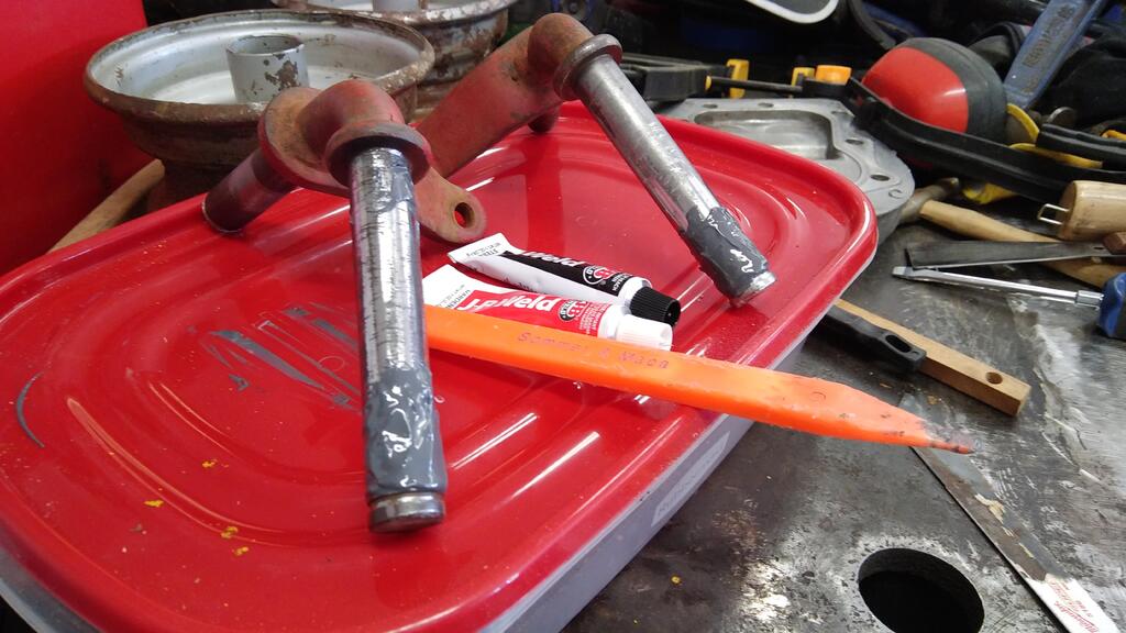

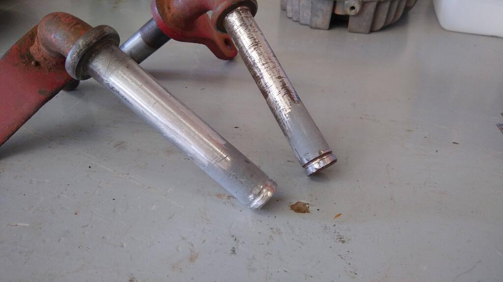

RandyLittrell 3,945 #1 Posted September 16, 2021 I am working on a C-121 and the spindles had some pretty worn spots from lack of maintenance on the wheel bearing and thought I would share this here rather than in my C-121 thread. That way it was searchable for others. I am sure there are other threads on this but this is how I am repairing mine, not the only way and some may not agree with my repair. To me welding them up or brazing and then reshaping seems like a lot of work for a 5 mph tractor. I used JB weld and then filed them to rough shape and finished with 220 sandpaper. I will try to remember to update this later and see how they hold up, I tend to used things like a rented mule! 4 Share this post Link to post Share on other sites

pacer 3,180 #10 Posted September 16, 2021 (edited) Not a bad idea using JB to patch the axle, that stuff is pretty amazing and I wouldnt be surprised if you didnt get at least 2-3 more yrs out of them..... I gave up on that horrible mess/method of lubing the bearings by cramming almost a full tube of grease in that big cavity hoping some would get to a bearing!! Some several yrs ago I found a "lot" of 10 sealed bearings on the bay for .... cheap, and thats all I use now -- no probs. In fact I ...think? I've got one 48" deck that I changed over to sealed that must be in its 6th or 7th season. Had never seen that Amazon 'deal' -- that looks like a keeper to me. Edited September 16, 2021 by pacer 3 Share this post Link to post Share on other sites
