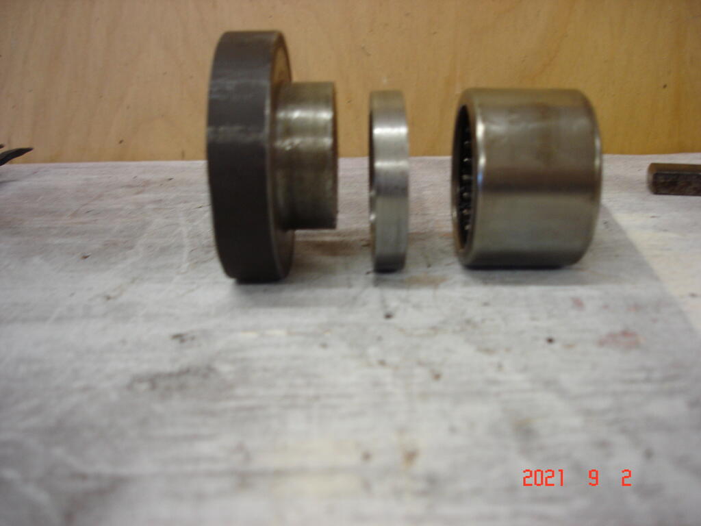

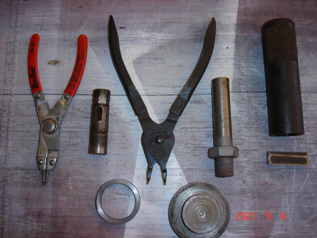

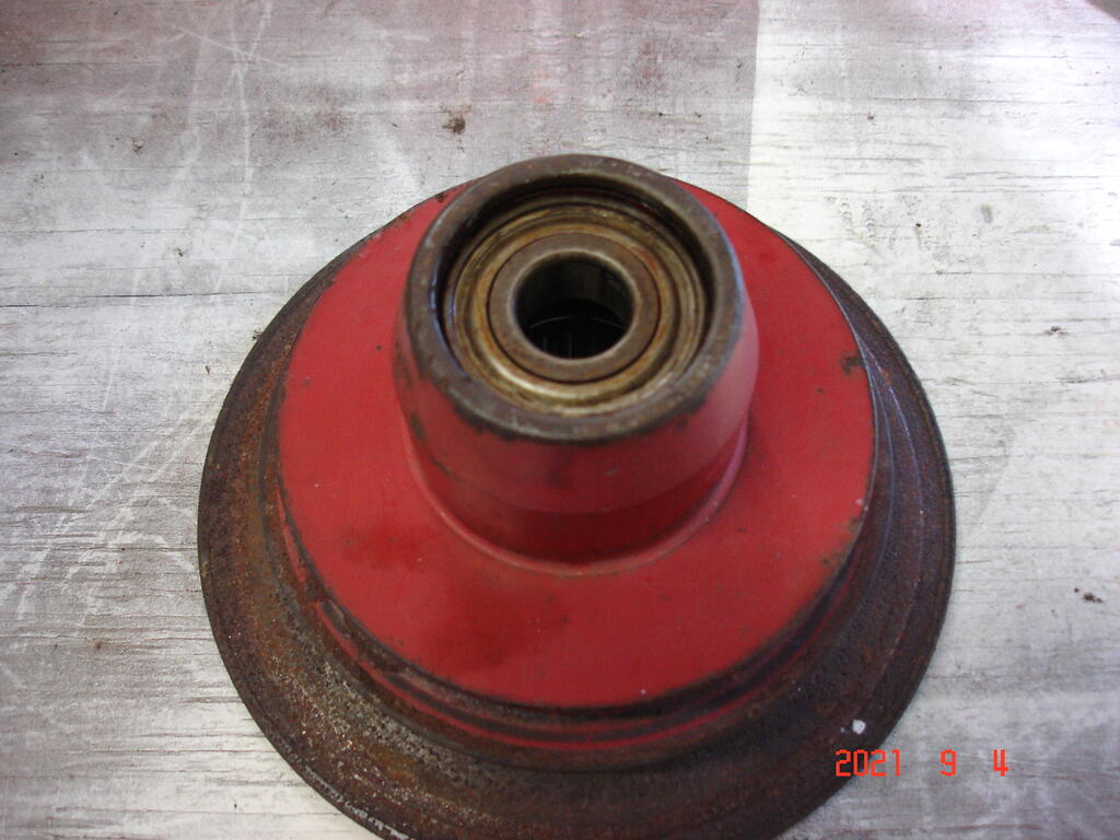

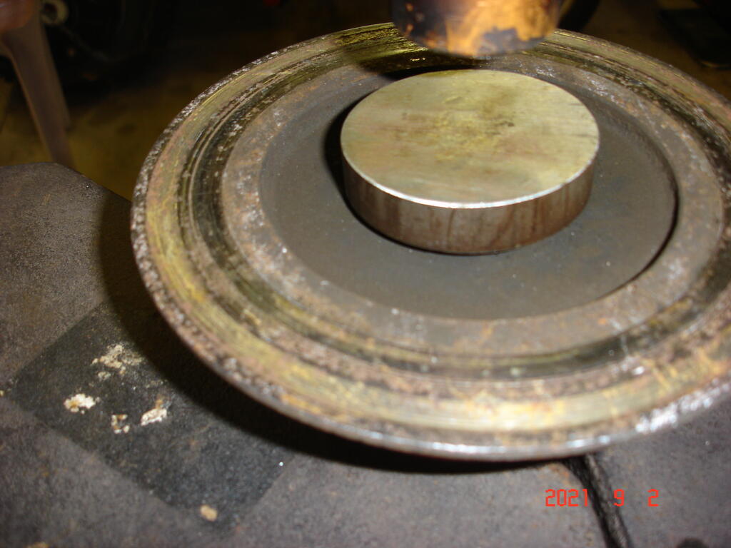

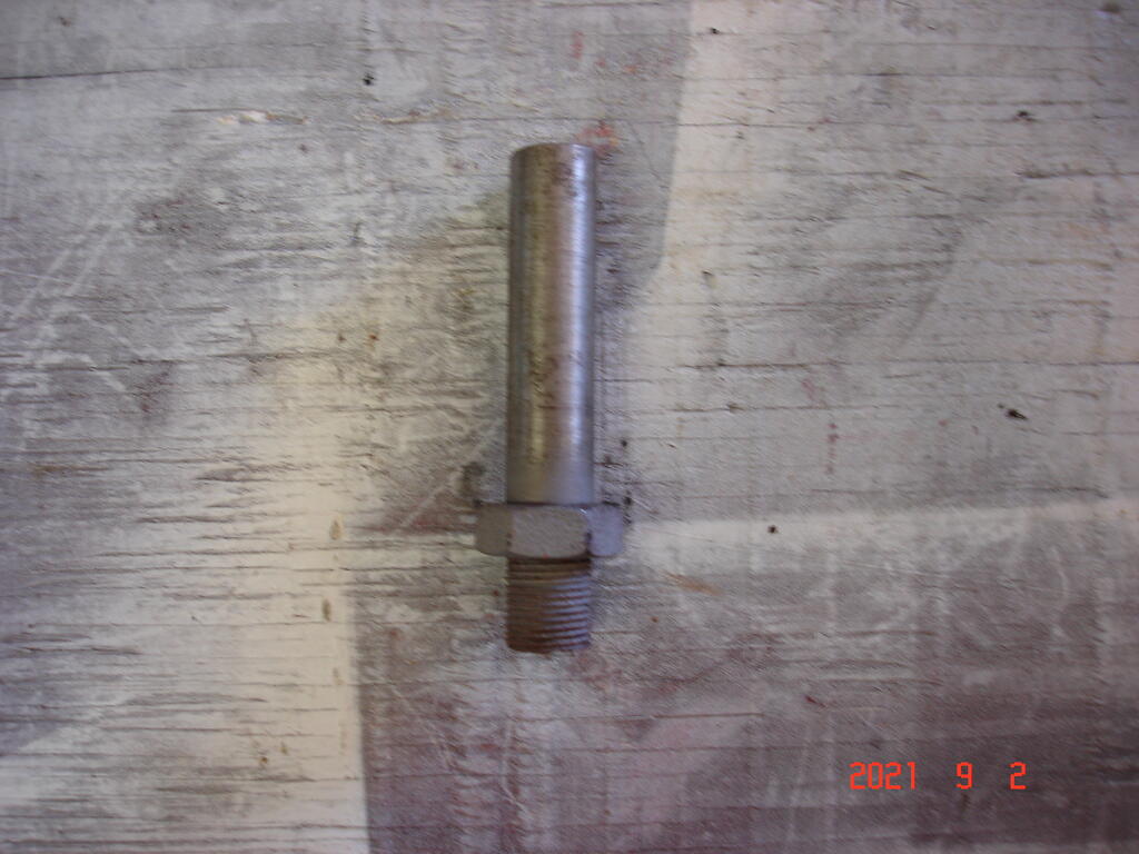

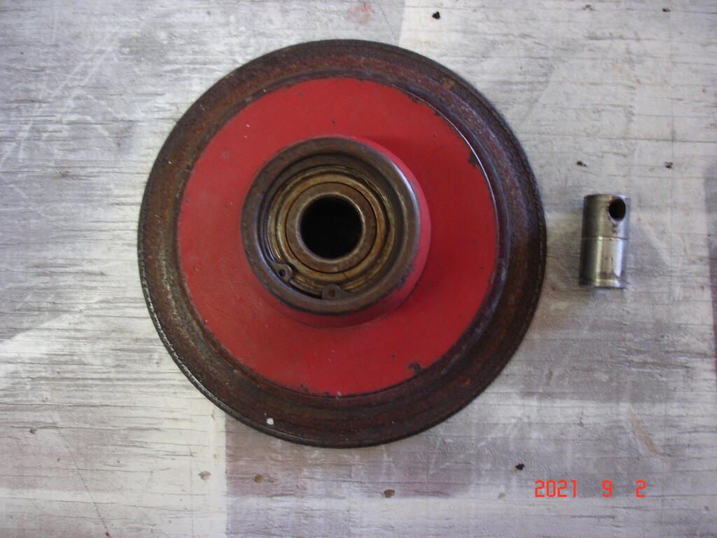

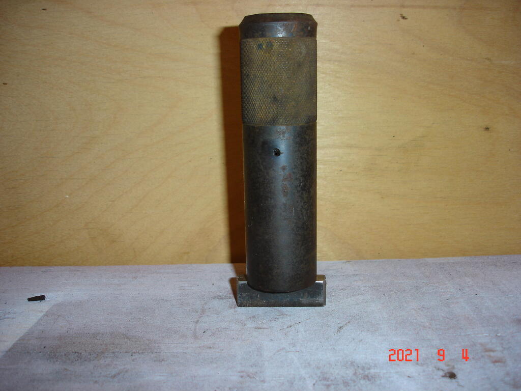

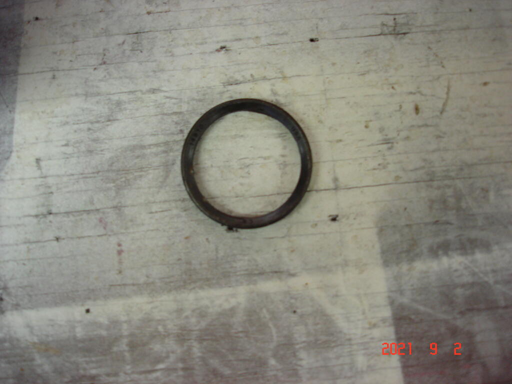

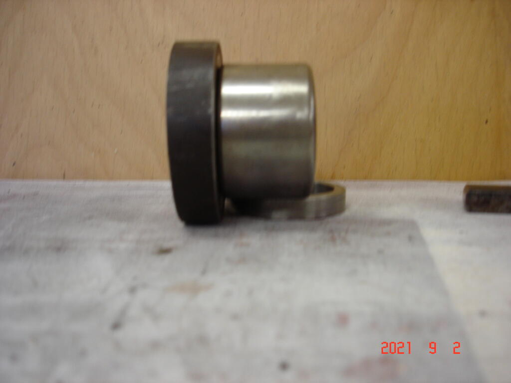

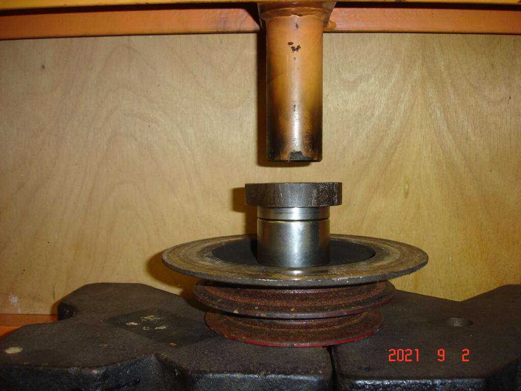

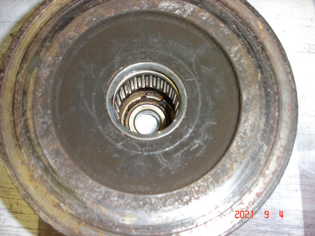

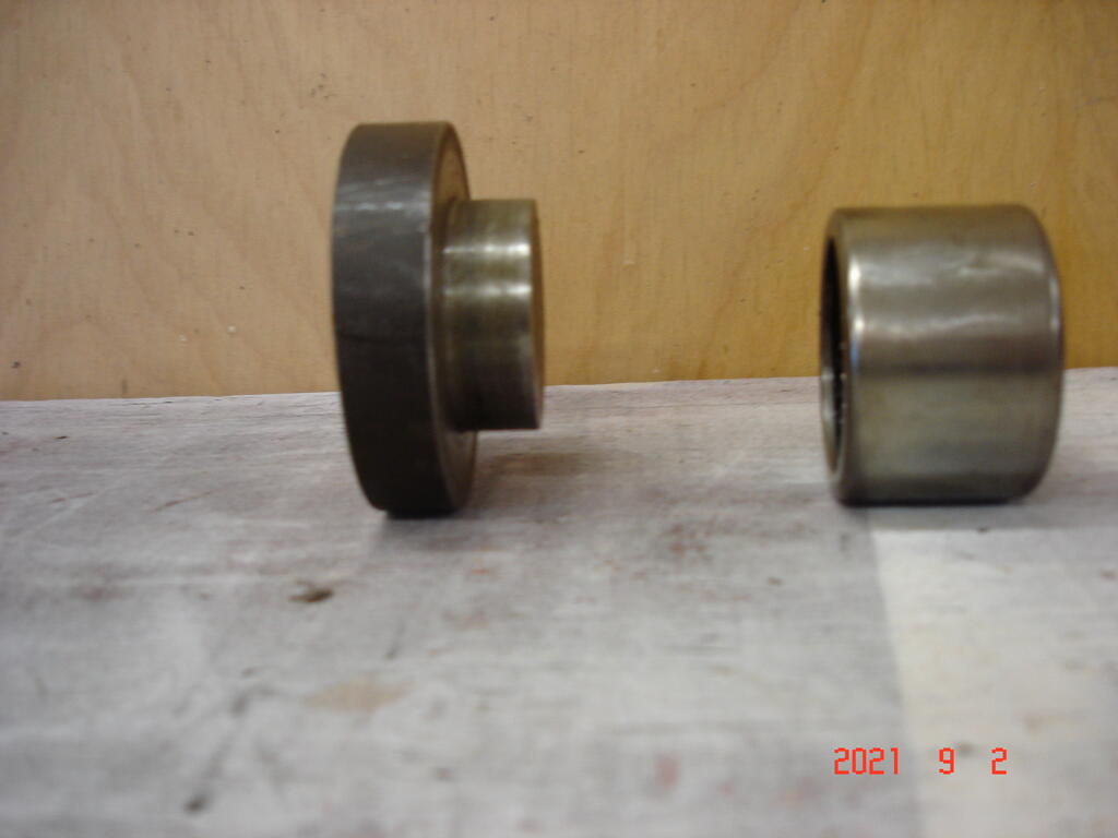

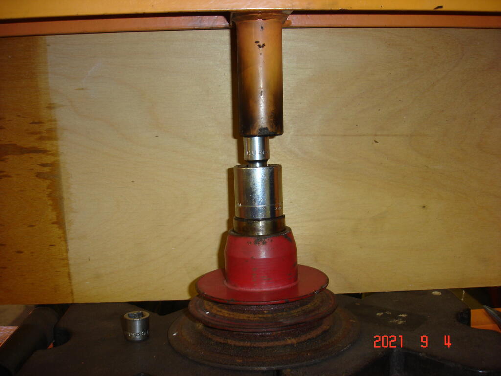

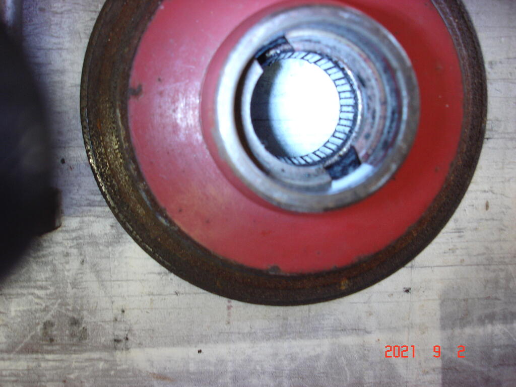

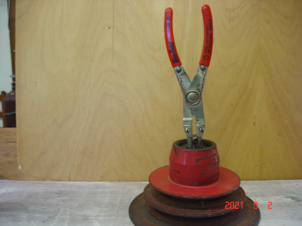

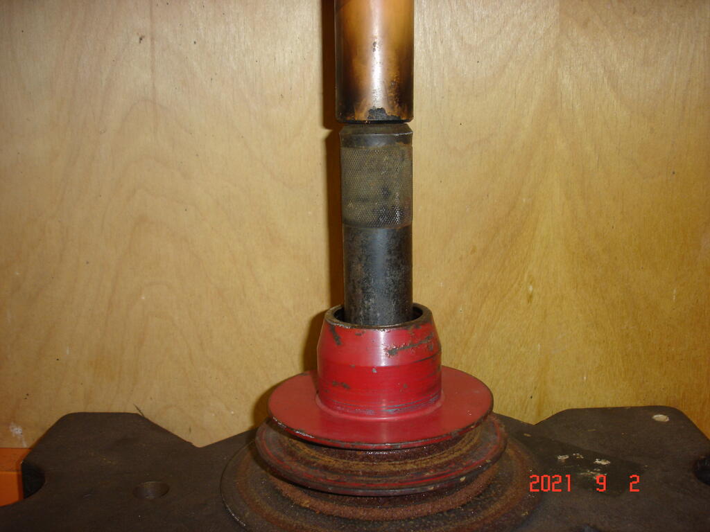

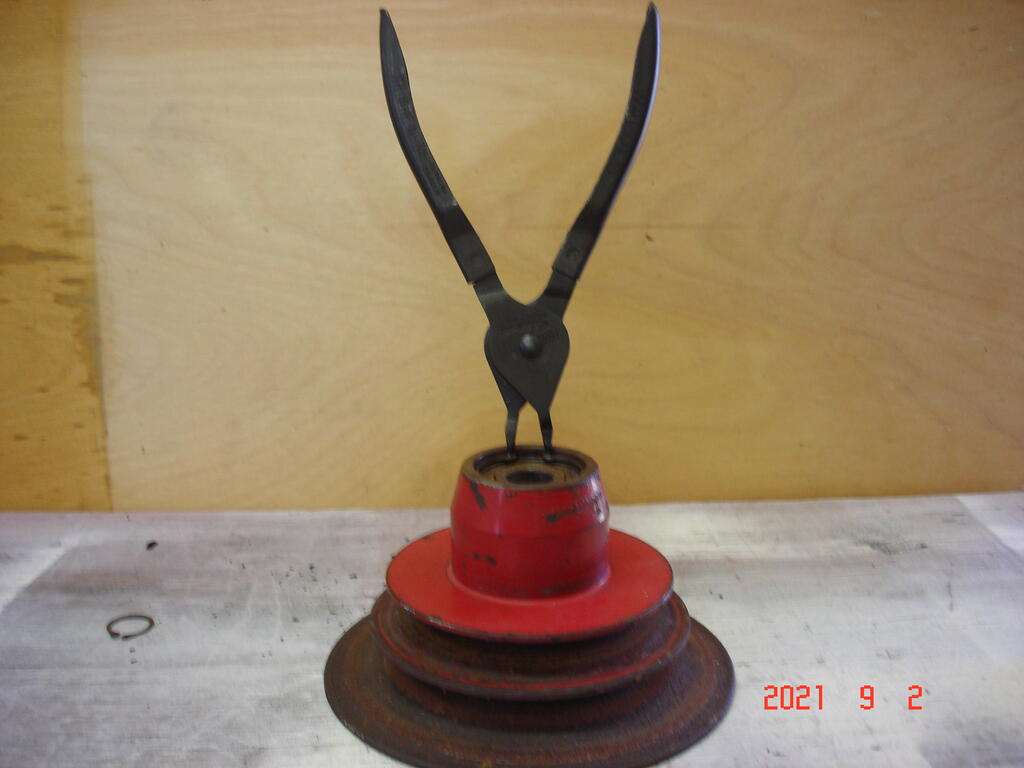

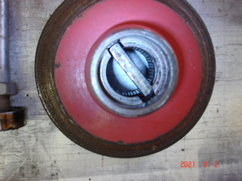

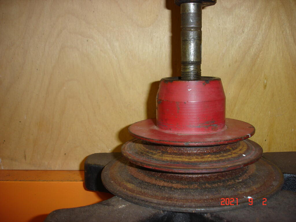

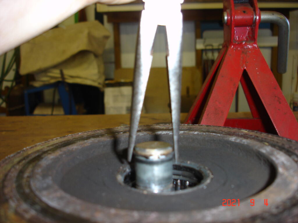

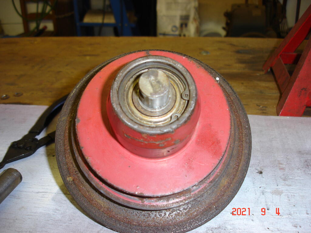

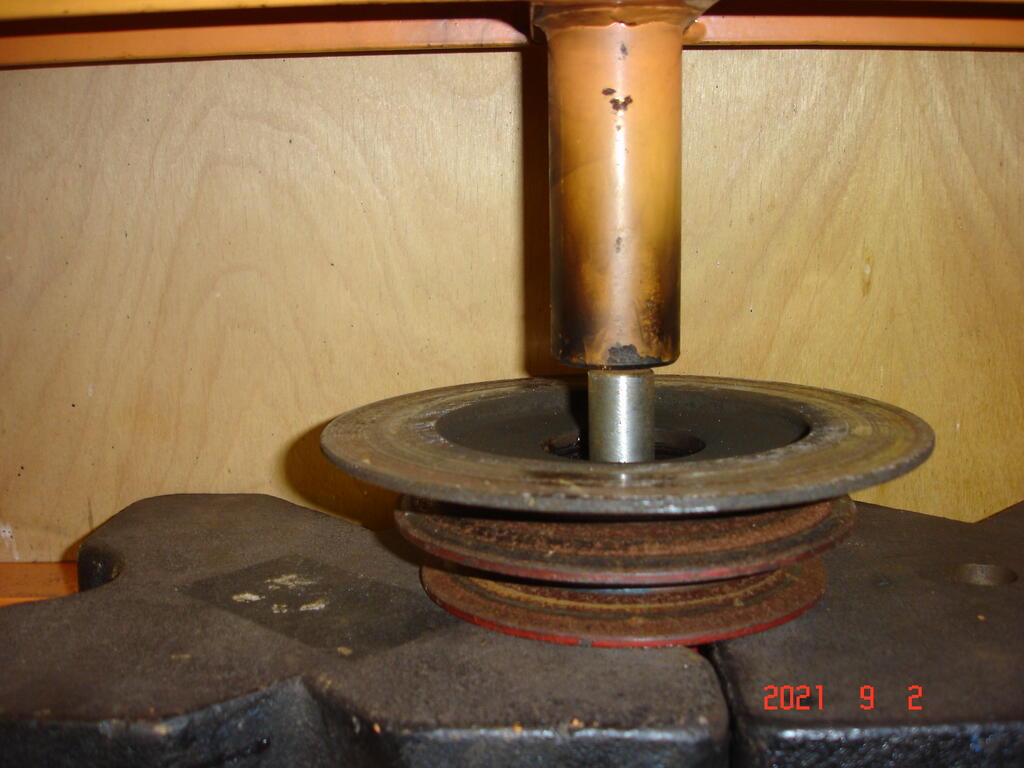

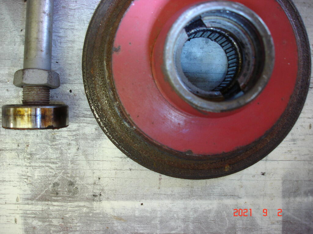

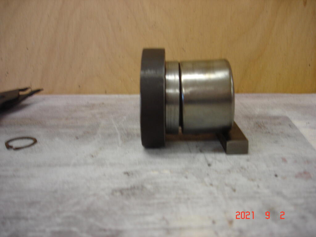

Marv 996 #1 Posted September 5, 2021 For those who have never done this. two notes: The short bar ,right side of tool picture, is made from a piece of 3/8 flat stock. It is 1.772 long and the ends are rounded to fit in the outer bearing bore of the bell. The ring is 5/16 thick to be used when installing the inner bearing. It sets the bearing to allow installation of the seal. Hope this will be helpful to someone. Marv 2 4 1 Share this post Link to post Share on other sites
