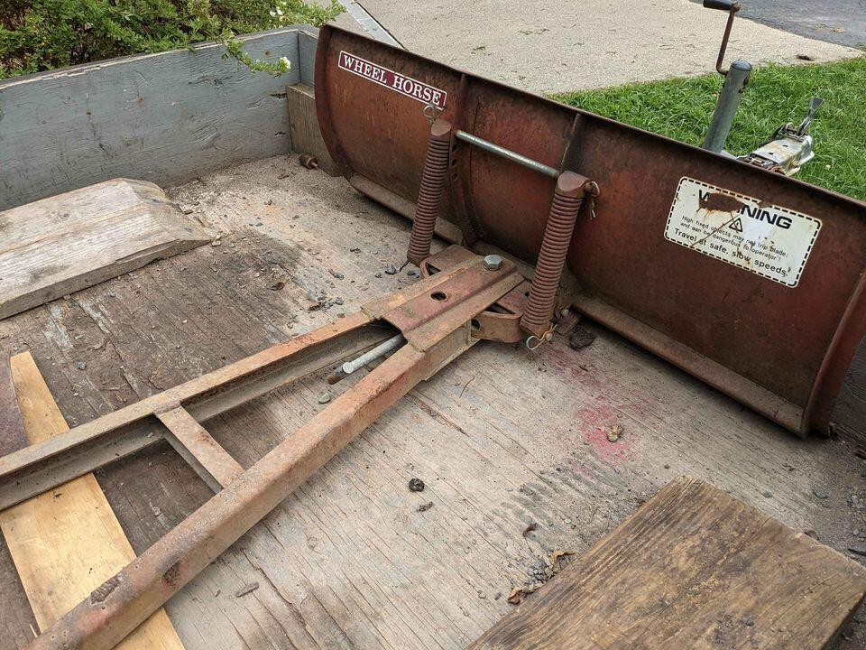

aemsee 93 #1 Posted September 2, 2021 Hi. Found this listed for $50...but JUST blade and frame. Should this fit my 89 310-8? And how hard to find all the stuff it needs to function? Many thanks as always Share this post Link to post Share on other sites
roadapples 6,987 #2 Posted September 2, 2021 This one is for a short frame tractor... Share this post Link to post Share on other sites
aemsee 93 #3 Posted September 2, 2021 Just now, roadapples said: This one is for a short frame tractor... Thank you Share this post Link to post Share on other sites

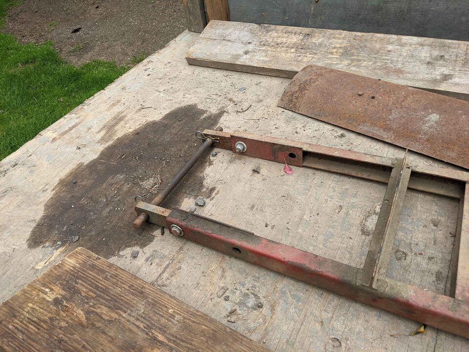

roadapples 6,987 #4 Posted September 2, 2021 (edited) Actually, can't see enough of the frame to be sure I might be wrong. It's happened before. Take a picture of the whole frame... Edited September 2, 2021 by roadapples Share this post Link to post Share on other sites
aemsee 93 #5 Posted September 2, 2021 5 minutes ago, roadapples said: Actually, can't see enough of the frame to be sure I might be wrong. It's happened before. Take a picture of the whole frame... those are the two pictures he posted on CL Share this post Link to post Share on other sites
Racinbob 13,290 #6 Posted September 2, 2021 I actually think it's for a long frame and even has a homemade extension for a 520. I don't think the shorty had two locations for the bar. We do need to see it all to be sure. 2 Share this post Link to post Share on other sites
stevasaurus 23,892 #7 Posted September 2, 2021 It's a long frame snow blade. It will fit his 310-8, but is missing all the wire and pieces for angling the blade. Not shown, he would also need the attach-a-matic for the transmission axle. He could make all the steering mechanism parts, but the way it is...$25. Maybe the seller has the other parts...then $50. 2 Share this post Link to post Share on other sites

gwest_ca-(File Mod) 12,557 #9 Posted September 2, 2021 Here is an illustrated parts list for what I think you have Share this post Link to post Share on other sites
SylvanLakeWH 32,934 #10 Posted September 2, 2021 Just bought a fully functional one in similar shape for $50… I’d offer him $25… 1 Share this post Link to post Share on other sites

peter lena 10,127 #22 Posted September 4, 2021 @aemsee for 50$ , that's a deal, first thing , ( if you want to ) give it an oil spray down to stop rust save patina and make that steering quadrant work easier , like stevaasaurus said , need a rear axel mount as well as blade swing lever and linkage . note you have the blade wear strip on that , hope its not worn down to blade edge bolt point . that quadrant can be really made to work with ease with tighter lever fittings and lubrication detail . I heim jointed my swing rod lever , no effort . good luck with it , pete Share this post Link to post Share on other sites
aemsee 93 #23 Posted September 4, 2021 1 hour ago, rjg854 said: We put a big addition on a house on Lerch Rd., a few years back. On west side of hill near 3 Brothers? I’m on east side at the bottom 16 minutes ago, peter lena said: @aemsee for 50$ , that's a deal, first thing , ( if you want to ) give it an oil spray down to stop rust save patina and make that steering quadrant work easier , like stevaasaurus said , need a rear axel mount as well as blade swing lever and linkage . note you have the blade wear strip on that , hope its not worn down to blade edge bolt point . that quadrant can be really made to work with ease with tighter lever fittings and lubrication detail . I heim jointed my swing rod lever , no effort . good luck with it , pete Thanks for the input. But think I will keep looking for one more complete. Plus something about the seller didnt click so wouldnt have taken it if he offered it for free 2 1 Share this post Link to post Share on other sites
