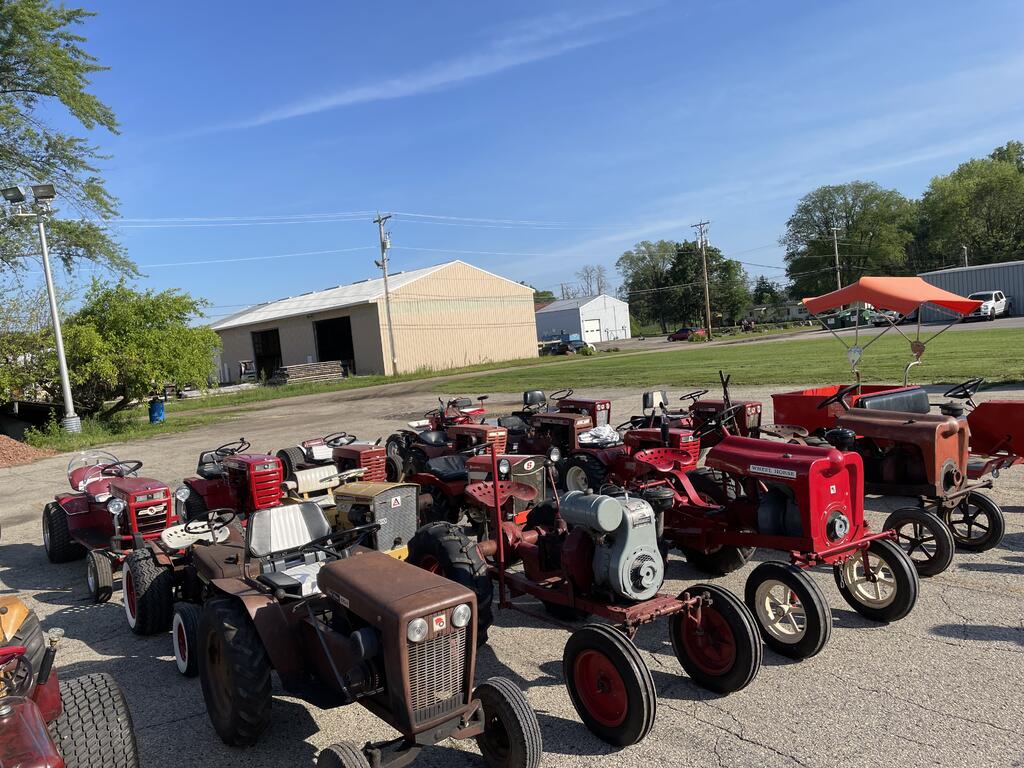

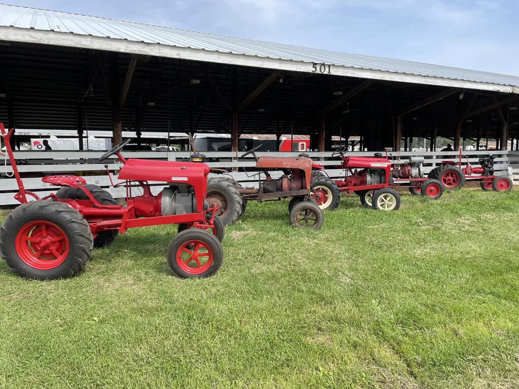

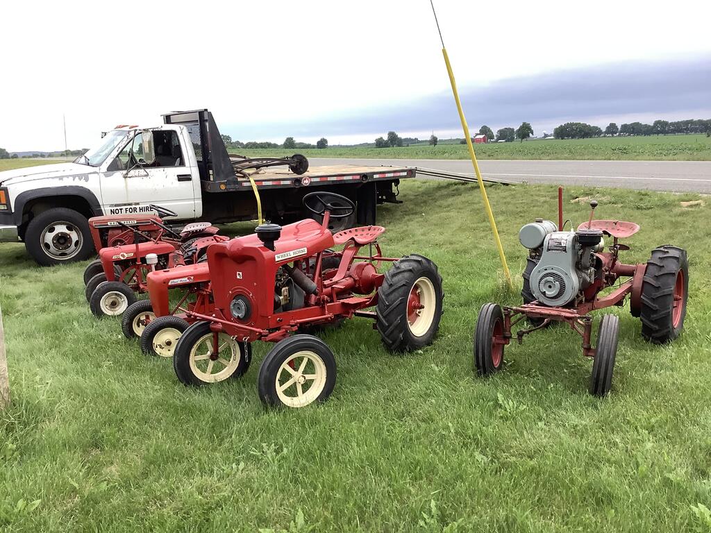

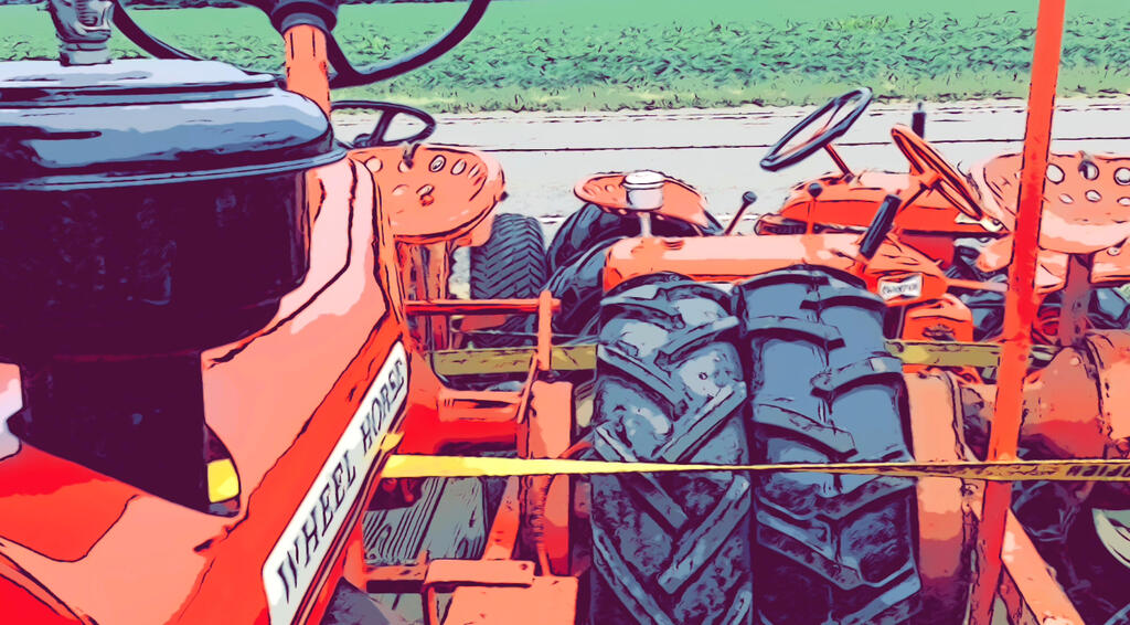

Pullstart 70,030 #52 Posted August 31, 2021 @Mike Van Eman, please forgive me for my ignorance on this thread! In the past year, I’ve been able to score an RS-83 for my wife, along with a Lever Steer for myself. The Lever Steer had a stuck exhaust valve as well. Because of your hood, it’s not so easy to remove the head. I popped the head off “Jackie” the Lever Steer and simply twisted the exhaust valve with a little WD-40 on the stem and it returned to it’s home in a jiffy. Best of luck getting that beautiful piece of history running! Those tires, they are awesome. The 3-12’s aren’t made any longer and I believe I’ve only seen one set of them in good shape, on @Shynon’s Senior. Here’s a few pics of ours and a lineup of a handful of ‘em in Portage, WI as well. 4 5 Share this post Link to post Share on other sites

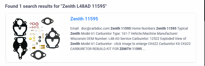

Gregor 4,848 #58 Posted December 2, 2021 The Carburetor Doctor Poke Here 2 Share this post Link to post Share on other sites
