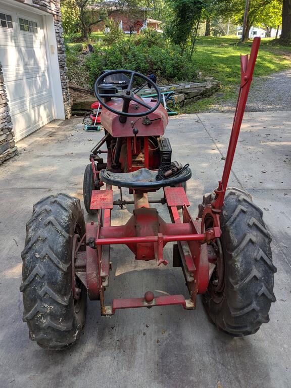

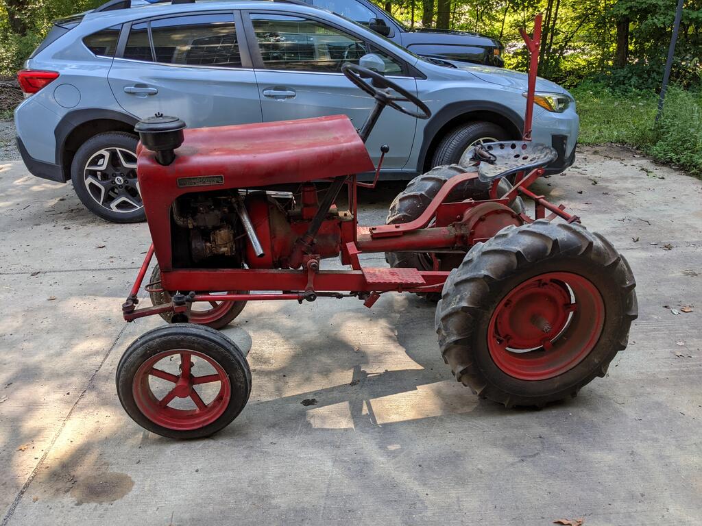

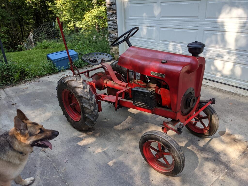

Mike Van Eman 73 #1 Posted August 28, 2021 Hello, I'm new to the forum and to Wheelhorse so please correct the model if I've mislabeled. This was my wife's grandfather's tractor and has been sitting in her dad's garage for the past 21 years. Unfortunately her dad passed away last year and lot of the history of this tractor went with him. He and I did attempt to get it to start before he passed but we figured out there were several things that needed fixed. work done so far: replaced spark plug, points & condenser, ignition coil, fuel sediment bowl, cleaned & rebuilt carburetor - it was pretty nasty with debris inside. I verified spark by grounding the plug to the frame and can see a spark in daylight when I turn the pulley and the magneto fires. I'm also getting fuel to the carburetor. Fuel had been leaking at the sediment bowl. current known issue: 0 psi compression according to my meter. I also put my thumb over the plug hole and while turning the pulley I don't feel any pressure. I poured a little oil down into the plug hole and it came pouring out of the exhaust. After doing this the pulley flywheel spun much easier when I wound and pulled the rope. I tried starter fluid and can get a pop once in a while but the engine won't fire. I'm not very experienced with taking apart engines so any advice or test ideas are welcome. There are a few implements I'll post pictures of: plow, cultivator, and a broken harrow. All anyone else can remember about this tractor was her dad needed to pull start it with his Ford 9N. Thanks! Mike 8 10 1 5 Share this post Link to post Share on other sites
squonk 48,076 #2 Posted August 28, 2021 Sounds like the exhaust valve is stuck open. 4 2 Share this post Link to post Share on other sites

Pollack Pete 2,273 #4 Posted August 28, 2021 With zero compression,it will never run.Like Squonk said,sounds like the exhaust valve is stuck open.Neat looking tractor. 1 Share this post Link to post Share on other sites
8ntruck 9,296 #5 Posted August 28, 2021 to the forum. Bunch of good helpful folks here. Someone will be along soon with more information for you. That is a really nice tractor. Don't give up on it. If it were mine, I would see if it has some sort of valve cover that could be opened to observe the valve operation. Lacking that, I would consider pulling the head to see if the valves work as they should. Might want to go easy on the starting fluid. It detonates hard enough that it could damage one of these small, old engines. Carb cleaner is gentler. Good luck, have fun, and keep us posted. 4 Share this post Link to post Share on other sites
953 nut 69,161 #6 Posted August 28, 2021 What a wonderful gift to remember your wife's grandfather by. That is one of the best looking RS-83 survivors I have ever seen. I would suggest you turn the crank until the piston is near TDC (top dead center) and then fill the cylinder with some MMO. Let it set for a day or two and it may free up the rings and valves. I have had good results with it. 10 1 Share this post Link to post Share on other sites
Handy Don 17,463 #7 Posted August 28, 2021 (edited) I feel for your sadness at losing some of the history of this tractor but it is great that you still have it! I hope you are able to gently coax it back into operation. A stuck exhaust valve does sound like the culprit and since it appears this machine was stored dry and under cover it may not be all that bad. Soaking the combustion area (via the spark plug hole) with a penetrating lubricant like Marvel Mystery Oil and leaving it to work is a good opening gambit. You won't be able to put much in without it coming out the exhaust, so several small doses over several days (or even weeks!) is the way to go. Patience will be key to not doing any new damage. You have a model that many members here admire. Edited August 28, 2021 by Handy Don 5 Share this post Link to post Share on other sites
Ed Kennell 47,268 #8 Posted August 29, 2021 to the Mike. You are in posession of one of rarest most sought Wheel Horses. It appears to be an all origonal. Please do not alter the tractor or risk damage with starting fluid. As Richard and Don have advised, try to loosen the rings and valves by soaking with MMO. We will all be anxious to see this gem running at the 2022 Wheel Horse Collectors Club Show next spring in Arendtsville, Pa. You are only 4 hours away. 3 2 Share this post Link to post Share on other sites

kpinnc 18,940 #11 Posted August 29, 2021 Holy cow are those the original rear tires? I have only seen those on the old sales brochures. What an awesome machine! I'm 100% sure your grandfather in law would be proud to see you following in his footsteps. What a piece of history- both for you and the folks like us who love these little red tractors! 1 Share this post Link to post Share on other sites
Mike Van Eman 73 #12 Posted August 29, 2021 Thanks everyone! I will be starting MMO treatment tomorrow and go from there. And thanks for letting me know about starting fluid, didn't know it was a bad idea for old engines but makes sense. Maybe having the exhaust valve stuck open saved my bacon. I'm not sure if the tires are original but maybe somebody will know. The rear are BF Goodrich Silvertown Super hi-cleat 8-16 and the front are Goodyear 3.00-12 tractor 2 2 Share this post Link to post Share on other sites
Jeff-C175 7,211 #13 Posted August 29, 2021 (edited) If you're thinking of painting it... IMO don't! It looks beautiful just as it sits. 2 hours ago, Mike in NC said: Keep it the way it is and enjoy it. Edited August 29, 2021 by Jeff-C175 3 1 Share this post Link to post Share on other sites
