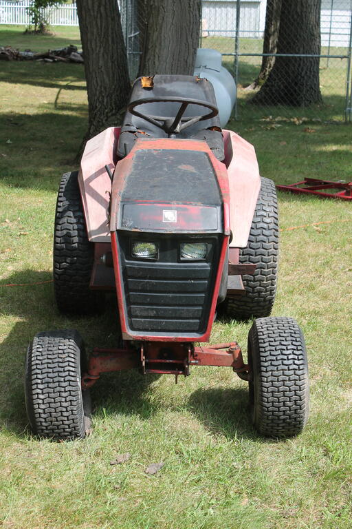

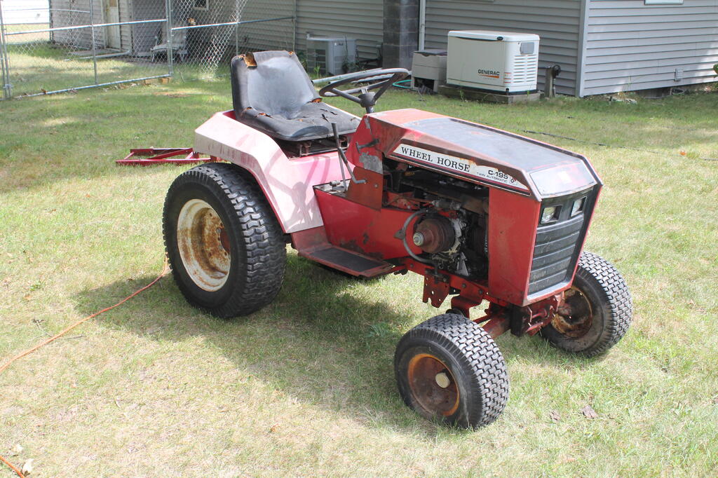

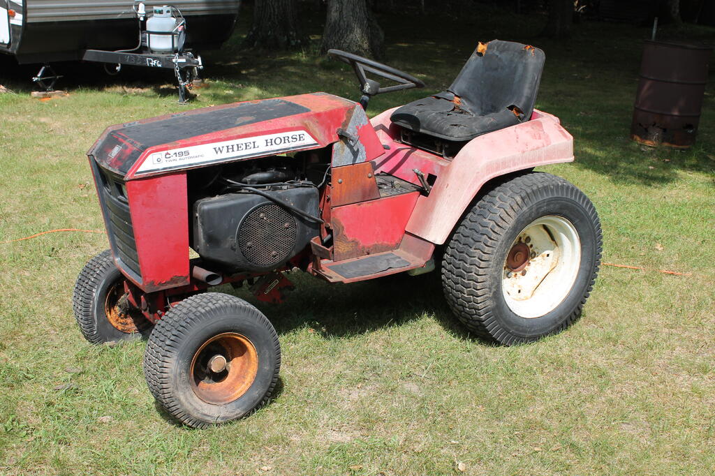

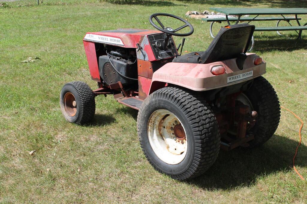

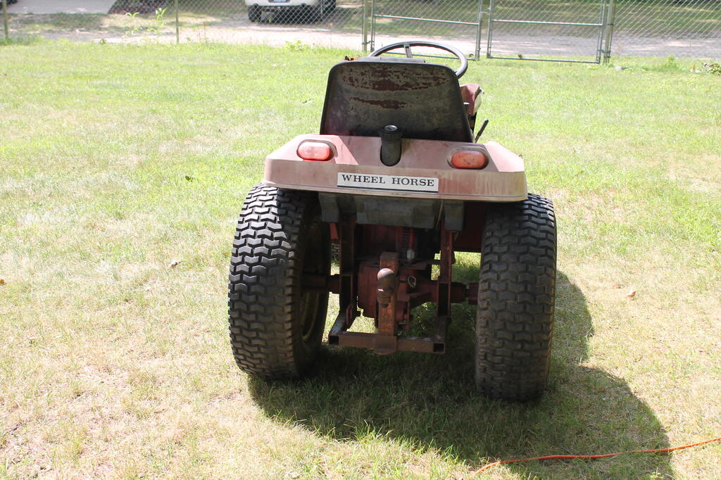

8ntruck 9,293 #1 Posted August 25, 2021 Last week @Matt Lemanski posted about a C 195 that he had saved from the scrap man. It was a tractor he kind of fell into and couldn't pass up, and he was not sure what to do with it. Well, we exchanged some PM's and came up with a price that was agreeable to both of us. Last Saturday, I brought what appears to be an early production C 195 home. Here are some pictures: 5 13 Share this post Link to post Share on other sites
