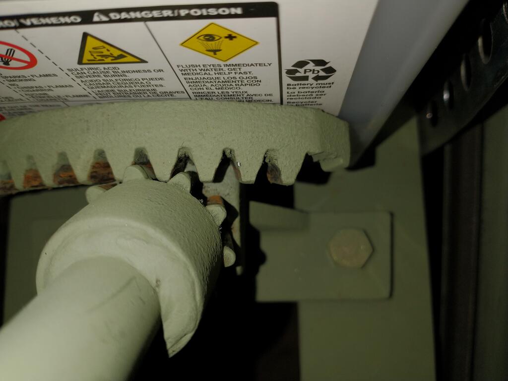

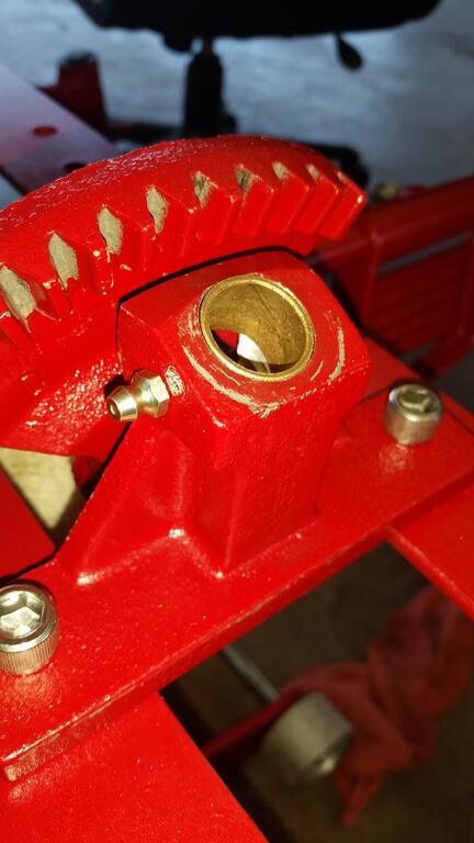

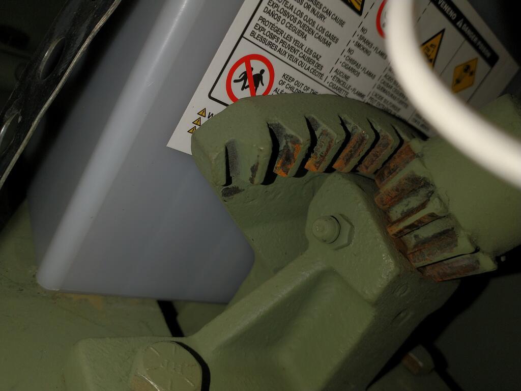

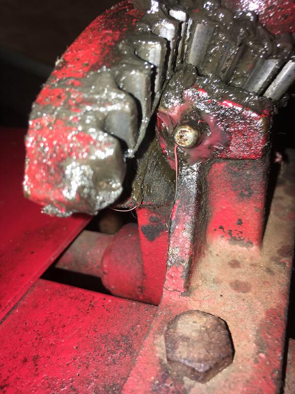

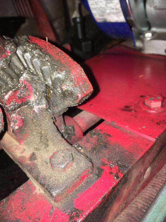

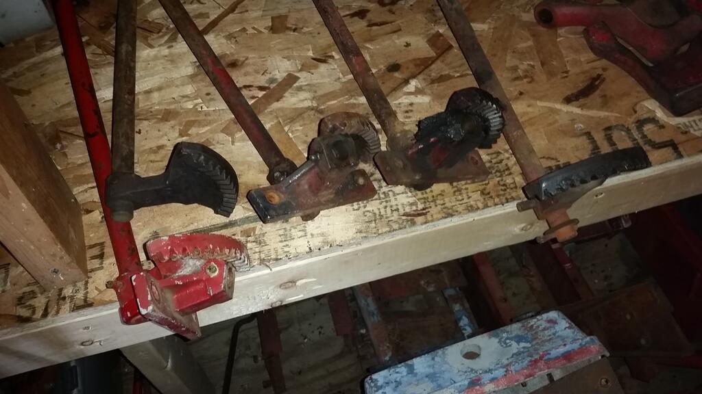

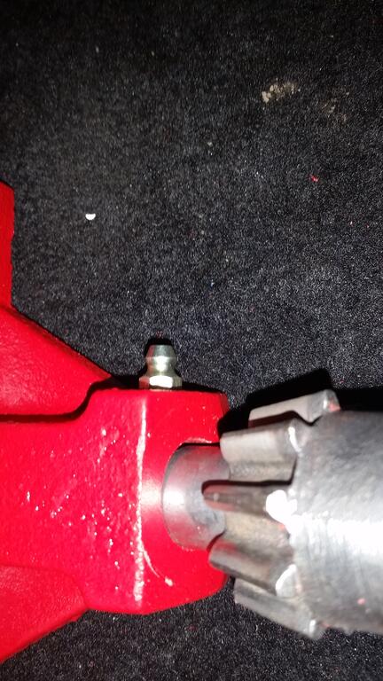

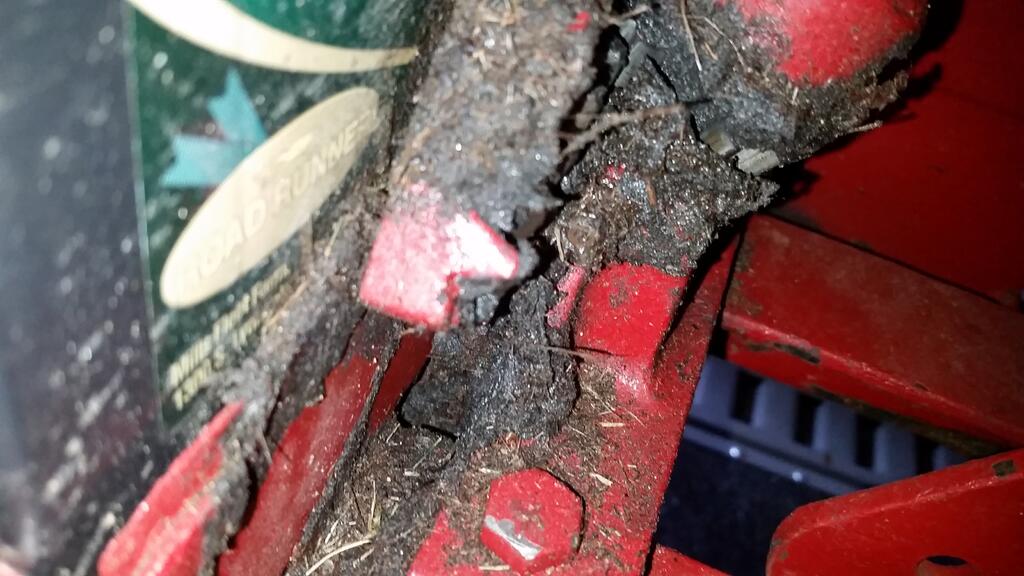

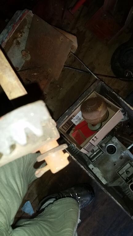

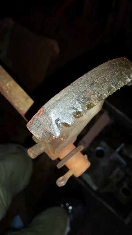

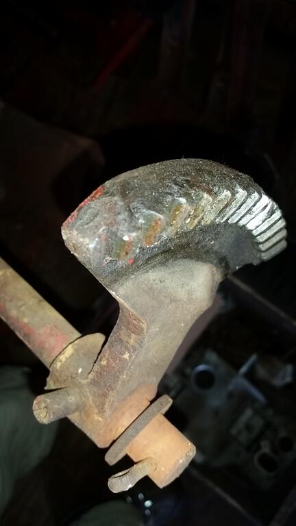

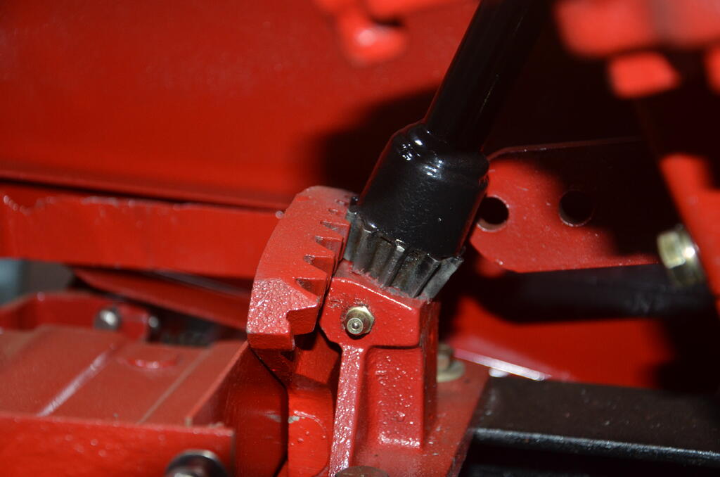

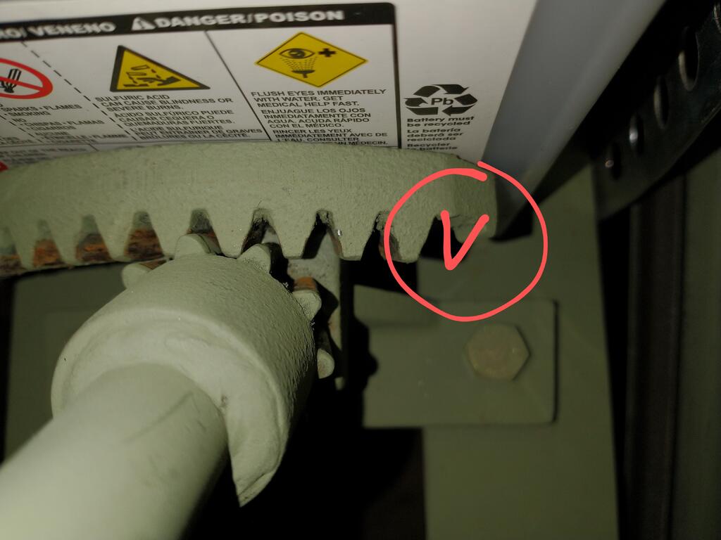

WHX?? 56,742 #1 Posted August 11, 2021 (edited) So the other day EB @ebinmaine posts a wanted ad for a fan gear for an 856. The one he is doing military theme. So I pm him calls him a goomer and he shoulda just insulted me first as he knows I am a bit heavy on mid sixties parts. So I blaze a bath in the parts shed. I found one...or three... or a half dozen... So I ask him what happened to the old one ... outside teeth broke off he says and shows me this. So in looking at the one for a short frame I think will work I find this. So I says WTF looks like they were made that way?? So I march out to the horse barn scrape away some grease and find this on my 856. Now he says one fer sure is broke off but I think he might be on crack.... they were cast this way. Thoughts fellas? Edited August 11, 2021 by WHX?? 1 1 2 Share this post Link to post Share on other sites
ebinmaine 79,053 #2 Posted August 11, 2021 Ya oughtta toss one over this way. 1 Share this post Link to post Share on other sites
ebinmaine 79,053 #3 Posted August 11, 2021 Turns out only one teefs is broke. Share this post Link to post Share on other sites
WHX?? 56,742 #4 Posted August 11, 2021 (edited) Thinkin that's a casting flaw dingus??? Lemme ask you this does that tooth engage before it hits the stops? Raining pitch forks and hammer handles here so I ain't gonna go out and look! Edited August 11, 2021 by WHX?? Share this post Link to post Share on other sites
WheelHorse520H 710 #5 Posted August 11, 2021 Just guessing but I think they did that on purpose. When you turn the wheel if the end ones mesh then when you try to turn the other way the gears aren’t lined up. It stops you from over steering, now that I think about it though I remember the stops on the axles. My 520 and 607 both have those I believe. Share this post Link to post Share on other sites
ebinmaine 79,053 #6 Posted August 11, 2021 1 minute ago, WHX?? said: Thinkin that's a casting flaw dingus??? I can get better pic. That one side is a absolutely a busticated tooth Share this post Link to post Share on other sites
WHX?? 56,742 #7 Posted August 11, 2021 520 don't count WH520 that's a totally different animal .... go check the 607 tho and let us know if they are there. Share this post Link to post Share on other sites

ZXT 2,402 #9 Posted August 12, 2021 Seems obvious to me that there is a tooth missing. On Eric's there is a broken, jagged gap between another tooth and the "flat" tooth you're seeing on your gears. 1 Share this post Link to post Share on other sites

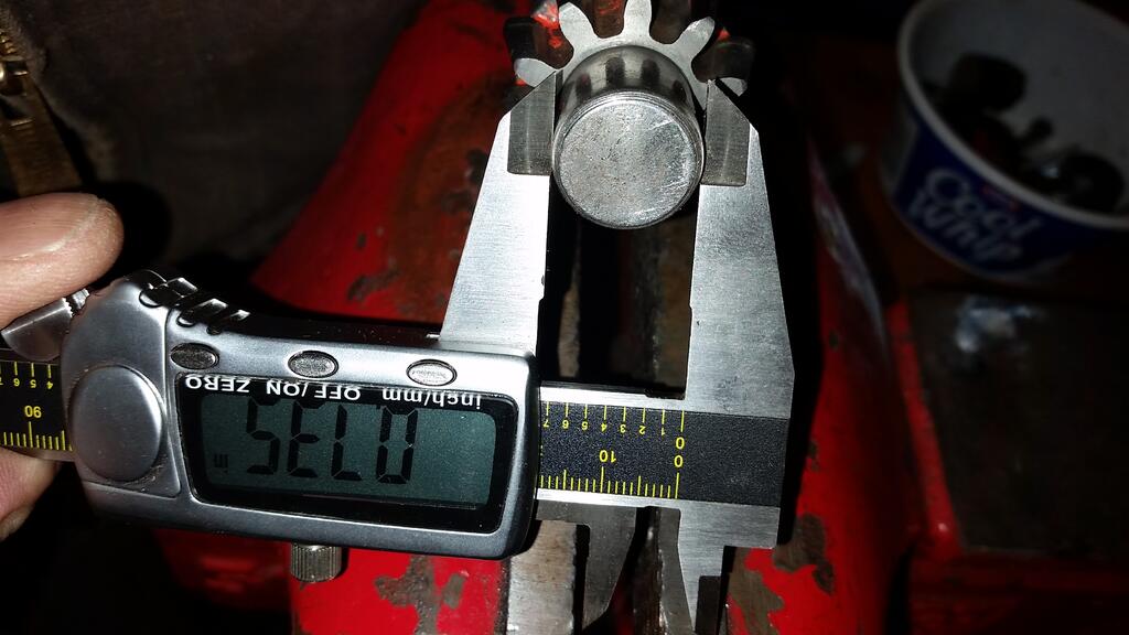

D_Mac 9,335 #10 Posted August 12, 2021 All I know is that I need the other gear. The small round one on the end of the shift. @Shynontold me he had one. Can't you count the teeth on those fan gears? If it isn't broke off they should have the same amount correct? 3 Share this post Link to post Share on other sites
ZXT 2,402 #11 Posted August 12, 2021 1 minute ago, D_Mac said: If it isn't broke off they should have the same amount correct? One would think Oh, and Eric, put some stinkin' grease on those gears and in those zerks! 1 2 Share this post Link to post Share on other sites

WheelHorse520H 710 #13 Posted August 12, 2021 (edited) Alright fellas, here is the verdict from the grand 607 jury. No broken teeth, I know the pictures are showing a lot of grease but I wiped it up with a paper towel and could feel the full teeth on either side. Edited August 12, 2021 by WheelHorse520H 1 1 Share this post Link to post Share on other sites

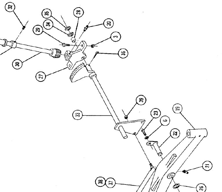

WHX?? 56,742 #14 Posted August 12, 2021 13 hours ago, ebinmaine said: Ya oughtta toss one over this way. I can send one but it's gonna look just like the one you got. I would need the length of the shaft tho if you want the whole assembly as they all seem to have the triangle welded on at different points. IPL shows as the whole assembly. Share this post Link to post Share on other sites

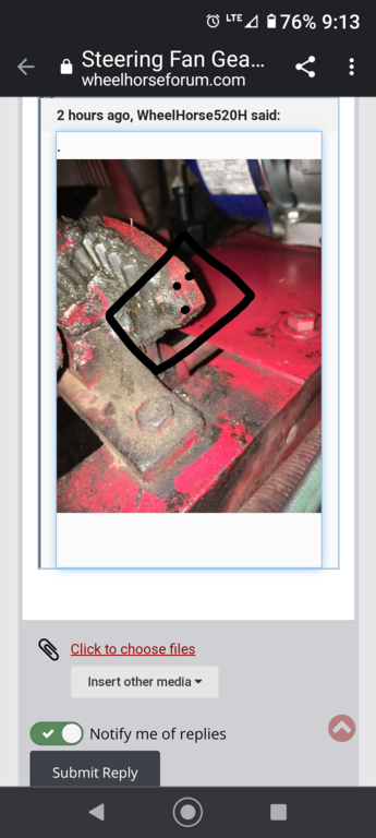

ebinmaine 79,053 #15 Posted August 12, 2021 2 hours ago, WheelHorse520H said: . 21 minutes ago, WHX?? said: I can send one but it's gonna look just like the one you got. I would need the length of the shaft tho if you want the whole assembly as they all seem to have the triangle welded on at different points. IPL shows as the whole assembly. Super cool Mr Jim. Thanks. It's tough to see the one on Trina's tractor because we don't have it at the right angle. If you look at the picture that I doctored with the black square you can see where there's a nub on the outside I put ONE DOT on. Right next to it there's an actual tooth that I put TWO DOTS on. We have the nub on the outside which is I believe, what you're looking at. What we don't have is that tooth. There's one entire tooth missing off of one side of her gear. I'll get a length for you and send you a PM at some point. 1 Share this post Link to post Share on other sites
Lee1977 7,638 #16 Posted August 12, 2021 17 hours ago, ebinmaine said: Turns out only one teefs is broke. The gears are not meshing right. You need to find what is causing it. Could be the fan gear needs shiming or the hole in the steering block is worn or both. The steering shaft could be worn too. 2 Share this post Link to post Share on other sites
ebinmaine 79,053 #17 Posted August 12, 2021 1 minute ago, Lee1977 said: The gears are not meshing right. You need to find what is causing it. Could be the fan gear needs shiming or the hole in the steering block is worn or both. The steering shaft could be worn too. Yes sir. Agreed. Trina and I were looking at that last night. She knows it has the right amount of shims in it. She slapped the whole tractor together in kind of a hurry just to make it so it would run and drive for the show and neither one of us remembers if the pillow block or the shafts were worn. She can take a closer look at all that stuff once we get a couple more new parts. 1 1 Share this post Link to post Share on other sites

squonk 46,728 #19 Posted August 12, 2021 See if you can wiggle the upper shaft in the block. Share this post Link to post Share on other sites

squonk 46,728 #22 Posted August 13, 2021 25 minutes ago, RJ Hamner said: ??? at 55 years old some "wiggle" is to be expected. But, yes there is a small amount of movement but not much. Wait a minute...which shaft are we trying to "wiggle" I am sooooo confused The shaft from the steering wheel. If the block on the frame has a wallowed out hole, the small gear moves away from the fan gear and ruins the teeth or skips . 1 Share this post Link to post Share on other sites

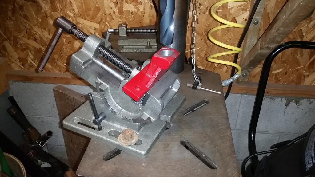

WHX?? 56,742 #23 Posted August 13, 2021 Like this Bob.... 2 Share this post Link to post Share on other sites
ebinmaine 79,053 #24 Posted August 13, 2021 6 minutes ago, WHX?? said: How does one find a vise that keeps an angle like that? Share this post Link to post Share on other sites
WHX?? 56,742 #25 Posted August 13, 2021 (edited) 5 minutes ago, ebinmaine said: one find a vise The scrap pile out back of my HVAC shop.!!! Still can't believe someone was tossing it. The lead screw is abit bent so doesn't close all the way but still very usable. The flat vise right behind it was with it. Edited August 13, 2021 by WHX?? 1 Share this post Link to post Share on other sites
