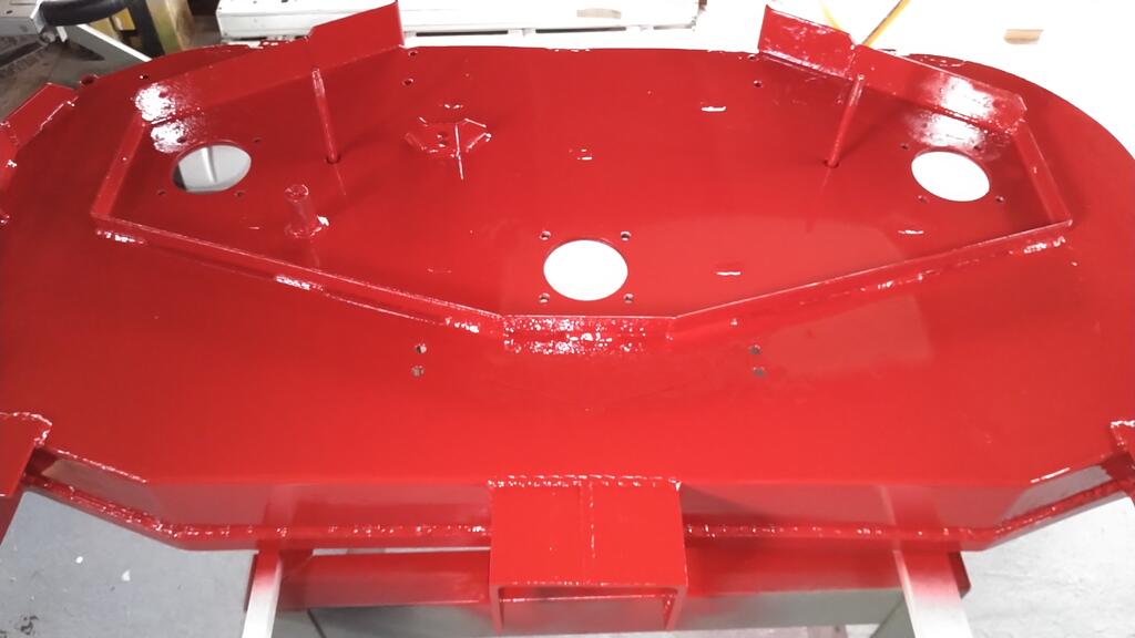

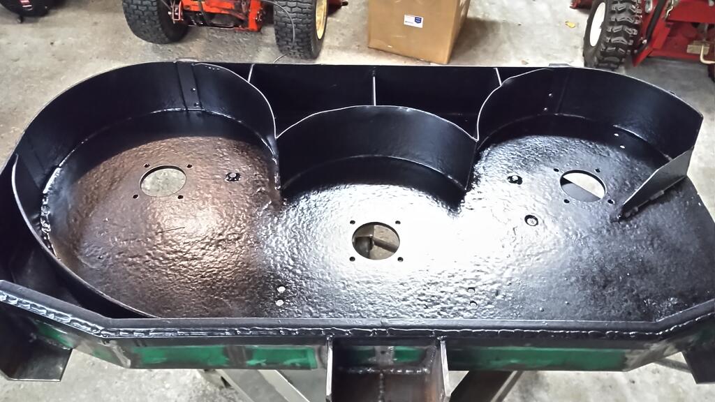

Bill D 2,834 #77 Posted October 26, 2021 Progress being made. One coat of POR 15 and two coats of Rust-Oleum spray on truck bed liner. Should keep the rust at Bay. 2 2 1 Share this post Link to post Share on other sites
Handy Don 16,479 #78 Posted October 26, 2021 I'm starting to thing the only sure path to a rust free deck is stainless steel! 1 1 Share this post Link to post Share on other sites
kpinnc 18,118 #79 Posted October 26, 2021 10 hours ago, Bill D said: Progress being made. One coat of POR 15 and two coats of Rust-Oleum spray on truck bed liner. Should keep the rust at Bay. Looking great Bill! I gotta get mine finished! 1 Share this post Link to post Share on other sites

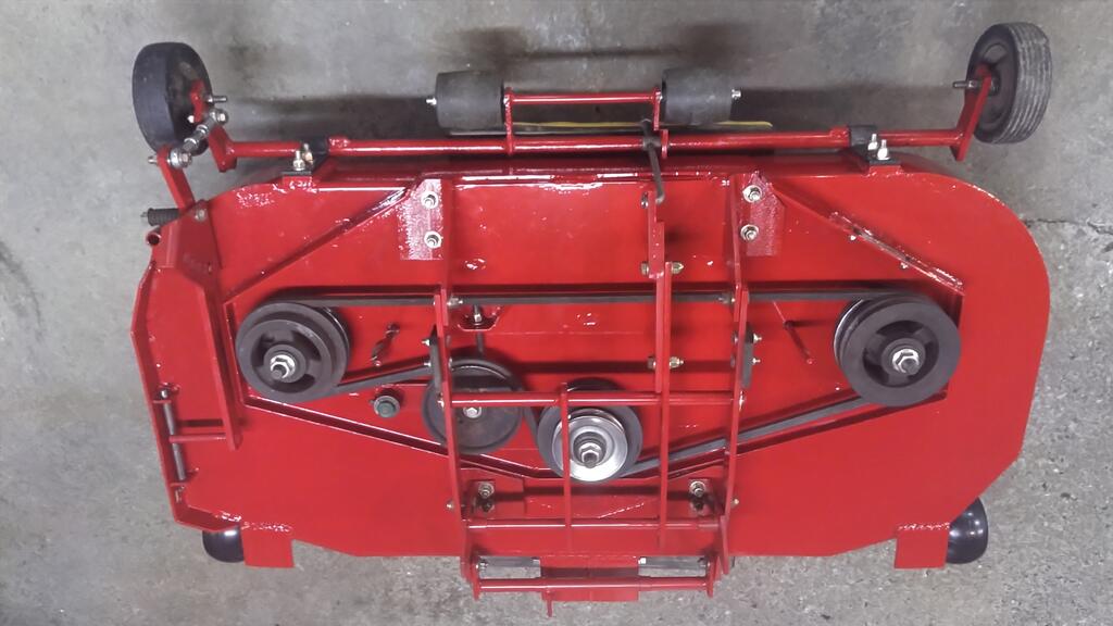

Bill D 2,834 #82 Posted October 30, 2021 Thanks for all the nice words Pete. Here's another picture for you. I hope to have it assembled next week. 3 Share this post Link to post Share on other sites

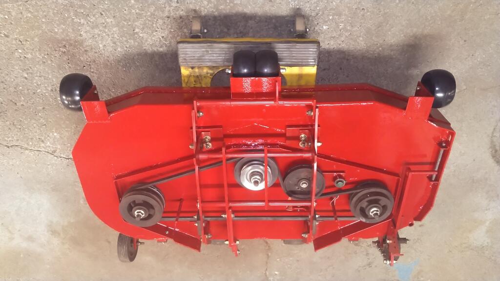

Bill D 2,834 #84 Posted November 6, 2021 Back together and ready to work. I still need to cut down the old belt cover and paint it. I don't usually run belt covers but I might need to on this one. 2 4 Share this post Link to post Share on other sites
peter lena 9,874 #85 Posted November 6, 2021 @Bill D terrific job on that , if i may suggest , notice your last 2 photos , unsupported long back belt area? added a single flat idler just about opposed center spindle drive , also got an idler with wide rubber side shields , to easily remove and clean out before lucas xtra heavy grease . put idler on back side toward rear of deck . have that on all my decks , stops that high speed belt bounce . just an idea, pete Share this post Link to post Share on other sites

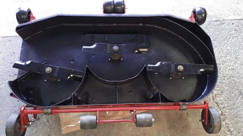

Bill D 2,834 #86 Posted November 6, 2021 I mowed with it yesterday. Great cut. Air flow isn't great like @kpinnc's Exmark deck. If I had been able to roll some baffles that would have helped a lot. I am getting a lot of clipping discharge out of the front edge. If I do something like this again I plan to use a Husqvarna or Exmark deck as a starting point. Still, it's been a fun project. 2 Share this post Link to post Share on other sites
1995 520H+96+97 939 #87 Posted November 6, 2021 Do you have some straight blades you could try? Share this post Link to post Share on other sites
Bill D 2,834 #88 Posted November 6, 2021 2 hours ago, 1995 520H+96+97 said: Do you have some straight blades you could try? No I don't. It has new high lift blades on it. There isn't an option for that style blade on this deck. 1 Share this post Link to post Share on other sites
kpinnc 18,118 #89 Posted November 7, 2021 It looks outstanding to me! I would experiment with lower lift blades and see if it helps. In my opinion, you have plenty of baffeling in there. I ran mine this morning with no gage wheels. I do not recommend it! still, my wheel setup needs some love. 1 Share this post Link to post Share on other sites

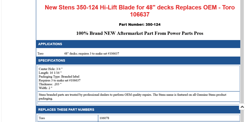

1995 520H+96+97 939 #90 Posted November 7, 2021 I assume you have 3/4" hole, 16 1/16 length. Your blades look like they are even (flush) with the bottom of the deck. Share this post Link to post Share on other sites
Bill D 2,834 #91 Posted November 7, 2021 (edited) On 11/7/2021 at 2:18 AM, 1995 520H+96+97 said: I assume you have 3/4" hole, 16 1/16 length. Your blades look like they are even (flush) with the bottom of the deck. This deck, like most commercial decks, uses blades with a 5/8" hole. As you can see the blades are not the flat style like the wheel horse blades. Edited November 8, 2021 by Bill D 1 Share this post Link to post Share on other sites
Bill D 2,834 #92 Posted November 7, 2021 13 hours ago, kpinnc said: It looks outstanding to me! I would experiment with lower lift blades and see if it helps. In my opinion, you have plenty of baffeling in there. I ran mine this morning with no gage wheels. I do not recommend it! still, my wheel setup needs some love. Still waiting to see what you come up with. I'm picking up an Exmark walk behind later this week. I'm going to do it again. Don't ask me why. 2 Share this post Link to post Share on other sites
Bill D 2,834 #93 Posted November 7, 2021 On 11/6/2021 at 9:04 AM, peter lena said: @Bill D terrific job on that , if i may suggest , notice your last 2 photos , unsupported long back belt area? added a single flat idler just about opposed center spindle drive , also got an idler with wide rubber side shields , to easily remove and clean out before lucas xtra heavy grease . put idler on back side toward rear of deck . have that on all my decks , stops that high speed belt bounce . just an idea, pete Thanks for the idea. Doesn't seem to need it though. The combo of a 5/8" belt and OEM style belt tensioner seems to have eliminated belt slap. 2 Share this post Link to post Share on other sites
kpinnc 18,118 #94 Posted November 8, 2021 (edited) 13 hours ago, Bill D said: This deck, like most commercial decks, uses blades with a 5/8" hole. The tips of the blades are actually about 3/4" below the lip of the deck. Ad you can see the blades are not the flat style like the wheel horse blades. I'm thinking something isn't right. My deck's leading edge is about 1/2 inch lower than the blades. It has extra 1/4 bushings to lower the blades, but I did not use them. I assume this is due to very little adjustment otherwise on a walk behind... Your blades being 3/4 of an inch lower than the deck edge will completely defeat any baffling, and certainly throw clippings out the front. Any chance yours has spacers under the spindles? Edited November 8, 2021 by kpinnc 1 Share this post Link to post Share on other sites
Bill D 2,834 #95 Posted November 8, 2021 26 minutes ago, kpinnc said: I'm thinking something isn't right. My deck's leading edge is about 1/2 inch lower than the blades. It has extra 1/4 bushings to lower the blades, but I did not use them. I assume this is due to very little adjustment otherwise on a walk behind... Your blades being 3/4 of an inch lower than the deck edge will completely defeat any baffling, and certainly throw clippings out the front. Any chance yours has spacers under the spindles? My mistake, the front edge of the deck is 3/4" below the blade tips. 1 Share this post Link to post Share on other sites
kpinnc 18,118 #96 Posted November 8, 2021 14 minutes ago, Bill D said: My mistake, the front edge of the deck is 3/4" below the blade tips. Ok, that sounds about right. Well shucks! I thought we figured out what was wrong! 1 Share this post Link to post Share on other sites
