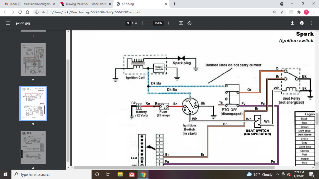

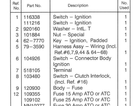

Gregor 4,848 #13 Posted August 8, 2021 This pic is from the manual for the 1994 Wheel Horse 314-H The wiring harness is Ref. No. 5, Part # 79-3590. You may find one on ebay or somewhere, but who's to say it's any better than what you have. 1 Share this post Link to post Share on other sites
westprw8@gmail.com 0 #14 Posted August 8, 2021 Yes sir this is what my book shows to I seen some on ebay but they are used thanks Share this post Link to post Share on other sites

953 nut 68,159 #20 Posted August 8, 2021 Do as Gary @gwest_ca suggested, use a 12 volt test light (best) or meter to replace the fuse for testing. Remove the fuse and connect the test light to the two fuse holder connections. Now when the short is present the test light will be bright and when you clear the short to ground the light will go off. At some point a wire is touching the chaises if the tractor or there is a component that has an internal ground. Take a look at the wiring diagram below, the seat switch and seat switch relay and the wires that go to them should be examined closely. Share this post Link to post Share on other sites
