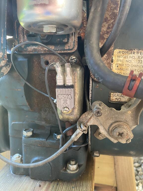

formariz 12,381 #1 Posted August 5, 2021 I have a substantial number of K91s that reside outside. Inevitably points always oxidize making them hard to start or not starting at all. My solution is to eliminate points and substitute them with NOVA II electronic module. Instant starts in any kind of weather regardless how long they sit. Also automatic instant perfect timing. A convenient place to install it is on points cover by removing push button and spring. 2 4 1 Share this post Link to post Share on other sites

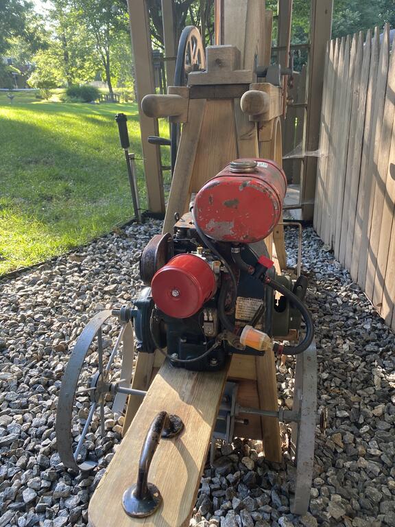

formariz 12,381 #9 Posted August 6, 2021 (edited) 5 hours ago, Dirty Dingus Magee said: i am curious , why do you have all these motors sitting outside? They don’t sit by themselves.Let’s see. Totally exposed to weather. K91s only . There are others but I only use the modules on these. 3 fully operable RJs that wife has taken over as lawn ornaments . 1 log splitter 1 grindstone forgot one Techy H40 also Edited August 6, 2021 by formariz Share this post Link to post Share on other sites
formariz 12,381 #10 Posted August 6, 2021 4 hours ago, pullstart said: Is there a more involved thread on the conversion process? It’s very simple. One merely removes ignition wire from points and attaches it to positive of module. Connect module ground wire to engine. it’s done. You don’t even have to attach module if you don’t want to since it is so small and weighs nothing. if it does not fire, reverse connections. For whatever reason half of the K91s I have them on work that way with negative attached to ignition wire. 1 Share this post Link to post Share on other sites
