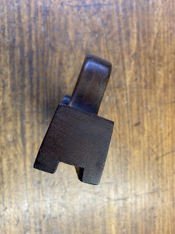

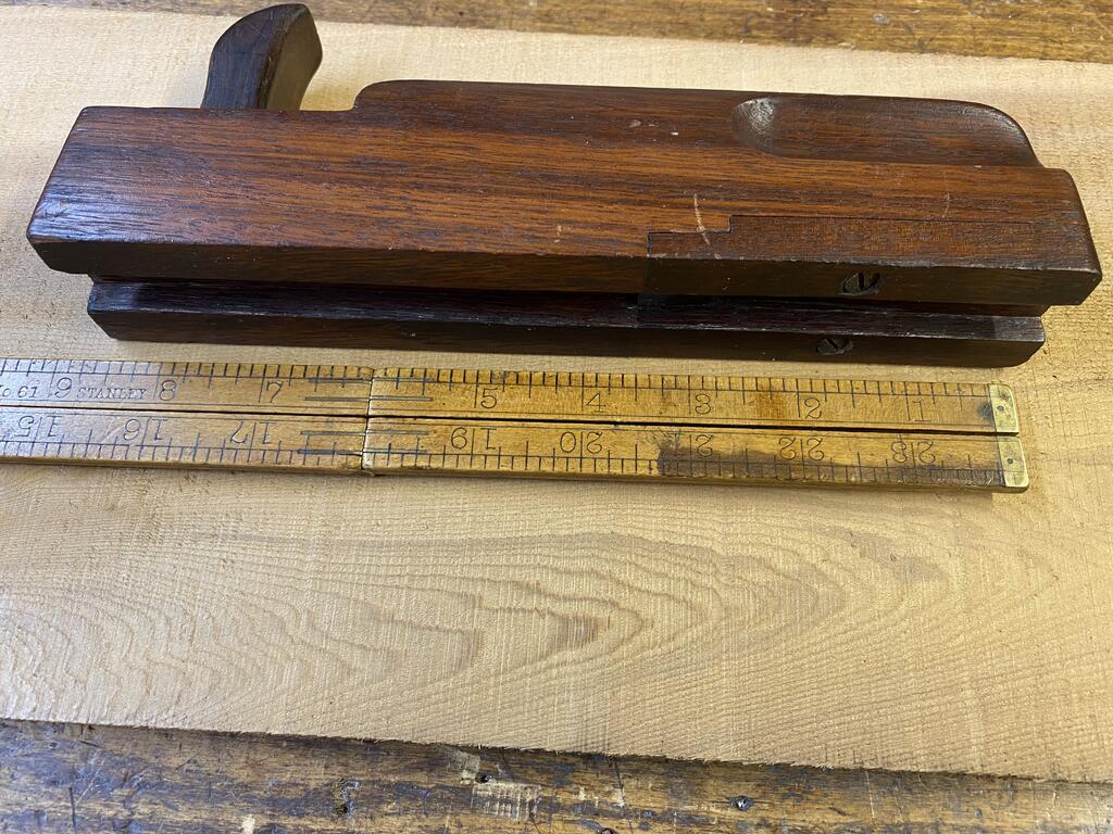

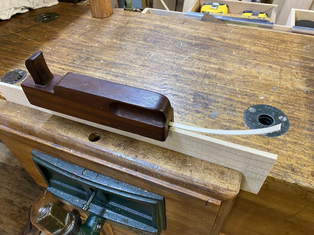

formariz 12,379 #1 Posted August 5, 2021 Been in a bit of a rut here so I need to get myself out of it. Here is a challenging one. Digging deep in the arsenal I came up with this one. It is a plane obviously and it is user made . Overall shape and design of plane is unique since it is user made. The results of its application however is something that most of us older folks with knowledge of traditional arts should be familiar with. Can we come up with it’s intended function? 1 Share this post Link to post Share on other sites

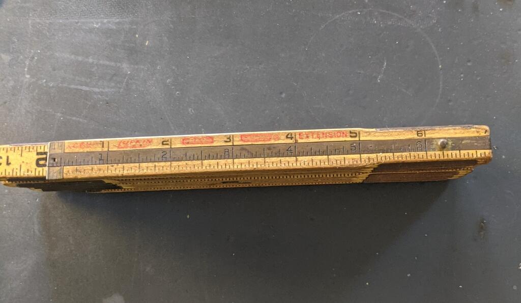

stevasaurus 23,739 #2 Posted August 5, 2021 I love the look of that plane !! It looks like it will cut a 45 degree bevel like on a table top, or coffee table, etc. Possibly, a picture frame of mirror frame edge. 1 Share this post Link to post Share on other sites
Jeff-C175 7,209 #3 Posted August 5, 2021 Jointer plane for the edge of 1/2" boards? 1 Share this post Link to post Share on other sites

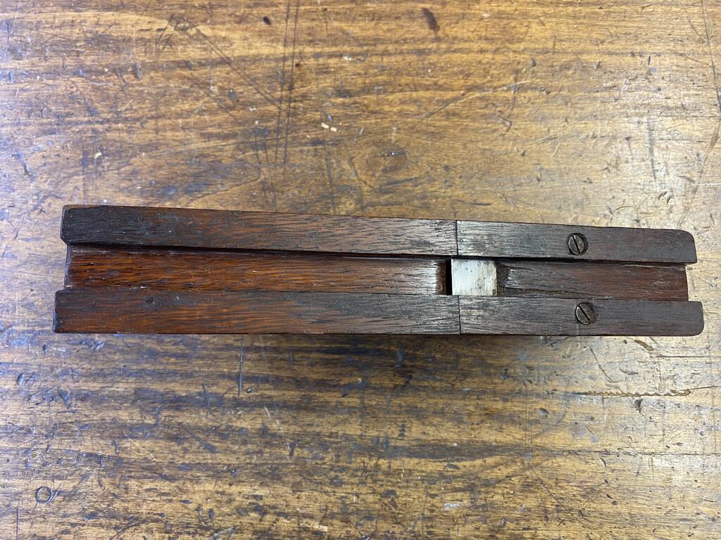

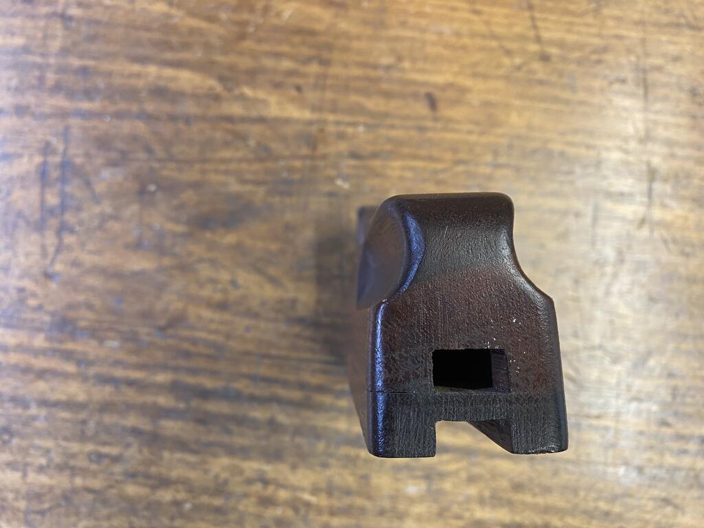

8ntruck 9,023 #5 Posted August 5, 2021 What is the orientation of the iron to slot in the sole and the opening in the back of the plane? Maybe it is used to peel 1/2 inch wide strips of veneer off of a plank? Share this post Link to post Share on other sites

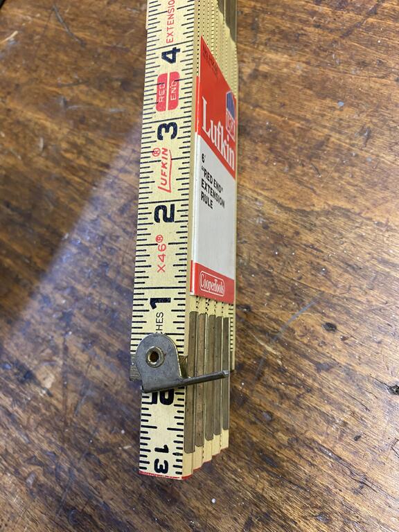

formariz 12,379 #11 Posted August 5, 2021 (edited) 4 hours ago, squonk said: Even you rulers rule! LOL. Interesting little tidbit of information on cabinet makers rulers only. In the US they read right to left. Our friends’s across the pond they read left to right. This only happens on cabinet maker’s rulers and not carpenter’s rulers . Those read left to right on both sides of Atlantic. Edited August 5, 2021 by formariz 1 2 Share this post Link to post Share on other sites
formariz 12,379 #12 Posted August 5, 2021 3 hours ago, 8ntruck said: What is the orientation of the iron to slot in the sole and the opening in the back of the plane? Maybe it is used to peel 1/2 inch wide strips of veneer off of a plank? Slot is the throat where shaving comes out. it does make strips 1/2” or less but what for? Share this post Link to post Share on other sites
953 nut 67,297 #13 Posted August 5, 2021 16 minutes ago, formariz said: it does make strips 1/2” or less but what for? Are the strips for basket weaving? 1 Share this post Link to post Share on other sites

8ntruck 9,023 #15 Posted August 6, 2021 (edited) It would be real handy to make hull and deck planks for model boats. Probably not the intended use, though. Woven chair seats? How thick are the strips this plane makes? Neat bit of trivia on the rules. Being left handed, I would have assumed you had left and right handed rules..... Edited August 6, 2021 by 8ntruck Share this post Link to post Share on other sites

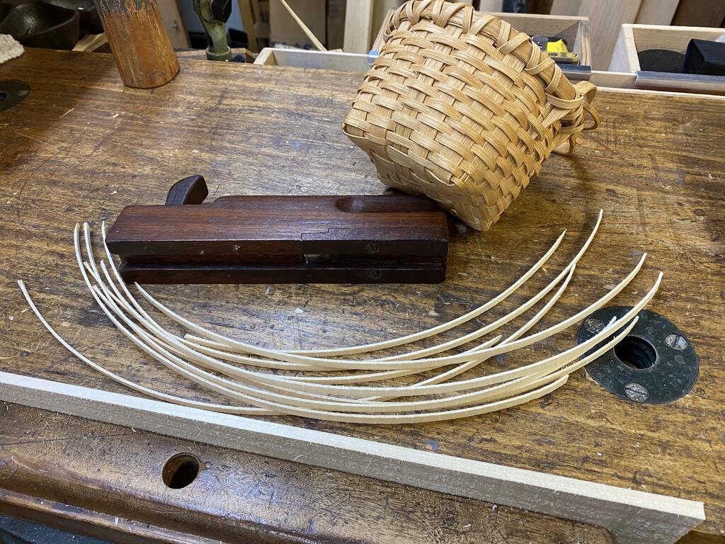

formariz 12,379 #16 Posted August 6, 2021 51 minutes ago, 953 nut said: Are the strips for basket weaving? Correct. It is a “splint “plane. Similar to a “spill” plane with the exception that it produces thicker straight strips where a spill plane produces a long curly strip. Instead of hand splitting strips which is actually a much better way to do it although time consuming, one makes strips with plane. Next they are smoothed and thinned down a little more by scraping them with a knife. One then steams them or soak them to make them more pliable and stronger. Ideally one starts already with a “ green” board with very straight grain usually ash. 1 4 1 2 Share this post Link to post Share on other sites
formariz 12,379 #17 Posted August 6, 2021 (edited) 35 minutes ago, 8ntruck said: How thick are the strips this plane makes? It makes full 1/16” strips. 35 minutes ago, 8ntruck said: Neat bit of trivia on the rules. Being left handed, I would have assumed you had left and right handed rules With this exception of US cabinet makers rulers they are all oriented the same way reading left to right. Edited August 6, 2021 by formariz 1 Share this post Link to post Share on other sites

rjg854 13,165 #19 Posted August 6, 2021 12 hours ago, formariz said: LOL. Interesting little tidbit of information on cabinet makers rulers only. In the US they read right to left. Our friends’s across the pond they read left to right. This only happens on cabinet maker’s rulers and not carpenter’s rulers . Those read left to right on both sides of Atlantic. That's the way my rulers are Nice tidbit of information 2 Share this post Link to post Share on other sites
ebinmaine 79,553 #20 Posted August 6, 2021 12 hours ago, Zeek said: Nice, would have never guessed that! I love this game Agreed. @formariz good stuff man. Thanks for posting. I don't always try to get in on the answers but it's interesting to see them. 1 Share this post Link to post Share on other sites
formariz 12,379 #21 Posted August 6, 2021 (edited) 3 hours ago, rjg854 said: That's the way my rulers are Nice tidbit of information I don’t know if you are aware that a different version of that ruler exists that is much more convenient due to the retractable “hook”. Those are essentially the ones I use 99% of time. They are however scarce and hard to find. Edited August 6, 2021 by formariz Share this post Link to post Share on other sites
rjg854 13,165 #22 Posted August 6, 2021 I do believe I have at least one like that, it's been a while since I've seen it. I've got stuff in boxes that haven't seen the light of day in years, plus I have all of Dad's tools. And he's been gone close to 40 years. When I was working, framing for the last 15 years, those rulers wouldn't have lasted long. Share this post Link to post Share on other sites
Zeek 2,299 #23 Posted August 7, 2021 My dad used to have those foldable rulers. I still remember to this day pinching the crap out of my fingers with them 1 1 Share this post Link to post Share on other sites
ebinmaine 79,553 #24 Posted August 7, 2021 56 minutes ago, Zeek said: My dad used to have those foldable rulers. I still remember to this day pinching the crap out of my fingers with them My Grampa had em. I couldn't believe anyone in their right mind would use one. 1 Share this post Link to post Share on other sites
Handy Don 16,918 #25 Posted August 7, 2021 1 hour ago, ebinmaine said: My Grampa had em. I couldn't believe anyone in their right mind would use one. Hmmm. I still use my 6-footer all the time and I have an 8-footer that is handy on some jobs. 3 Share this post Link to post Share on other sites
