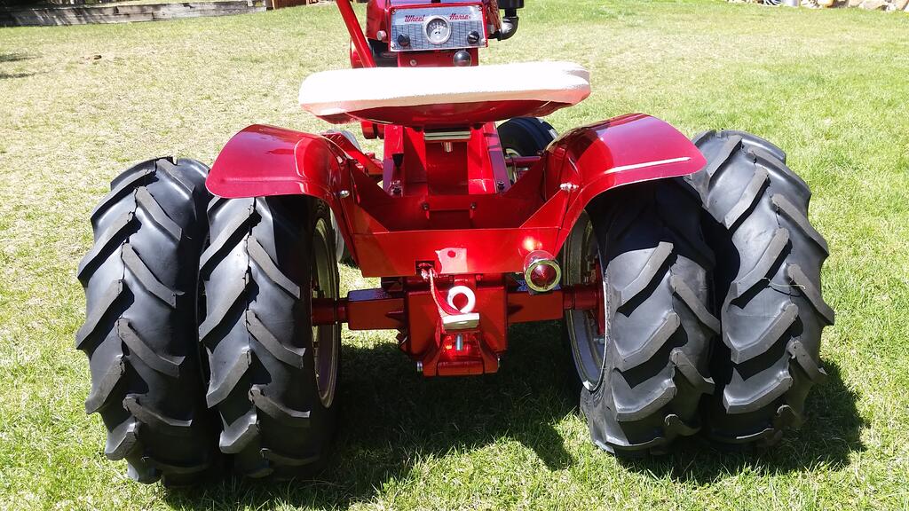

JoeM 10,317 #1 Posted August 3, 2021 Seen this guy's stuff on FB, interesting concept. 1 Share this post Link to post Share on other sites
ebinmaine 81,047 #2 Posted August 3, 2021 Is that the 4 standard carriage bolts holding the wheels together with a piece of PVC between? Share this post Link to post Share on other sites
Pullstart 71,482 #3 Posted August 3, 2021 1 hour ago, ebinmaine said: Is that the 4 standard carriage bolts holding the wheels together with a piece of PVC between? Possibly, that idea from what I recall originated with @SylvanLakeWH and “The WHRat WHrecker” around RedSquare. Still the only one I’ve seen personally and they work great! Those ones above, look like wheel blanks for the liters with simple tabs welded on. 1 Share this post Link to post Share on other sites
JoeM 10,317 #4 Posted August 3, 2021 2 hours ago, ebinmaine said: Is that the 4 standard carriage bolts holding the wheels together with a piece of PVC between? IDK it doesn't say but looks like metal. Touts them as custom made to order. 1 hour ago, pullstart said: looks like wheel blanks for the outers with simple tabs welded on For sure. I like how deep that side view, have to get a small kid to climb in there to start the lugs when wheels are assembled. 1 2 Share this post Link to post Share on other sites
ebinmaine 81,047 #5 Posted August 4, 2021 23 minutes ago, JoeM said: I like how deep that side view, have to get a small kid to climb in there to start the lugs when wheels are assembled Best I can do there is a BBT. No kid but pretty small. If'n I were to do this I'd bolt the wheels to the LUG BOLTS like any tractor should have then use the carriage bolts to attach the second wheel set. 1 Share this post Link to post Share on other sites

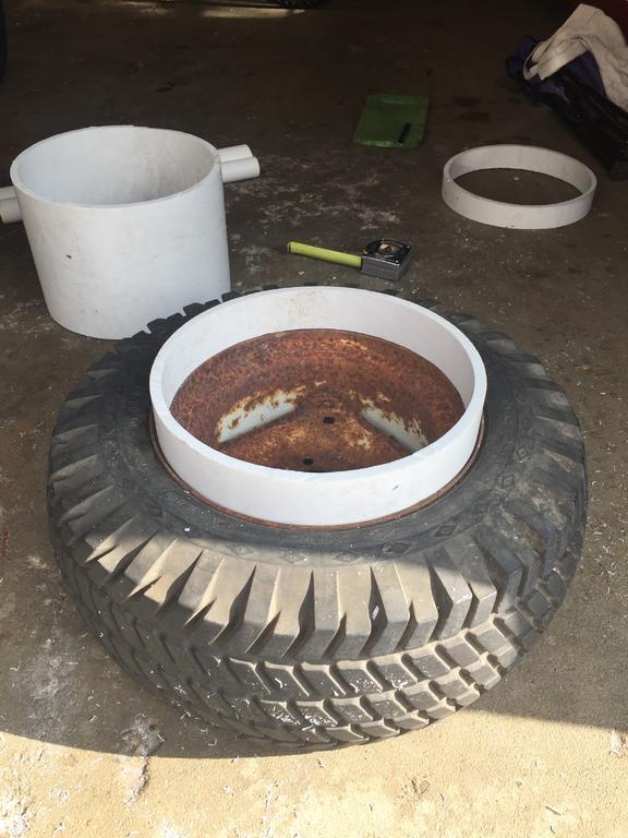

SylvanLakeWH 32,777 #6 Posted August 4, 2021 (edited) 2 hours ago, pullstart said: Possibly, that idea from what I recall originated with @SylvanLakeWH and “The WHRat WHrecker” around RedSquare. Still the only one I’ve seen personally and they work great! Those ones above, look like wheel blanks for the liters with simple tabs welded on. They do work great… easy too… cut 12” pvc pipe with a circular saw. Very solid. If I recall, The WHrat WHrecker’s are 2” wide… @pullstart has the rest of the 12” pvc pipe… I’m thinking business opportunity… can you say duality spacer kits? Edited August 4, 2021 by SylvanLakeWH 2 1 Share this post Link to post Share on other sites

RandyLittrell 3,946 #22 Posted August 20, 2021 On 8/3/2021 at 3:56 PM, ebinmaine said: Is that the 4 standard carriage bolts holding the wheels together with a piece of PVC between? That is how I do the duals on mine. I haven't had the duals on for awhile though. Randy 1 Share this post Link to post Share on other sites
