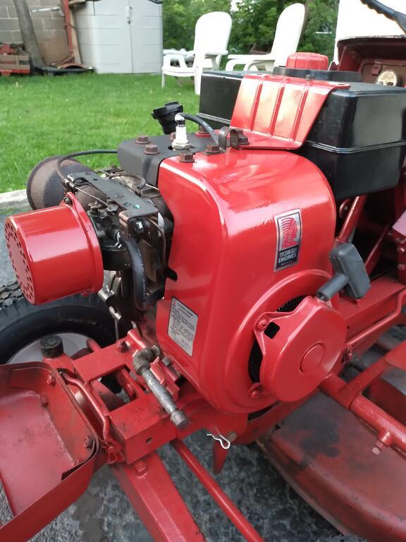

Greentored 3,221 #1 Posted August 3, 2021 (edited) Ok, maybe not 'pro', but most of you likely know by now, I know my way around internal combustion engines and carbs quite well haha, but this Tekky on the 655 'lil booger' has been driving me up a wall for almost a year of cutting grass! I cannot cut the lawn at the woman's postage stamp size property without making 2-3 carb adjustments. Everything has been cleaned and is spotless, throttle shaft is tight, 'jiggle rod' emulsion tube is free, engine is in good mechanical condition, governor adjusted correctly. It lights off so well that I don't even run a battery- the rope start has it purring often on the first pull. It has never idled 'clean'- it 'pops' or cuts out randomly and will sometimes stall if I dont keep the idle up a bit. Response is excellent, power is great, then as I'm mowing, it will suddenly begin to stumble and sputter, I'll hop off, tweak the main jet, and away she goes for another 5 minutes, then I repeat. If I get frustrated I sometimes yank the choke halfway and finish the yard. Points, plug, magneto air gap, fuel tank vent all correct. This is probably the 'tightest' early WH I may ever find- steering, pivot pin, spindles, hubs, deck and drive system, basically all the items that have usually seen better days- they are snug like new! Someone either didn't use this much, took very good care of it, or both. With that being said, as much as I'd love to toss a K181 on it, really would like to leave it original. Any ideas before this carb turns into a UFO across the yard? Edited August 3, 2021 by Greentored 1 Share this post Link to post Share on other sites

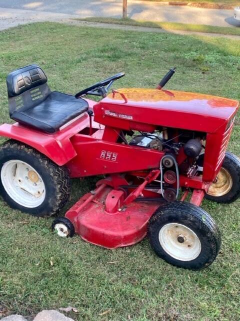

WHX?? 58,218 #9 Posted August 3, 2021 You know the more I look at your tractor Green the nicer it gets. I maybe best just come get it... I wouldn't think twice about dropping a K181 on it and calling it a 855. I'll even set you up with a gently used 857 for mowing duty. 2 Share this post Link to post Share on other sites
