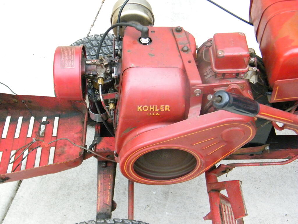

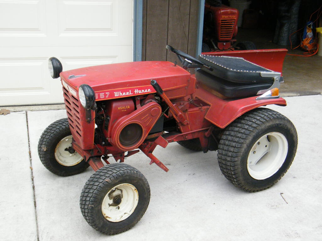

stevasaurus 23,742 #21 Posted July 26, 2021 Here is my 857. DSCF8744.MP4 1 Share this post Link to post Share on other sites
