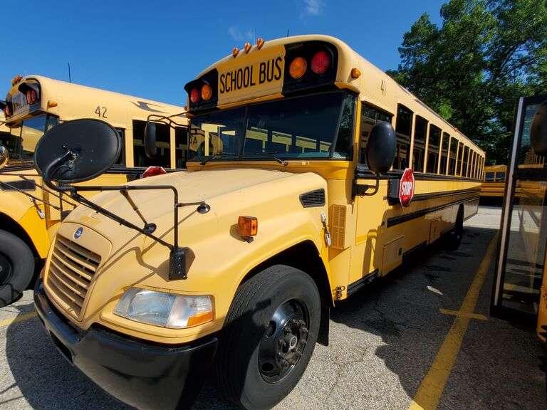

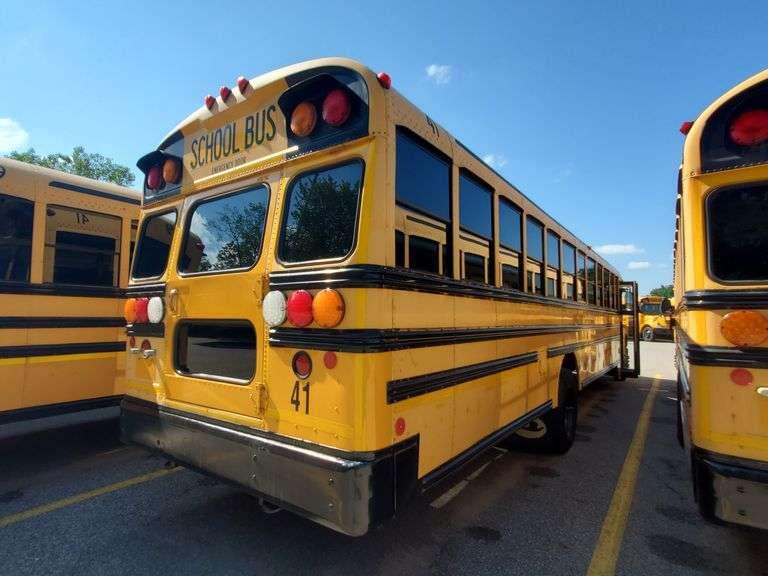

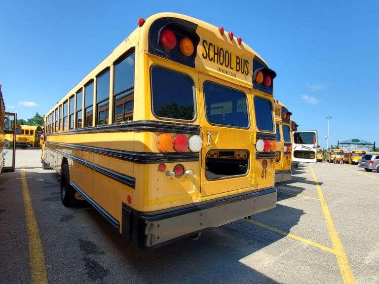

Pullstart 71,467 #1 Posted July 16, 2021 You’d think one of these would come with a hitch. 2 Share this post Link to post Share on other sites

adsm08 5,214 #11 Posted July 16, 2021 Just get one of the class 5 to class 2 adapters and weld that thing to the bumper. 1 Share this post Link to post Share on other sites
Pullstart 71,467 #12 Posted July 16, 2021 26 minutes ago, 19richie66 said: New hauler? 6.7 Cummins, Allison auto. Sounds bullet proof! 4 2 Share this post Link to post Share on other sites

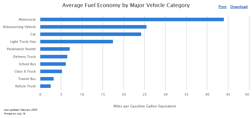

cafoose 3,882 #16 Posted July 16, 2021 1 hour ago, 19richie66 said: New hauler? I thought about that myself Gas mileage sucks 1 1 Share this post Link to post Share on other sites

8ntruck 9,356 #18 Posted July 16, 2021 I'd take a good look at the way the back bumper is attached before attaching as hitch to it. My neighbor runs the local school bus garage. He told me a story of how they hitched a chain to the rear bumper of a stuck bus and proceeded to pull the bumper off instead of getting the bus unstuck. Turns out that the attachment bolt holes in the bumper were horizontal slots while the frame brackets were vertical slots. Not an arrangement to be towing with. Share this post Link to post Share on other sites

953 nut 69,935 #23 Posted July 16, 2021 8 hours ago, cafoose said: Gas mileage sucks I don't think @pullstart plans to stop every few hundred feet to pick up little children. If he did he would probably be arrested! 4 Share this post Link to post Share on other sites
