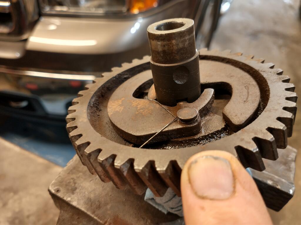

stevasaurus 23,884 #52 Posted July 13, 2021 Mike, can you take some good pictures of that camshaft, together and apart?? Show the marks and how it goes together, so we all can better understand what happened and what to look for?? Get in touch with Shynon for anything you need...that governor shaft with the flag should be easy. I think you can be sure the cam lobe was on wrong. It had to be. Share this post Link to post Share on other sites

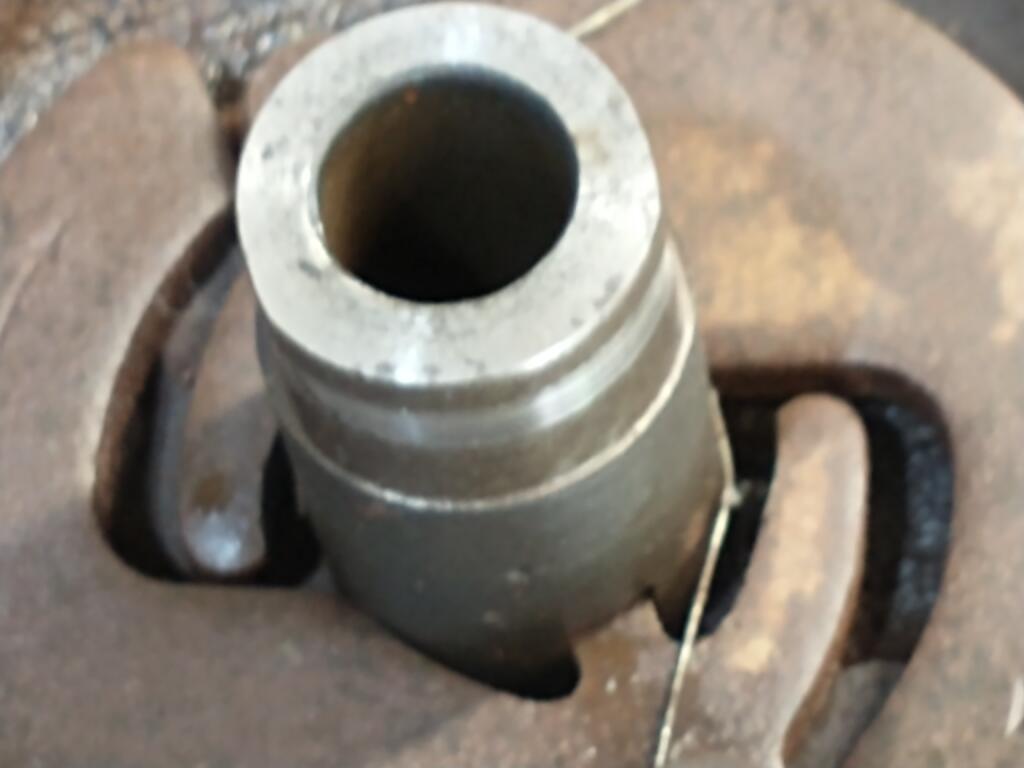

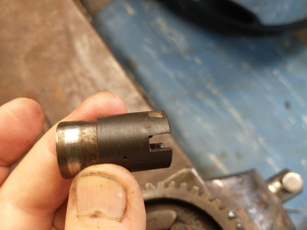

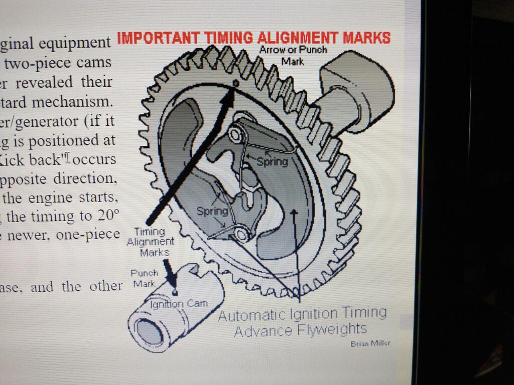

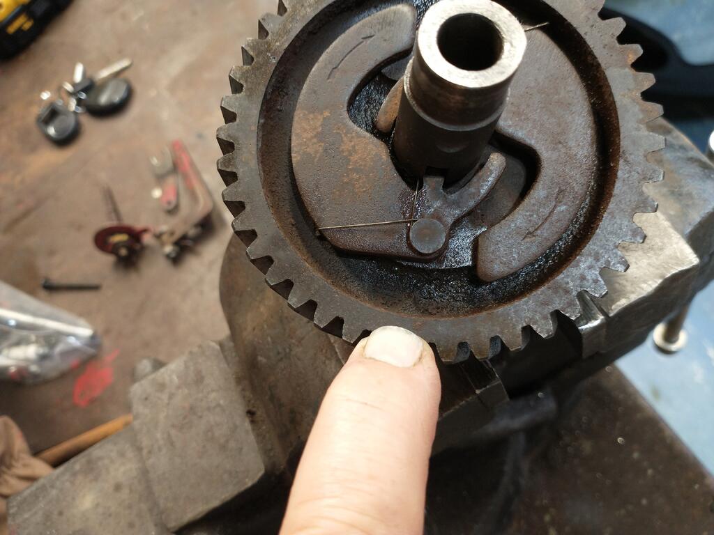

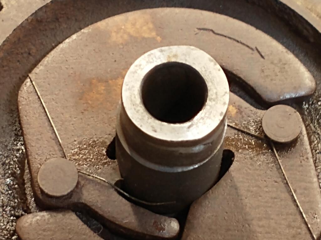

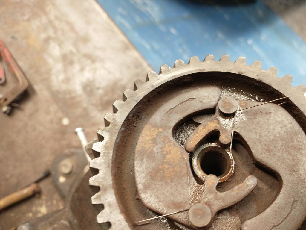

squonk 48,322 #53 Posted July 13, 2021 First picture is from Brian Millers site. He shows how to line up the points cam: I do not see a dot. But you can just make out an arrow where my finger is. The cam can only go on 2 ways so this must be the mark: The punch mark on the points cam lines up with the arrow (finger) Picture of the camshaft without the points lobe, I think the tiny spring finger thingy's go inside the slots of the points lobe. Points lobe: 1 1 Share this post Link to post Share on other sites
squonk 48,322 #54 Posted July 13, 2021 My big question is do the springs go inside of the slots or outside of the points lobe? I have a parts engine here. Now I know what to look for ,maybe I can determine where they go. Might as well tear it down. I can probably get the gov arm and cam washer out of it 2 Share this post Link to post Share on other sites

buckrancher 2,697 #59 Posted July 13, 2021 20 minutes ago, squonk said: My big question is do the springs go inside of the slots or outside of the points lobe? I have a parts engine here. Now I know what to look for ,maybe I can determine where they go. Might as well tear it down. I can probably get the gov arm and cam washer out of it outside of point lobe and yes you can change to the acr cam 1 Share this post Link to post Share on other sites

Handy Don 17,670 #61 Posted July 13, 2021 (edited) 1 hour ago, squonk said: My big question is do the springs go inside of the slots or outside of the points lobe? It seems like the springs' job is to pull the spark advance arms into the center and rotate the lobe to "retard" the timing (i.e. against the direction of the rotation arrows) while the engine is starting. Then once at speed, the arms would push outward against the springs and rotate the lobe to "advance" the timing (i.e, in the direction of the rotation arrows). So the tension on the springs at rest should be pulling the arms inward. It looks like the hooked end of the spring rests against the outside of the arm and the slightly bent end will be on the opposite side of the camshaft resting against the outside lobe body at the cam gear end. Getting them in place and then inserting the lobe seems like a three-hand job! Clever bit of design and engineering there. Of course it assumes correct assembly. Great pictures and play-by-play @squonk--thanks! Edited July 13, 2021 by Handy Don 1 1 Share this post Link to post Share on other sites
buckrancher 2,697 #62 Posted July 13, 2021 you can do the spring placement with two hands just pull the one spring with one finger and push the point lobe against the other spring to position it then release the spring from under your finger 4 Share this post Link to post Share on other sites

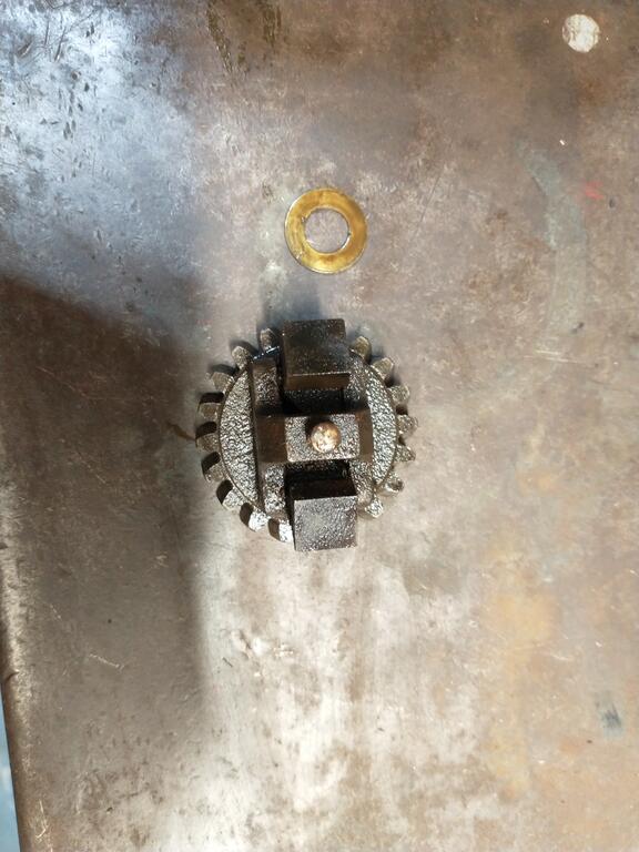

squonk 48,322 #64 Posted July 14, 2021 That deal not getting the governor gear out bothered me. I figured that little shaft was supposed to move. Went out this morning and sure enough with a screwdriver I was able to get it to move. Got it out and it's rusty. Beginning to think to this engine sat outside for a while. 1 Share this post Link to post Share on other sites

Handy Don 17,670 #67 Posted July 14, 2021 5 minutes ago, Ed Kennell said: Makes cents....seems like that's the only way it would work. Thanks for the info and education Mike. Old Edog is still learning. I think the slots on the one end of the cam lobe cylinder are only for the little inward-facing arms that actually rotate the lobe cylinder. Putting the spring in there with the arm could cause interference (and not sure they'd fit with the shaft inside anyway). But you are there with it and I'm here at my desk with pictures only! Please post a pic when you get there, and thanks for sharing your progress. 1 Share this post Link to post Share on other sites

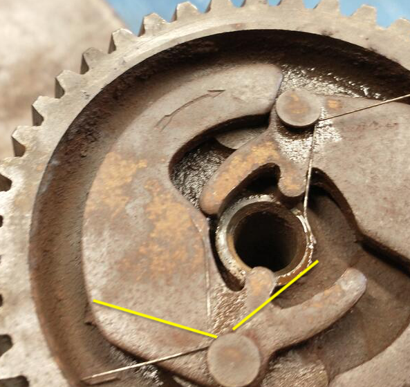

squonk 48,322 #69 Posted July 14, 2021 Read buckrancher's post above about the springs. You can see the curve in the springs that go around the lobe on the outside. Share this post Link to post Share on other sites
Handy Don 17,670 #70 Posted July 14, 2021 @squonk, I think the spring has to end up where the yellow lines are in this picture. One end against the outer arm and the other end agains the lobe cylinder. It's the only way there will be good spring tension on the arm. 1 Share this post Link to post Share on other sites
