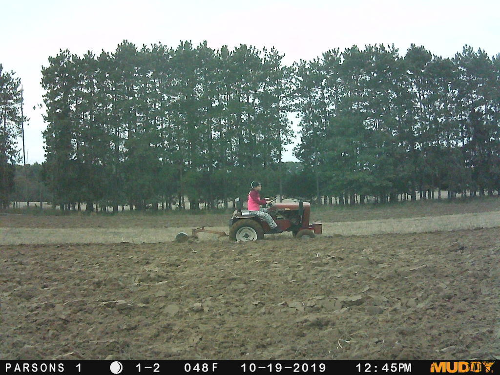

Pullstart 71,311 #14 Posted July 12, 2021 @richarddwescott@twc.com! You might find more info than you can wrap your head around in this thread... dedicated solely to plowing and maybe a friendly jab in the kidney here or there... @D_Mac I’m not sure if you’ve looked in there either, but lots to learn! Plowing might just be the single hardest thing you could put a Wheel Horse through but shy of full on tractor shows, grow the biggest gathering for events. 1 Share this post Link to post Share on other sites

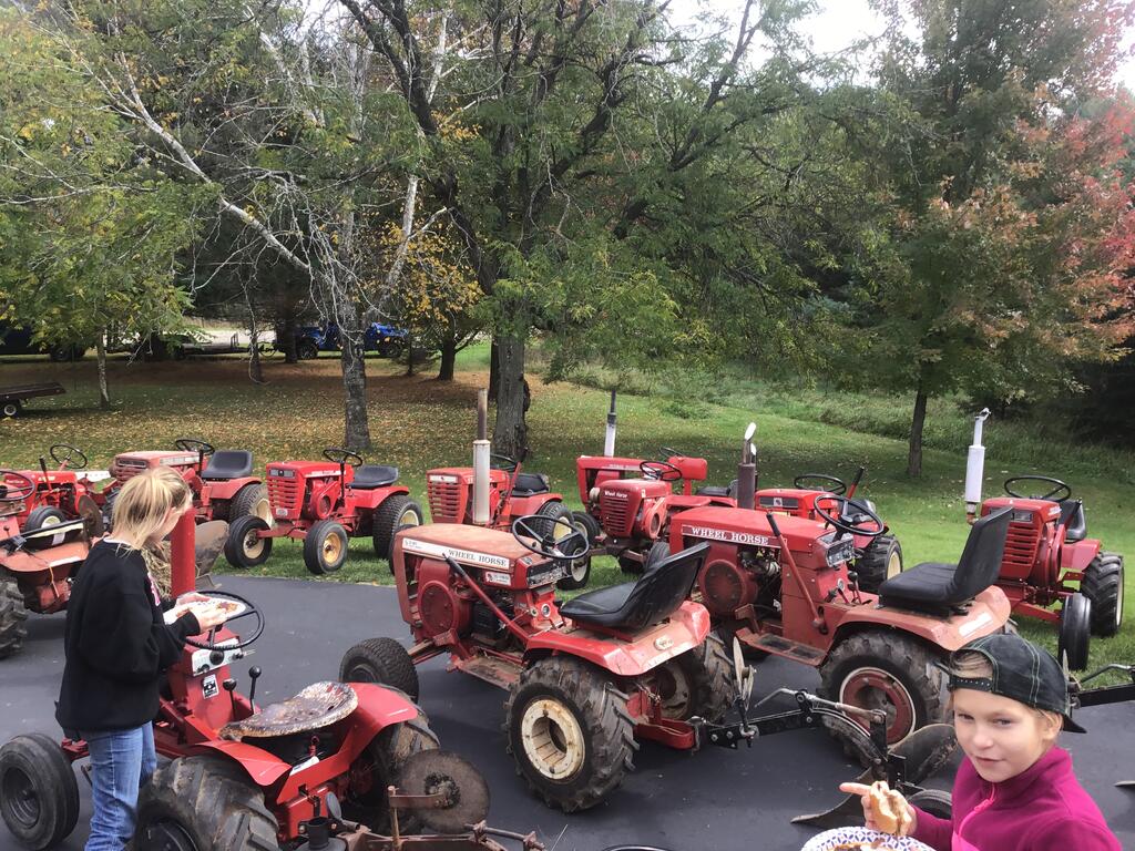

Handy Don 17,490 #15 Posted July 12, 2021 (edited) Great add, @pullstart At 2:54 in the video, you can see that the 1054 is using a slot hitch. Just before that, in the "plowing procession", the IH Cub is using a sleeve hitch. In the "parked tractors" photo, the tractor in the center foreground has a sleeve hitch. Edited July 12, 2021 by Handy Don 1 Share this post Link to post Share on other sites
