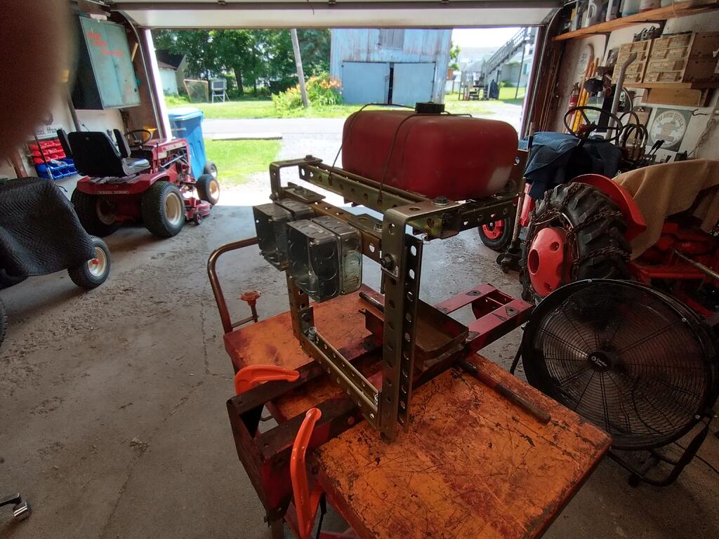

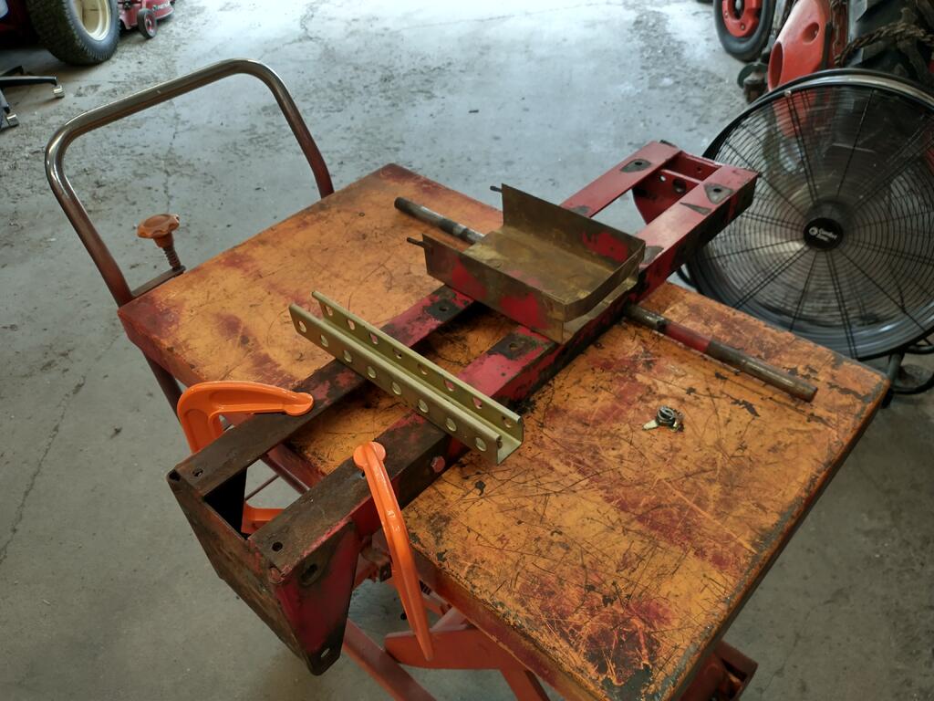

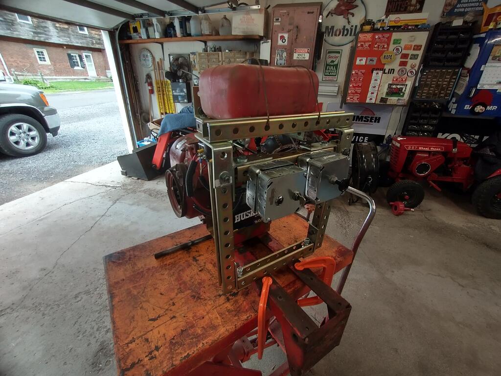

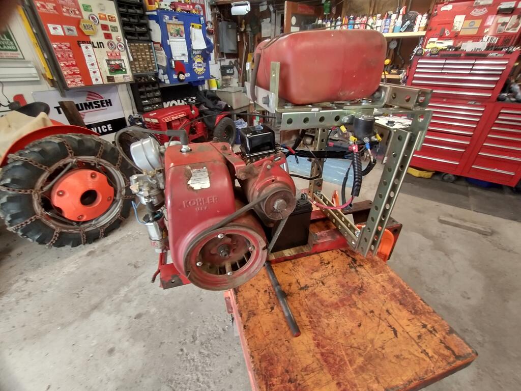

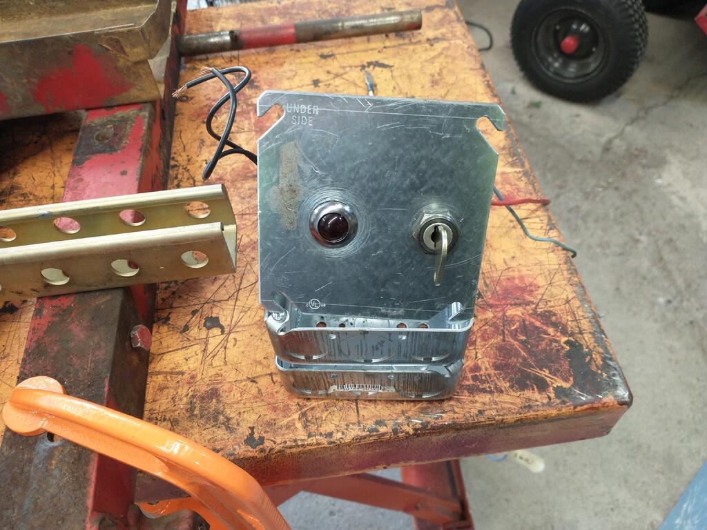

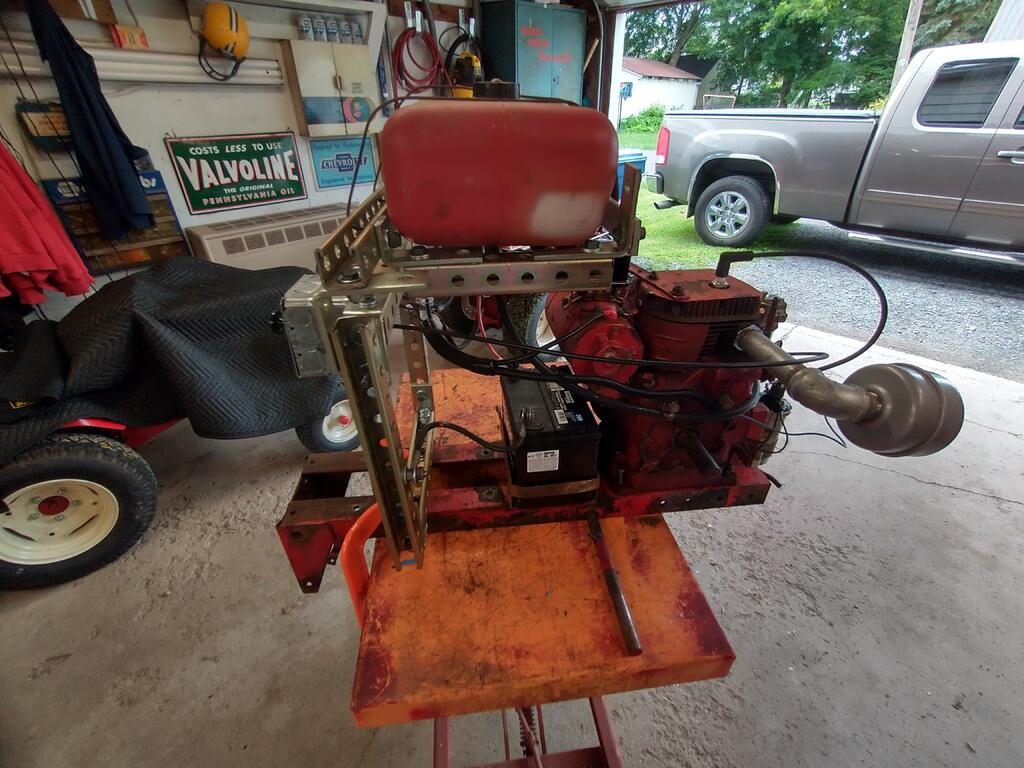

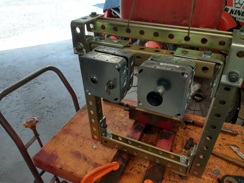

squonk 45,539 #1 Posted July 11, 2021 I'll try to make this as short a story as I can. @D_Mac needed an engine for his 875. Figured they would be some at the show. Bought an " Allegedly Rebuilt" K-181 off a FB ad to be picked up at the show. Ad says engine will run. Friday comes and 2 kids say we got you engine. They take me to it and it looks like it came out of the junkyard. Kid says he put a new piston, rings, rod ect. in it but he can't get it to run. Thought it was in the valves. Well I already paid for the thing sop I took it. Ended up buying another engine for Don that looked like it was a good engine. Bought it from a collector who took it off a tractor to put a Twin cyl on and make a hot rod. So I got this other engine. No room for a roller even here but I got the idea to build a test stand. I knew where there was a frame "hanging" around @rjg854 and I had a bunch of strut taking up space and a box of wire. all I needed was some brackets, electrical boxes and bolts. I will clamp this rig to my hydraulic lift table. When I'm not using it 4 bolts and it will hang in the shed Commando frame with the first piece of strut and battery box I got at the show: Electrical box for key and "IDOT " light: Junkyard dog: Gas tank picked up at the show rigged up: Electrical and throttle control mounted: All finished: Cranked the engine over and yup it blows out of the carb when it fires. I will continue in this thread as I progress to get this running. First step will be valve timing and lash 5 5 Share this post Link to post Share on other sites
peter lena 9,770 #2 Posted July 11, 2021 @squonk like the idea of a test bed set up, just being able to break in or detail a running engine is the way to go . my experience was fuel , lubrication and electrical detailing. always noticed a gain on response , smoother running , my first oil changes were , showing me a clean up , electrical upgrades every step. running on seafoam , the transition was obvious . just the opposite of its previous life , pete Share this post Link to post Share on other sites

ebinmaine 77,360 #8 Posted July 11, 2021 Very nice work on that stand Mike. I'll be looking forward to hearing what makes that engine go "right". Share this post Link to post Share on other sites
