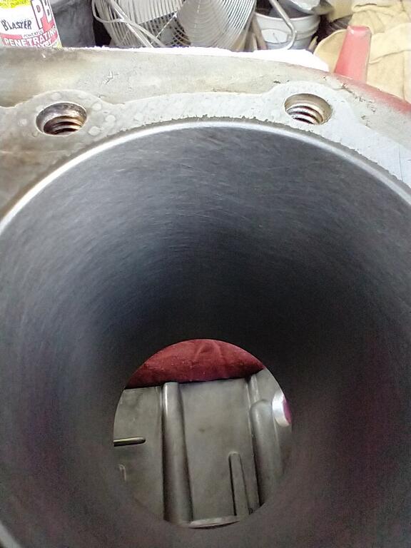

Richmondred01, that cross hatch is a thing of beauty!!!   :occasion-xmas:
  • Like 4
rmaynard
Yup, crosshatch and new rings. Worked for me in my 54 year old Tecumseh V60. Burned oil like crazy. Nothing afterwards.

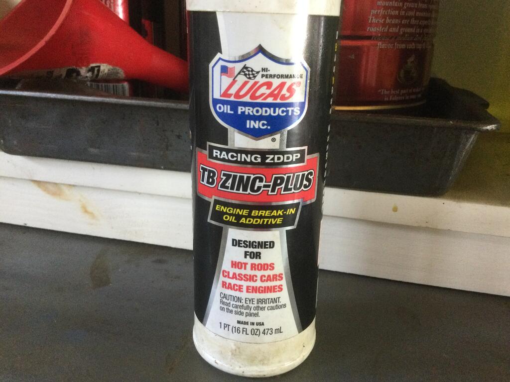

@WHX24 think the best combo for hot weather , is  rislone zinc and # 30 shell rotella , that way you are getting  great protection and the added cleaning with the zinc , that hot work with the cleaner , will give you what you want , for protection and an easier running engine . the heavy oil theory , typically does not help with the varnish build up in these engines . always marveled at the color change to new oil with the added zinc , you are looking at varnish removal , and an easier running engine . just my own experience , pete
Pete, are you saying that the zinc is a 'cleaner'?  My understanding is that it is a lubricant, particularly with respect to the flat tappets.  Never heard of it's use as a cleaner.

peter lena
@Jeff-C175, Jeff I can tell you , not only is is a lubricant , but since regularly adding it to my oil changes , the dipstick tube on my engines and the dip stick look like new inside, also the milky dip tube residue is gone. like it says makes new oil work better in older style engines . rotella 30 # and rislone zinc , has made me a believer , put some hours on that additive and prove it to yourself . simple and easy to do. not making this up , pete

Jeff-C175
@peter lena Thanks Pete!  I've been using Rotella T1 30 weight for over a decade now in all my equipment, summer and winter.  They're all clean as a whistle inside.  I do add a tad of zddp when I remember to.

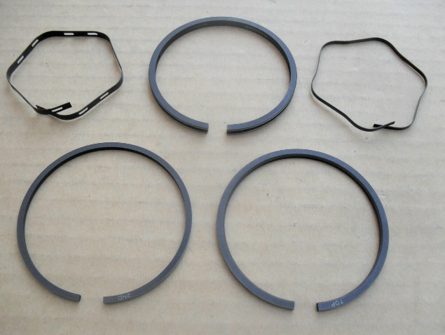

richmondred01
Seafoam is another good product to help loosen rings and carbon on an engine that’s been sitting.
Before tearing down this old cub loboy I used it in the crankcase as well as the spray for the intake.
It still needed to be rebuilt but it did run better.
  • Like 4
