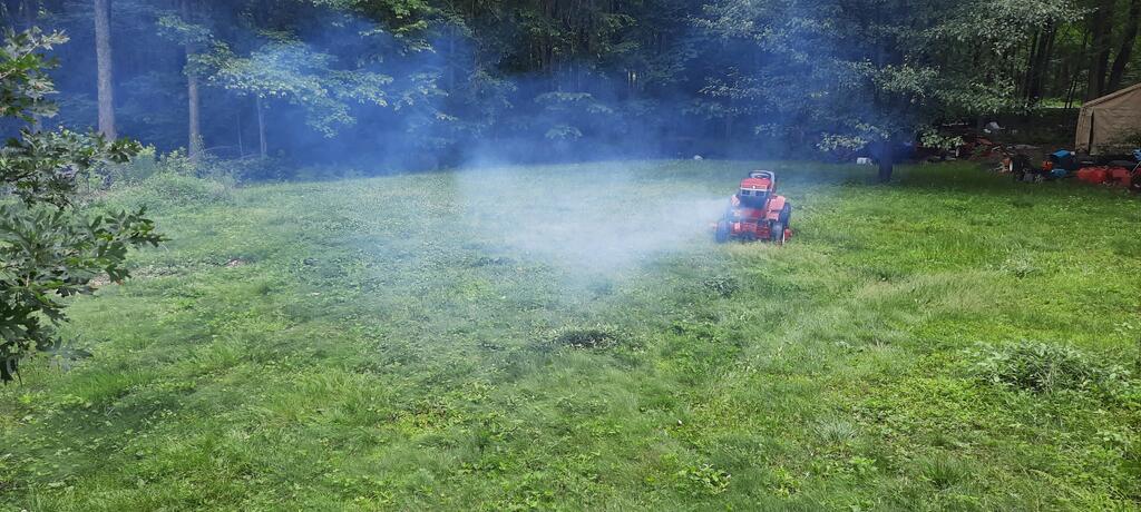

Docwheelhorse 2,991 #1 Posted July 5, 2021 (edited) Hello All, Bought a "beater" at show... couldn't check oil because A) lazy and would've had to find wrench... its an old K with screw in dipstick. Tractor puffed LIGHTLY... and I took it home. Undid dipstick today and found oil thick and black and just touching dipstick. I poured in some kero... flushed motor and drained / re-filled with 30 weight... well with ENGINE FULL it smokes like a freight train. I then sprayed some de-carb / ring free into spark plugs and let it soak for 30 minutes. Then said screw it and put a deck on and beat the stuffing out of it mowing thick, tall wet grass... by the end the smoke was way way down. I may soak it again unless you guys have any suggestions for oil or magic potions that may clean the rings put and get this motor sealed up a little better... I wanted to plow with it and use it as a yard tractor. I know... I know... I hear you screaming re-ring it, but I just don't have time now. Thanks Tony 20210705_114405.mp4 20210705_121912.mp4 Edited July 5, 2021 by Docwheelhorse 1 Share this post Link to post Share on other sites
WHX?? 57,469 #2 Posted July 5, 2021 You call that smoke?!?!? I got a KT17 that beats that and a Briggs twin that together the US Army wanted me to come lay down smoke screens for their next invasion. Sorry to have to tell you Doc that looks like toasted rings to me. You could try a little MMO in it just for $h!t& grins. Ain't a can of liquid tune up in the world gonna cure that tho. 3 1 Share this post Link to post Share on other sites

rmaynard 17,434 #19 Posted July 6, 2021 If you know me, I'm not a fan of snake oil, whether in the gas or in the oil. It's smoking because oil is getting into the combustion chamber. Valve guides, rings or a combination of both. Let the oil burn until your are ready to rebuild it. 1 Share this post Link to post Share on other sites
