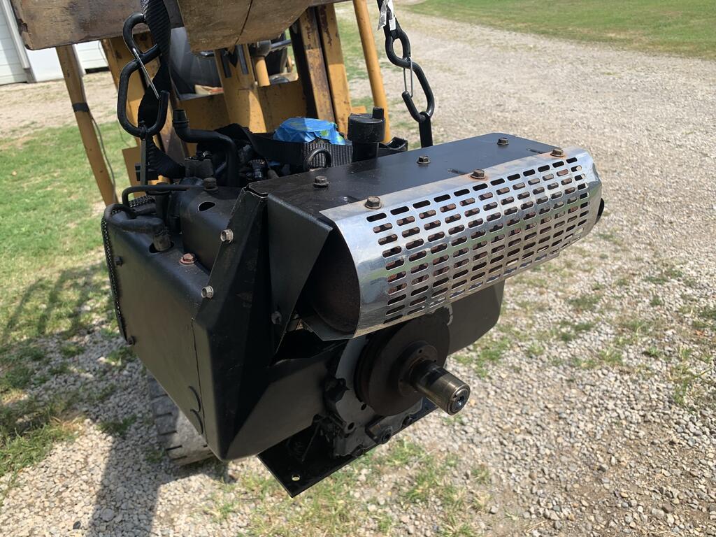

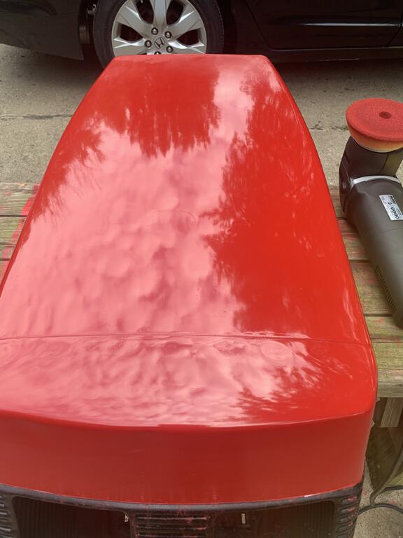

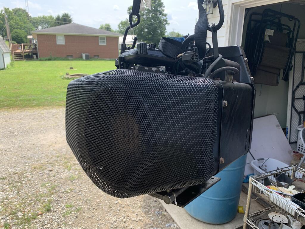

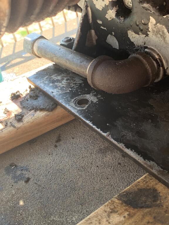

WH1618speed 543 #51 Posted August 15, 2021 Hey y’all! It’s been a while but here’s some updates… I got the engine mounted and attached all the guards for the engine. Also started color sanding the hood and seat pan. Got some decals on. Also changed the hydro and engine oil. I fixed the oil drain so it doesn’t leak. It’s running well but I noticed the tube from the engine to the engine fill cap is leaking oil but I will just fix that up with some Teflon tape. Overall it’s coming together nicely! 5 Share this post Link to post Share on other sites

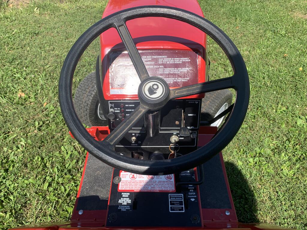

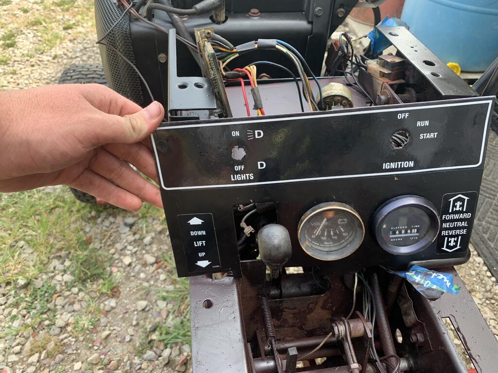

peter lena 10,103 #56 Posted August 15, 2021 @WH1618speed thought I would complement you on your work , and offer you a suggestion to a known issue, looking at the top of your dash area, look at the end of your PTO lever, notice all the washer less end play ? that lever rides on the battery ground rail , I added 3/8" teflon/steeel washers to the end area as well as lubrication , tighten up that lever makes engagement solid firm , also added another engine ground , from the same ground rail ,that battery grounds to , to corner of engine to frame bolt , used 4 ga battery cable . makes electrical issues go away . pete 2 Share this post Link to post Share on other sites
peter lena 10,103 #57 Posted August 15, 2021 @WH1618speed found it , did this a while ago , added this to my 3 horses , note 1st and last photo , look at all the washers I added to the pto lever , to make it snug , last picture shows' ground cable mount from engine to frame edge , connects to battery ground point , also note battery tender plug in on choke cable , for quick easy plug in , pete 1 1 Share this post Link to post Share on other sites

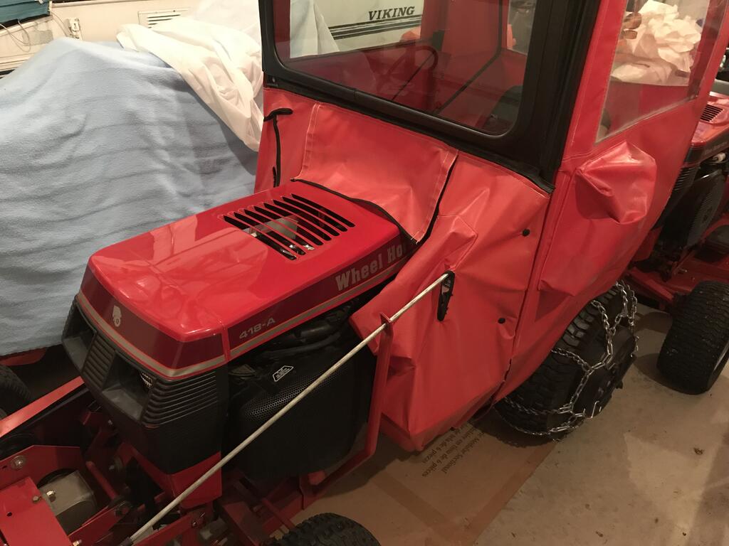

Ike 94 #58 Posted August 16, 2021 This 418A has 130 hours. Pretty much a garage ornament. 1 8 Share this post Link to post Share on other sites
WH1618speed 543 #59 Posted August 16, 2021 Ok, I will have to try that @peter lena. Thanks! 1 Share this post Link to post Share on other sites

peter lena 10,103 #61 Posted August 16, 2021 @Ike been using this marine grade protectant for years , cars , tractors , all rubber trim , https://www.303products.com.au/product-range/marine/303-marine-protectant , that snow cab would look like a fresh vinyl with a rub down of this , rubber/vinyl car trim , just pops with fresh look , pete Share this post Link to post Share on other sites

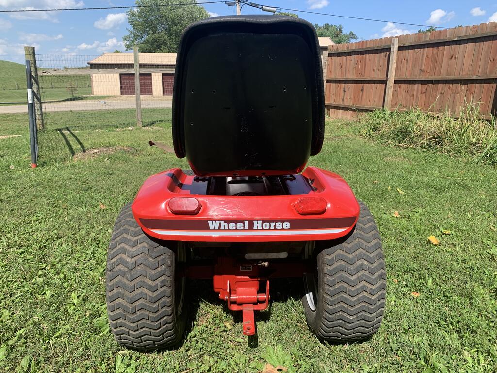

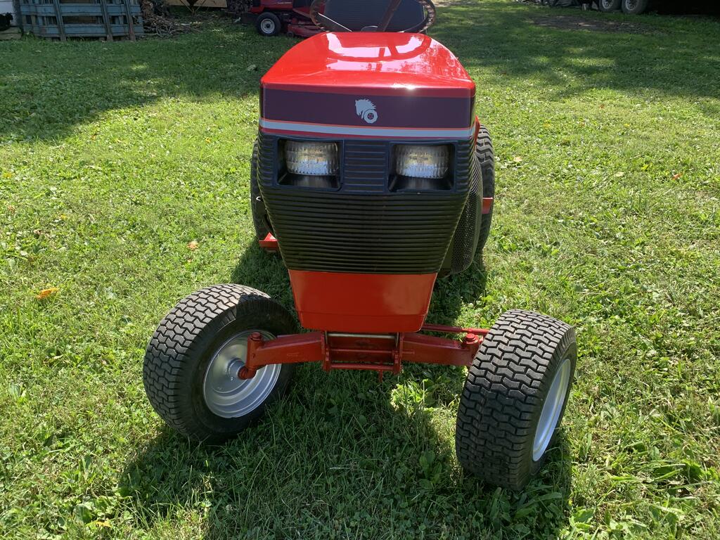

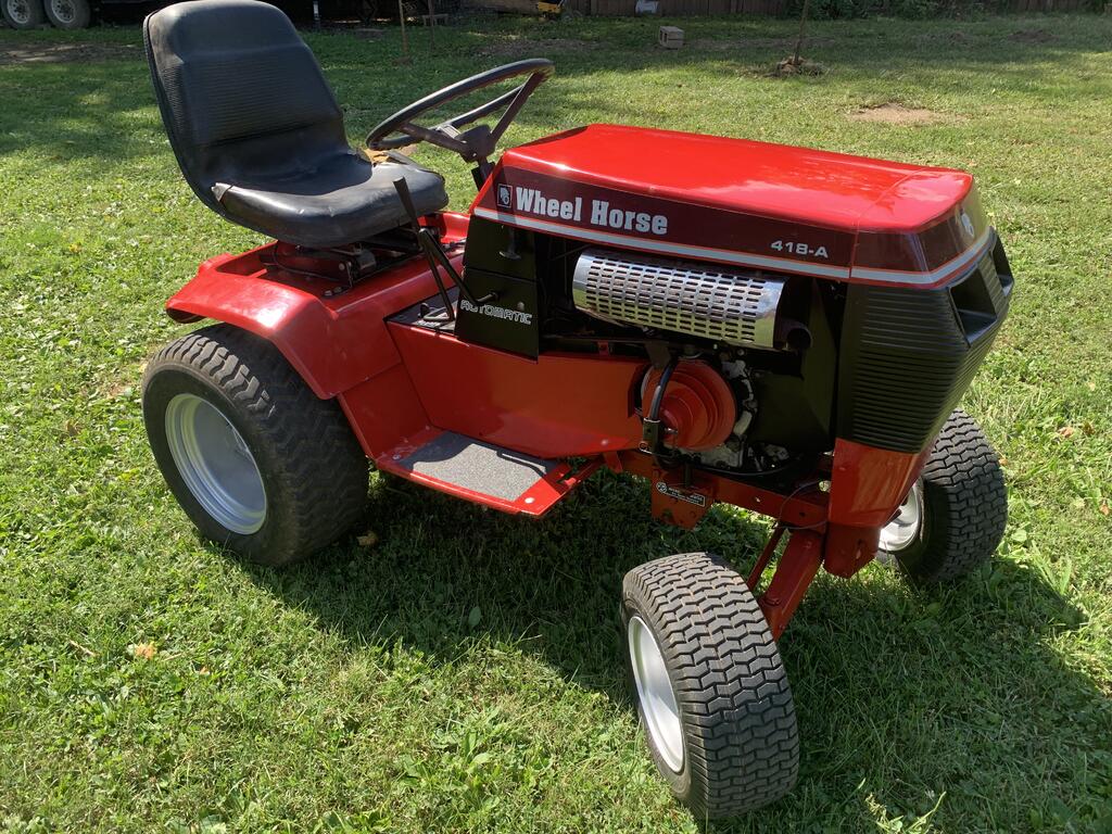

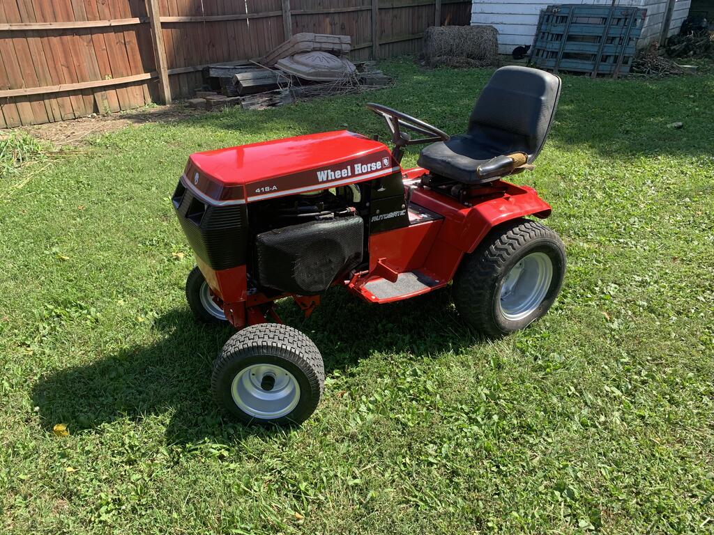

WH1618speed 543 #62 Posted September 7, 2021 Hey everyone just finished my Wheel Horse 418-A Project today!!! After long hours and days of working and painting it is done!! I thought it turned out pretty nice it runs great and everything is back to working condition!! 11 Share this post Link to post Share on other sites

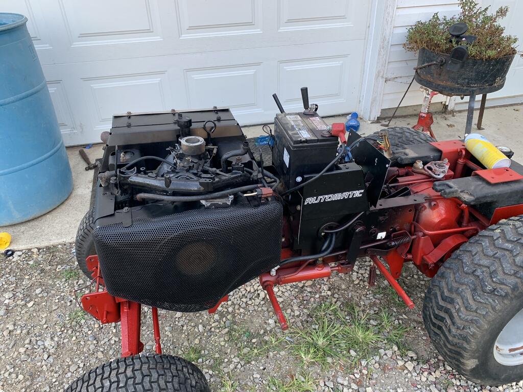

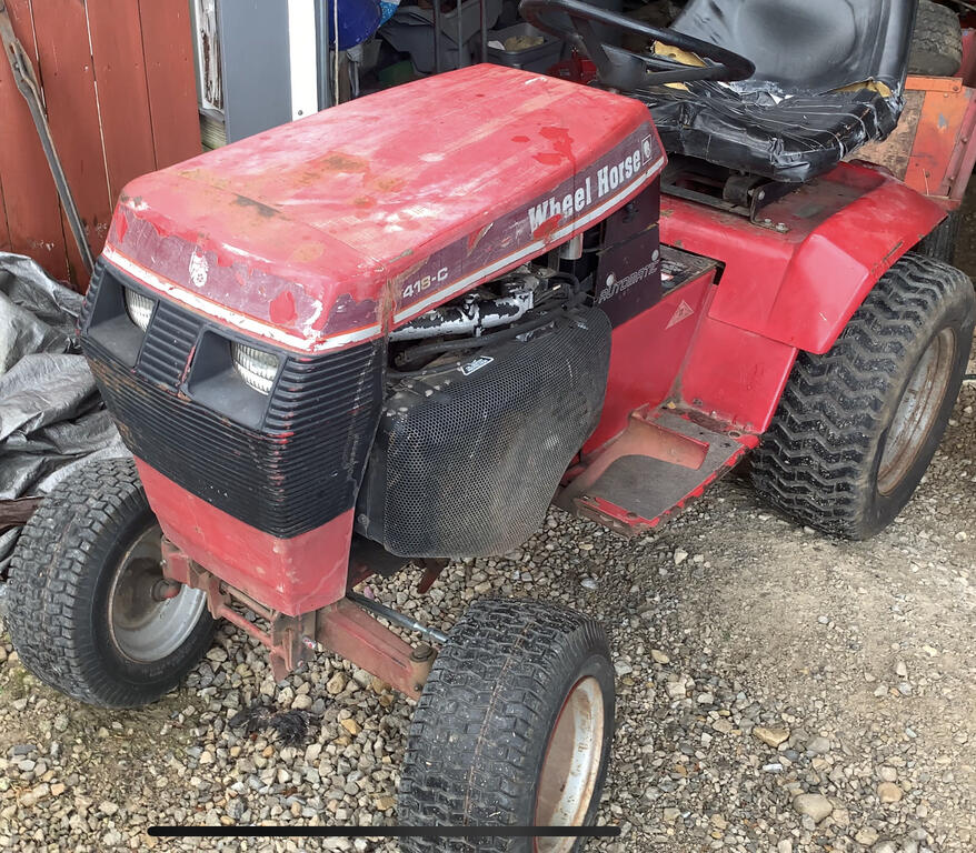

WH1618speed 543 #67 Posted September 7, 2021 Just a reminder here is “before” 3 4 Share this post Link to post Share on other sites
Gregor 4,848 #68 Posted September 7, 2021 Did you paint it? Rattle cans? Looks very nice! 2 Share this post Link to post Share on other sites
WH1618speed 543 #69 Posted September 7, 2021 (edited) @Gregoryes it has been painted not rattle can, it was painted with enamel paint and pneumatic paint gun thanks!! All new decals as well Edited September 7, 2021 by WH1618speed 2 Share this post Link to post Share on other sites

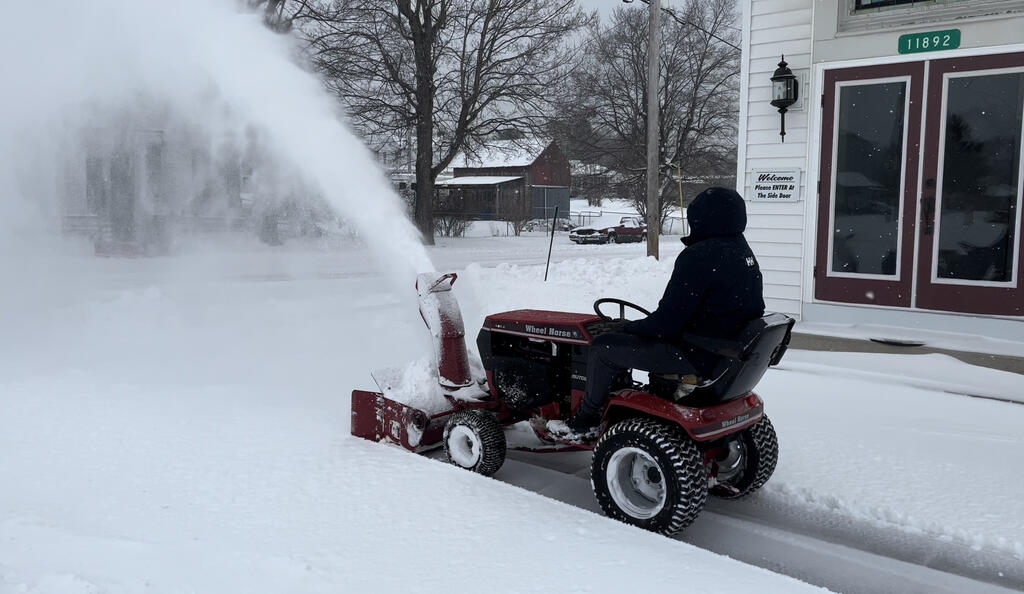

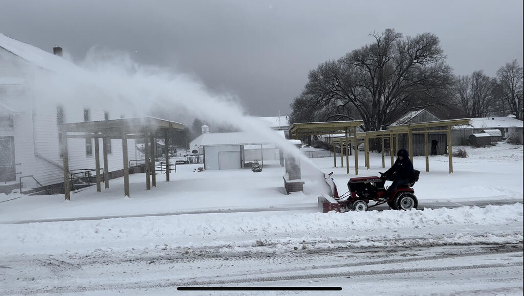

WH1618speed 543 #75 Posted January 20, 2022 (edited) Got some snow a few days ago and here is her being put to use!! That old Kohler puts out the power!! It's a gas hog though using the snow thrower. Not pictured here, but I put on some 4-link v bar chains on 10.50 tires and that did the job for traction. Next thing to get would be a cab for sure! Edited January 20, 2022 by WH1618speed 2 1 Share this post Link to post Share on other sites
