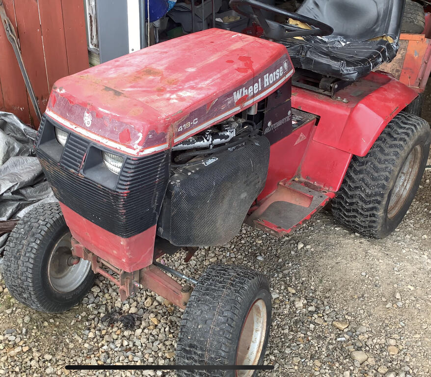

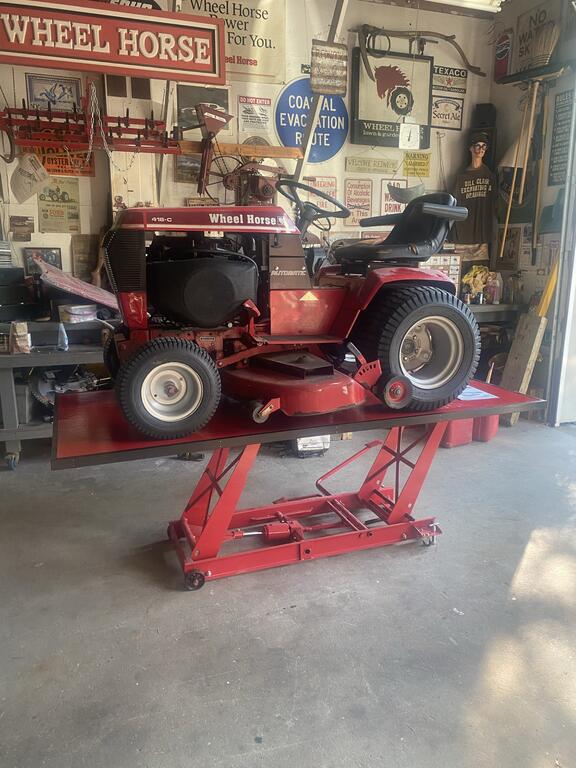

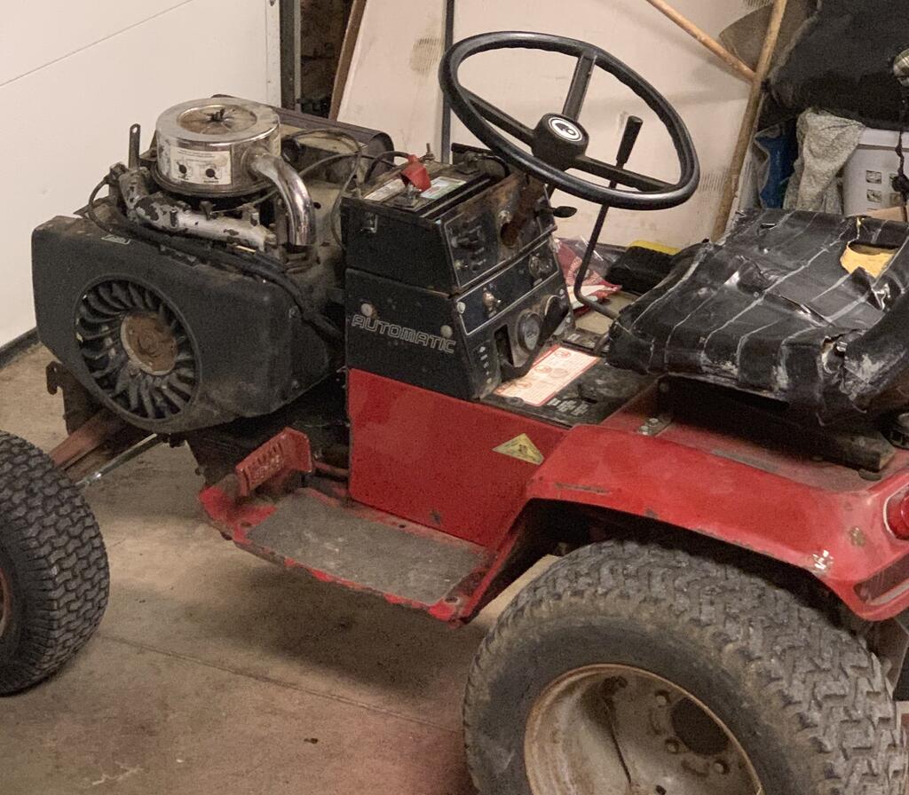

WH1618speed 543 #1 Posted June 30, 2021 Hi all, I am starting my restoration of my 1987 Wheel Horse 418-C. It runs perfectly and Kohler Magnum 18 purrs like a kitten but it needs a new paint job. I bought this tractor at the Wheel Horse Show in PA this last weekend and I am planning on restoring it and posting update photos... Here are some pics of the tractor itself... I already started taking some things apart to prep for the restoration. I already have another steering wheel to replace the warped one and I have another seat that is much better condition to put on it. Also the previous owner added the chrome breather cover and muffler cover. Wish me luck!! 3 11 Share this post Link to post Share on other sites
Jeff-C175 7,211 #2 Posted June 30, 2021 1 hour ago, WH1618speed said: added the chrome breather cover and muffler cover. Not sure, but those might be standard stock. 3 Share this post Link to post Share on other sites

pfrederi 21,274 #8 Posted July 1, 2021 No Chrome on 418-C originally. had higher gearing (faster) I didn't think it had all the idiot lights.... 3 Share this post Link to post Share on other sites

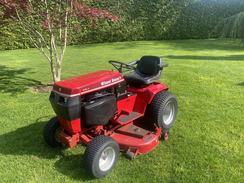

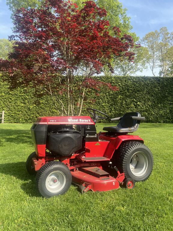

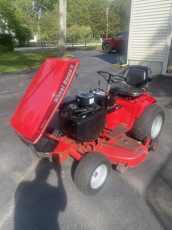

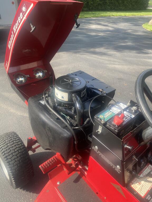

c-series don 12,609 #9 Posted July 1, 2021 @WH1618speedI recently picked up a 418-C and love it. I’m basically the second owner. Good luck with your restoration please keep us posted with plenty of pictures! 4 6 Share this post Link to post Share on other sites
Jeff-C175 7,211 #10 Posted July 1, 2021 7 minutes ago, pfrederi said: No Chrome on 418-C originally. Were those chromed parts available from WH as 'options'? Or I wonder if the OO had them done? I know I've seen plenty pics depicting the chrome muffler cover. That's what led me to believe that they came that way. But maybe that was on the 520 ? 1 Share this post Link to post Share on other sites
c-series don 12,609 #11 Posted July 1, 2021 (edited) @pfrederi correct! If you look at the wiring schematic between a 418-A and a 418-C you would be amazed how much more unnecessary wiring and idiot lights there is. It’s worth checking out and it will make you shake your head. Also zero chrome on the C model. Edited July 1, 2021 by c-series don 3 Share this post Link to post Share on other sites
WH1618speed 543 #12 Posted July 1, 2021 (edited) Right I am debating whether or not this is a 418-C or a 418-A because of the chrome, idiot lights, and no heavy duty spindles. It might be a 418-A with a 418-C hood. The serial # on the seat pan is faded off so I wouldn't know what it really is. Is there any other places where I could find out whether or not this is a -C or -A? The only thing that could possibly make it a -C is it came with a heavy-duty deck with the reinforcements around the bottom part and over the discharge chute. It makes me wonder if someone has went and swapped parts b/w two tractors. Unfortunately, if it turns out to be an -A, I have already ordered -C decals from redoyourhorse. I ordered them at the show so maybe I can still change them. Edited July 1, 2021 by WH1618speed 1 Share this post Link to post Share on other sites
ebinmaine 81,047 #13 Posted July 1, 2021 5 hours ago, WH1618speed said: I ordered them at the show so maybe I can still change them Give Terry a quick call and he'll hold off a bit. Does sound like you have a combo tractor but either way it's a great rig. 1 Share this post Link to post Share on other sites
19richie66 17,937 #14 Posted July 1, 2021 If it has the little red lights on the dash with the test switch, it’s an “A” as the C had no dash lights, no chrome air cleaner or muffler guard. 3 Share this post Link to post Share on other sites

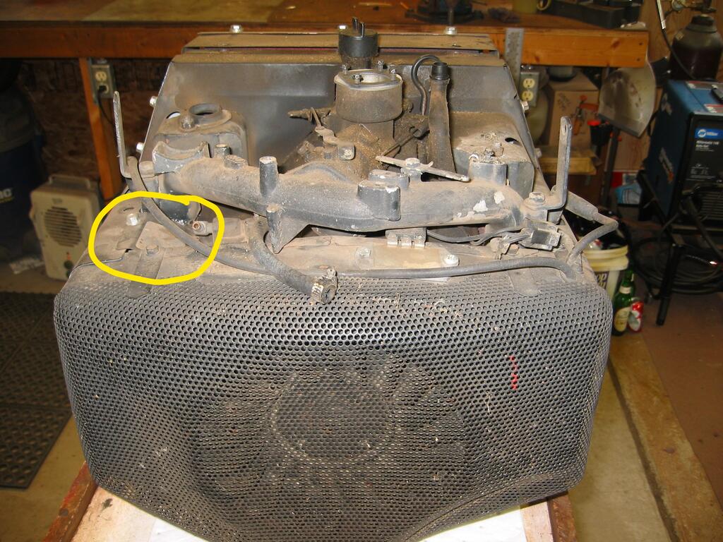

pfrederi 21,274 #15 Posted July 1, 2021 (edited) The 418A used M-18 Spec # 24510 The 418C used spec number 12536 Data plate circled in yellow. Edited July 1, 2021 by pfrederi 3 1 Share this post Link to post Share on other sites
WH1618speed 543 #16 Posted July 1, 2021 Ok, thank you all for the advice I appreciated it. I got in contact with Terry and hopefully I will be able to get the right decals. It would be nice to have a hood with the louvers in it that the 418-A had but it is what it is. 1 Share this post Link to post Share on other sites

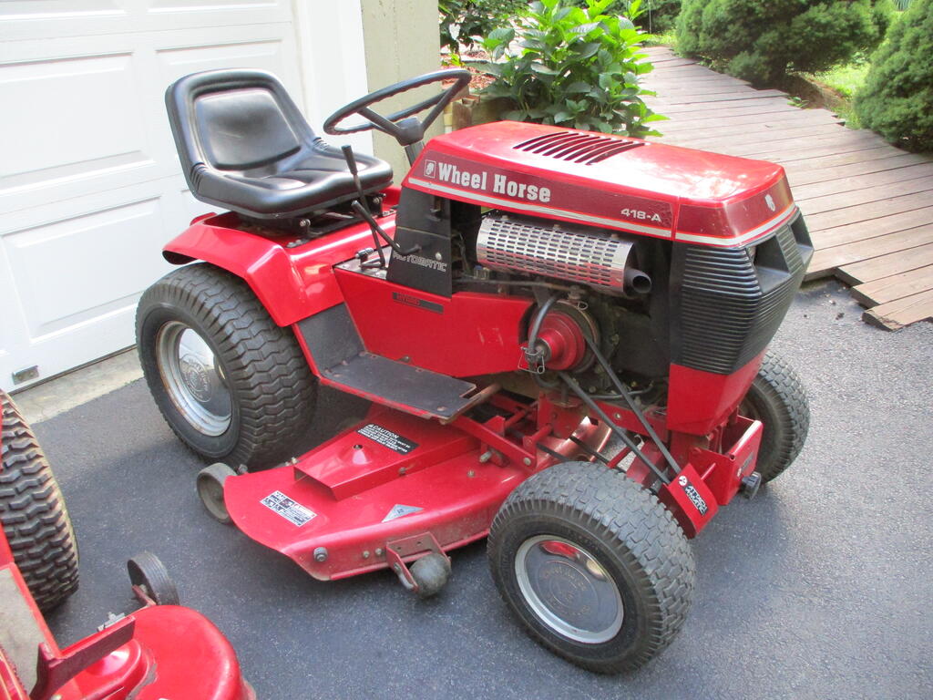

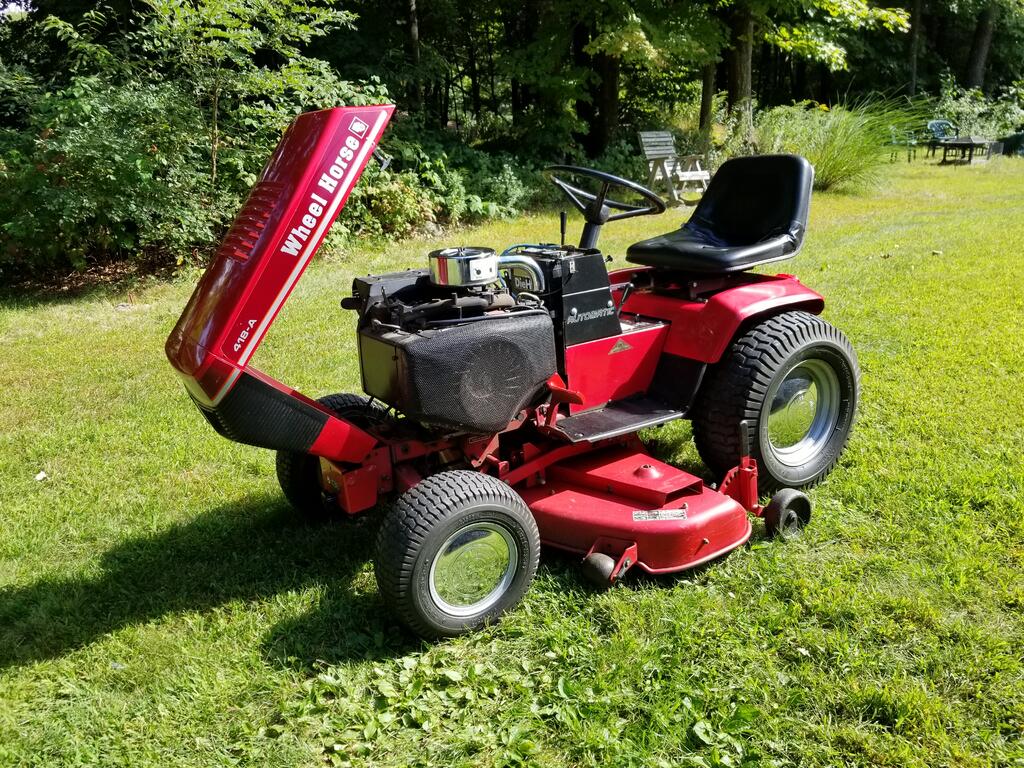

johnnymag3 2,646 #18 Posted July 1, 2021 Love my two 418 A tractors...they are a one year only Tractor. Super nice, powerful Kohler 18 Twin...Hydros are great also. Looking forward to see your restoration completed !! John Was close to Corona last year, had to put mask on..... 4 1 Share this post Link to post Share on other sites

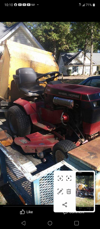

johnnymag3 2,646 #19 Posted July 2, 2021 Top Photo is a Tractor purchased from Eddie Murphy......Hence its name.... EDDIE. A fine fellow made me license plates for all of my Tractors.....Thanks Ritchie !!!! 1 1 Share this post Link to post Share on other sites

johnnymag3 2,646 #22 Posted July 2, 2021 8 hours ago, c-series don said: @johnnymag3 when you say Eddie Murphy do you mean like Eddie Murphy, Eddie Murphy? Probably not the Eddie Murphy I’m thinking of, I doubt that he cuts his own grass!!! Yes that Eddie Murphy........He does not mow, Ron the Caretaker does the 40 acres...Eddie just wanted it to drive up and down the Driveway to the other buildings on his property.He liked it because he was a fan in his younger days, and he was drawn to all of the chrome goodies on the 418-A. Eddie is the same in real life as you see him in the movies !!! 6 Share this post Link to post Share on other sites
