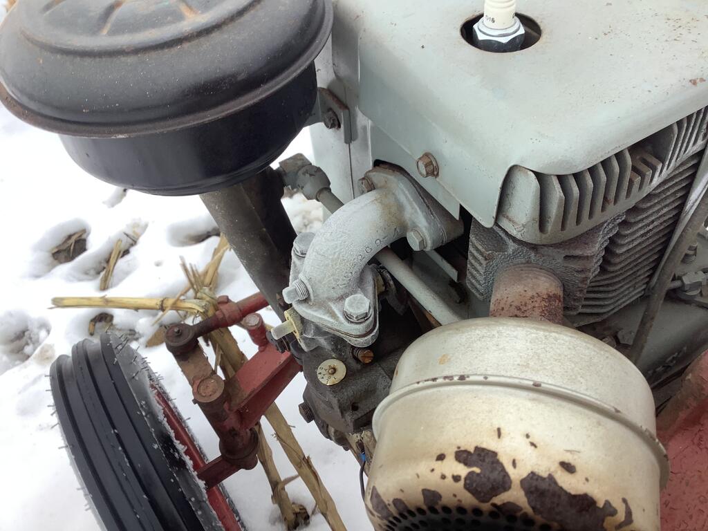

Pullstart 71,220 #105 Posted January 13, 2022 Waking up from a winter’s slumber… the dew point must be making this intake freeze up? 1 Share this post Link to post Share on other sites
Handy Don 17,467 #106 Posted January 13, 2022 1 hour ago, Pullstart said: Waking up from a winter’s slumber… the dew point must be making this intake freeze up? Yep, indeed. Next will be the carb throat and silence.... Share this post Link to post Share on other sites
Pullstart 71,220 #107 Posted January 13, 2022 Just now, Handy Don said: Yep, indeed. Next will be the carb throat and silence.... it ran like that until it ran out of fuel. Luckily, we were right outside the house when it started running out. My secret nap weapon is an idling tractor 1 1 Share this post Link to post Share on other sites
Handy Don 17,467 #108 Posted January 13, 2022 1 minute ago, Pullstart said: it ran like that until it ran out of fuel. Luckily, we were right outside the house when it started running out. My secret nap weapon is an idling tractor Wheel Horse lullaby. You need a songwriter and lyricist! BTW, must have been a bit too warm to freeze the carb. Lucky. 2 Share this post Link to post Share on other sites

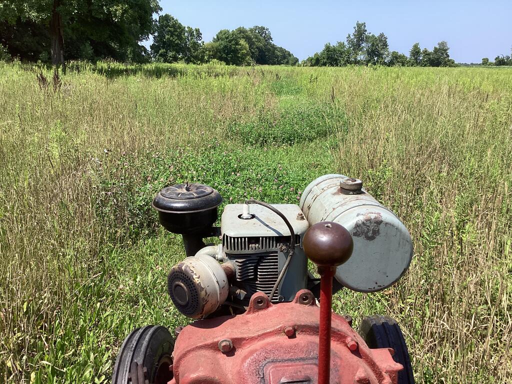

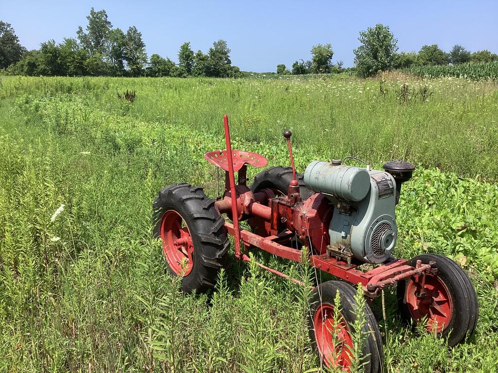

Pullstart 71,220 #122 Posted July 27, 2023 I took a stroll in the field today. The shift forks had been dragging gears while in neutral for a while the last few times I drove Jackie. I took the top plate off today and peened the roll pins so the forks would hold the shafts better. It seemed to take care of the grinding! 1 1 Share this post Link to post Share on other sites

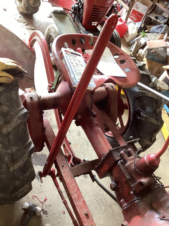

Pullstart 71,220 #124 Posted October 21, 2023 I’ve been getting Jackie all fixed up for plow day. Today’s the day to see if things will work like they did in the 40’s! 4 1 Share this post Link to post Share on other sites
Pullstart 71,220 #125 Posted October 21, 2023 I built the lift arm quadrant based off of pictures from Lowell @wheelhorseman and guessed my way through the lift arm geometry. We stuck it in the dirt last night and things went very well! The new lever was the best I could do to replicate the original, but I sleeved the inside with 3/8 plate all the way to the handle and also made the pin greasable. I did borrow the top cap/end from the original, it was just too cool not to. 5 1 1 Share this post Link to post Share on other sites
