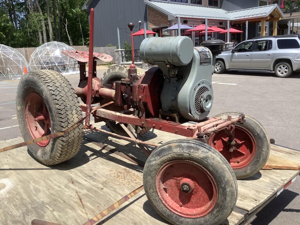

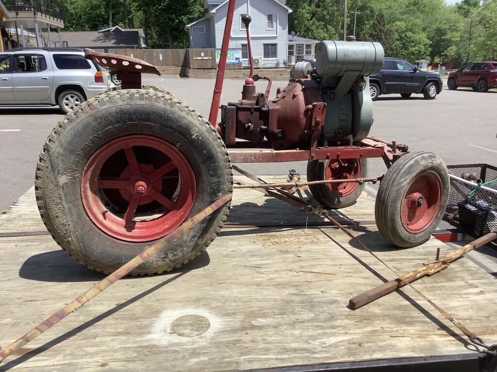

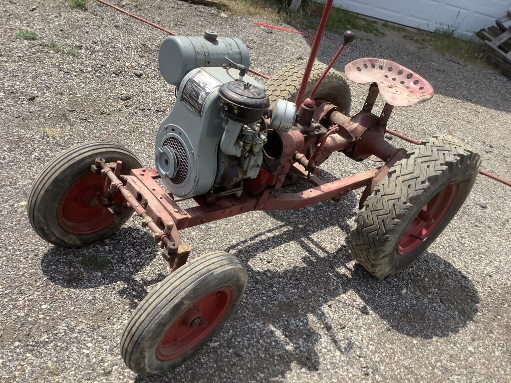

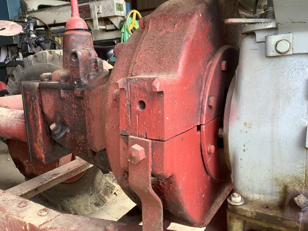

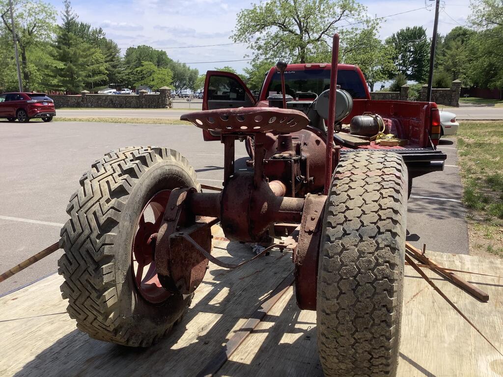

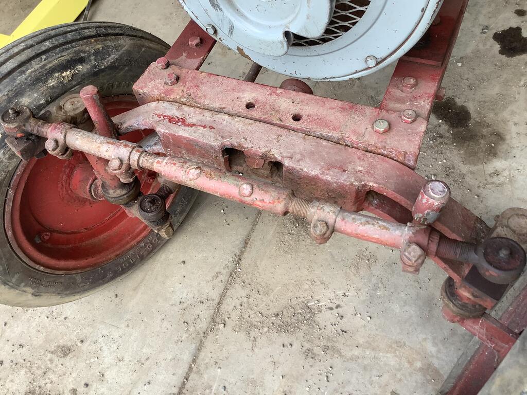

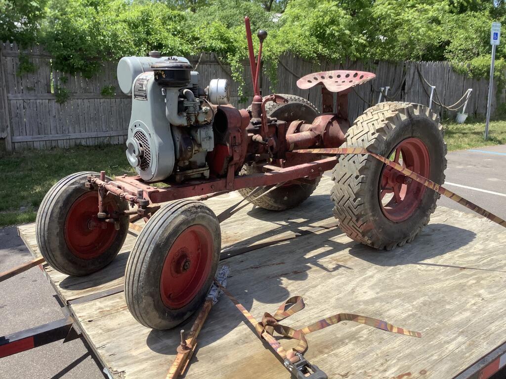

Pullstart 71,561 #1 Posted June 1, 2021 (edited) Here it is... @oldiron613 Rob I might need some help identifying anything I don’t point out... but the bellhousing and clutch are not lever steer normal, I don’t think many frames were bent either. I was told most of the lever steer tie rods were just a flat bar with bolts/pins, so maybe with all the added touches, this might be the last lever steer built in 1947? The engine has been swapped, so the build date is challenging to pin down... but it is what it is and it’s home for good! Once again, many thanks to @Bow_Extreme for the lead on the Senior in the first place, then passing “dibs” on to me on this one! 1947, Jackie Robinson signed with the Brooklyn Dodgers. I’m not much a fan of baseball, but I’m a fan of his story. I’m thinking I’ll call this one “Jackie” Edited June 2, 2021 by pullstart Topic title 11 24 6 Share this post Link to post Share on other sites
oldiron613 590 #2 Posted June 1, 2021 Firstly, congrats! That's awesome being able to uncover another Pond Lever Steer. My immediate observations: -The replacement bellhousing is a Ford model A -The frame is unique; looks 1947 to me. -Most of the 1947 tractors I'm aware of (just a couple) came equipped with the Wisconsin AEH engine. -The rear "long" spokes look correct, but the rims may have been widened? I'm hoping Derek/Harry England can provide additional insight. Congrats again, I'm stoked for you! 5 1 Share this post Link to post Share on other sites

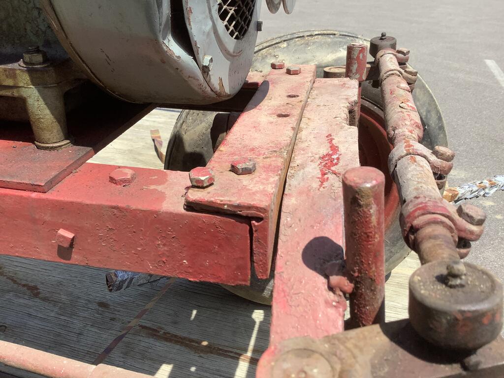

oldiron613 590 #3 Posted June 1, 2021 *I see looking closer that the frame is of the earlier, curved style seeing the last picture of the left side. 3 1 Share this post Link to post Share on other sites

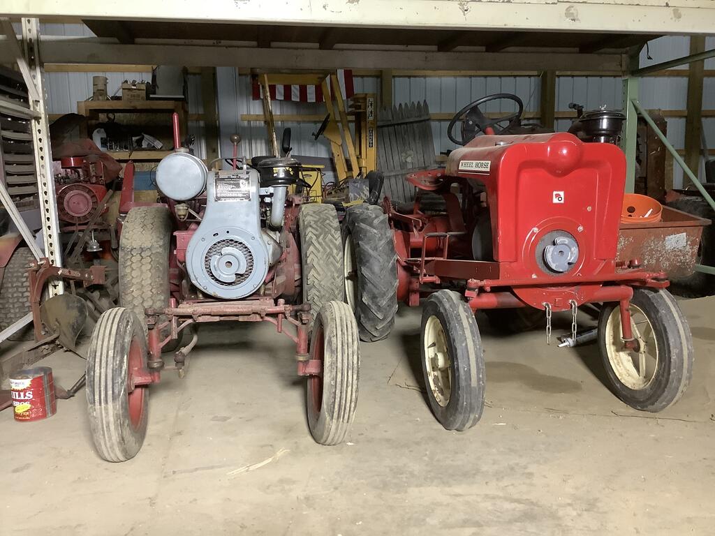

Pullstart 71,561 #14 Posted June 2, 2021 I backed Jackie in next to the Senior. There’s surely something bent on the left front spindle/axle. I might eventually try to remake a new front end. Time for fluid checks and see if it’ll fire! 8 4 Share this post Link to post Share on other sites

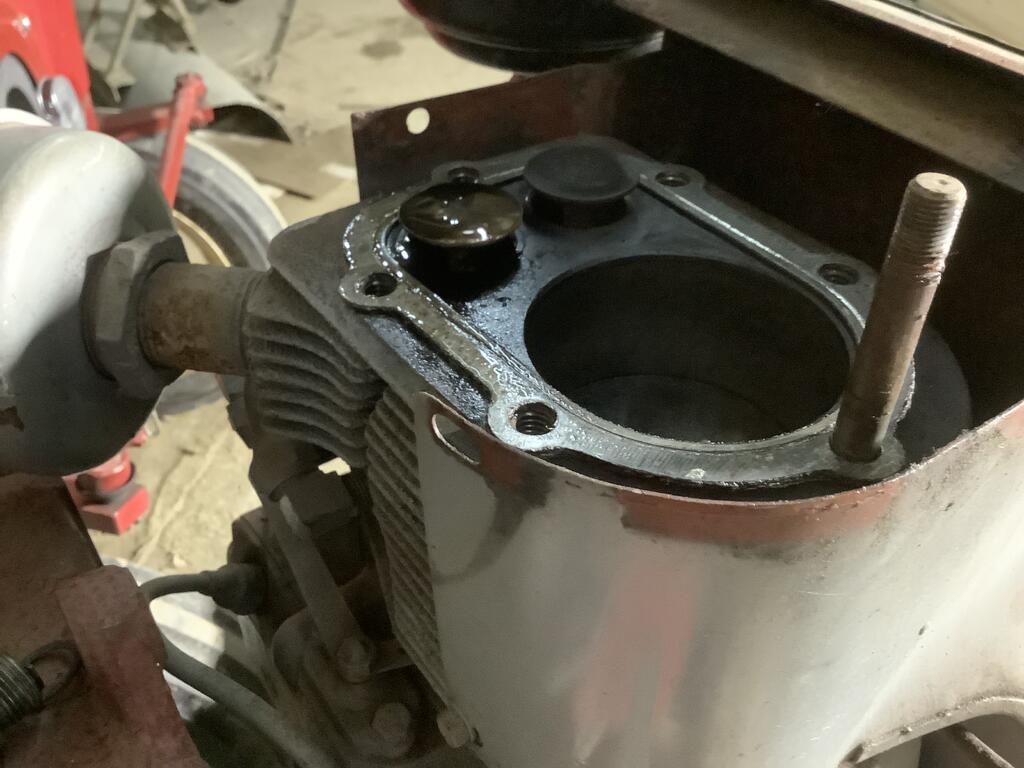

Pullstart 71,561 #21 Posted June 2, 2021 16 minutes ago, 953 nut said: Bring it to the Big Show even if it won't fire! Wild Bill and a few others are always looking for a challenge. Yeah, I plan to have it there regardless, but it sure would be nice to have it cruiseable straight away upon arrival! I had to pull the head last night and free up the exhaust valve. It was stuck open but it didn’t take much to free it up. I made sure all the fuel passageways in the carb were clear, now I need spark! 5 Share this post Link to post Share on other sites

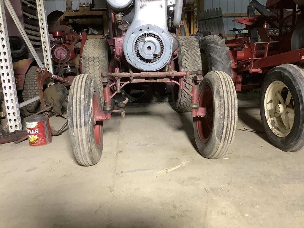

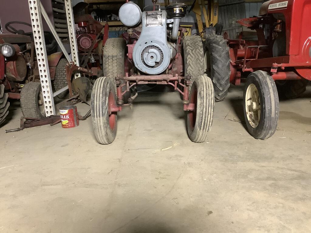

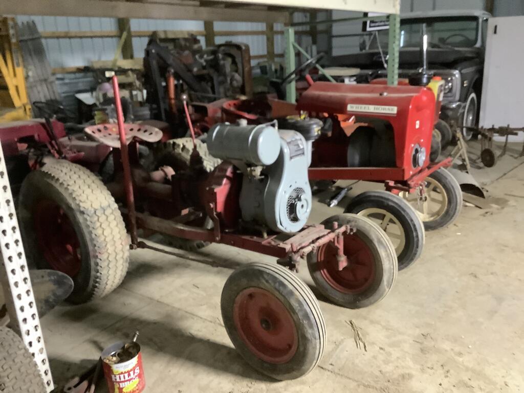

Pullstart 71,561 #22 Posted June 2, 2021 For anyone who cannot see the videos, here are a few pictures. The front end is a bit wonky. It looks to me like the left front took a side impact of some sort in it’s life. It has much more camber than the right side. The exhaust valve was stuck fully open. Can’t get much compression that way! Jackie’s in his resting place next to the Senior. 4 3 Share this post Link to post Share on other sites

19richie66 17,951 #24 Posted June 2, 2021 Left side tilts more so it will be straight up and down when in a furrow Nice find Kevin 1 1 3 Share this post Link to post Share on other sites
ebinmaine 81,282 #25 Posted June 3, 2021 2 hours ago, 19richie66 said: Left side tilts more so it will be straight up and down when in a furrow This is fair. A reasonable assessment by the Richie. 2 Share this post Link to post Share on other sites
