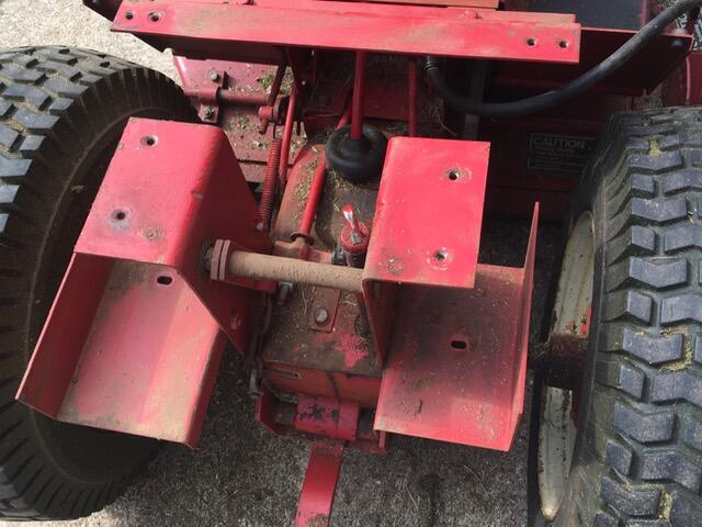

twiisted71 51 #1 Posted May 14, 2021 Pretty sure I"ve got crud in my tank and want to pull it so I can slosh it around and pour out of the filler cap. Before I go crazy and dismantle the darned thing I was hoping y'all could tell me the easiest way to go about it. Hoping there is a secret push button I don't know about that will just release it, no tools req'd!!! Changed headgasket, rebuilt starter, and replaced starter lead over the past two days. Bounced around some rough places in the yard today and no fuel. It did it once last year and I just ran some wire in the petcock and unplugged it. However if I'm out of town and the missus is using it I'd rather not get that call because I didn't just do the job right. I did run all new fuel line and installed a large see-thru filter over the winter. Yep the fuel pump is working. She's sucked the filter dry and, yes there is fuel in the tank. Share this post Link to post Share on other sites
Thor27 848 #2 Posted May 14, 2021 pull the fender, then there will be 2 5/16 bolts in the front, and one on each side from underneath. 1 Share this post Link to post Share on other sites

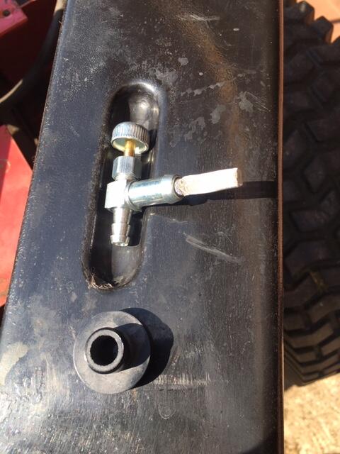

R Scheer 510 #3 Posted May 14, 2021 Some have a strainer on the tank shut off valve, the part that goes into the tank. I've had that clog, ended up getting annoyed and removed the strainer and put in an inline filter instead. It had the same symptoms, intermittent loss of fuel. Haven't had an issue since then. Share this post Link to post Share on other sites

twiisted71 51 #5 Posted May 14, 2021 3 minutes ago, R Scheer said: Some have a strainer on the tank shut off valve, the part that goes into the tank. I've had that clog, ended up getting annoyed and removed the strainer and put in an inline filter instead. It had the same symptoms, intermittent loss of fuel. Haven't had an issue since then. RS I've been a little leery of popping that petcock out for fear of tearing up the grommet or breaking the valve. I'd like to just install a 90* bulkhead fitting and install an inline shut off valve but haven't looked into whether I can reach that hole in the tank through the filler neck to be able to put a back up nut on it. Share this post Link to post Share on other sites
Stormin 9,987 #6 Posted May 14, 2021 You'll have to remove the seat and fender. 4 hex screws for each. Don't forget to disconnect any wires for seat switch and rear lights, also fuel pipe. Two hex screws at the front of the tank on top. Just slacken off. Two underneath. Remove then tank will slide back. Share this post Link to post Share on other sites

Achto 30,963 #9 Posted May 14, 2021 (edited) 8 hours ago, twiisted71 said: RS I've been a little leery of popping that petcock out for fear of tearing up the grommet or breaking the valve. Replacement grommet are available. Check your local hardware store or small engine shop. They were used by many manufacturers and are all pretty much the same. Here is a link to them at the jungle store as well. https://www.amazon.com/HIPA-Bushing-Grommet-Specific-Tecumseh/dp/B0794W3R8Z/ref=sr_1_7_sspa?dchild=1&gclid=EAIaIQobChMIm_Kjk5bJ8AIVU_vjBx1KDwMCEAAYAiAAEgIMkPD_BwE&hvadid=178319321648&hvdev=c&hvlocphy=9018899&hvnetw=g&hvqmt=e&hvrand=7741916821923603643&hvtargid=kwd-4096621064&hydadcr=28665_10189487&keywords=gas+tank+grommet&qid=1620995333&sr=8-7-spons&psc=1&spLa=ZW5jcnlwdGVkUXVhbGlmaWVyPUE3MjVKM09INzZXNVUmZW5jcnlwdGVkSWQ9QTEwMzMxODgzRFZLUTNGVVhCVURLJmVuY3J5cHRlZEFkSWQ9QTA2MjU3MzgzMFBBRzVNOE5IOVRTJndpZGdldE5hbWU9c3BfbXRmJmFjdGlvbj1jbGlja1JlZGlyZWN0JmRvTm90TG9nQ2xpY2s9dHJ1ZQ== You can also get valve & grommet combo kits. https://www.amazon.com/Grommet-Generators-Craftsman-Coleman-Generac/dp/B07HR6K547/ref=sr_1_3?dchild=1&gclid=EAIaIQobChMIm_Kjk5bJ8AIVU_vjBx1KDwMCEAAYAiAAEgIMkPD_BwE&hvadid=178319321648&hvdev=c&hvlocphy=9018899&hvnetw=g&hvqmt=e&hvrand=7741916821923603643&hvtargid=kwd-4096621064&hydadcr=28665_10189487&keywords=gas+tank+grommet&qid=1620995586&sr=8-3 Edited May 14, 2021 by Achto 1 Share this post Link to post Share on other sites

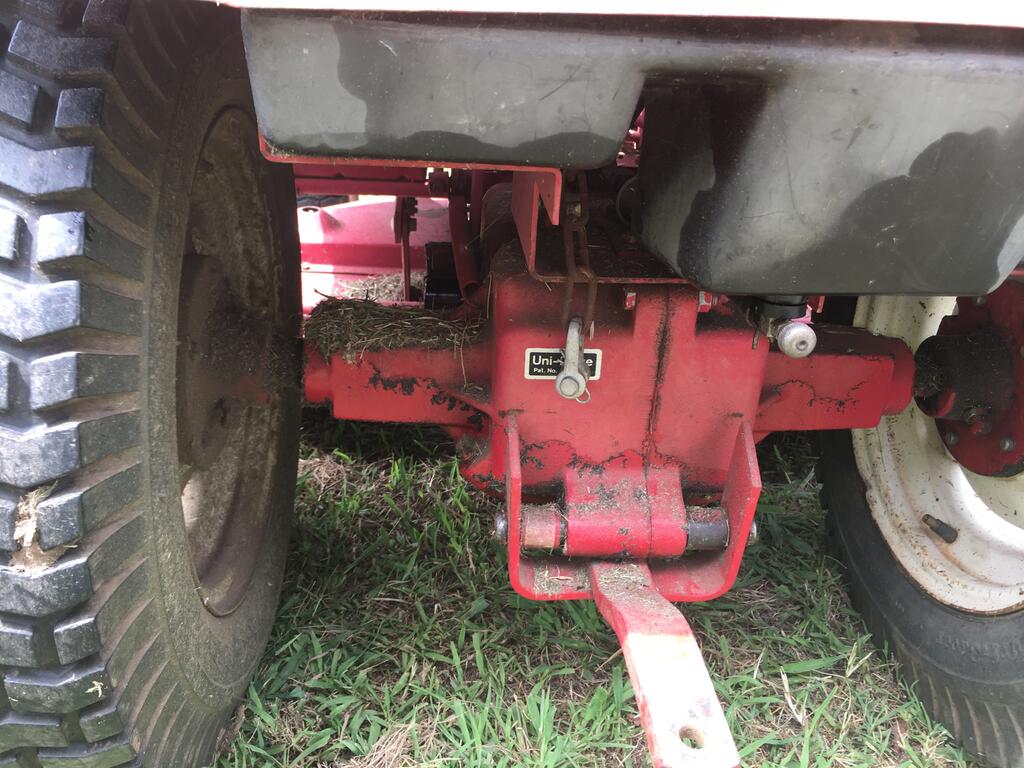

c-series don 11,357 #10 Posted May 14, 2021 I would just order a new grommet and valve like Achto said. I’ve done this many times,it’s a simple easy fix.Also once you have the fender off to take the tank out it’s only two more bolts to take out the tank support. Those bolts go into the transmission so you want to clean around there first so no debris will go in the holes. Then you can take the tank out and flip it upside down to remove the two bolts that actually go into the tank. You said that you have a bad back so this way you can remove these bolts without laying on the floor trying to feel for them. I would also take this time to thoroughly clean the area around the transmission. 2 Share this post Link to post Share on other sites
Jeff-C175 7,207 #11 Posted May 14, 2021 (edited) 16 minutes ago, c-series don said: I would just order a new grommet and valve like Achto said. The old grommet is likely well past it's prime anyway. Replace the shutoff as well. It makes no sense at all to NOT replace it. You don't need to pull the tank to do that. Just pulling the shutoff and grommet will likely get the 'crud' out of the tank since it's probably all sitting at the bottom around the valve/strainer. You can put a bucket underneath to collect the fuel and crud still in the tank. Maybe a funnel. Strain it through a coffee filter if you want to save the fuel. DO THIS OUTSIDE! and NOT ON ASPHALT or good grass! Edited May 14, 2021 by Jeff-C175 Share this post Link to post Share on other sites

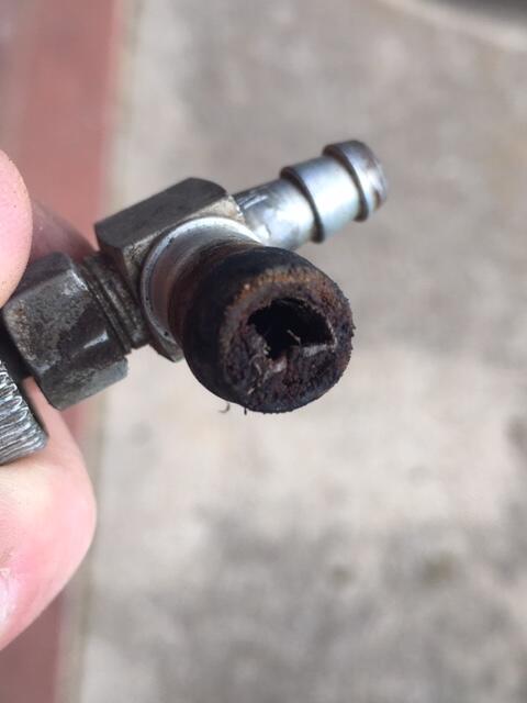

twiisted71 51 #17 Posted May 14, 2021 (edited) Alright!!!! Its done!! 8 bolts for fenders (4 for seat bracket and 4 under seat in middle of fender pan). 4 bolts for tank (two hold downs at front and 2 that bolt in from the bottom above the axles). Of course when I pulled the petcock the grommet tore. The screen was essentially gone, except for what was left in the bore that was doing nothing more than causing more restriction. For around $10 my local hardware store had an exact replacement valve and grommet. Tank was NASTY, but now its sparkly inside. All buttoned up and running like a champ again! Thank you so much for the help. I know it is a simple task but its nice to have others confirm it vs. there being one hidden fastener and ending up cracking the tank or something equally catastrophic! Oh yeah forgot to mention. I just used a little axle grease for the grommet and valve = EASY. Fit like socks on a rooster! Edited May 14, 2021 by twiisted71 3 6 Share this post Link to post Share on other sites

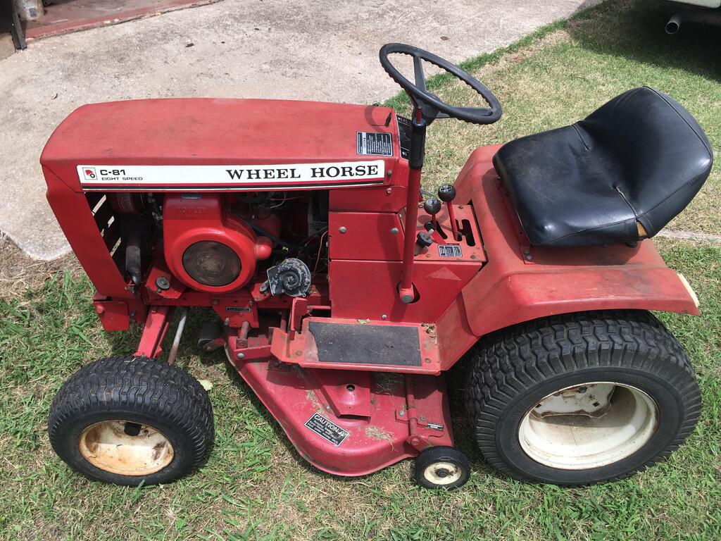

twiisted71 51 #19 Posted May 14, 2021 Yes I've got that serial number somewhere. My C-81 is a '79 IIRC. I've tried searching through the manuals on this site but just don't ever seem to have any luck finding what I"m looking for. So far as my back......... I'm on the couch on a heating pad watching terrible old movies!!!! I use impact guns and drills with socket drivers in them to speed things up to reduce the amount of time I have to be up moving around as much as I can. Everyone says it, let me repeat it. Take care of your back. Here is a shot of my girl. at some point I am going to try to put a set of rib tractor tires up front as the current ones are so old the cracks are1/8-3/16 wide!!! I'm trying to find a set of the old narrow front wheels but no luck yet. Not many WHs made it to the South. 4 3 Share this post Link to post Share on other sites

Stormin 9,987 #23 Posted May 15, 2021 10 hours ago, twiisted71 said: My C-81 is a '79 Same rears as mine. though mine was built in Belgium. 1 Share this post Link to post Share on other sites
