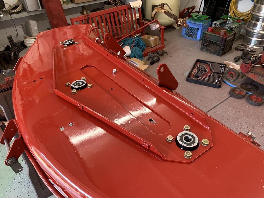

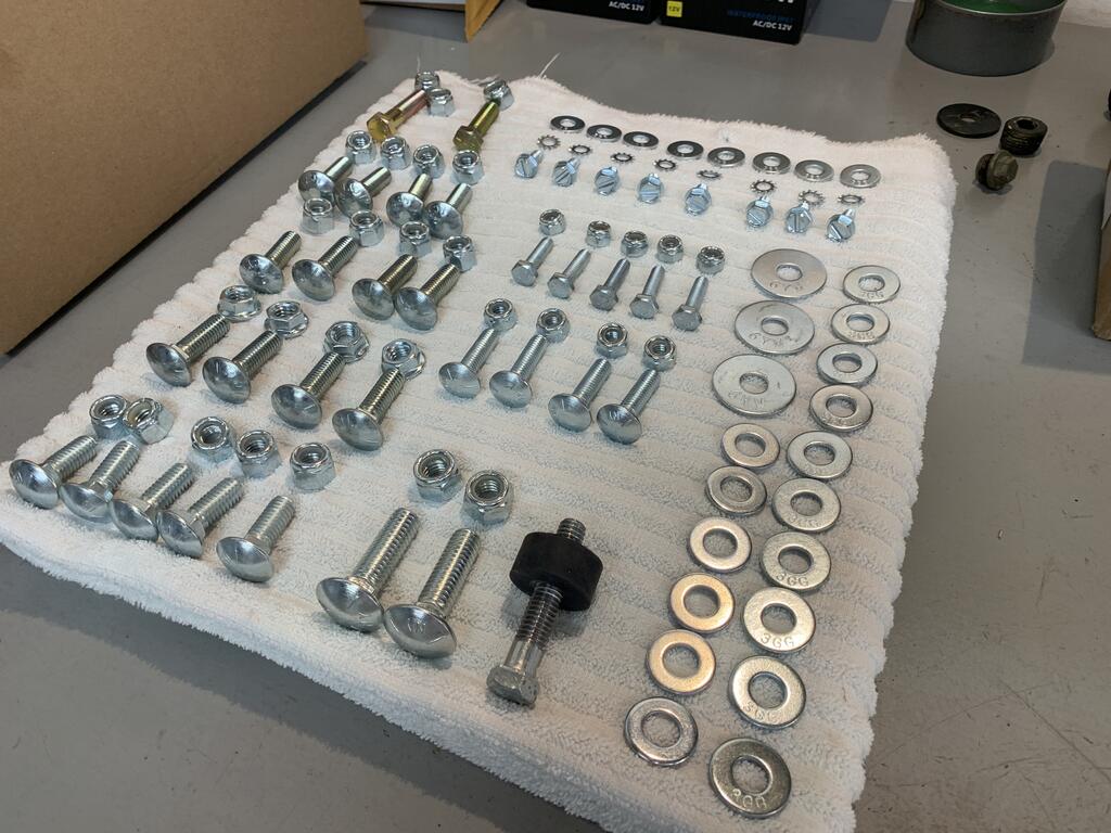

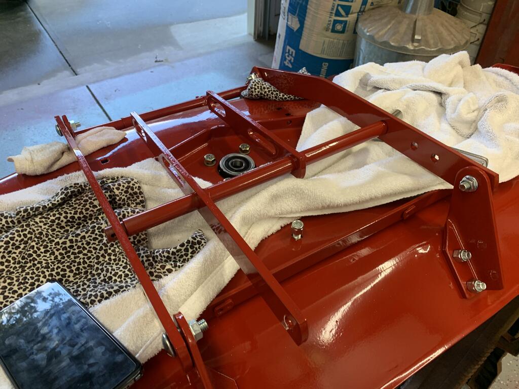

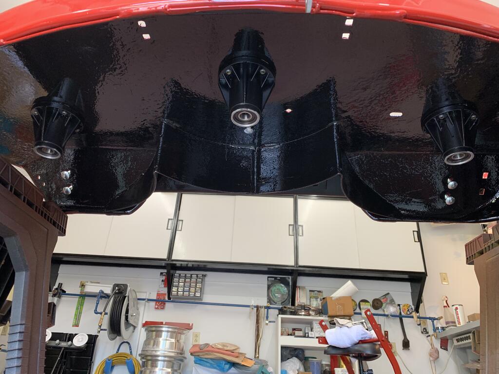

While trying to sort out bolts, nuts, and washers needed, I bolted on the spindles…
Had started on the deck carriage, but held off after noticing I had better get the pulleys and idler slide bar on first.
I used anti-sieze on the spindle mounting bolts to prevent the steel bolts from seizing against the aluminum spindle housing… hope that wasn’t a mistake…

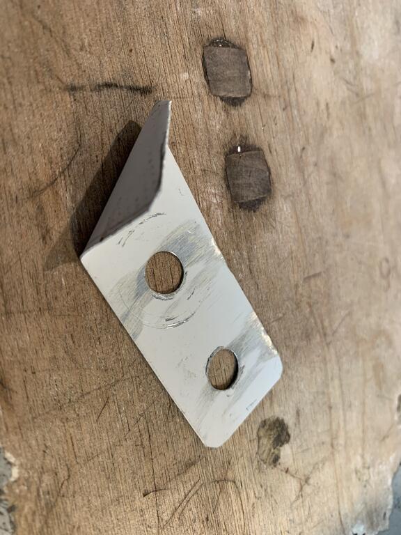

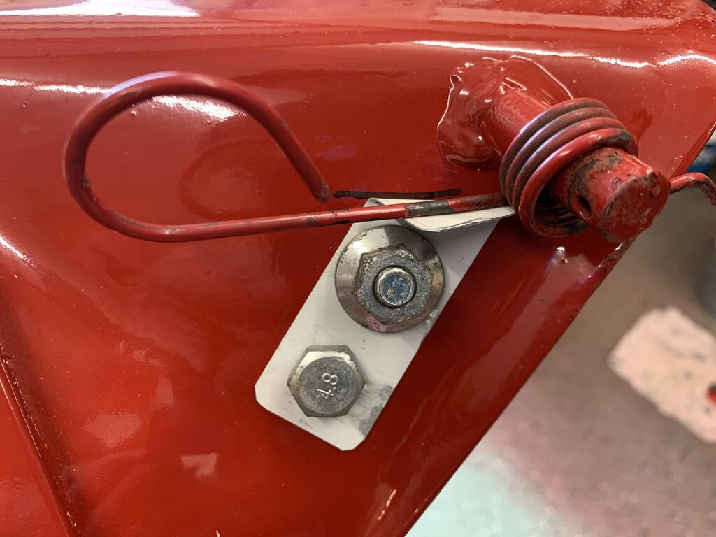

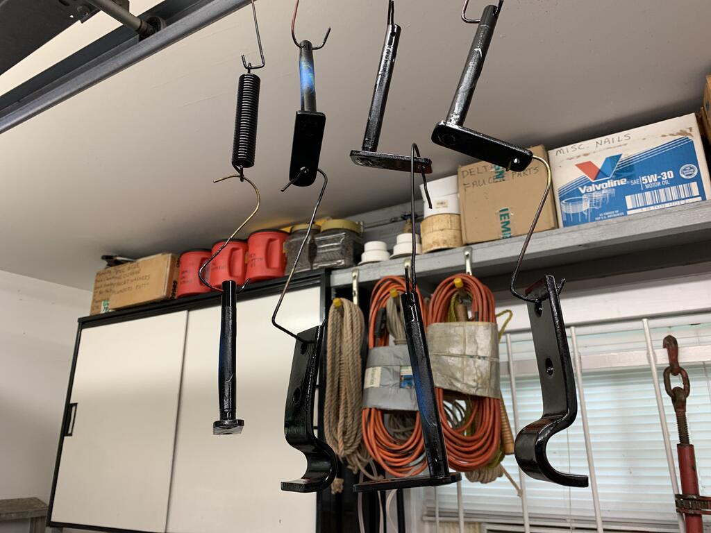

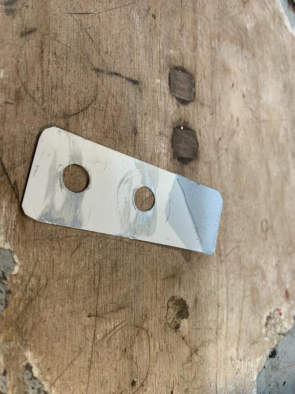

Also going to fabricate a “spring catch” for the deflector chute spring…
(this is just a thin metal “mock up” of the catch…
Edited by Horse Newbie
Jeff-C175
I don't know how or when you 'clipped' them off my clothesline, but I would like my underwear back!  :omg::text-lol:
Otherwise, excellent job!
Can't you just run a bolt through and put the loop on the bolt?

On the first comment…
you never know where a man gets his rags…:lol:

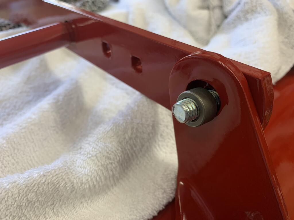

Now on the suggestion for the chute spring… see the little end that goes through the hole in the chute… if I rotate the “hoop” end down to the location of the blue bolt, I would essentially be unwinding the spring, and wouldn’t that cause it to try to lift the chute instead of holding the chute down ? … even though I know that spring is not strong enough to lift it-I don’t think… @Jeff-C175

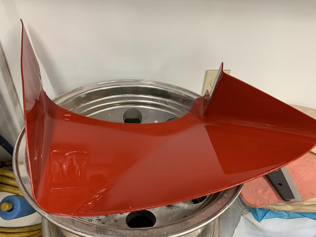

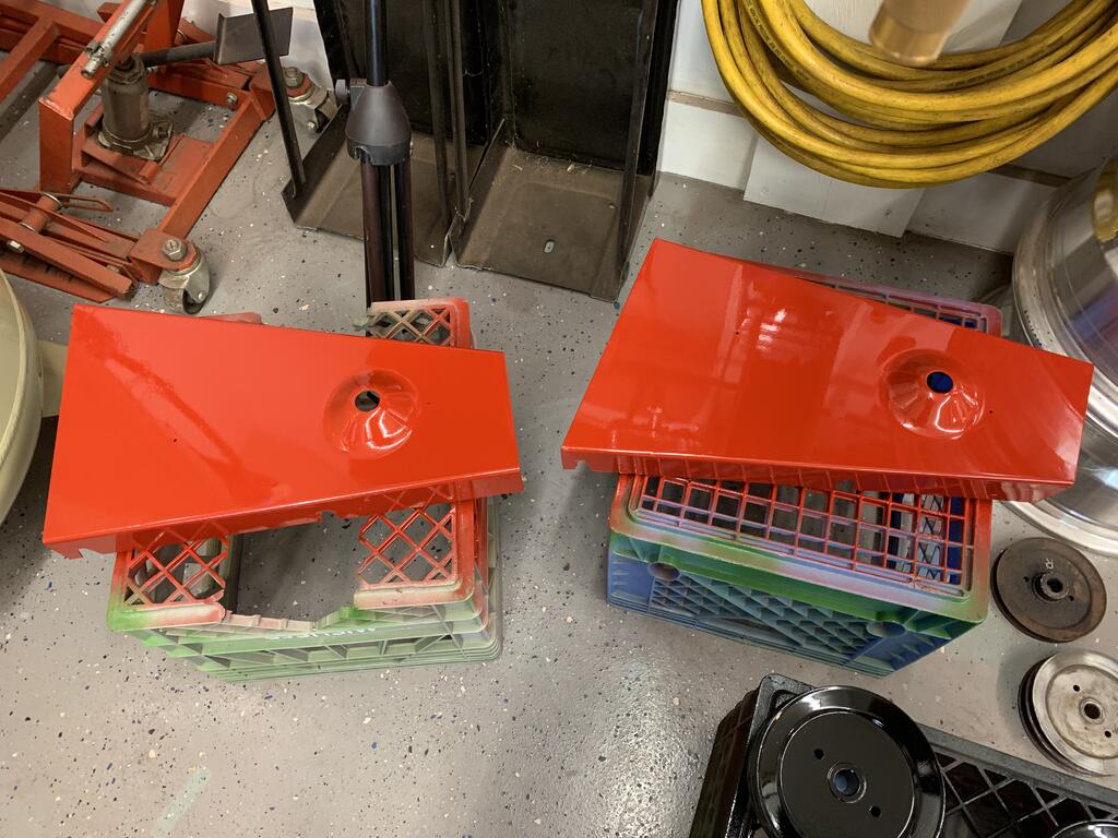

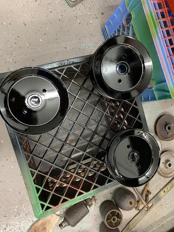

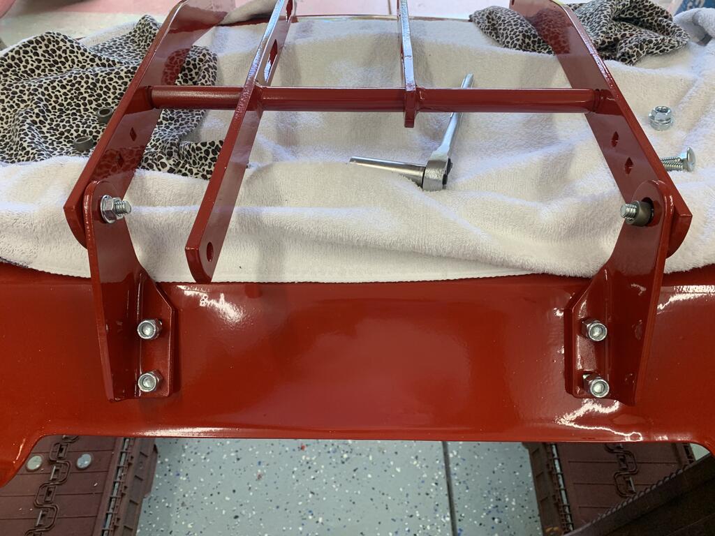

I painted some more deck parts…

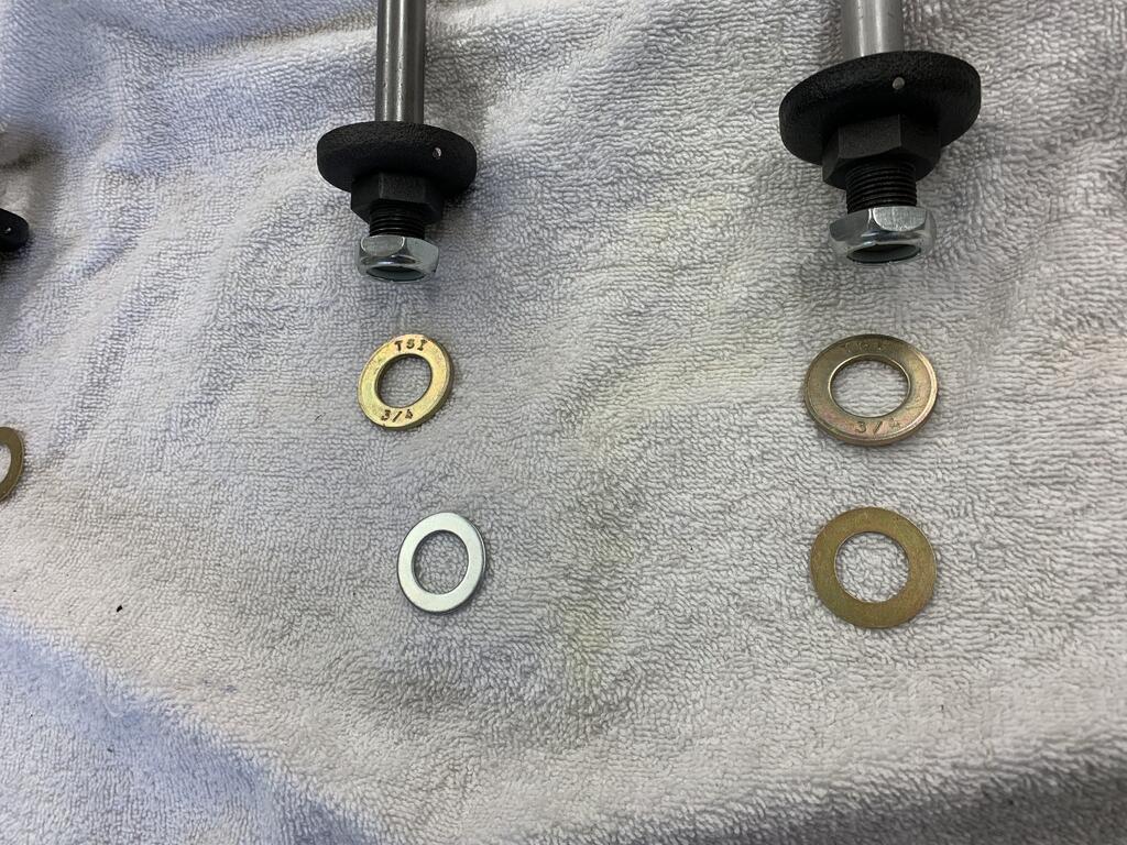

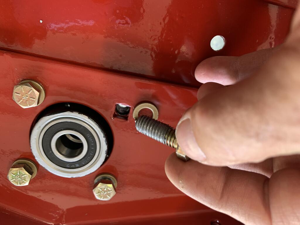

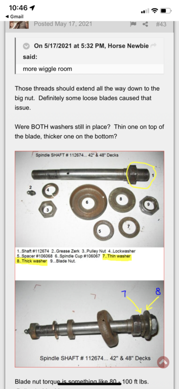

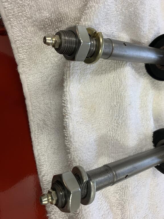

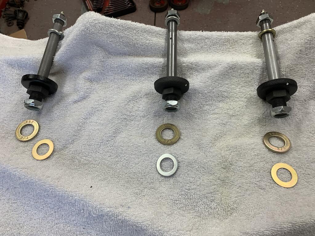

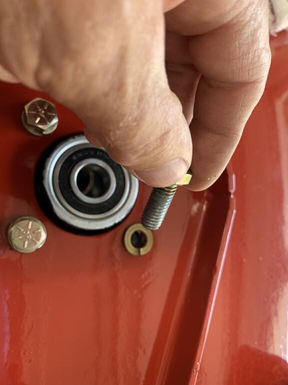

Now I have a question for you fellas…
I’m pretty sure this is the layout of the nuts and washers on the spindle shafts, but…
I have what almost looks like a jam nut (kinda thin), and lock washer on the top where the grease fitting is…
I have the Nylock nuts on the bottom to hold the blades, but…
(Pretty sure the nuts are in the right place because that’s the threads they fit).
I don’t know where the other two washers go, the big thick washer that says “TSI and
3/4 on it, and the thin washers…
I have heard some talk on here about the importance of the thin washer being in the right place, but I don’t know where it goes… also , of the 3 thin washers that Brian (K&B) sent me with the new spindle kits, one is thicker… does it being thicker matter, or do you guys think I need to contact Brian and ask about it ?

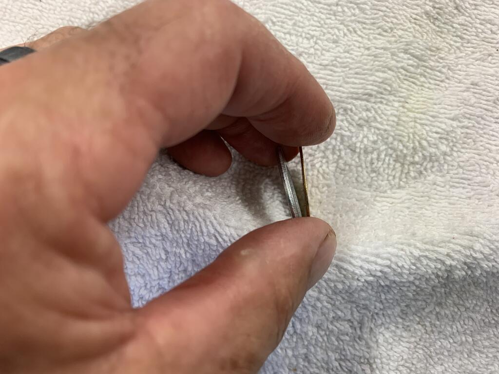

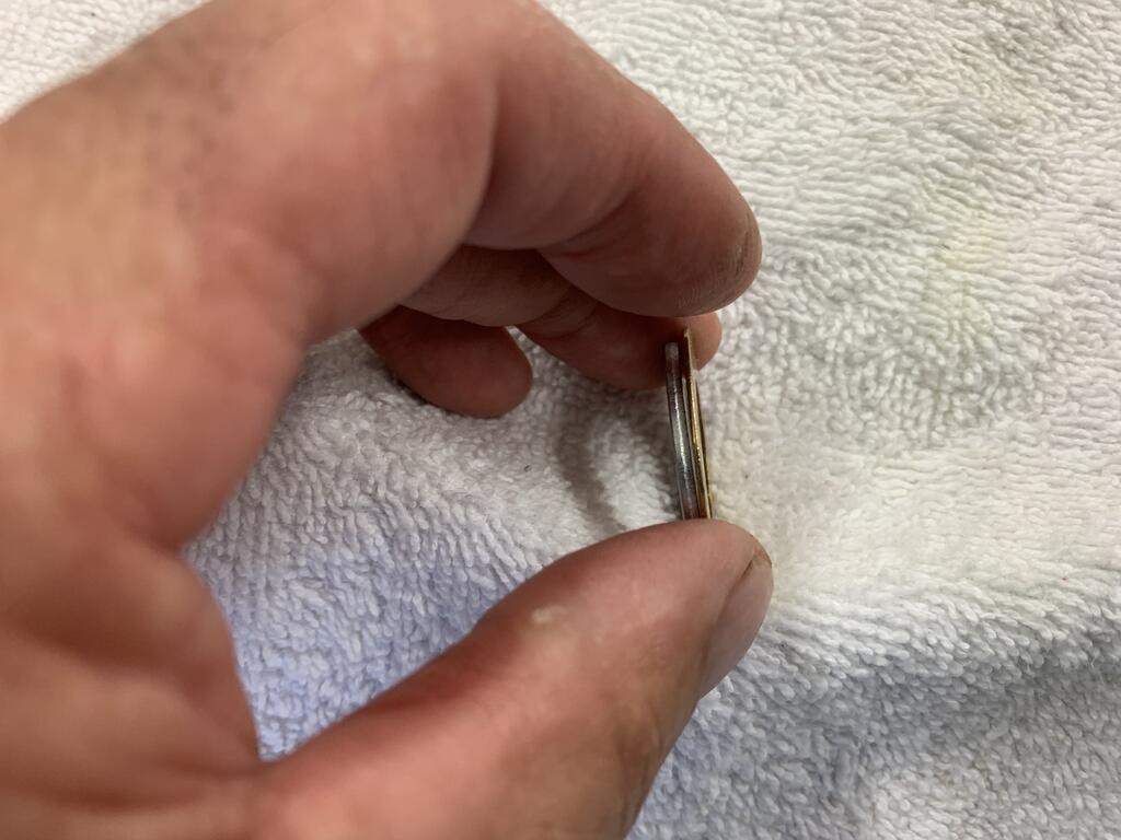

Please see last two pics concerning the thickness of the third washer…
Someone who is sure will hopefully respond, but my recollection is that the thick washer goes between the spindle nut and the blade, and the thin one goes under the nut.
I wouldn't think that the 'thin' washer thickness would make any difference.
I think you know that the torque spec is like 80-90 ft lbs, yes?  On new spindles I would torque and loosen a couple times to flatten the washers out. I don't think you need the Nyloc nuts.  I'd be a bit concerned that they are too 'soft' for that torque.  They appear to be stainless too... and stainless has a tendency to 'gall' the threads.
I would use a regular steel Grade 8 bolt myself.
https://www.mcmaster.com/nuts/system-of-measurement~inch/hex-nuts/high-strength-steel-hex-nuts-grade-8/
Didn't you get bolts with the spindles? or is that what they came with?
Edited by Jeff-C175
Horse Newbie
Top paragraph… where you say “ thick washer goes between the spindle nut and the blade”, is the spindle nut the large nut that is made into the spindle shaft ?,
or are you referring to the actual nut that holds the blade on ?
So it would be thick washer, blade, thin washer, Nylock nut ?

Jeff-C175
And what I have is what K&B sent me… I know no one is perfect, but I’ve seen Brian’s work, and it gives me great confidence that he sent the correct parts…
I will confirm though…
I should have phrased that better.
Yes, thick washer first, then blade, thin washer, nut.
At least that's my recollection, and could be wrong.
Brian knows what he's doing so I suspect you're OK.
Edited by Jeff-C175
76c12091520h
thin washer, then the blade, then the thick washer, then the nut......
In that case Brian,  I wonder about:
3 hours ago, Horse Newbie said:
of the 3 thin washers that Brian (K&B) sent me with the new spindle kits, one is thicker… does it being thicker matter?
Horse Newbie
That’s what I was thinking because when I took old deck apart the thin washers were somehow almost cupped on the spindle nut that is made into the bottom end of the shaft. And seems you would want that thick washer holding the blade…
@76c12091520h, while I have you here… From you I got  3 thick, 2 thin washers, and one regular for the bottom… can I use that regular washer on one of the bottoms of the shafts ?
Look above for maybe a better explanation, please… or these pics…
Horse Newbie
@Jeff-C175… see post # 43 and 47. It confirms what Brian said about the location of the thick and thin washers.
And @76c12091520h, is it absolutely necessary that the washer above the blade be a thin washer ? …. because if not, I will use the regular washer… it will drop one blade (center) about a1/16th lower.
cleat

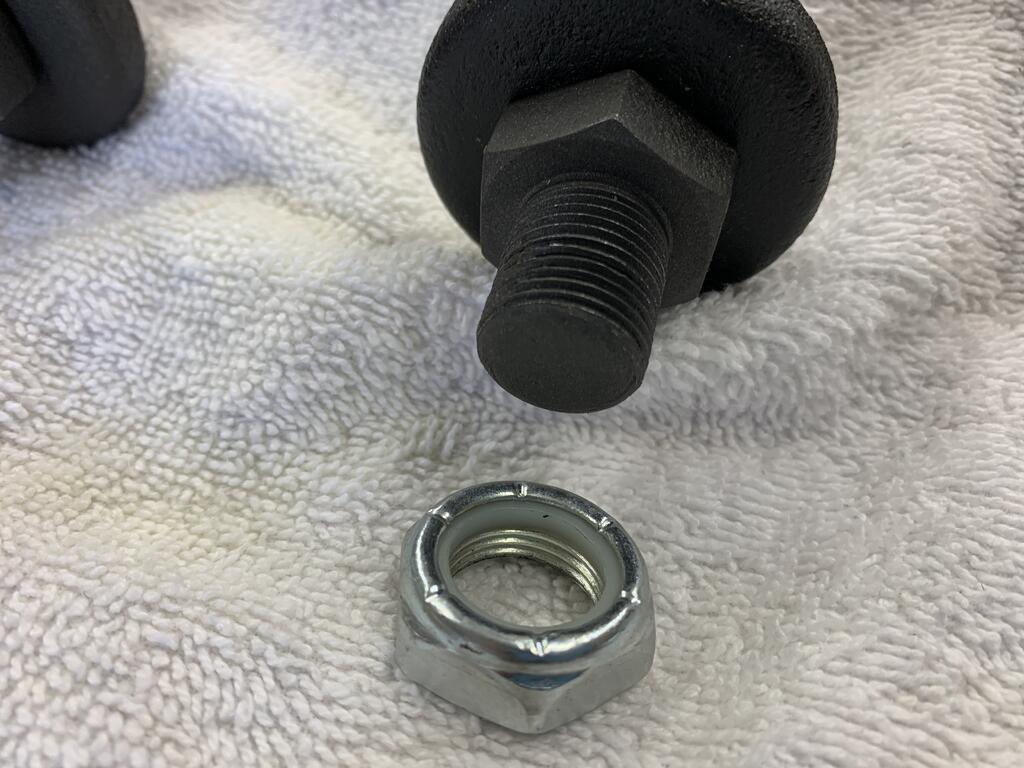

Thin washer above the blade and there should not be a nyloc nut on either end. They self tighten with operation.
I use lots of neverseize on those threads as well to be sure the nuts turn on easily.
Horse Newbie
But @cleat… see post # 43… isn’t that a Nylock nut in what looks like an official document ?
Horse Newbie
@Jeff-C175… where did you get that pic in post # 43 ?
Looks like a Nylock nut to me…
I believe that came from @daveoman1966 and now I'm all confused again because it seems to contradict the WH part diagram.
I can tell you that the new spindles I bought came with regular steel nuts for the blades.  Can't recall if the pulley bolts were nyloc or not.
The 5/16" flat washers at TSC fit 3/8" bolts perfectly.
Edited by Jeff-C175
Jeff-C175
Yes, the bolt in Dave's pic does appear to be a nyloc.
cleat
Here is the parts manual that clearly states free running nuts only.
All of my decks came with free running nuts as well.
48 inch deck parts manual bolt lengths shown.pdf
I think that nyloc nuts may prevent the blades from self tightening to the shaft with use.
Then again they might work just fine, I just never tried.
