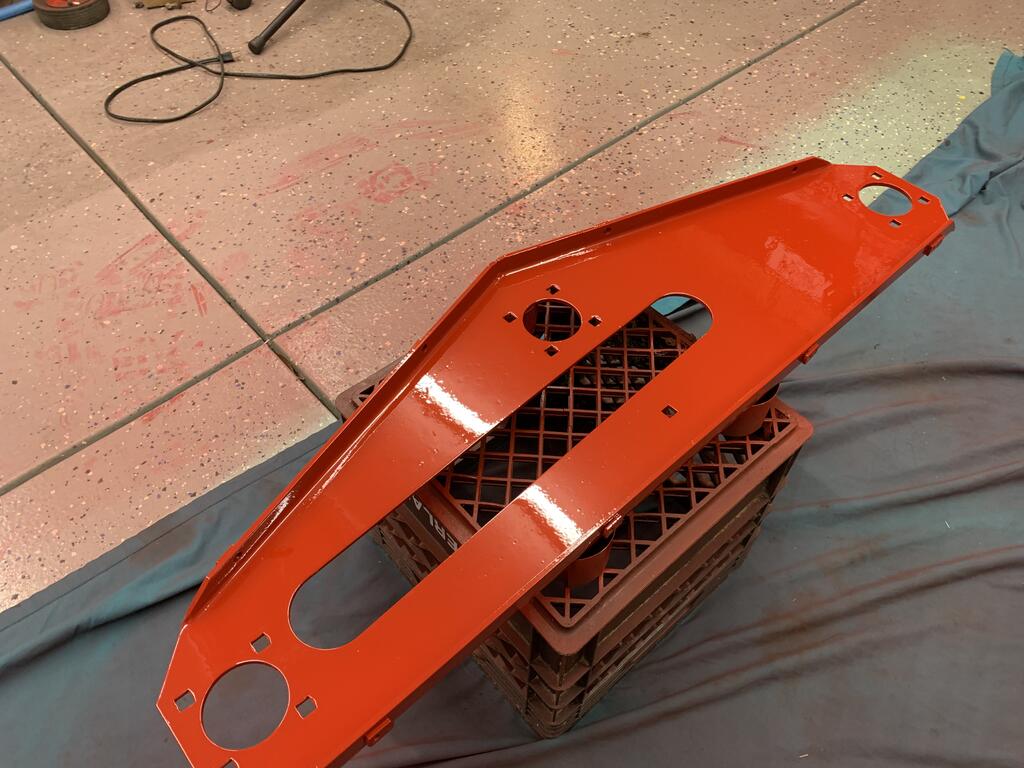

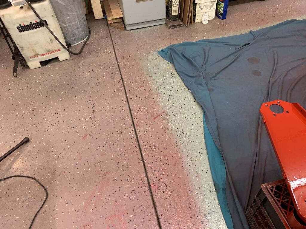

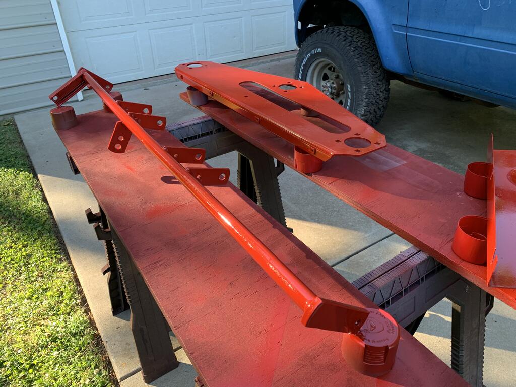

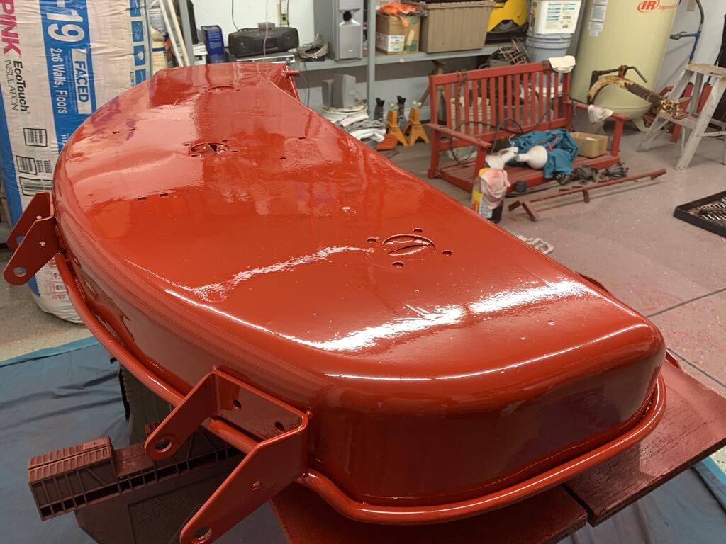

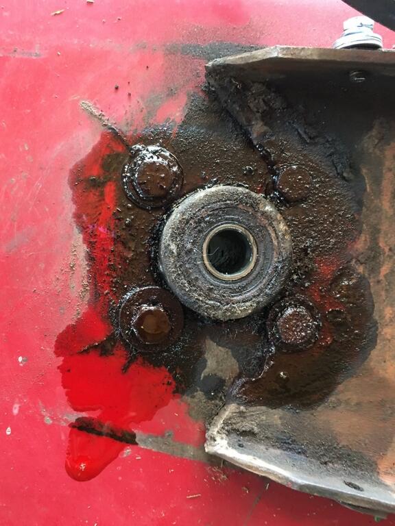

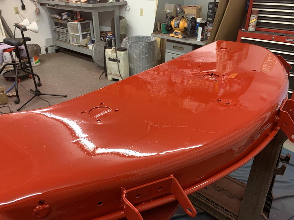

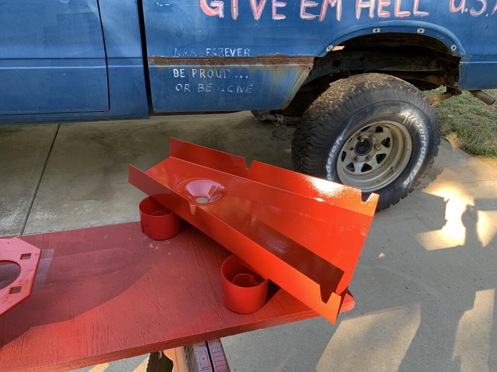

Last night I laid down some Rustoleum Regal Red on the deck and some of the hardware…
Happiness is a red shop floor…

Looks sunburned to me :lol: but what do I know.
That overspray gets everywhere!
I was painting OUTSIDE one day.  It was a calm day.  I had the garage doors open.  I had to clay bar three cars that were covered in overspray.
Lesson learned, close the garage doors!
Wife dang near killed me when I turned her Tundra pink a few months back.
A lesson many of us have learned!
Hurry up with that thing. You need to paint a hood, fender, and assorted parts from my stuff! :lol:
Looks too nice to scratch up and splatter green juice all over! :thumbs:

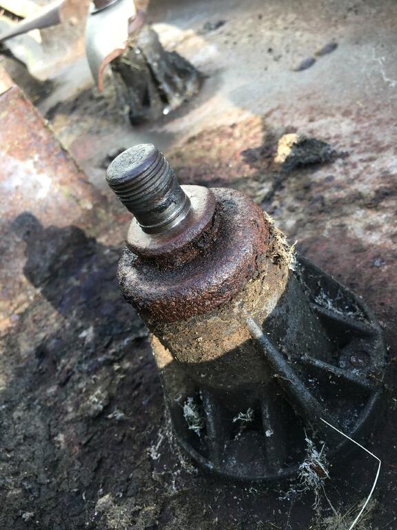

Like @Lee1977 said … I don’t believe there is any good way to remove rusted on pulleys from spindle shafts, or rusty spindle shafts from a spindle housing… on my deck that this thread is about I mushroomed the tops of two of my spindle shafts trying to beat them out… cut them off with a die grinder, then used a punch to get them started down through the spindle housing. And this was after about 2 weeks of soaking with every kind of penetrating oil I had, and heat from a MAPP torch…No telling what I did to the old bearings while doing this…
I also bent up my pulleys try to get them off the spindle shafts.
Since my spindle housings were either broken, or in bad shape I was left with not much choice except bite the bullet and buy new parts.
Was it worth it ?… I don’t know yet, but I will have what amounts to a new 1994 SD deck, and that was kinda the thought when I decided that the refreshed 1994 520H deserved a decent deck.
I know for the same money you cannot get a deck built like these today…( for the same money)…
Again @davem1111, if you do have to get new spindle housings I would reach out to

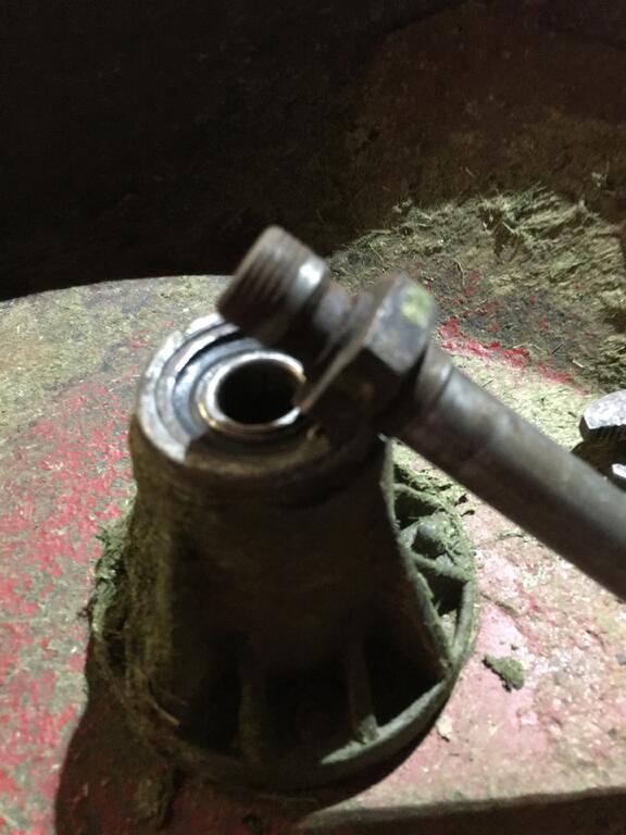

Oh, BTW, I found this when I took a spindle off the deck I'm trying to fix up:
So, changing plans again a bit.  I'm going to need to take this all apart and either swap this plate with the other deck, or do some welding.  Either will work, but if I can get the spindles off both decks I think my first choice will be a swap with a complete repaint.  And yeah, I should drill some holes and weld those cracks in the shell.  I just saw it mentioned that drilling holes can help relax the stress on existing cracks, but not exactly sure where these should be drilled.
Oh well, it will be sweet when it's done - not as nice as yours by a longshot, but decent.  I have no intention of investing enough time in this to get it looking "new".

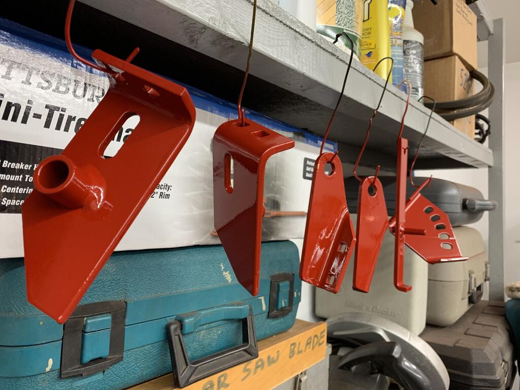

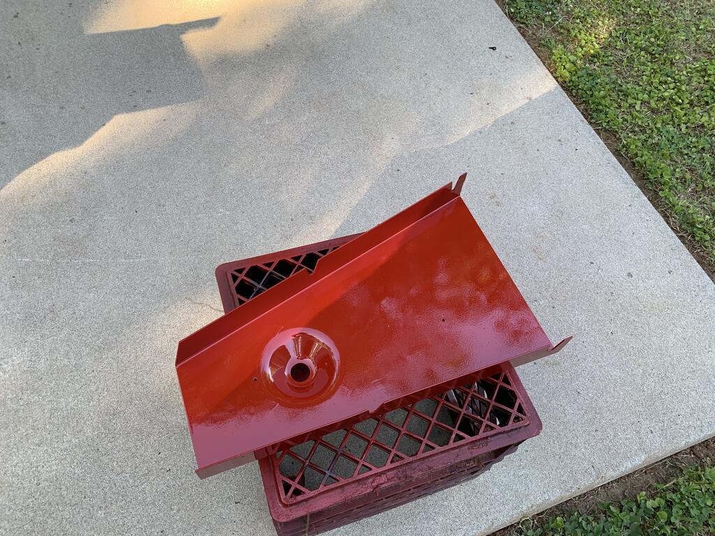

Painted some more parts…
  • Excellent 3

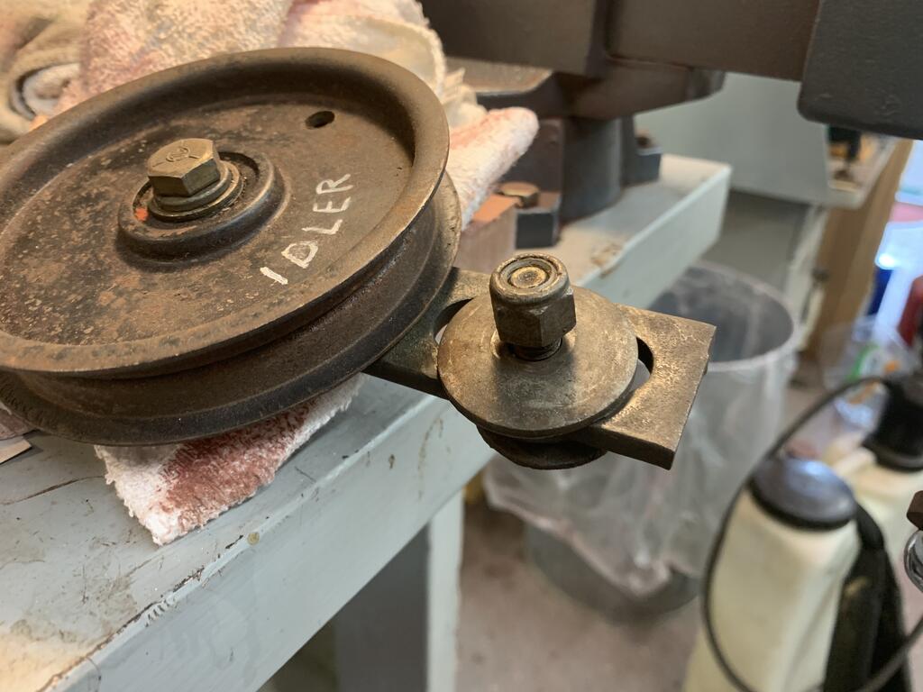

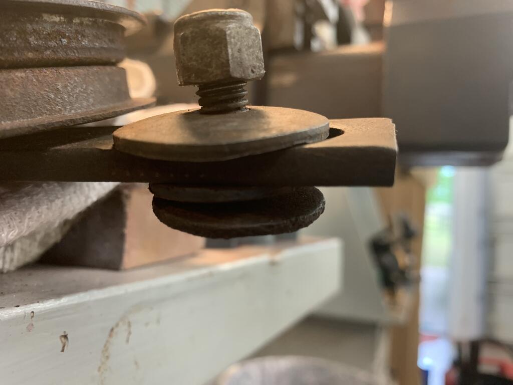

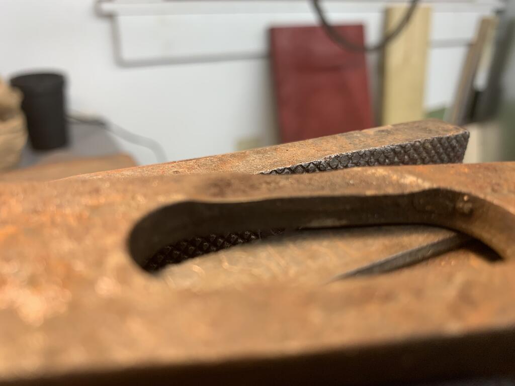

I have a question about these washers on the two bolts on the idler pulley slide bar…
are these washers supposed to be cupped ?
If they are, maybe that’s why the are referred to as “special” on the parts diagram.
So can anyone tell me if the new ones need to be cupped, or will regular washers work on top of the plastic shoulder washers on the deck idler pulley slide bar ?
Edited by Horse Newbie

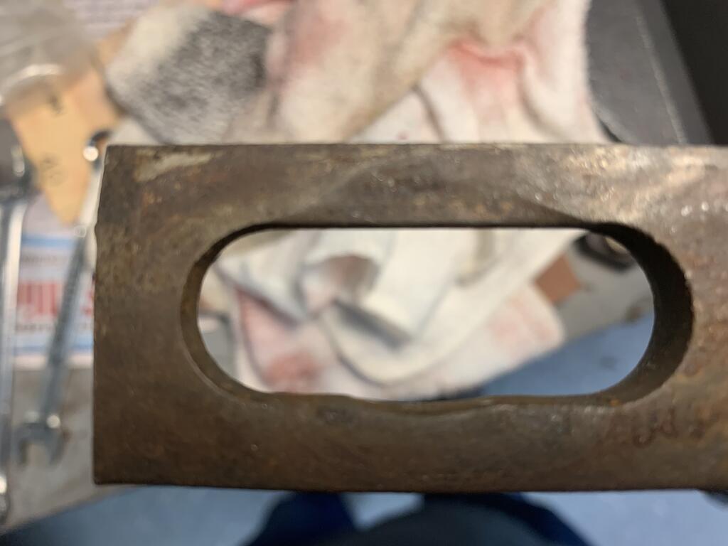

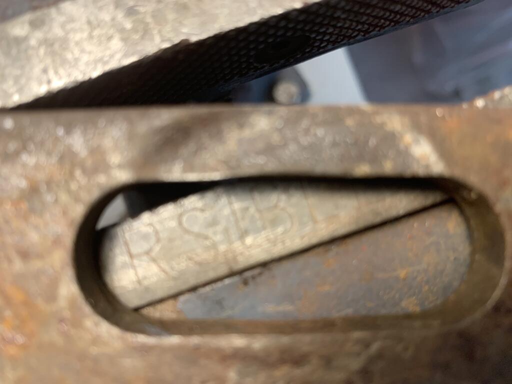

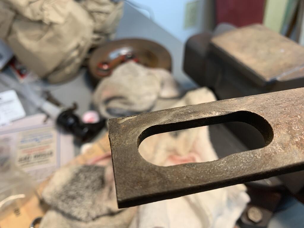

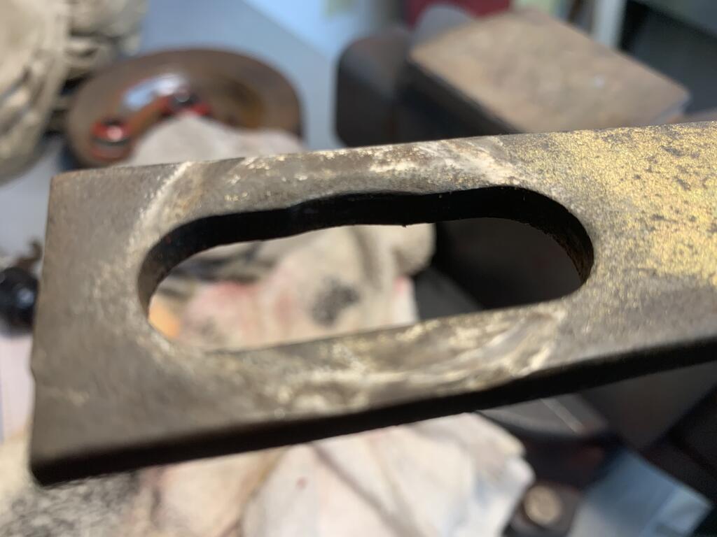

Horse Newbie
So it looks like the slide bar has some worn spots that will have to be built up with weld…
Also, the oval shaped holes in the slide bar will need to be welded up and reshaped…
Jeff-C175
I don't recall if mine were cupped or not, but it appears that if they ARE cupped it could potentially cause issues with the plastic washer 'catching' in the end of the slot.
Maybe the cup goes the other way round?
Are you installing new plastic inserts?
My bar was similarly 'carnaged' and I got a new one from Brian at K&B rather than try my poor welding skills to repair it.
