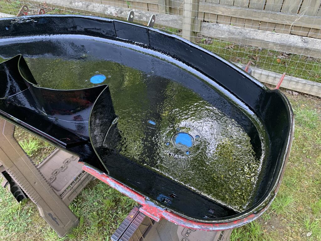

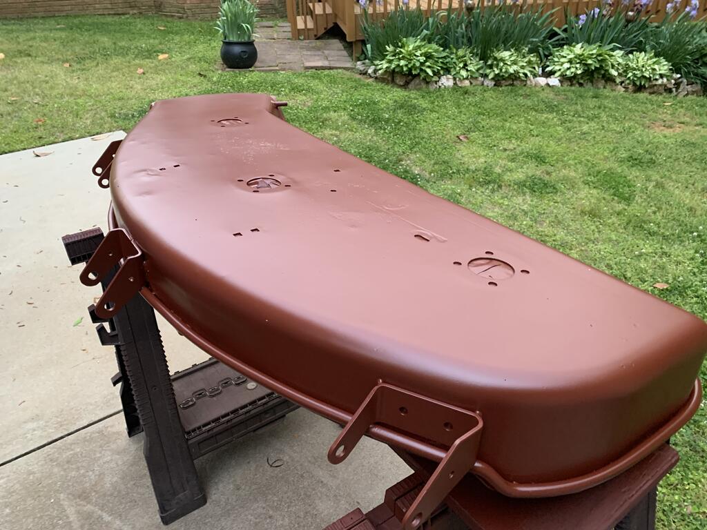

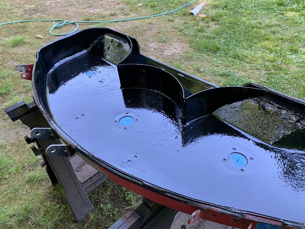

Got the 2nd coat of POR-15 on the deck…
she’ll sit there until tomorrow morning before I go to work… got to keep it out of direct sunlight…

3 hours ago, Horse Newbie said:
turned the shiny metal kinda white
That's what happens to my stuff too.  Turns the clean metal white, and any rust black.

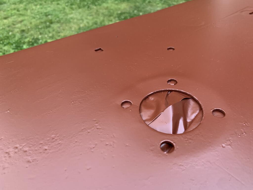

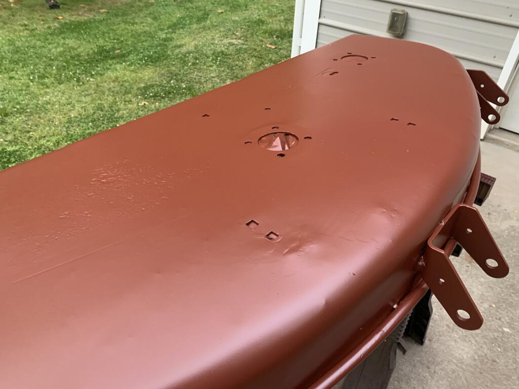

Horse Newbie

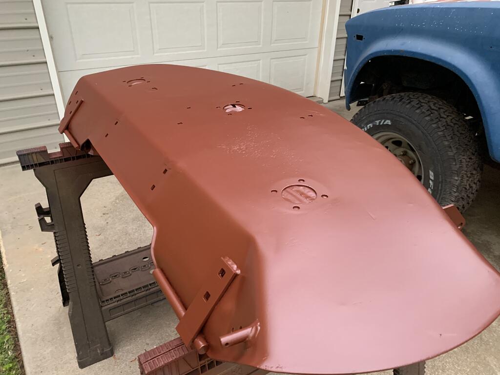

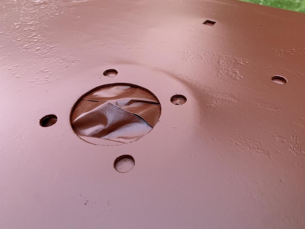

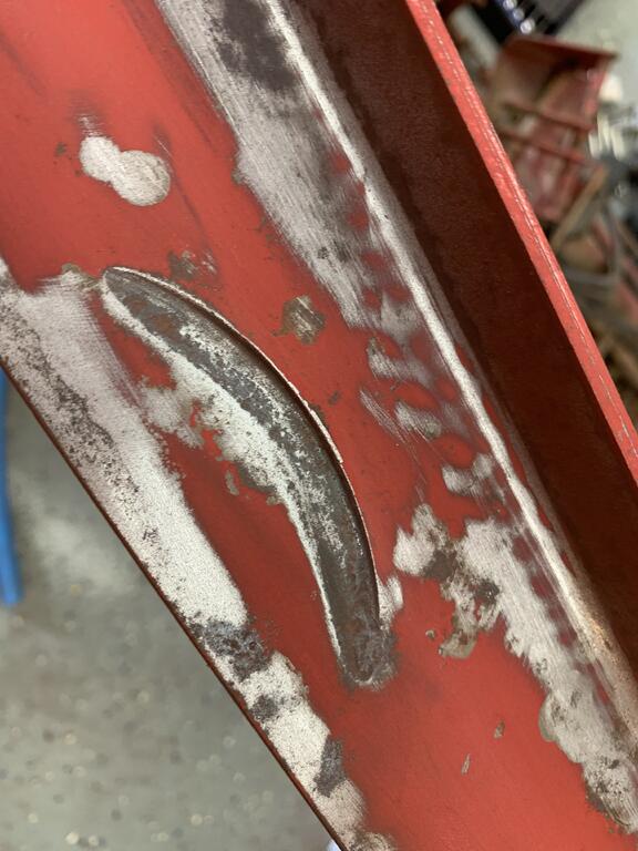

Got the outside of the 48 inch SD deck primed… she’s got a few lumps in the metal…
Didn’t really notice the area around the center spindle hole was bent until I painted…
hoping the reinforcement plate on top of the deck will hold the spindles in line enough to where the deck cuts good and even…
I’m guessing that damage was done when the PO center punched something that wouldn’t move with the center anti-scalp wheel , and when the center blade stopped there it pushed back and tweaked the deck a bit at the center spindle hole in the deck.
Edited by Horse Newbie
Jeff-C175
6 minutes ago, Horse Newbie said:
reinforcement plate
You sure that's not tweaked too?
I dunno... I would try to flatten that some, that blade will be high on one end and low on the other.
Horse Newbie
No I am not absolutely sure the reinforcement plate is not bent… will have to lay a straight edge on it…
I hope the deck works out without having to try to fatten it now… already did POR-15 on underside and primed the top.
I will bolt on the new spindles and blades and check if it’s off much before I go to whacking on it with a B.A.H.
Jeff-C175
That probably won't work anyway.  What you need is a B.A. press.
I would try a piece of u-channel and some bolts.  Drill matching holes in tbe channel, space the channel way from the botton surface, tighten the bolts down to pull it back down.
Once you get some preload on it a couple well placed whacks with the BAH will 'set' the position.
Unless you have an anvil you can set it on.
Edited by Jeff-C175

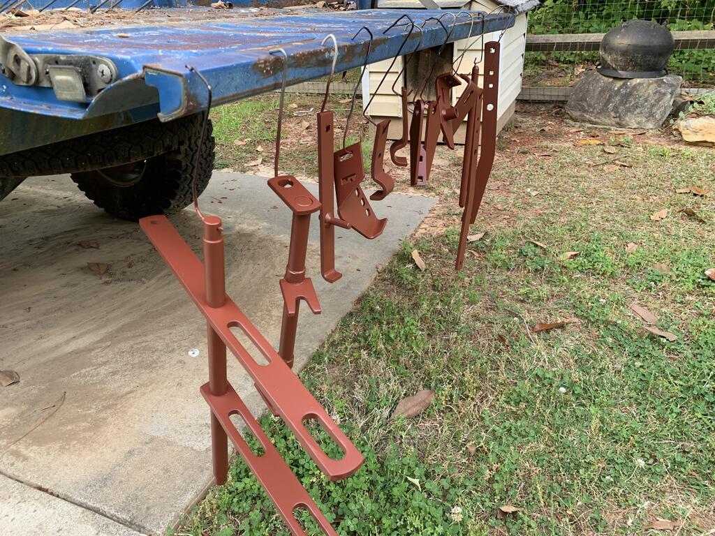

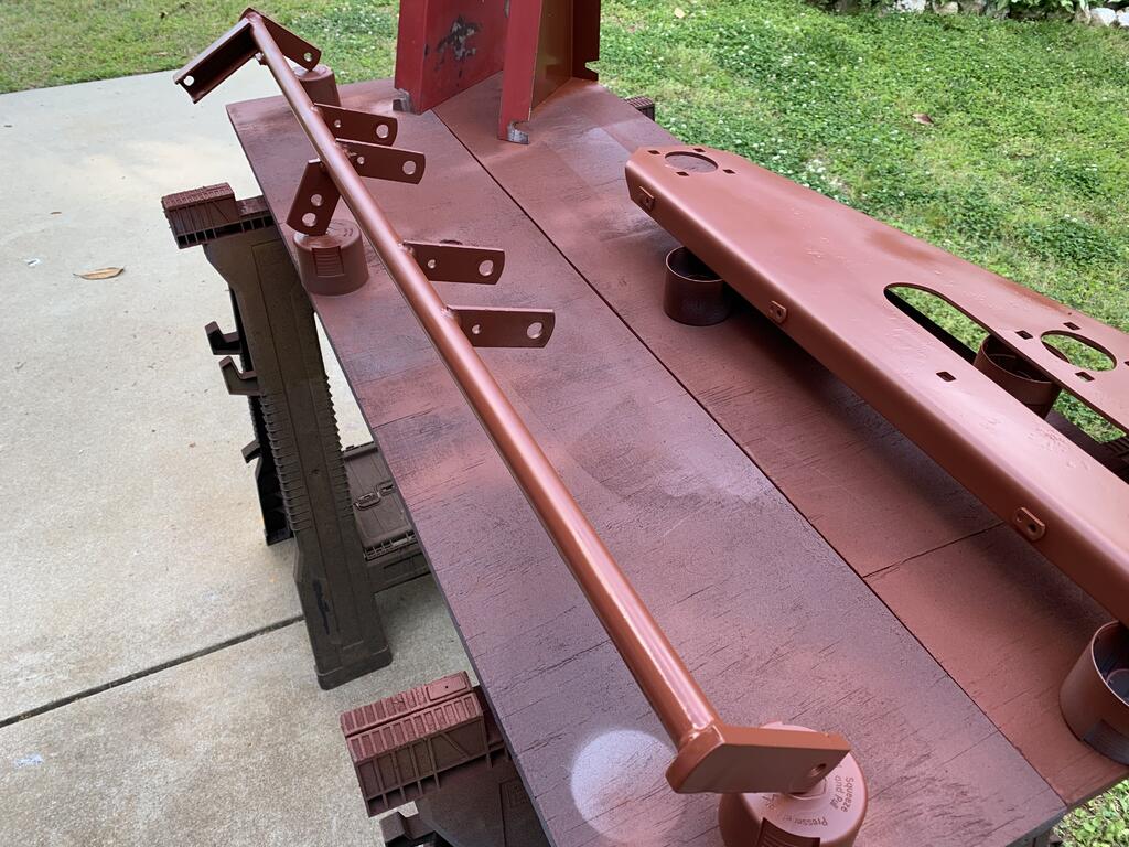

Horse Newbie
Got the deck hanger parts and the underside of the deck belt guards primed today…

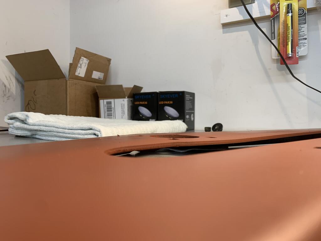

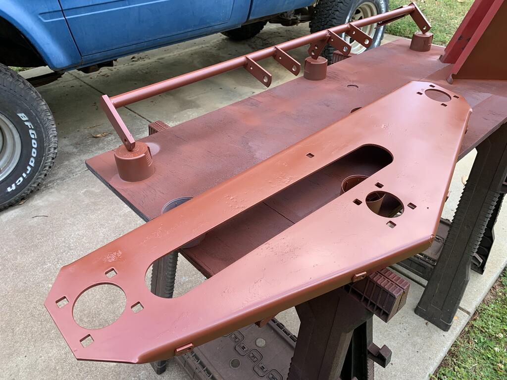

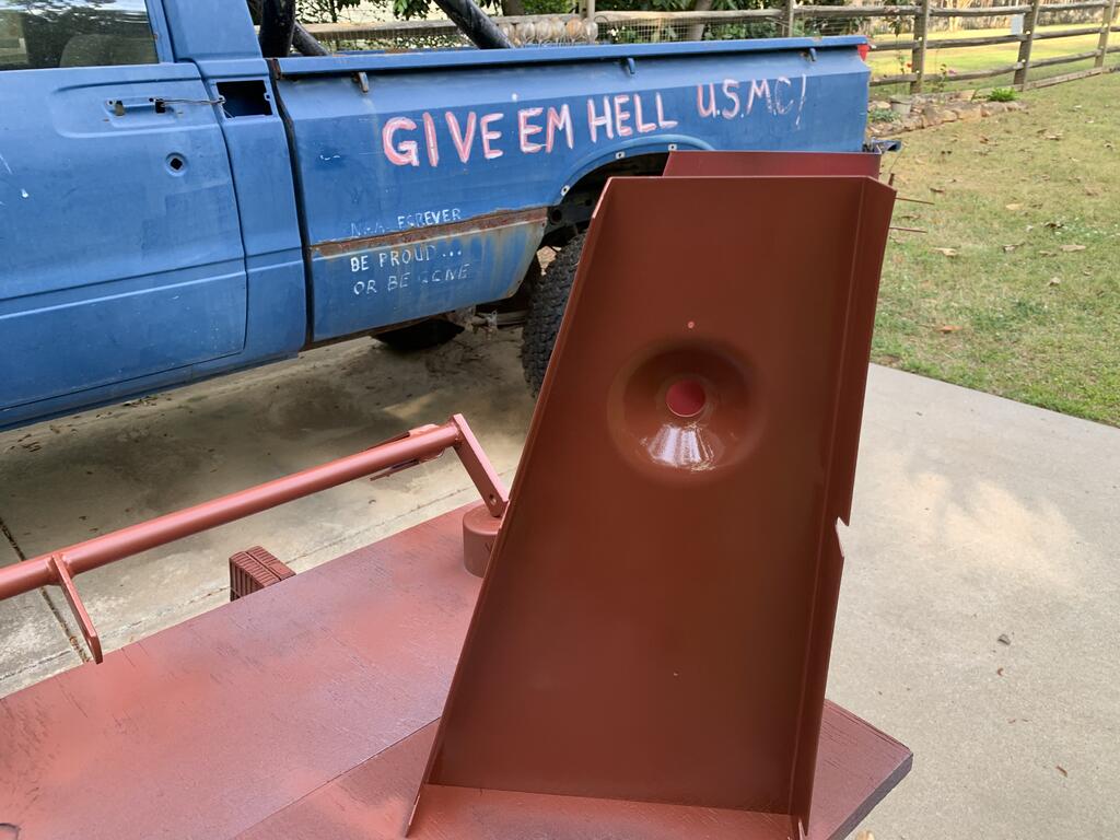

Horse Newbie
@Jeff-C175 was asking if the deck reinforcement plate was bent too, as the deck had a slight bend at the center spindle hole… the plate is bent a little at the center spindle hole as well.
I don’t think it’s enough to make my yard weeds look bad…:lol:
You may be able to see it in this pic…
Funny, I couldn’t see these bends until I primed the parts…

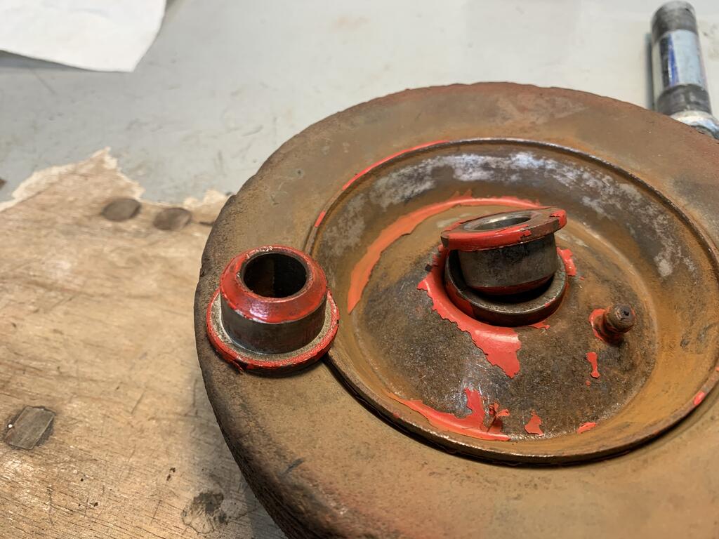

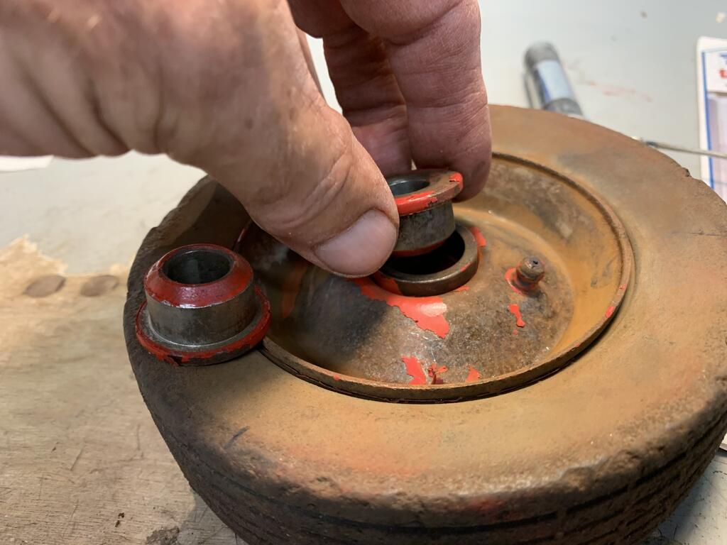

So I’m trying to decide whether to get new gauge wheels or paint the old…
I already know I need to get new lawn mower wheel bolts… does anybody know what these wheel center inserts are called ?… probably will check McMaster Carr for those…
Jeff-C175
I wonder if it's enough to cause belt alignment issues?
Since there's no POR15 on that part it might be worthwhile to see if you can flatten the plate.

Horse Newbie
I don’t know about the belt alignment issue yet… that is something I will definitely look at when I do the “mock up” before the Regal Red goes on…

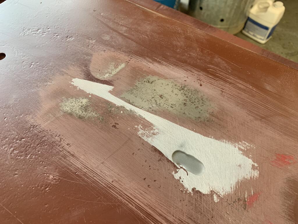

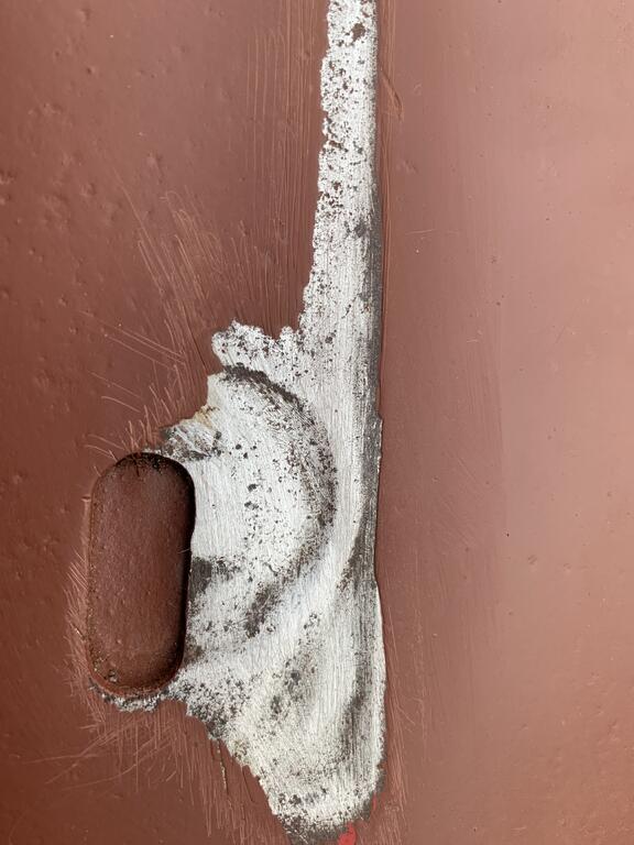

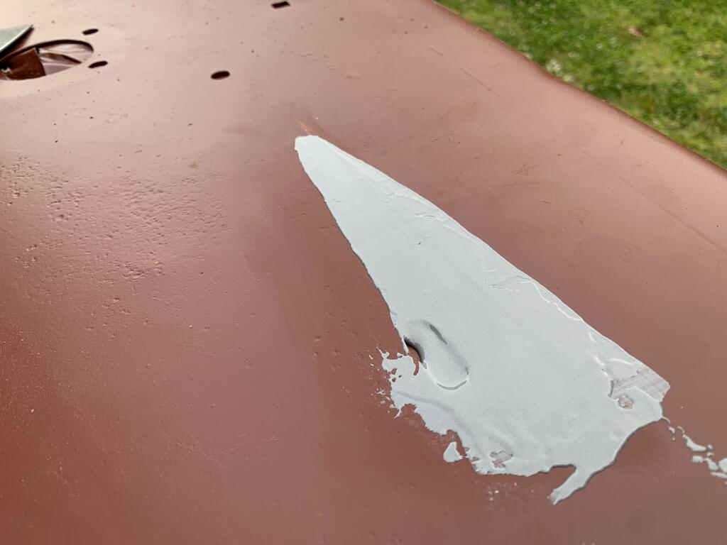

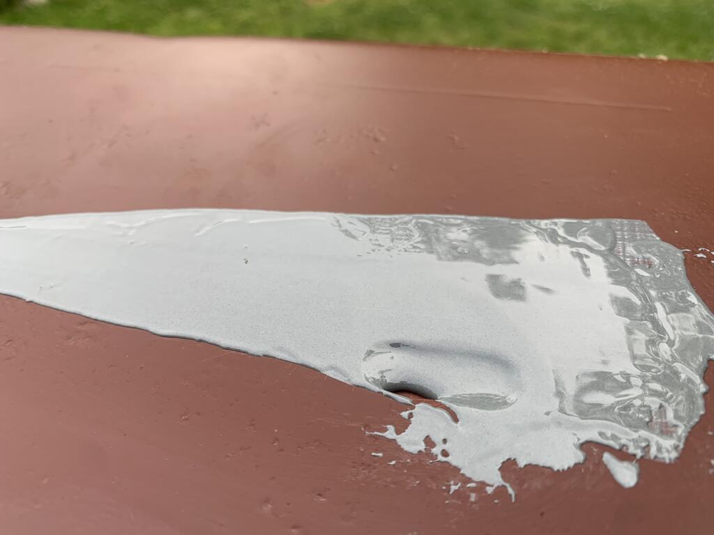

I also was bothered by this worn spot in the deck where the idler pulley slide bar rides… looks like it is where one of the plastic washers sits underneath the slide bar…
I roughed that area up with some 60 grit sandpaper and put some J-B Weld on it.

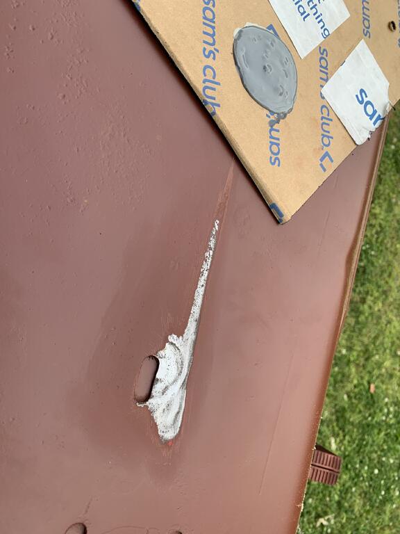

I sanded down the JB Weld that I had applied to the deck surface where the idler puller slide bar rides… definitely is gonna make the surface where the slide washers sit flatter and should bring back the performance level to “almost like new”.
I guess while I’m at it, I may as well put some JB Weld in this groove that the idler pulley wore into the deck reinforcement plate…

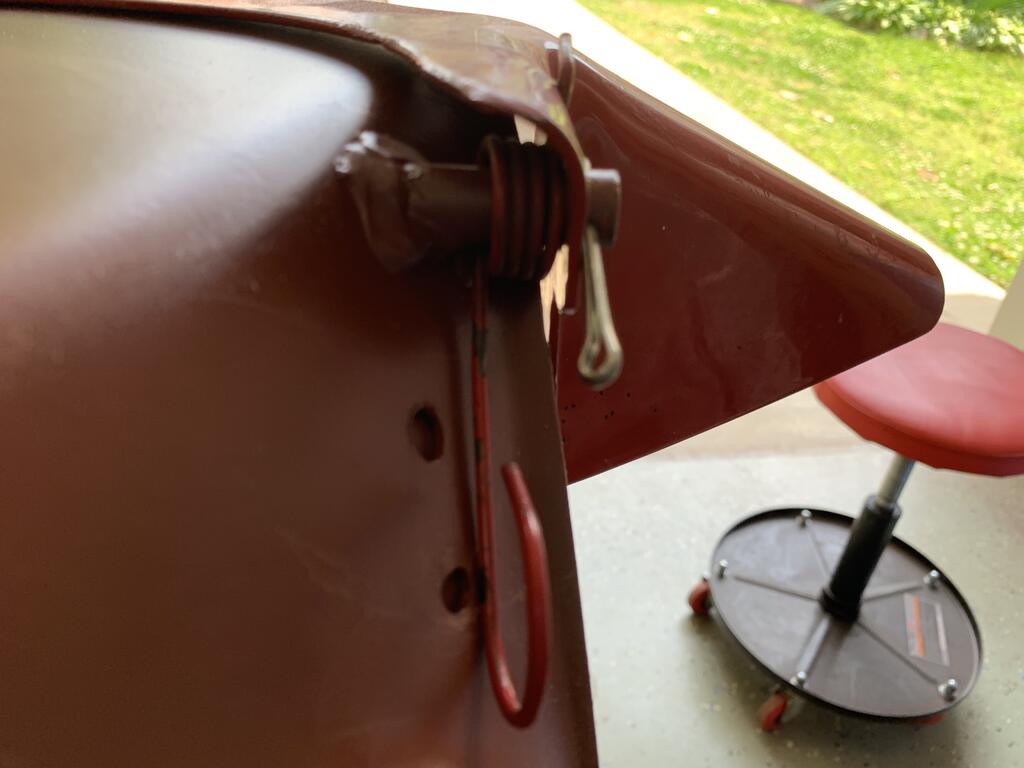

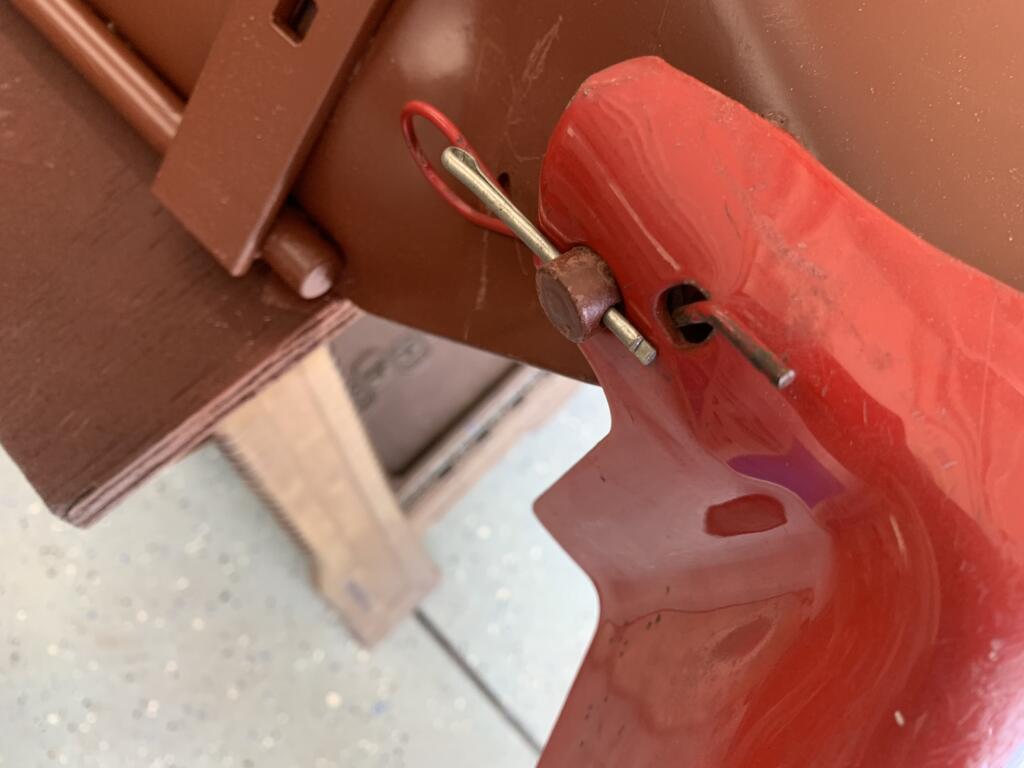

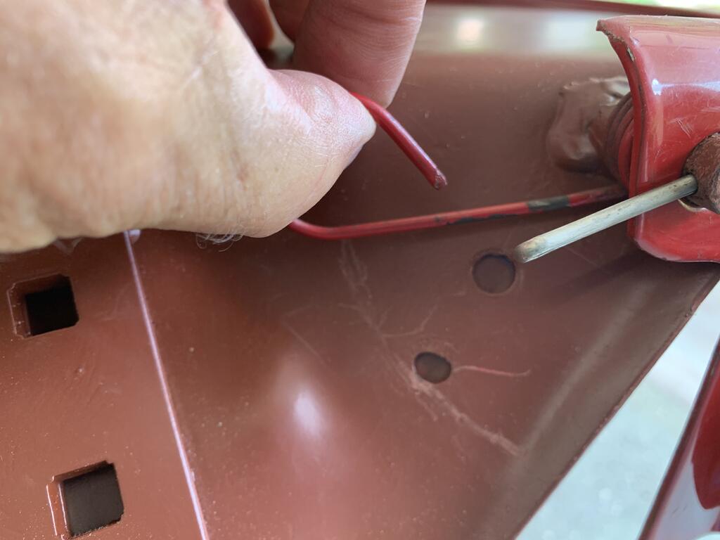

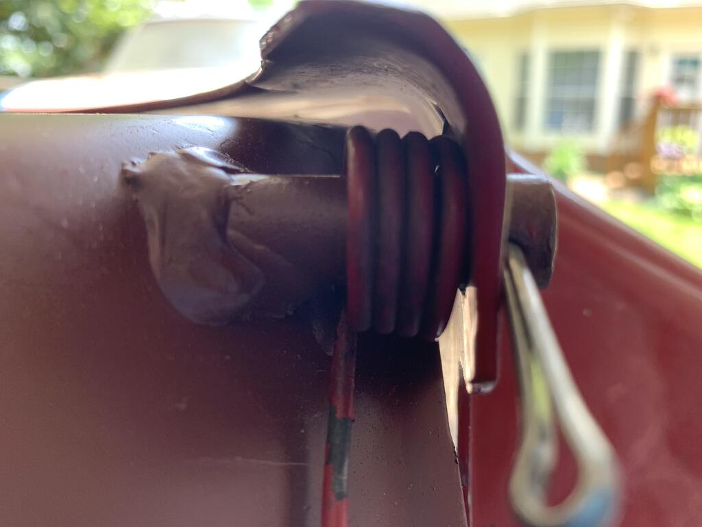

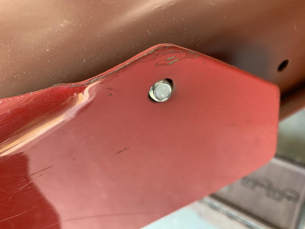

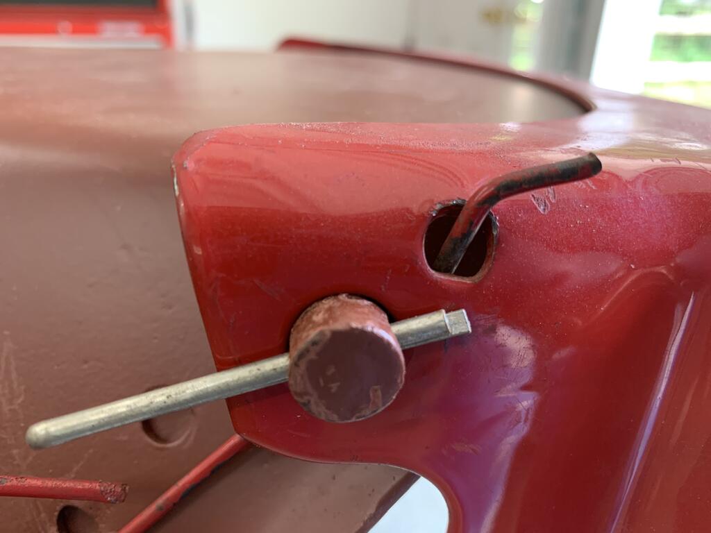

Also trying to figure out how to mount the deck chute… got the correct spring from Lincoln at A-Z Tractors, now I’ve just got to figure how to make it all work. I know on the front where a bolt (3/8 ths I think) comes through the deck there should be a rubber spacer… will probably have to fab that…
Is there any of you who use the deck chute on the 93-94’ 48 inch SD deck that can put some pics on here to help me out ?
Horse Newbie
Will fab up a small “spring stop” to mount in these two holes…

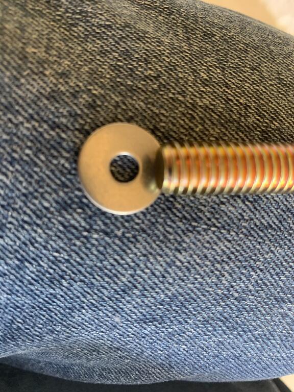

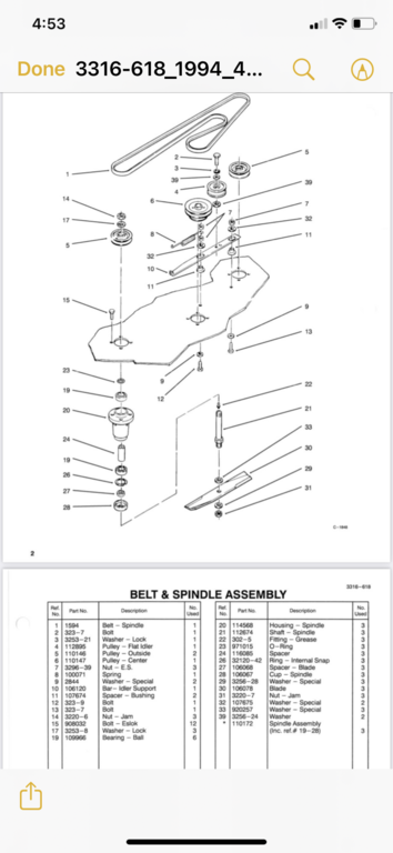

I have been working some more on the deck… ran into a couple of little SNAFU’s…
Take a look at the parts diagram…
I ordered parts 13,12, and two 9’s…
Can someone tell me what’s “special” about these two washers ( the # 9’s ) ?
Must be special because the washers that were sent have 3/16ths holes, and they’re supposed to go on 5/16ths inch bolts.
I suppose PartsTree sent the wrong washers, as the bolts were in sealed plastic bags and the two # 9 washers were in Zip-Lock baggies like they were hand picked out of a box of bolts on a shelf.
