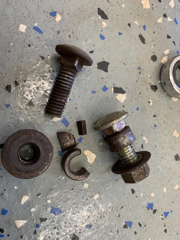

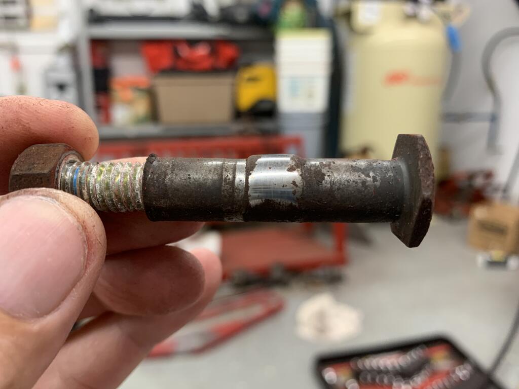

Hey fellows and/ or ladies, got a few questions for you all who may have restored some WH decks…
First of all what re these bolts called ?…
I call them shoulder bolts, or carriage bolts… can you get them at McMaster-Carr ? They are the bolts for the gauge wheels.

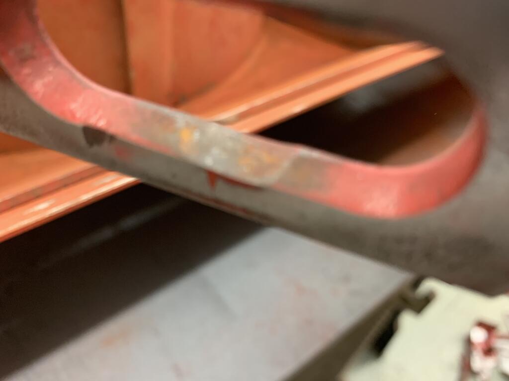

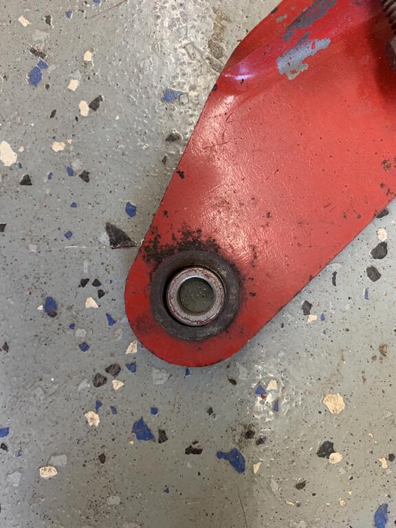

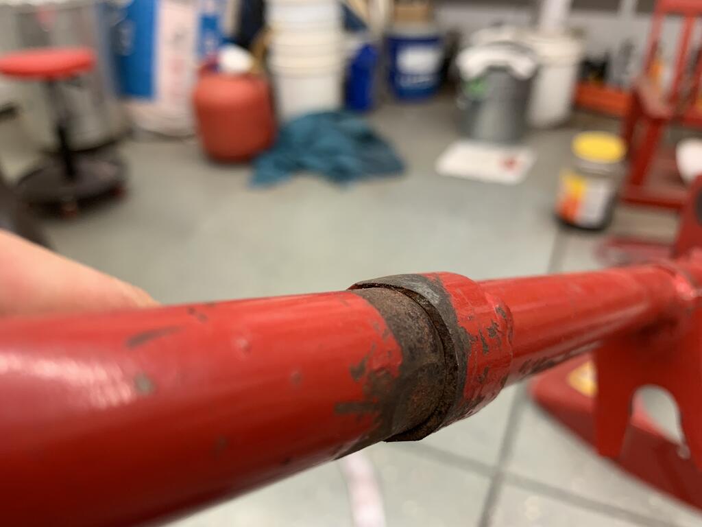

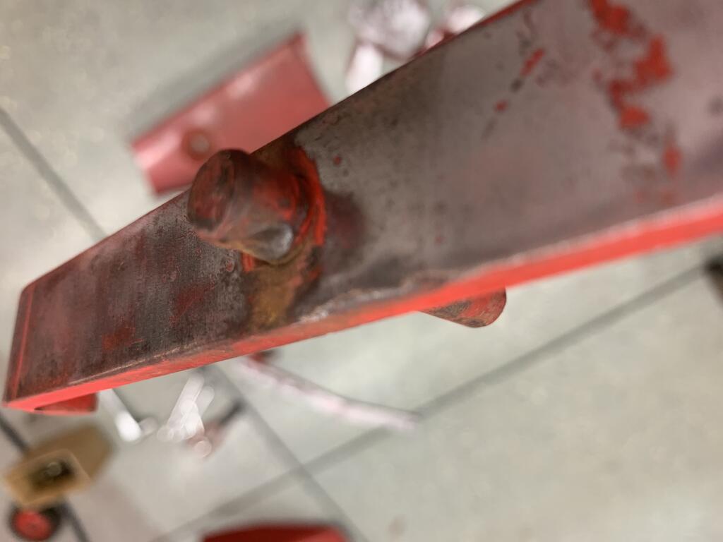

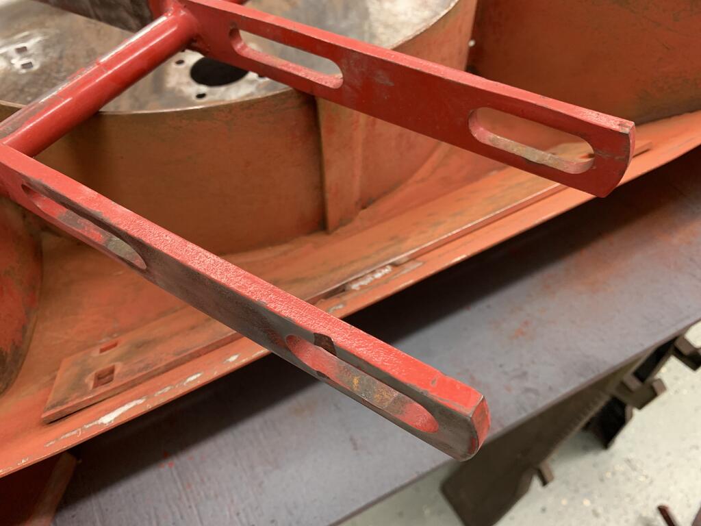

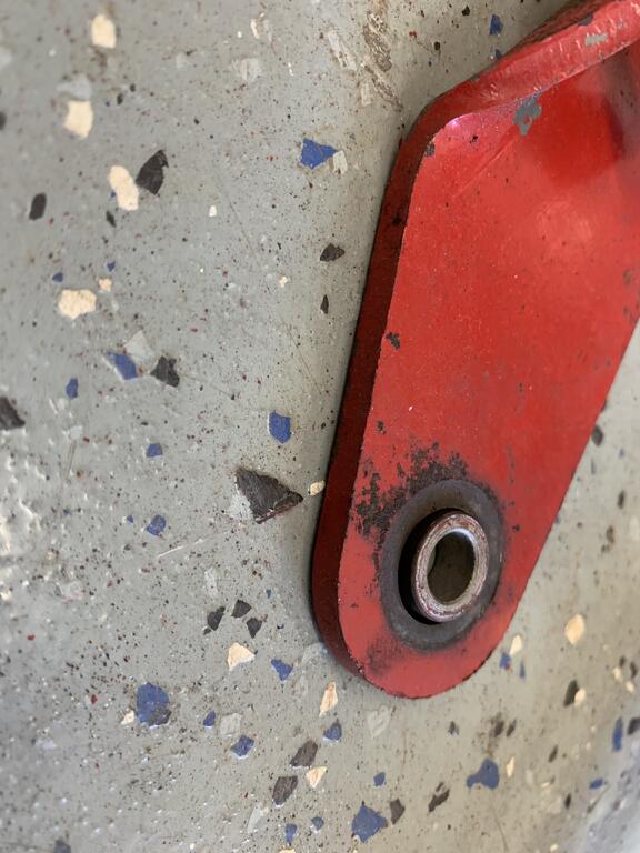

Next group of pics (next 3)…are these collars or spacers supposed to be a tight fit it the bracket holes. These are the ones that go on the bolts that go from the brackets to the two long flat bars at the outside of the deck hanger on both sides. The long flat bars are slightly bent from the factory. One of them was shattered when I unbolted it.
Next 4 pics… I have some wear marks in the deck hanger bracket pieces… would you just apply weld to build up these areas, grind and file them down as good as you can, or not worry about them ? The wear is on the little post on the height adjustment lever, and the bracket it goes in, the round cross bar at the attach-a-magic, and the slots in the long, bent, outside bars.
They are called lawn mower wheel bolts, note the thin head.  Standard shoulder bolts can be used if you aren't concerned with keeping it original.
The broken hardware needs to be replaced, the wear that you show is not excessive so no need to weld.
I grease the wheels every time I mow and apply oil to all those wear spots from time to time.  Your wheels haven't seen grease since the last ice age.
When you say hardware, are you talking about all broken hardware ( I assume you are), or the sleeves that the bolts run through that hold the deck hangers to the brackets on the deck?
Also, are these sleeves hardened, and would you try to find ones made to size, or just buy some sleeves at the local hardware, and cut to length ?

lynnmor
The sleeves are hard and you probably need to buy OEM.  The other items are cheap and I would just replace with hardware store stuff. Grade 5 fasteners would be best.

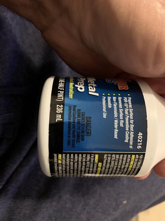

I can't say exactly which one, but the "cleaner/degreaser" smells just like one of the common ones, perhaps "Zep" or whatever it is called.
The metal prep is most definitely phosphoric acid.  Smells like the exact same f4rts.

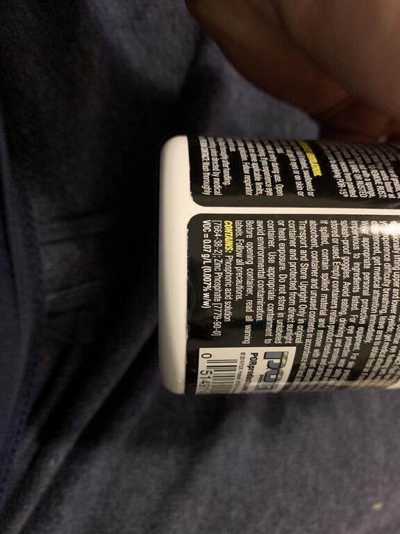

Horse Newbie
@WHX?? and @Jeff-C175
Herr ya go…
Horse Newbie
This is the Cleaner/ Degreaser…
Edited by Horse Newbie

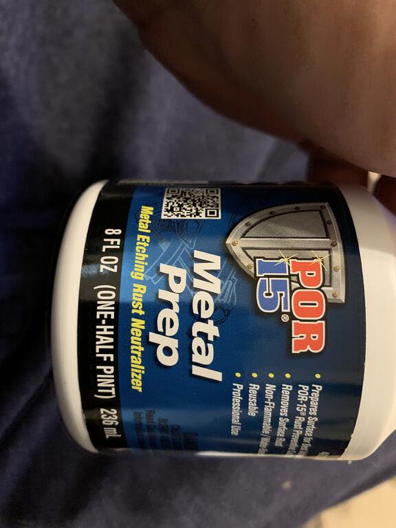

Horse Newbie
Here is the Metal Prep…
Let me know if you need any more pics in case some of these are not readable…

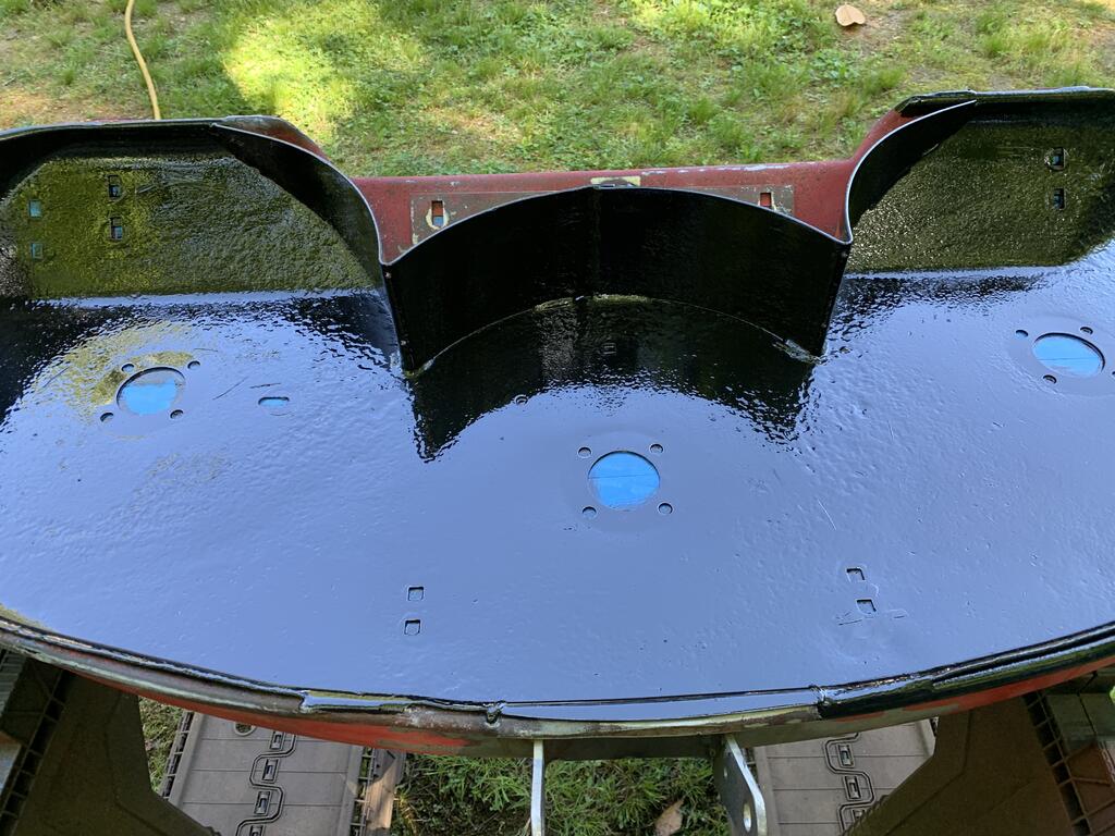

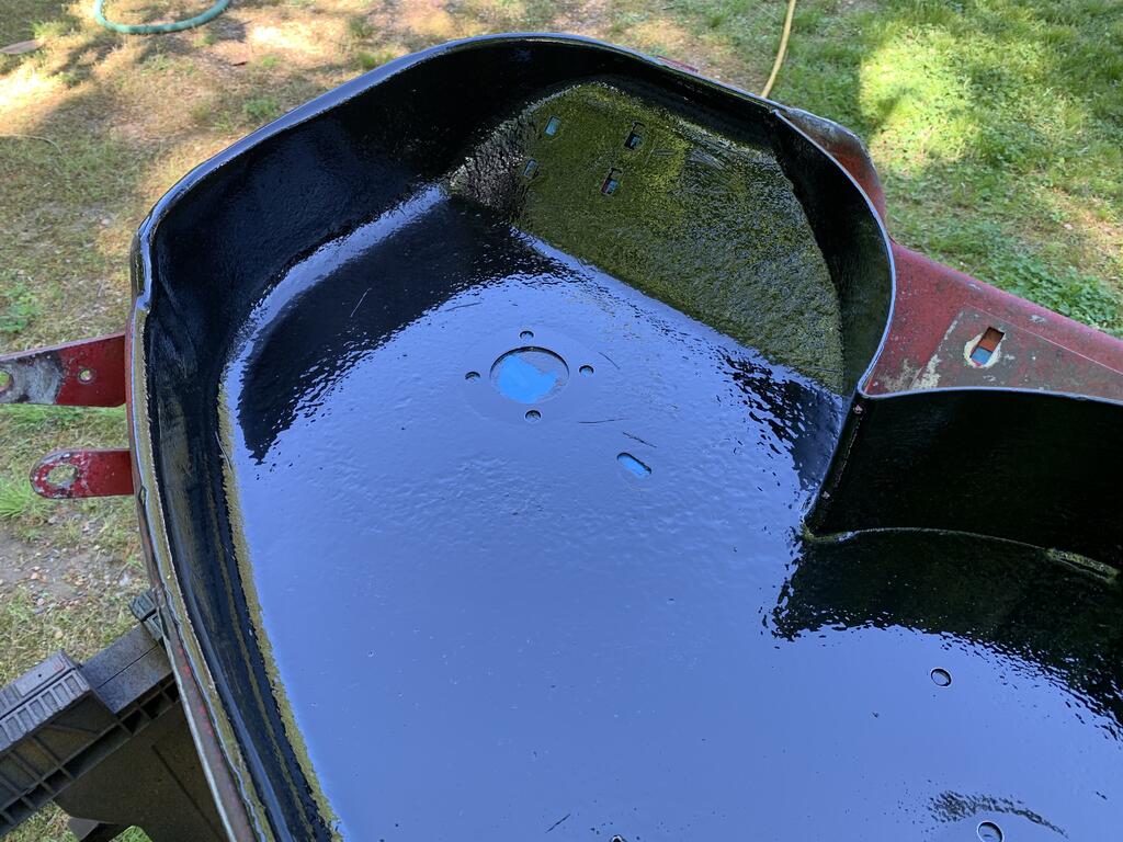

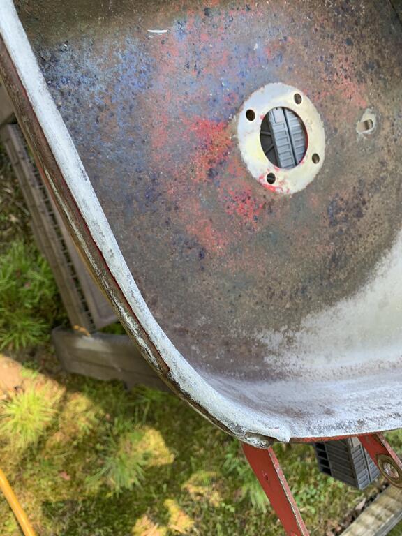

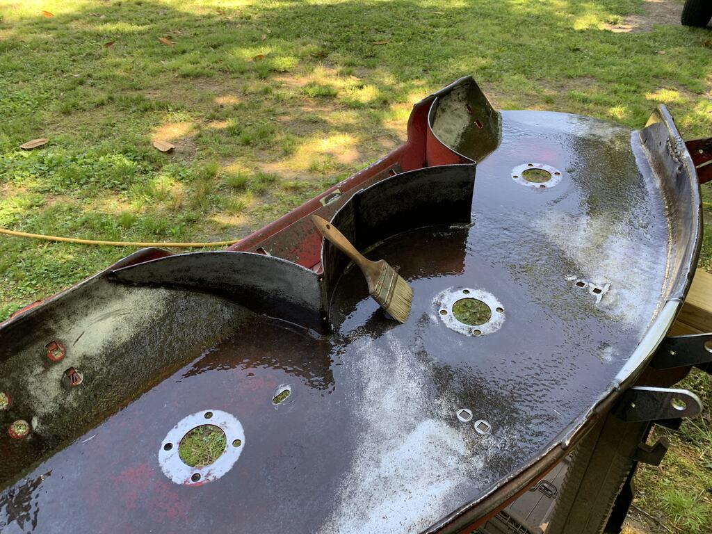

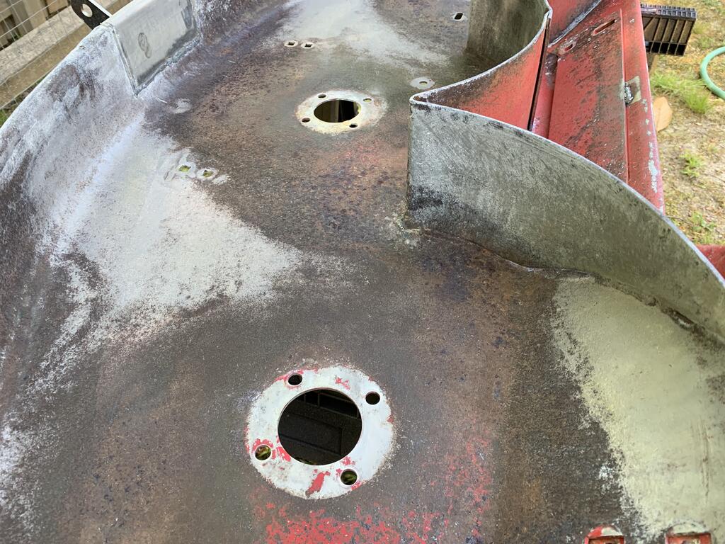

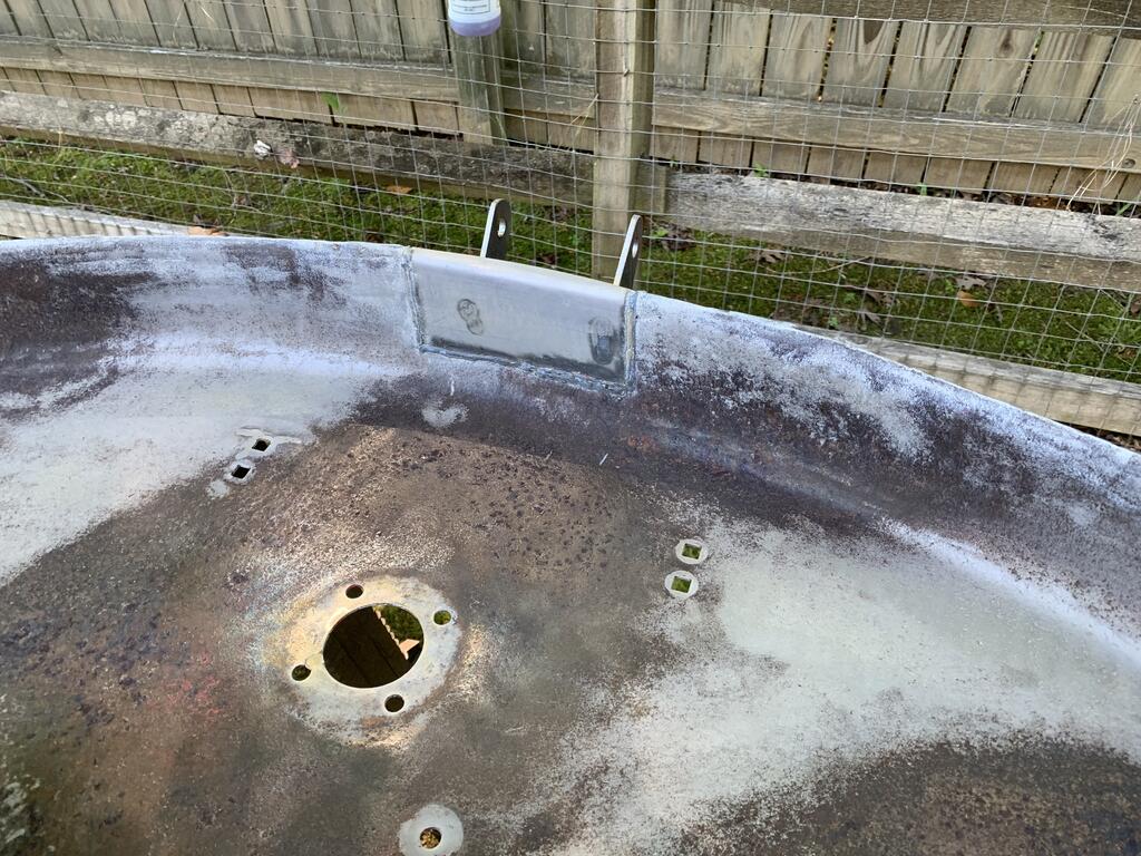

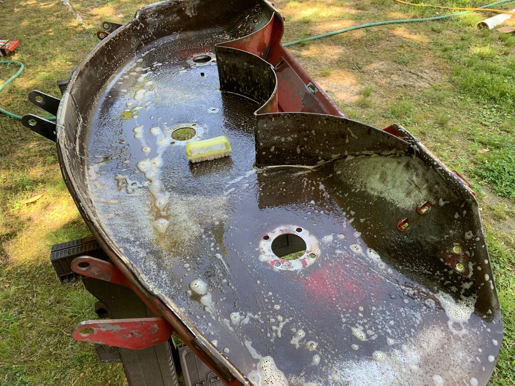

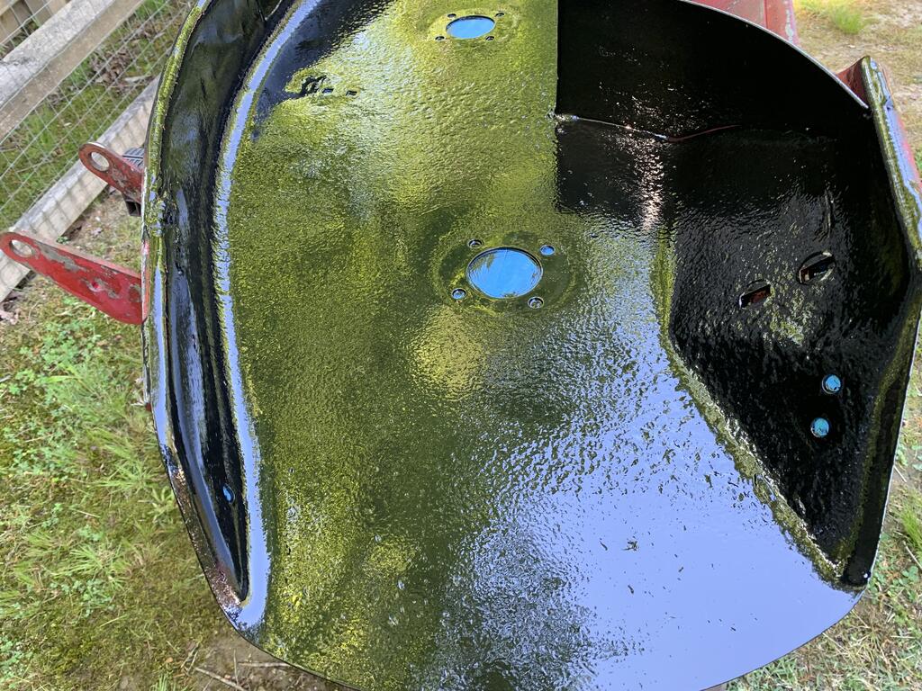

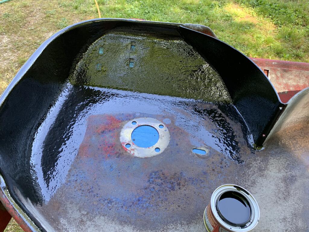

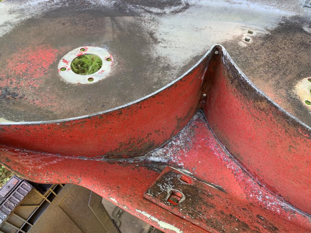

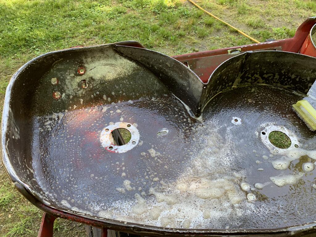

Followed the POR-15 Stop Rust Kit instructions to a “T”… hope it turns out good…
cleaned and degreased with the POR cleaner and degreaser… kept it wet for 20 minutes…rinsed, blow dried…first 3 pics…
then I treated the metal with POR-15 Metal Prep… kept it wet for 15 minutes…
next 4 pics… you can see where it turned the shiny metal kinda white… must have gotten a good etching…
Rinsed it and blow dried…
Then I got to painting (next 4 pics)…while the first coat gets tacky, I’ll install the new rubber hood latches that just came in for the Work Horse.
