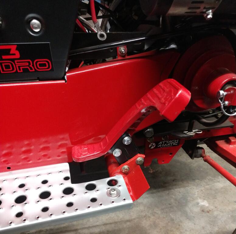

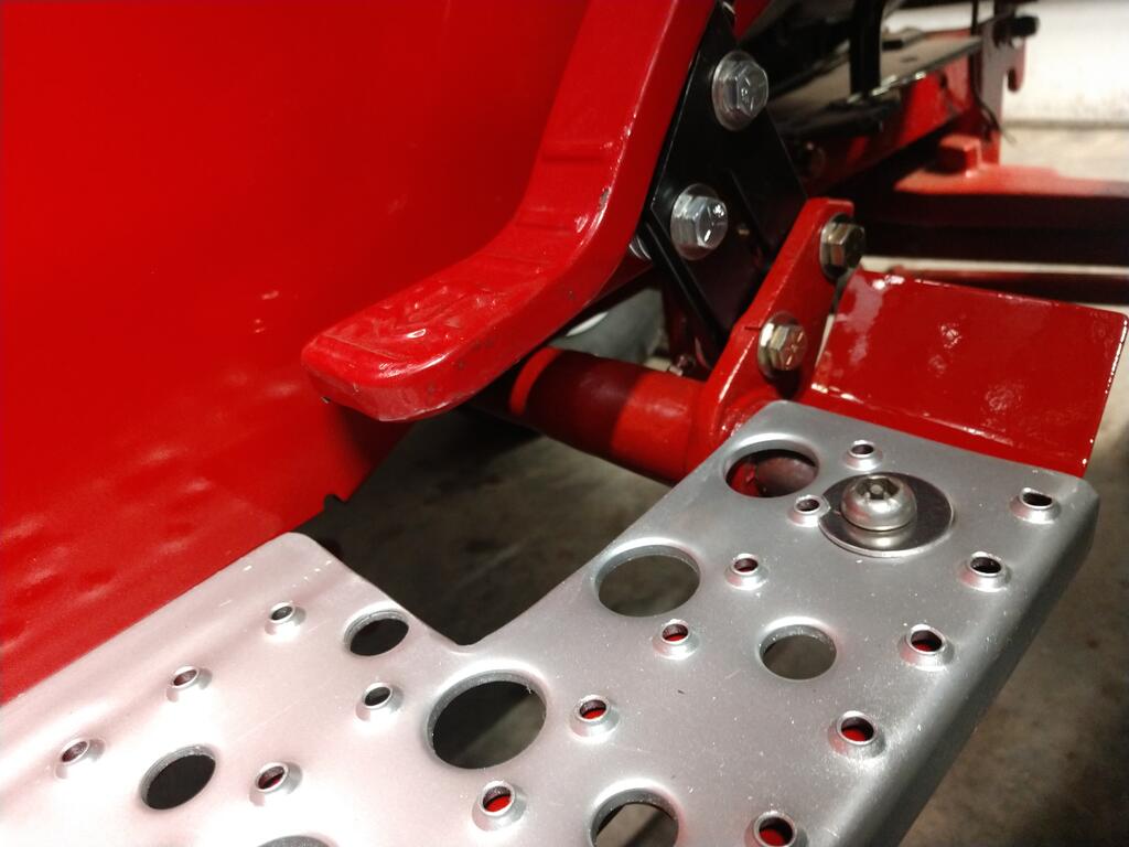

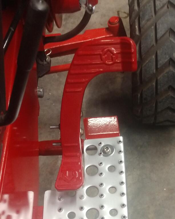

kpinnc 18,847 #201 Posted March 18, 2024 Also did a redesign of the hydro pedal. Raised the "toe", and shortened the throw considerably. Effectively moved the pivot back slightly. Also no more linkage sticking out underneath the belt guard. Looks like it's too close to the belt guard in the pictures, but it's not. 2 10 Share this post Link to post Share on other sites

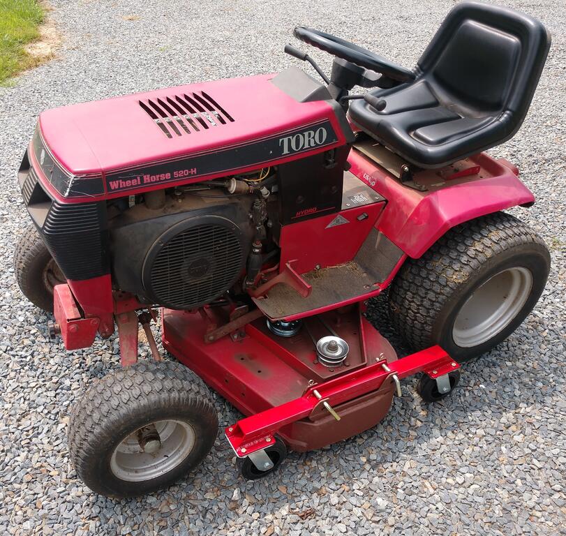

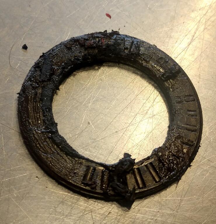

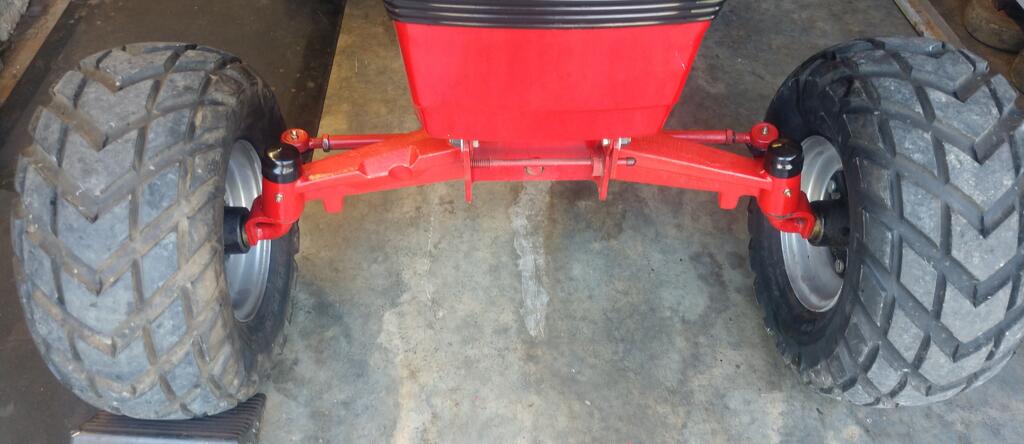

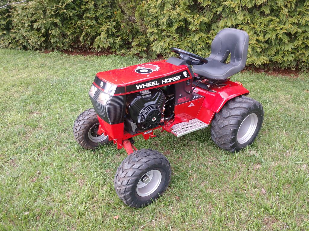

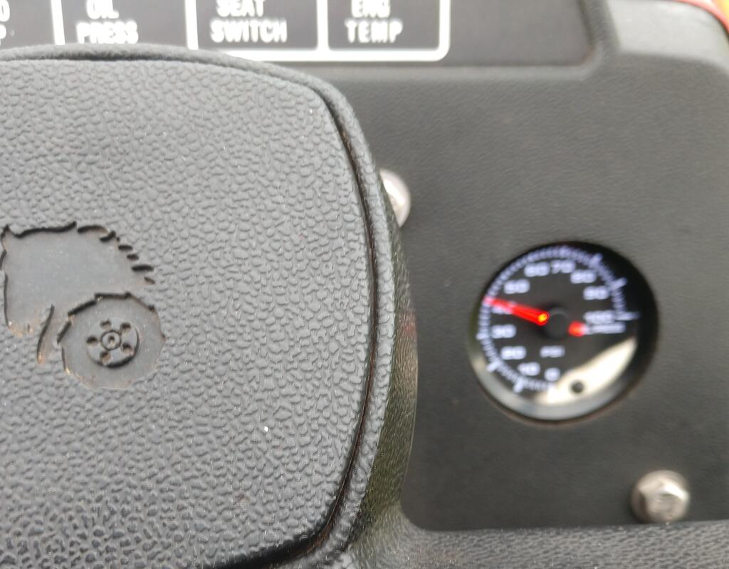

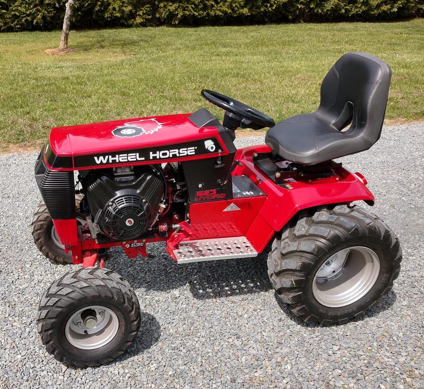

kpinnc 18,847 #202 Posted March 23, 2024 (edited) I hadn't posted much on this tractor for a couple years after it was finished. I was actually pretty afraid of the engine build I had done (it started life as a vertical engine, and I bought all the parts to make it horizontal), and I wanted the foot control to be better. So the last few days I finally decided to "knuckle up", and she's now a runner. A darn nice runner if I say so myself! So today, she drove around for the first time. New hour meter recorded 0.4 hours. Foot control works great but is too tight. Easy fix. Engine oil pressure is hard to see, but makes 43 PSI at 3000 RPM. Still a few tiny tweaks to make, but she's all set for work! Edited March 24, 2024 by kpinnc 4 9 2 Share this post Link to post Share on other sites

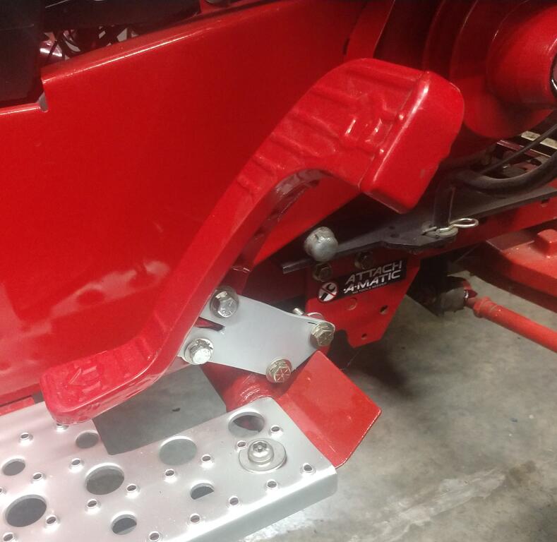

kpinnc 18,847 #207 Posted March 25, 2024 Had it out again today. The hydro pedal was too tight, so I replaced the bronze bushing and polished the portion of the peg it rides on. Made a big difference. But I still might move it back towards the rear another inch or so. I'm 6 feet tall, and have to stretch to get full forward... 1 5 Share this post Link to post Share on other sites
kpinnc 18,847 #208 Posted March 26, 2024 (edited) Hopefully the third time is the charm. Made up another bracket so the pedal is moved back about 2 inches. Definitely more comfortable, and full range is easier now. I gotta pick up some shorter bolts, but this seems to be finished. Wishing I didn't notch the foot rest so much, because it doesn't make contact. Oh well, good enough... Edited March 26, 2024 by kpinnc 2 1 Share this post Link to post Share on other sites

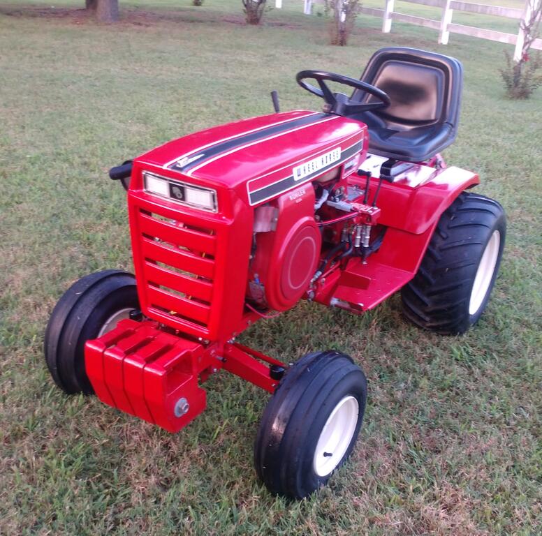

kpinnc 18,847 #212 Posted March 26, 2024 2 hours ago, RED-Z06 said: Tri-Ribs would fix that Yep. Got the Firestone ones on the Bronco. Even with that cast iron K321 and 115lbs of suitcase weights, the tractor steers like it has power steering. Like an old Jeep! 1 4 Share this post Link to post Share on other sites

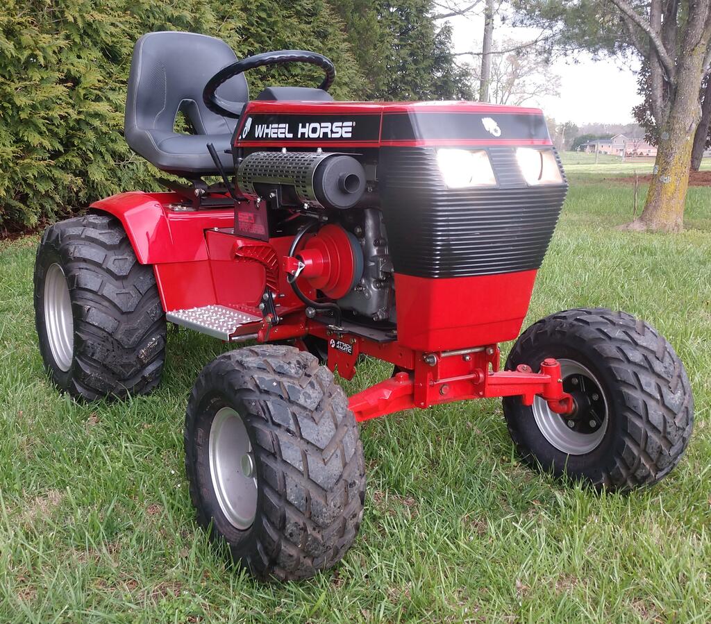

kpinnc 18,847 #214 Posted March 26, 2024 Not sure if the 523-H will mow or not. At least not under the tractor. That's an odd thing to me because the actual build was intended for increasing cut height. Now I'm leaning towards making the grader setup on it. Who knows, I'll probably change my mind several times... 1 2 Share this post Link to post Share on other sites

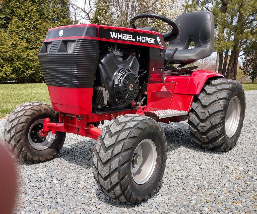

kpinnc 18,847 #215 Posted March 28, 2024 (edited) Found I had a leaky o-ring on the rear lift cylinder hose, spent a few minutes replacing it. Really I just wanted an excuse to put up another picture of this thing because I like it so much... It's a bleeping beast! Forgive the dumb thumb in the corner. Edited March 28, 2024 by kpinnc 3 3 Share this post Link to post Share on other sites

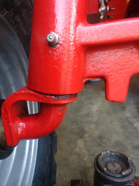

kpinnc 18,847 #216 Posted March 28, 2024 (edited) Almost ashamed to post this... I completely missed something on this build. Nearly every nut, bolt, and seal has been replaced on this tractor. I always do an OSI (obvious, um stuff inspection) before any project. And I did with this one. I checked the axle spindles, and they were nice and snug. What never occurred to my tiny mind was big tires + 500lbs of tractor will multiply "snug" considerably. This thing had the heaviest steering I've ever seen. So today I fixed it. The thrust bearings in the axle were so gunked up that they were almost unrecognizable. The grease had dried out, so no amount of lube could reach them. And they were worn to the point that the axle rubbed the knuckle on top. So I picked up a new set, cleaned everything and installed them. I picked the two best "old" races and put them in the bottom as .030 shims. Gap created is just large enough to have no contact now. Pumped full of grease and installed top caps. It steers so much better! Doesn't feel heavy at all now. I may still add reduction steering. Not sure yet. Of course I feel like a dummy for missing something like that, but fixed is fixed! Edited March 28, 2024 by kpinnc 1 7 Share this post Link to post Share on other sites

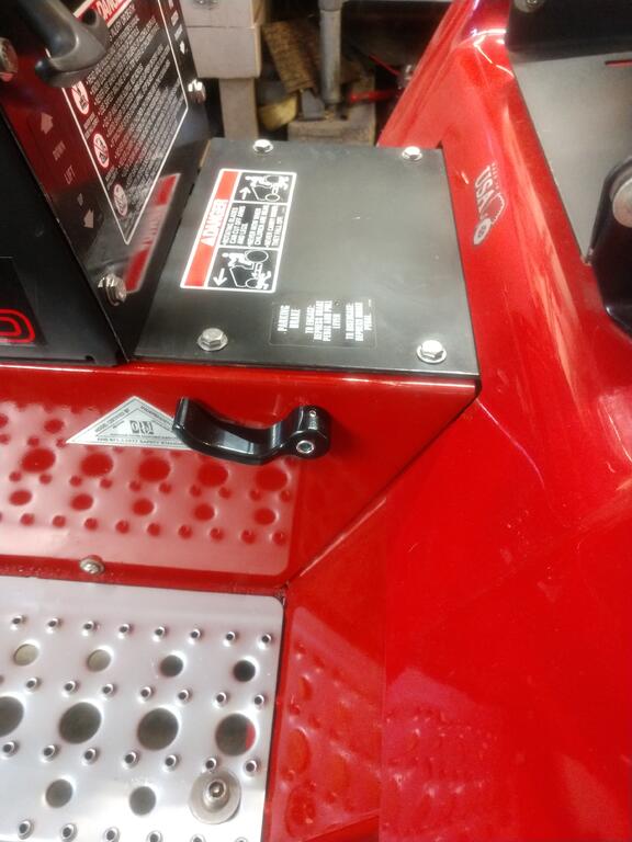

kpinnc 18,847 #217 Posted March 28, 2024 Added my own tweak on the park brake. Modified a thumb throttle lever from an ATV... Pressed in a steel bushing for a little more strength. Works great. Brake is set in the pic, hence the nose up position. 5 1 Share this post Link to post Share on other sites

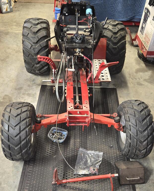

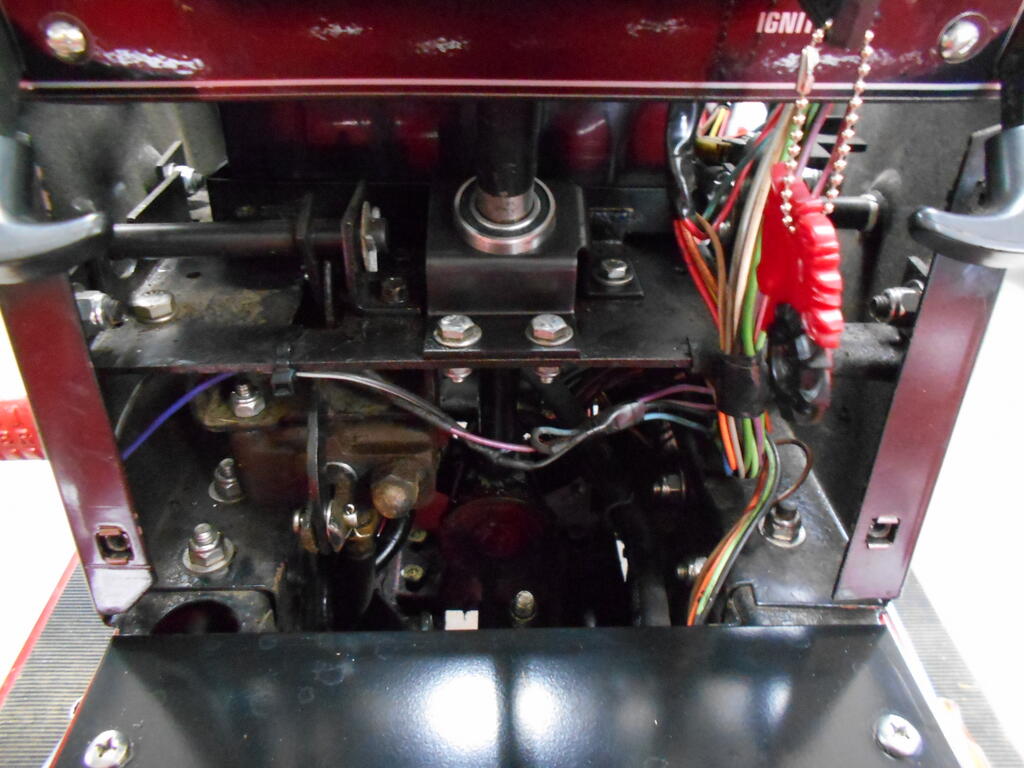

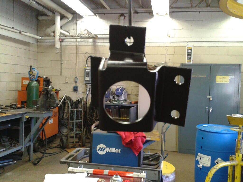

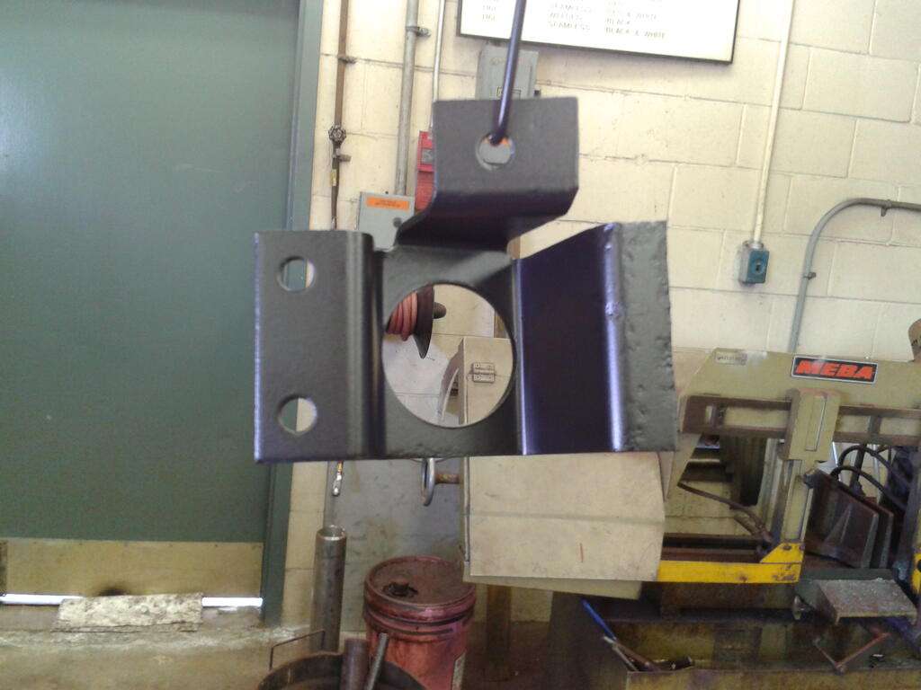

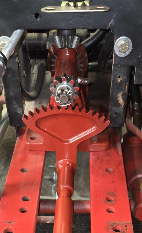

kpinnc 18,847 #218 Posted January 12 (edited) Eric @ebinmaine made me do it... He has another thread adding reduction steering to his C series, and it reminded me that I had all the parts to add reduction steering but didn't when I originally built the 523-H. I have 3 tractors with the 520 front axle, but none had reduction steering. This tractor has 18 inch front wheels, and though it steers pretty easily, it's the best candidate for the upgrade. I also had an issue with my hydro foot pedal. It binds up with about 1/8 inch of the last travel in the cam, which is quite a bit of the top end speed. I thought maybe this transmission was just a little slow, but now I'm not so sure. Regardless, I've got some tweaking to do on the rear end as well. So now I've taken this tractor almost back to the frame. No chance of getting that lower steering shaft swapped without removing the engine. That and the hydro linkage work mean almost a full tear down. It looks sad! First thing I noticed is that although the upper steering shaft is shorter than the original, it is still 1.5 inches taller are the steering wheel. I had planned to add about 3 inches anyway, because the wheel is just too low. I assumed it being shorter meant the wheel would be in the same place... Also, the bellcrank for the belly hitch comes very close the the back of the gear reduction base. It almost touches it at full down. Anybody else seen this with reduction steering 520-H tractors? Anyway. It'll be a few days before I get this back together. I'm gonna add a bearing at the top below the steering wheel and a few other tweaks, but it's nice to be tinkering again! Edited January 12 by kpinnc 5 Share this post Link to post Share on other sites

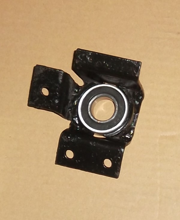

Lee1977 7,743 #219 Posted January 12 We talked about this bearing and bracket, though I would send the picture any way. 2 Share this post Link to post Share on other sites
cleat 9,093 #220 Posted January 12 1 hour ago, kpinnc said: Eric @ebinmaine made me do it... He has another thread adding reduction steering to his C series, and it reminded me that I had all the parts to add reduction steering but didn't when I originally built the 523-H. I have 3 tractors with the 520 front axle, but none had reduction steering. This tractor has 18 inch front wheels, and though it steers pretty easily, it's the best candidate for the upgrade. I also had an issue with my hydro foot pedal. It binds up with about 1/8 inch of the last travel in the cam, which is quite a bit of the top end speed. I thought maybe this transmission was just a little slow, but now I'm not so sure. Regardless, I've got some tweaking to do on the rear end as well. So now I've taken this tractor almost back to the frame. No chance of getting that lower steering shaft swapped without removing the engine. That and the hydro linkage work mean almost a full tear down. It looks sad! First thing I noticed is that although the upper steering shaft is shorter than the original, it is still 1.5 inches taller are the steering wheel. I had planned to add about 3 inches anyway, because the wheel is just too low. I assumed it being shorter meant the wheel would be in the same place... Also, the bellcrank for the belly hitch comes very close the the back of the gear reduction base. It almost touches it at full down. Anybody else seen this with reduction steering 520-H tractors? Anyway. It'll be a few days before I get this back together. I'm gonna add a bearing at the top below the steering wheel and a few other tweaks, but it's nice to be tinkering again! Yes, the lift bellcrank is slightly shorter on the reduction steering models. I found that out the hard way also. 3 1 Share this post Link to post Share on other sites
cleat 9,093 #221 Posted January 12 15 minutes ago, Lee1977 said: We talked about this bearing and bracket, though I would send the picture any way. I did that as well on a couple of my 520's Drill out to 1-3/8 then you can use a regular wheel horse front wheel bearing as the steering bearing. Works very smooth with no play. 2 2 1 Share this post Link to post Share on other sites
Lee1977 7,743 #222 Posted January 12 2 minutes ago, cleat said: I did that as well on a couple of my 520's Drill out to 1-3/8 then you can use a regular wheel horse front wheel bearing as the steering bearing. Works very smooth with no play. I used a out side PTO bearing and welded in a couple pieces of pipe to hold the bearing. Either way it's hard to adjust the 3/4" collar. 2 Share this post Link to post Share on other sites
ebinmaine 80,062 #223 Posted January 12 7 hours ago, kpinnc said: Eric @ebinmaine made me do it... Yep. 6 hours ago, cleat said: Yes, the lift bellcrank is slightly shorter on the reduction steering models. Now there's some interesting information 🤔 On my 1974 C160-8 the gear ⚙️ has strong contact with the lift lever. I haven't decided how to solve that just yet. 2 Share this post Link to post Share on other sites
Bill D 3,061 #224 Posted January 12 I'll be following along to see what you find wrong with your hydro pedal linkage. 1 Share this post Link to post Share on other sites
Handy Don 17,164 #225 Posted January 12 11 hours ago, kpinnc said: Also, the bellcrank for the belly hitch comes very close the the back of the gear reduction base. It almost touches it at full down. Anybody else seen this with reduction steering 520-H tractors? I was in there when building our 520-based machine and it was close, but not whisker close, so I was puzzled. Glad I also read the responses. (Thanks @cleat) 1 Share this post Link to post Share on other sites
